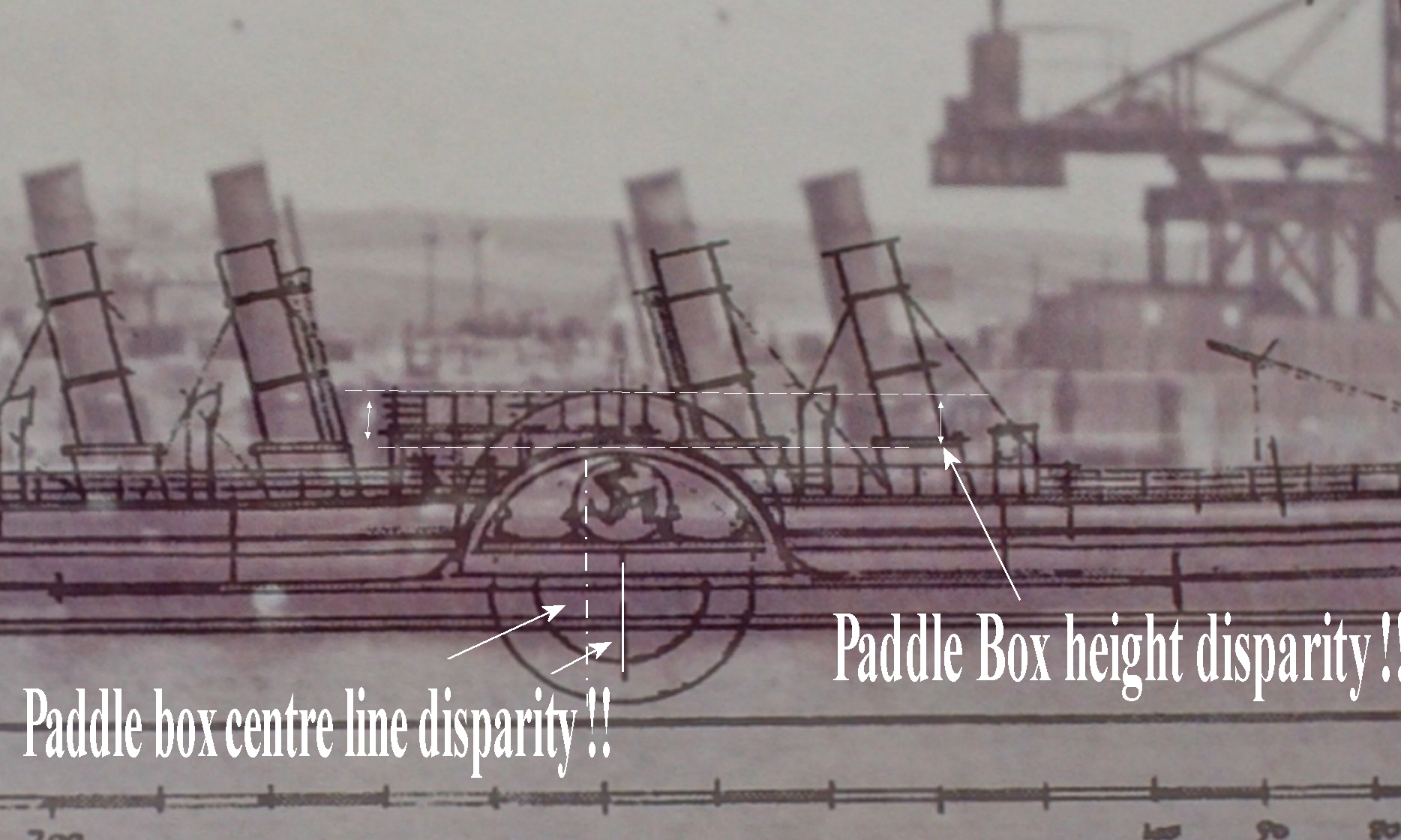

ah... that Drawing ...
all is not as it seems alas... :scratch:
I overlaid a side-on-photo and the plan together--and a number of misleading problems came to the fore;
as below...
Ha!

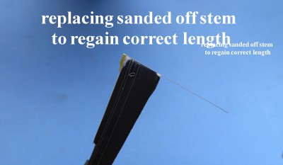

So as to allow the stem-head ( bow) to create an razors sharp stem ,
--I inserted a piece of stainless steel into a grove cut into the wood at the bow
( thereby it is cantilevered against sanding loads!)

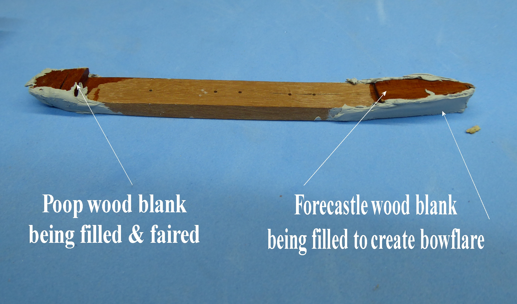

then the filling and fairing began....
first I added F'oclse and poop decks to deck plan and filled the undercuts with
high grade automotive filler

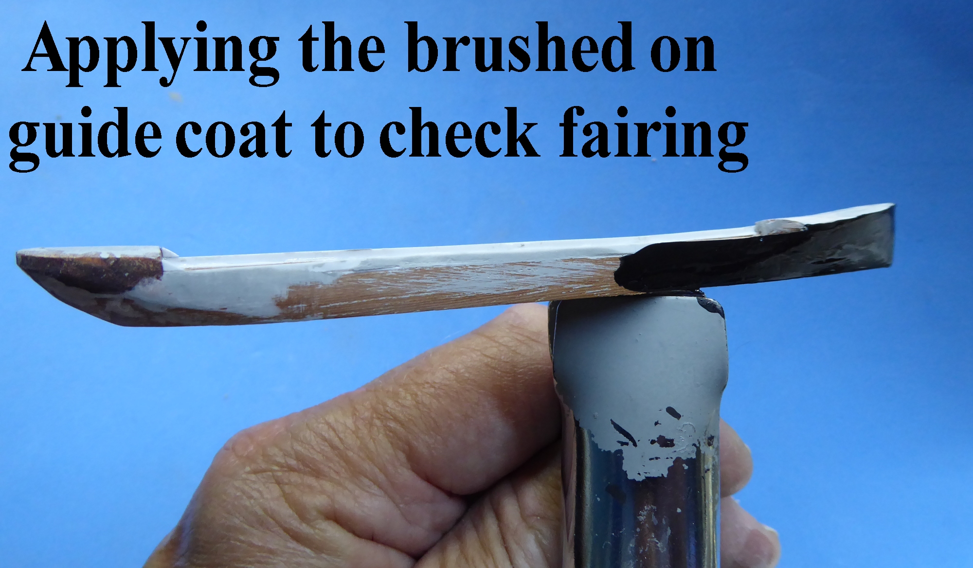

and thereafter I painted it in thick enamel --so as to act as a guide coat and fine 'filler '
when the paint has hardened it will show up any areas that need further attention.
very very mild imperfections will mostly disappear when the paint is sanded

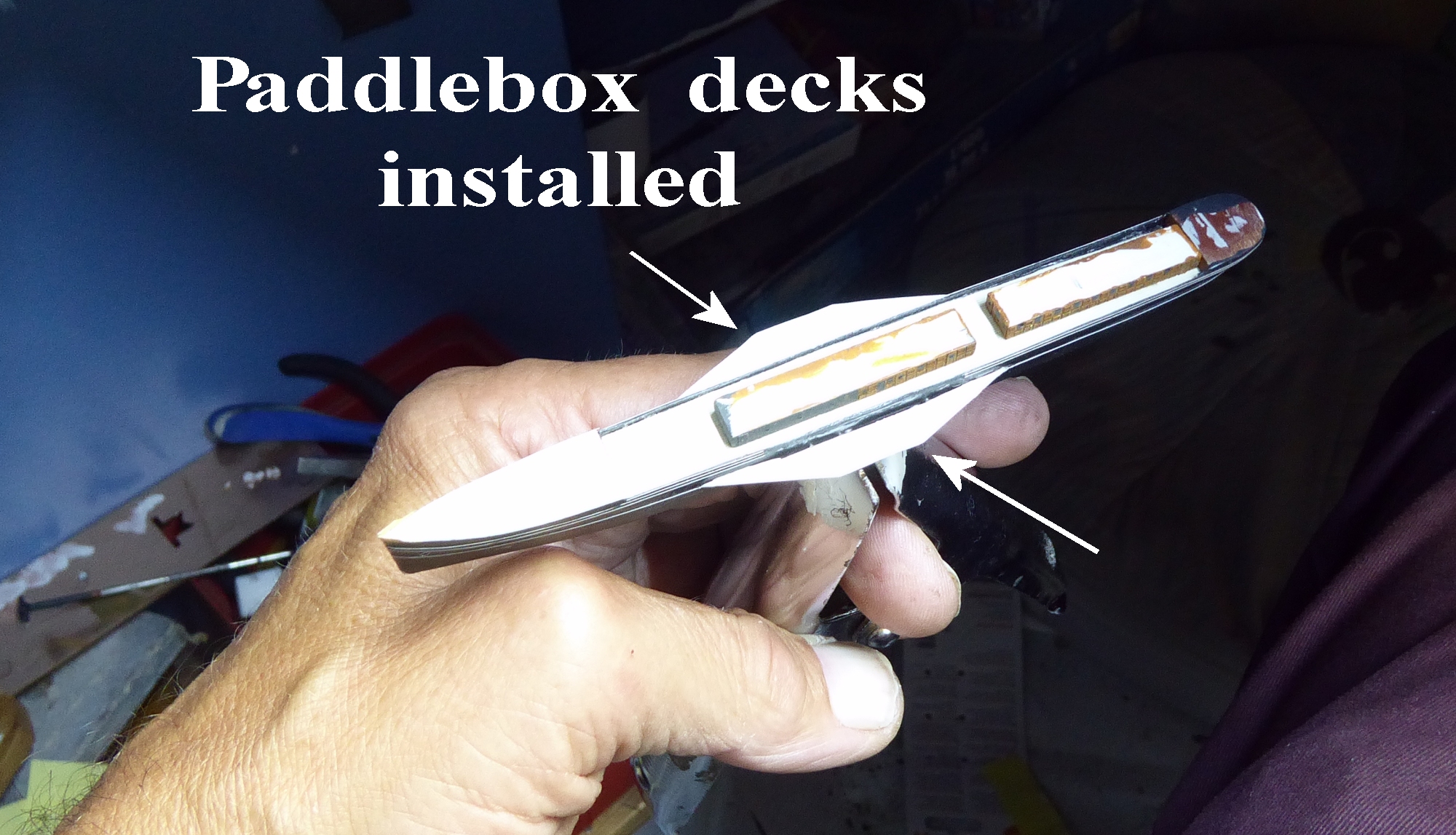

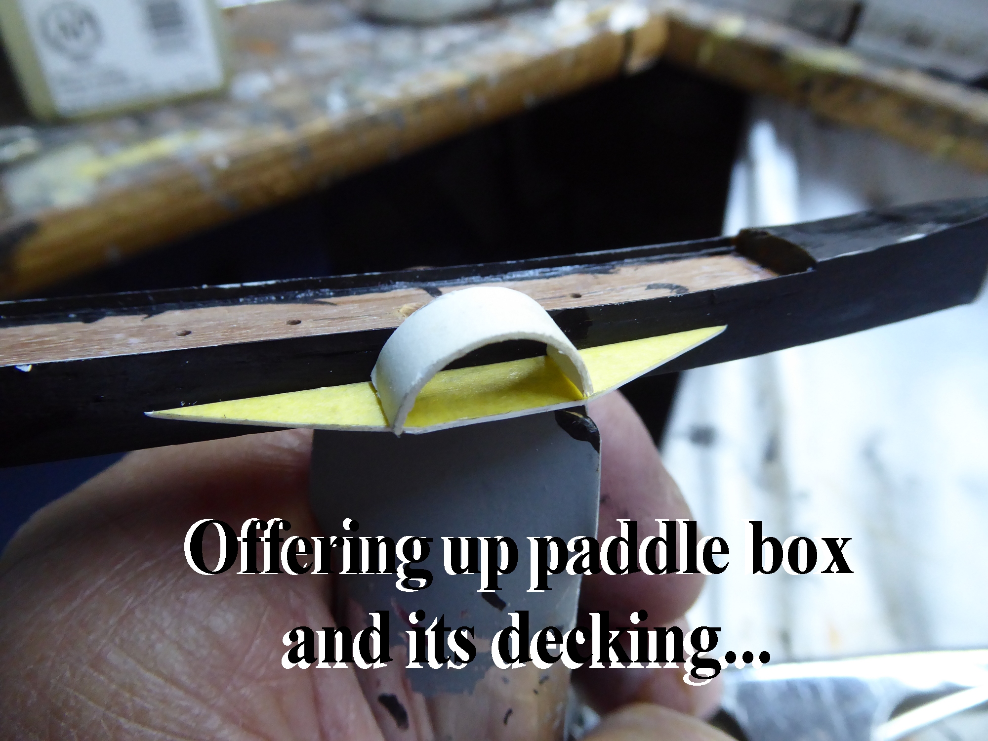

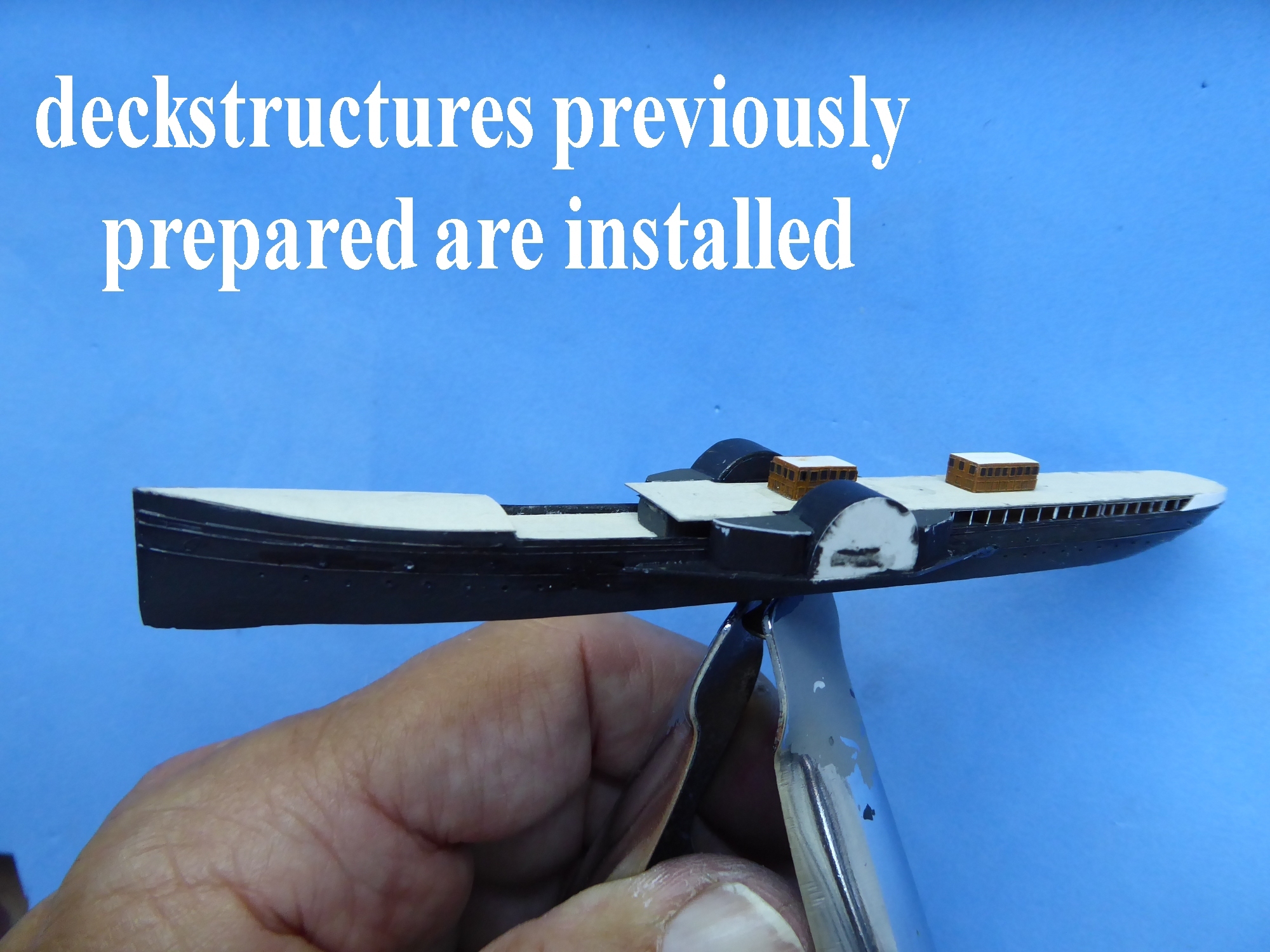

meanwhile I cut the paddlebox decks
and some 14mm tubing ( in my ancient K & S metals tube cutter )
and then offered and balanced the decks and paddle box ( using no adhesive other than will-power :big_grin: !)
to the hull to gauge the proportions
all seems well!

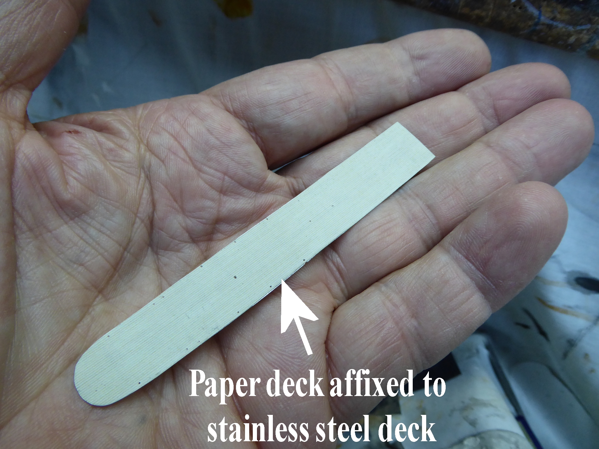

Making the main deck template to enable me to cut accurately my printed paper decking

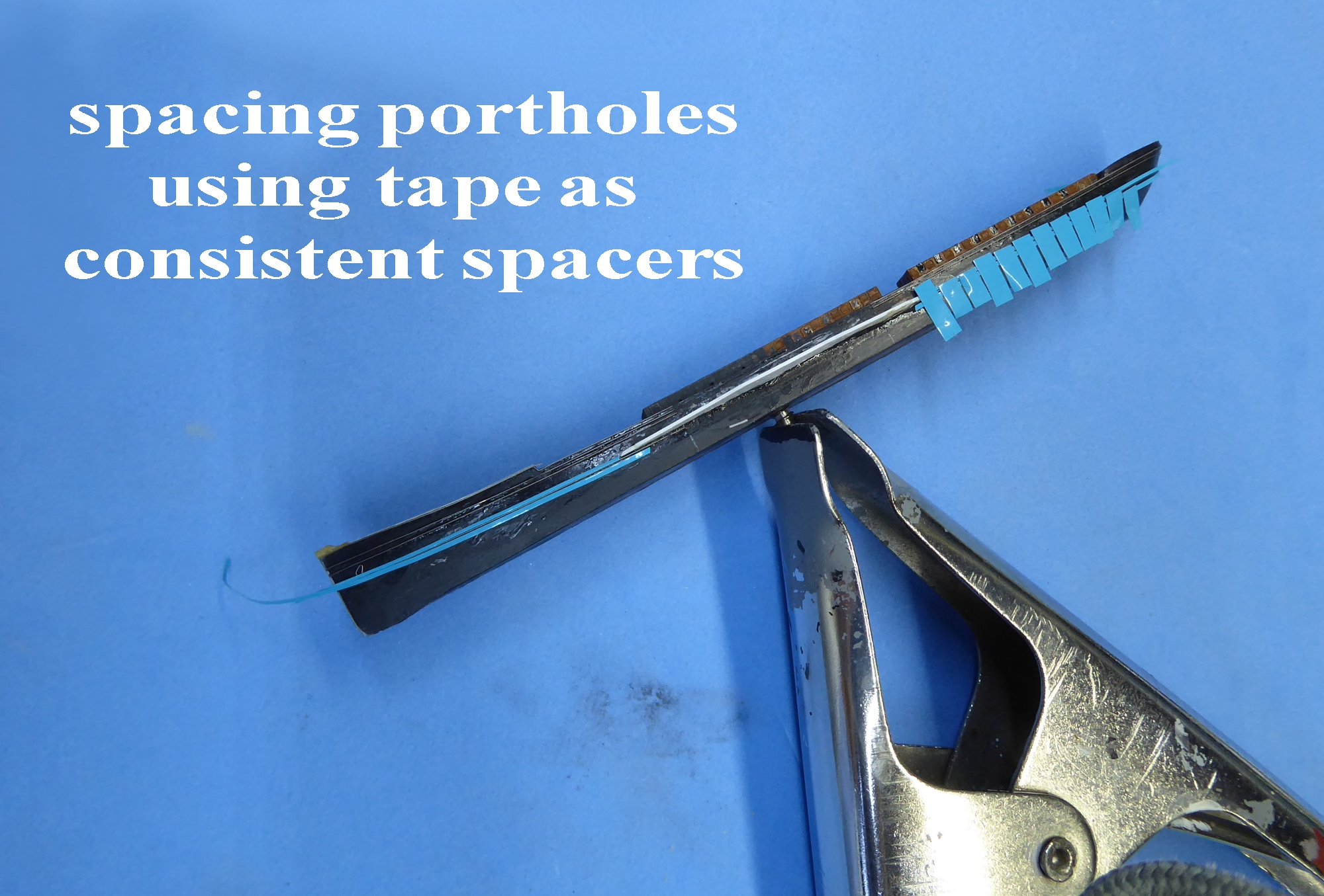

some of the pieces needed portholes as well

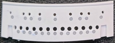

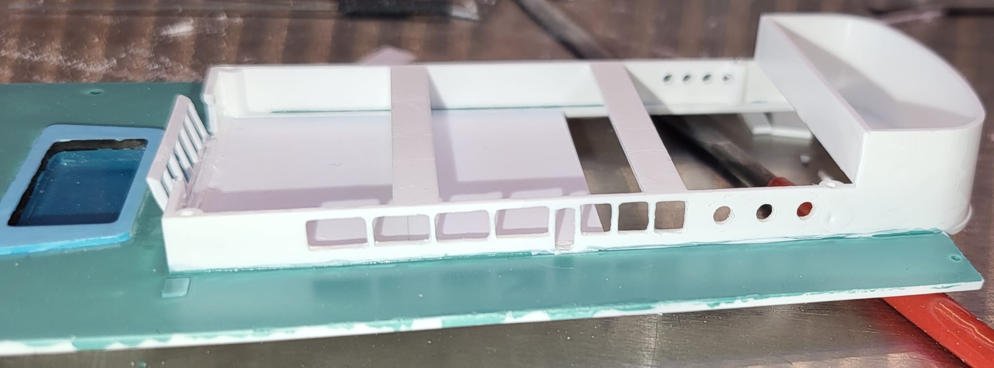

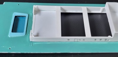

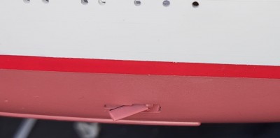

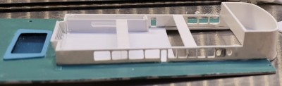

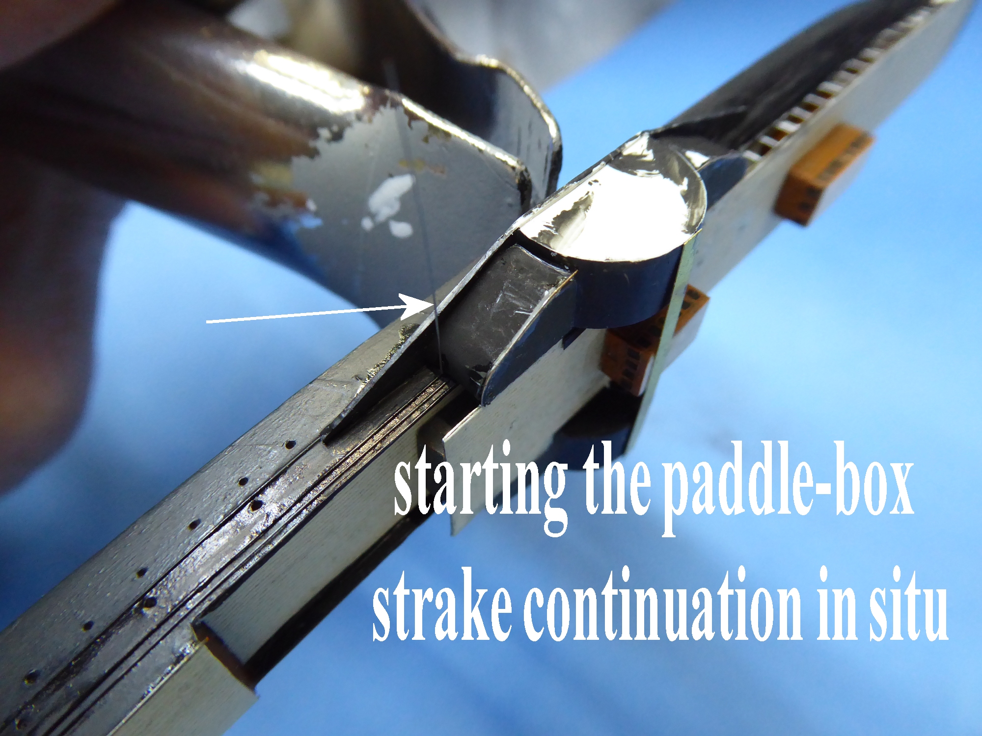

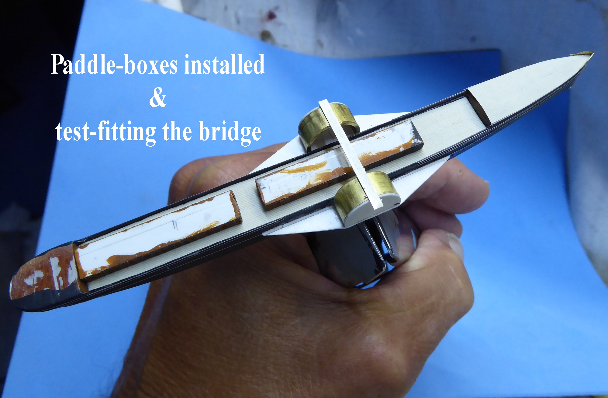

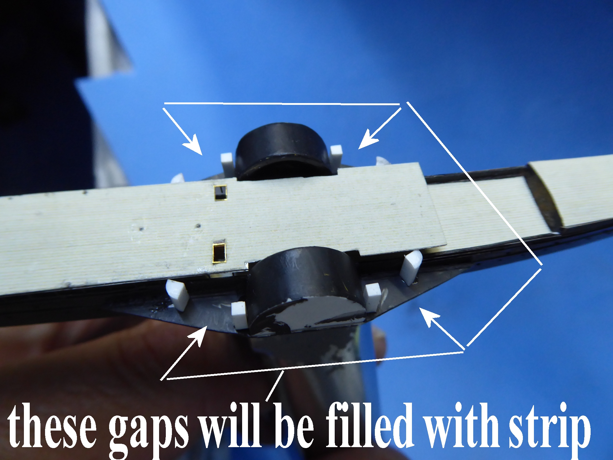

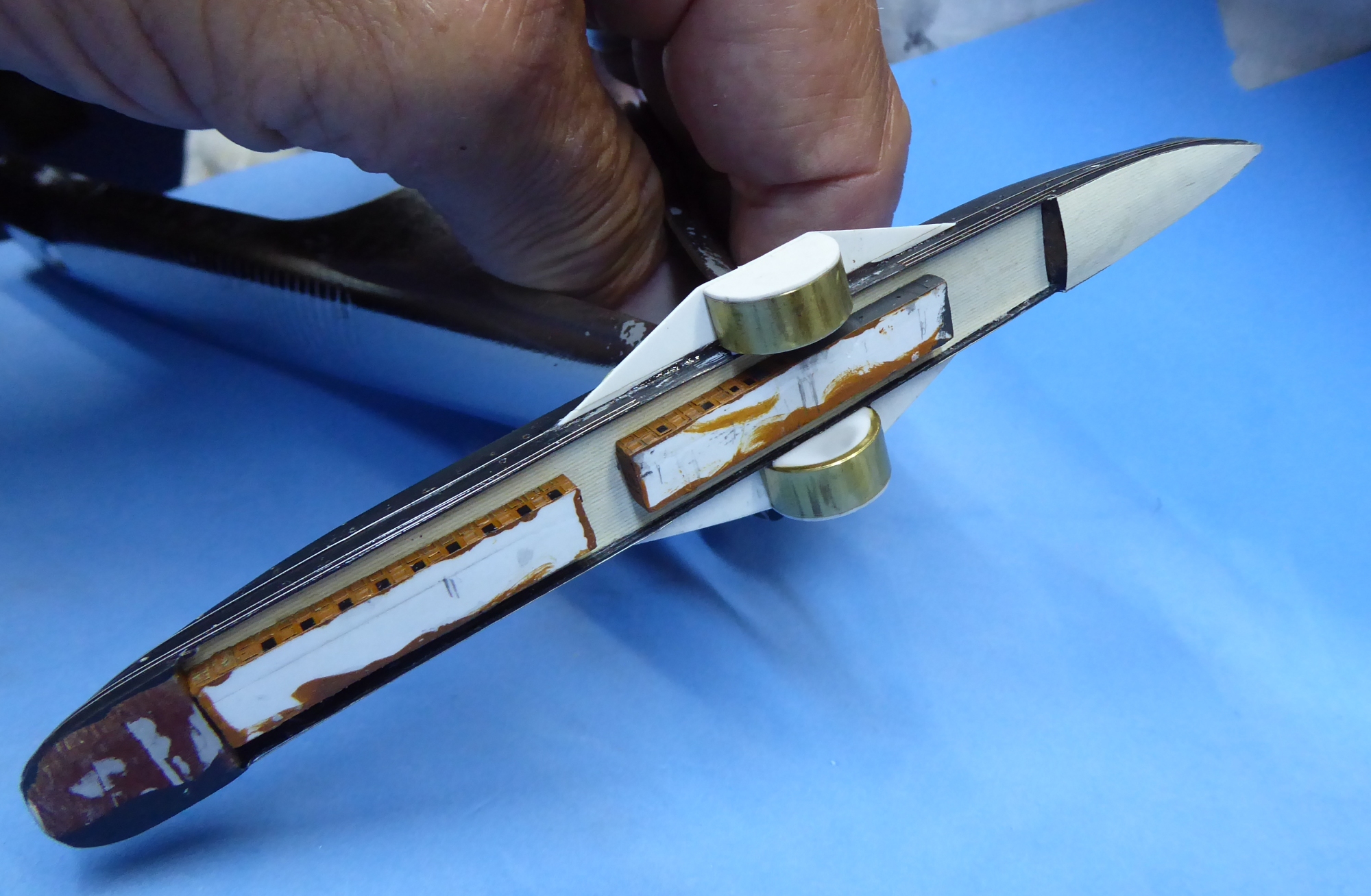

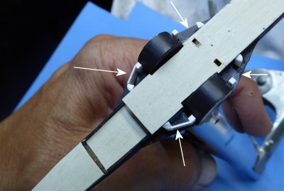

I found myself to be dissatisfied with my earlier paddle boxes--the surface of the media was not as smooth/ homogeneous as I would have wished ...
so I made some new ones ( x 4 in case of damage / error ) cut from of 14 mm thickwall brass tubing
which the outer faces made of Styrene ,
The styrene was subsequently pared and sanded to shape -this also gave the correct final paddle Box width

All styrene decking was too thick--brass is too soft -- and expands too much in heat/ contracts in cold
Stainless steel is better and more stable in terms of thermo dynamics
I cut my decking from a very wide ( 20 mm !) piece of stainless steel PE fret surround
This was cut with a new pair of Fiskars scissors
-looks unsubtle .... :big_grin: but very effective and as they are exceedingly sharp--almost distortion free :thumbs_up_1:
This deck was drilled in my mini pillar drill- with very small holes- to take the davits shafts
This will be clad with my usual home designed printed paper deck ( as seen first on my 1/700 Normandie )

The ' wood/paper ' decking mounted onto the stainless steel
as the model consists of a solid wooden hull-- unsubtle tools
will not dish the weather deck !! :big_grin:
The real ship had a multitude of rubbing strakes
I replicated these with application of thin wire
eventually.....
and to blend the strakes and the sanded bow plate
at long last-tangible progress !
I employed a few unusual techniques...(!)
at this point-with the strakes installed ,
I could space off the portholes -
-using contrasting colour tape as a consistent measurement...
that I could eyeball
The upper deck supporting struts caused me a headache
--how to get them thin-and regular -and totally even...
==> solution... spares box PE used creatively :cool_2:
back to the paddles boxes....

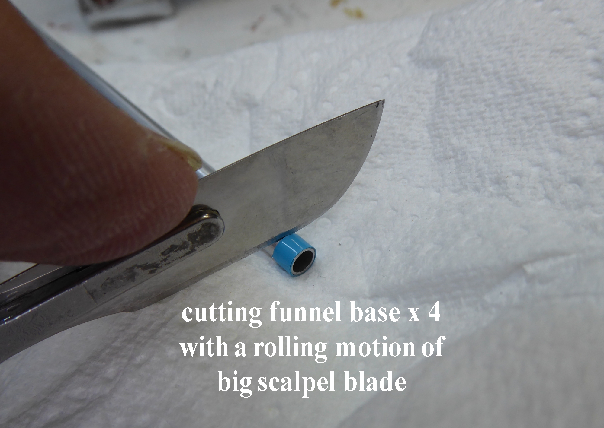

and onwards to the funnel bases ( bigger tube)

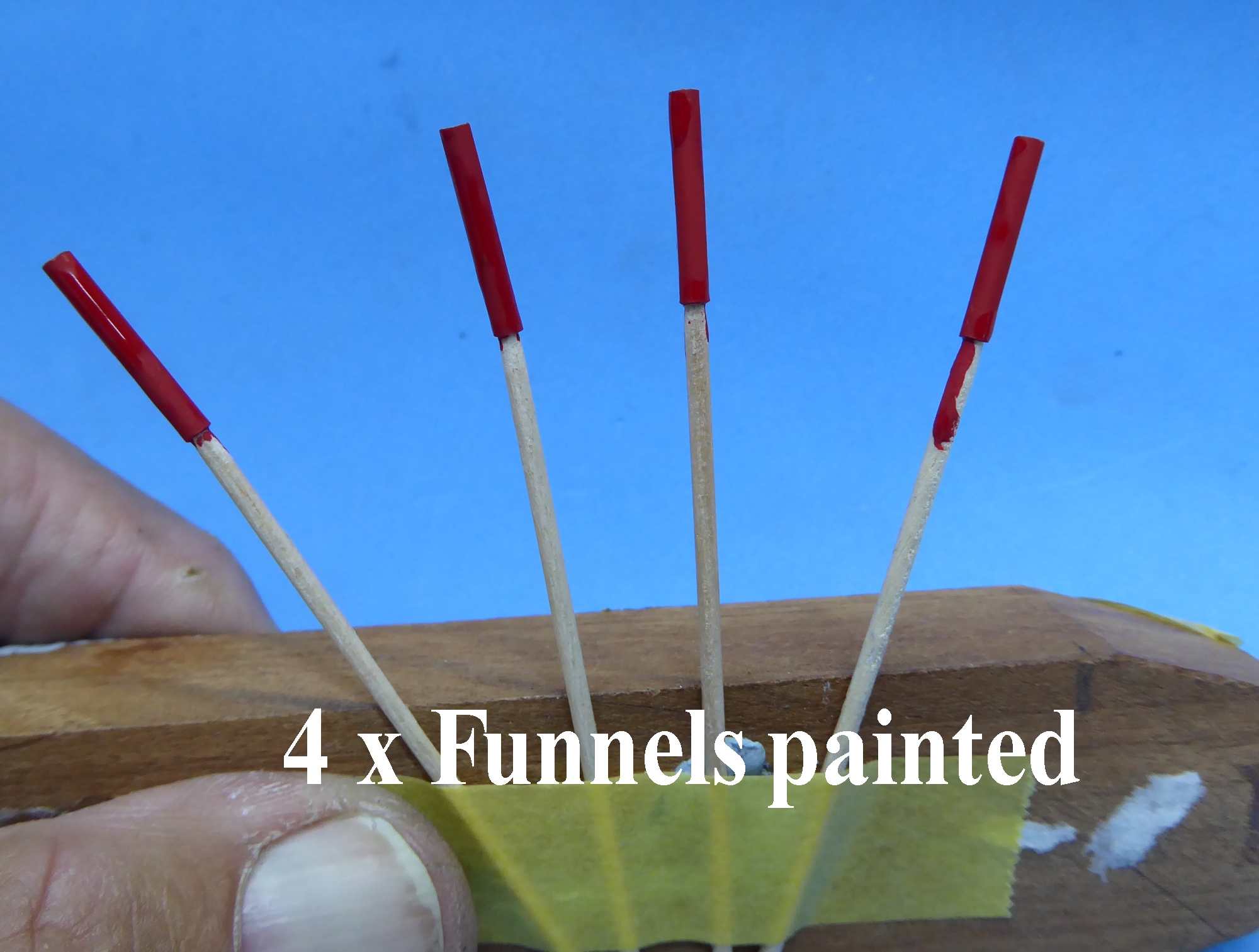

and then the funnels -( smaller tube ) - with hollowed out tube tops
to give the appearance of thin funnel walling
and then some more pleasurable installations
of previously prepared components
and then back to the tedium of adding moire strakes to the
paddle box sides
