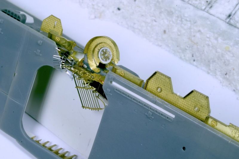

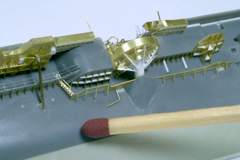

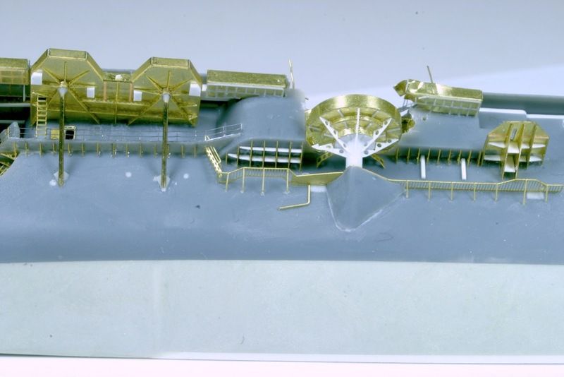

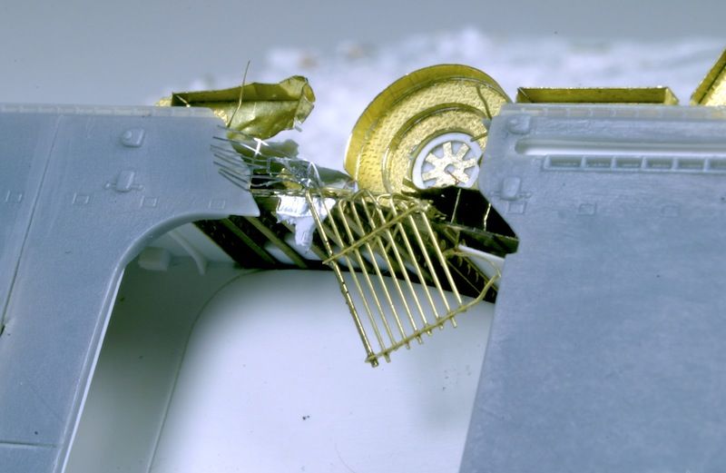

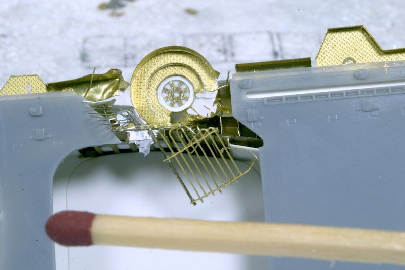

Meanwhile, I slowly move forward while detailing. A fun part I just finished was the battle damage along the rear elevator.
More railings need adding later.
I used some parts from the Lionroar PE set for the Unryu I'm using, and one part from Bruno's custom set (the star-shaped centre part of the 5' gun mount), generic PE perforated beams and gussets, but also quite some brass and plastic sheet, stretched sprue and brass rod and wire to cobble together the details.
And of course with my giant match :) :
