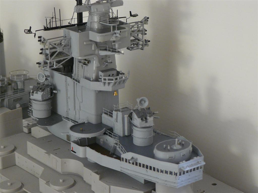

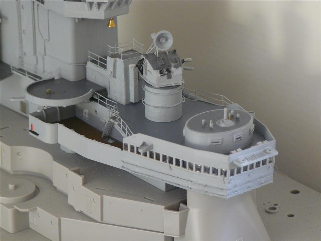

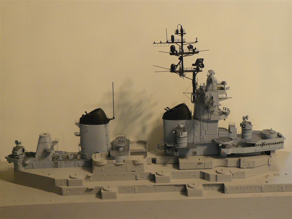

Well, amid a family crisis that is in progress, I decided to upload the latest. I may be absent from the forum so I'll begin the week with these photos:
Here's the overall superstructure (Note - major pieces sitting in place only):
Closer view of bridge & conning tower:
Closer view of bridge:
I'm still waiting on the decking set arriving from Pontos :huh: :cry_3: :huh: so at this point I'm going to s-l-o-w-l-y begin basic hull & main deck work since only some minor superstructure work can be done at this point.

Outstanding work on the tower and the ECM gear. Looks the business, clean and tidy. Good luck with the family crisis and hopefully PONTOS will come through with the deck. Looking forward to the next update.

Sorry to hear about your family troubles; god knows I've had my fair share of family messes so I feel for ya.
The Big J looks great though; she'll be one of a kind... and in a good way! :thumbs_up_1:

Posts: 5060
I know the family crisis has been a psychological burden, but sometimes having our projects can take us away long enough to cope better. Hope things are better at least for now.
NJ is looking very NJ like, interesting to see both the differences in the individual ships and era wise as well.
Chuck mentioned using primer to simulate plate lines. I did this for my waterline 1:192 Alaska hull and it worked out well. High build auto body primer, available at many parts stores comes in rattle cans and is good for this. Not a technique I invented but had read about somewhere many years ago. The primer is soft so as to easily sand and hide imperfections, so might take a coat of harder lacquer or enamel to protect it before much additional progress. Golden makes an airbrush extender for acrylics which might be the ticket for Randy as it increases the flexibility of the paint film. Such additives are also commonly used to top coat airplane fabric which flexes a lot.
Looks as if the bridge windows came out well. Did you leave any open?
The windows at the aft end of the bridge (you can't see them) that are perpendicular to the bridge house (one window, one door) are open. After reading Jason's comments on CASF IOWA Class regarding the size of the Trumpeter bridge windows, I recall earlier threads on this subject - CliffyB had measured WISCONSIN's windows and after comparing the Pontos PE brass bridge windows with the Trumpeter, I decided to go with the kit plastic - they are very close to what they should be and if I had thought about it BEFORE beginning to work on this, I would have taken the time to gently filed the kit window openings a tad bit larger in both directions. But, given that oversight, I'm not all that displeased with the results.

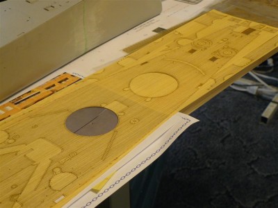

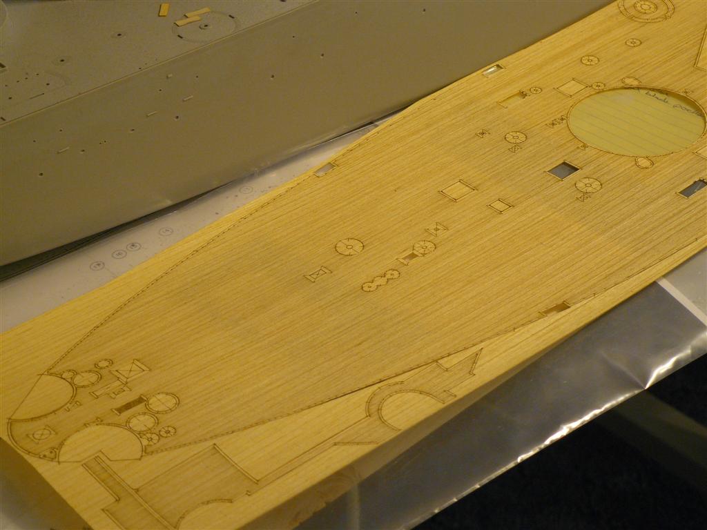

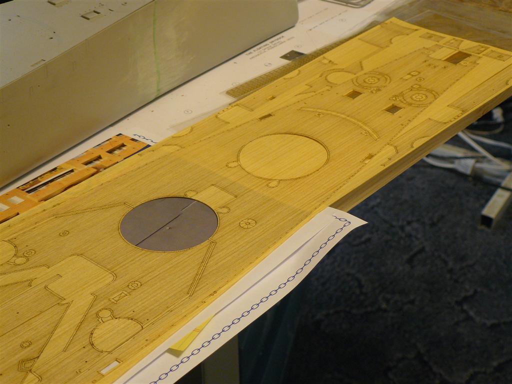

Here are a couple photos of the Pontos Decking that I had on special order which came while I was home:
As you can see all the 20mm emplacements are gone, as well as the catapult cutouts and a few other items that were not present on NEW JERSEY in 1967-69. I am planning on doing a bit of color experimentation on some of the scrap material to possibly get a more brown look than the yellow look. However, overall I have no complaints - Pontos did a great job working w/me on this.
I also intend to finish the decks with some flat or satin treatment - see the discussion Wooden Decking on the Main Forum. But this will take place AFTER whatever modifications to the hull are made and I watching two other builds at this time which have made modifications to the basic 1:200 Trumpeter IOWA class hull.

Wishing you an improved and less stressful year to come. The deck looks great and happy that (1) mr Kim was willing to work with you on this (2) it came out well. Will be interested as to the deck finish and how that comes out. I agree the yellow is a bit over the top and not too represenative of an as installed deck, maintained or not.

Thanks for the kind remarks. I don't want to remove the deck parts from the sheet if possible, but I think there is enough spare mat'l. to make several test strips for various shades of coloring. The yellow is a bit too much and needs correcting.
