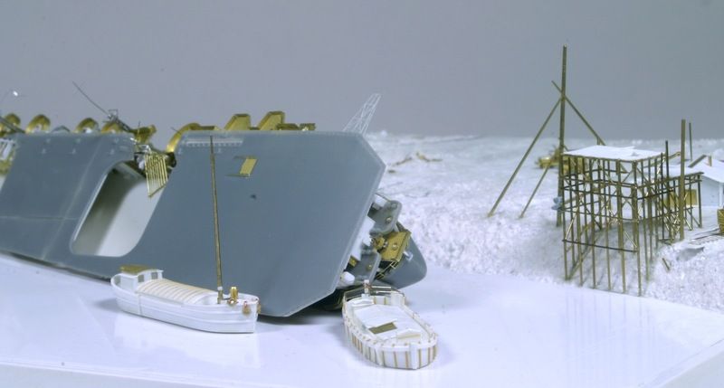

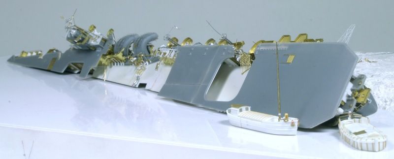

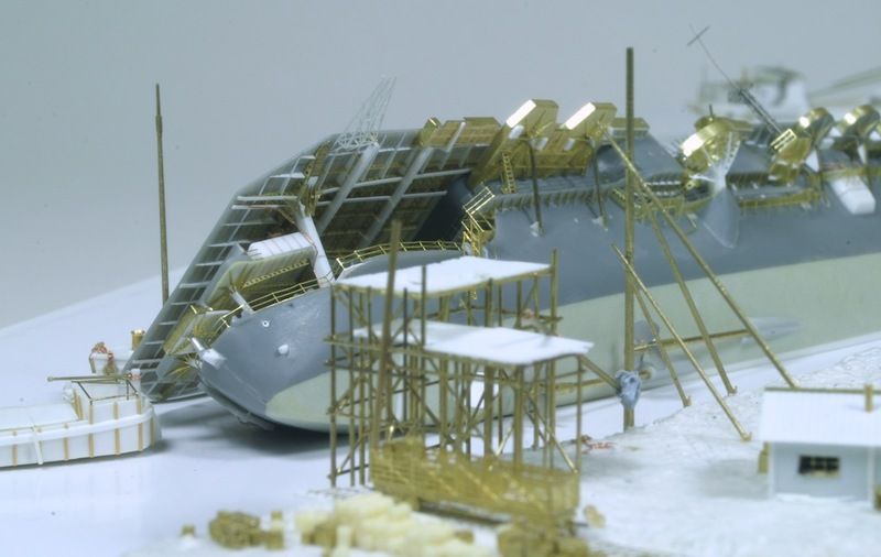

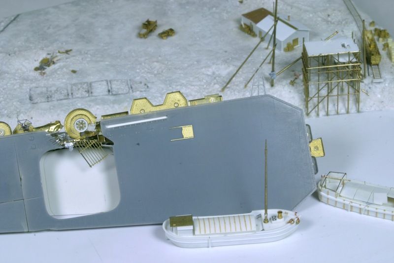

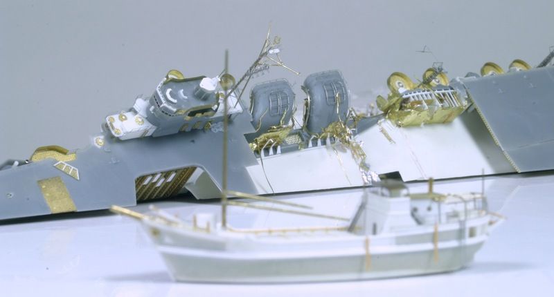

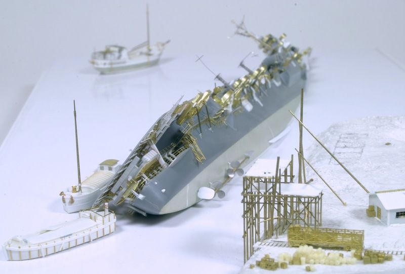

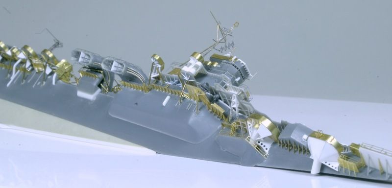

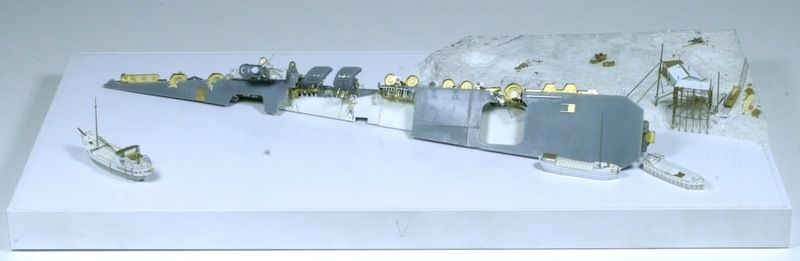

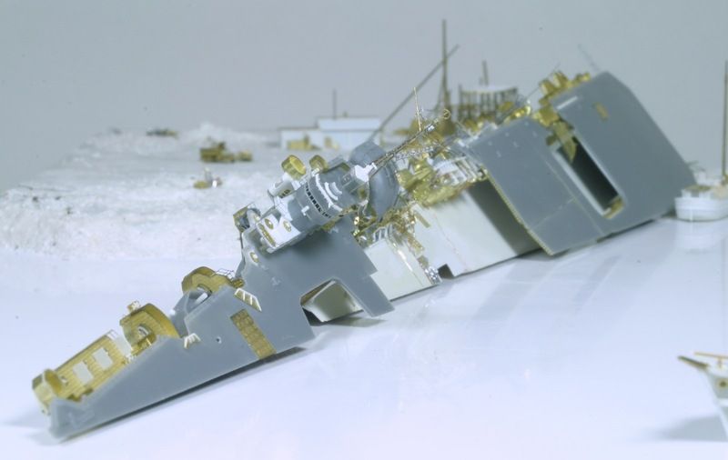

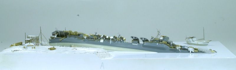

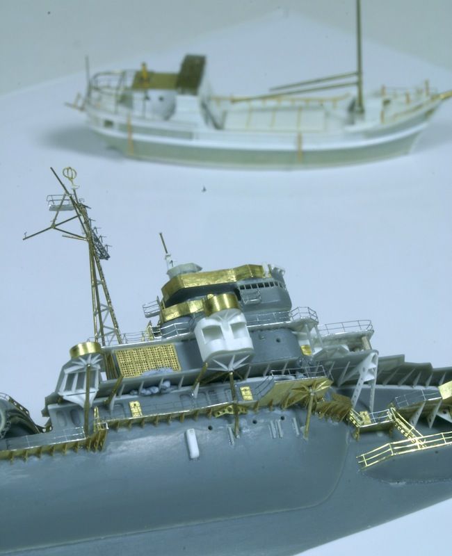

Many thanks guys!
It is 1/700 alright. :) A carrier in 1/350 would be just too much work for me… :)
I'm also really looking forward to seeing some paint on this!
But for now only some pictures of the complete diorama sans paint: :)
Cheers!
Marijn

Wow...
That is really incredible Marijn... absolutely no words. The damage looks already realistic, and that is without paint.
Unbelivable, I wish I can see your diorama in the future!

well..this is...hum...err...
i mean, is this even legal?????
fantastic to say the least.

Besides being perfectly executed to the tiniest detail, this diorama stunningly displayes perfect proportions and a very tasteful arrangement. It just doesn't get any better than this...

Looks amazing, you are doing a fantastic job!
Might be a bit early, but I wanna plant the seed for your next project, HMS Warspite when she ran aground on her way to the breakers yard. :thumbs_up_1:

This just raises the bar...and more than just one level too...

Yours is an incredibly fine piece of modeling, Marijn. Truly marvelous.

I don't know what to say!! It just couldn't get any better than this!! :thumbs_up_1: :thumbs_up_1: :thumbs_up_1: :thumbs_up_1: :woo_hoo: :woo_hoo: :woo_hoo:
What did you use to sculpt the land? It looks so good. Maybe I should stop guessing around and buy some modelling magazines! :heh:

This is exceptional work; a really great concept, and is being really well delivered!
I'll keep avidly watching with interest.

breathtakingly superb...!
paint... now that is where its at!
watching with great interest!

Many thanks George! As I see myself as a diorama modeller before ship modeller (or any other subject for that matter), this is very important to me!
But at the same time it is always challenging, as with modelling it is too easy to lose oneself in the details, and this especially true with ship modelling. And working from historic photo's can sometimes also be a trap to end up with a less than ideal composition...
Well, modelling magazines can certainly be helpful, but they also don't provide all the answers instantly... :)
Anyway, the basic height of the island was built up with a couple of layers of plastic sheet. Then I added a layer of Magic Sculp putty to get close to the actual slightly undulating relief. The 'soil' is a thin layer of a mixture of wood glue and ceramic plaster (just the dry powder, no water), in which varying amounts of grit (dried and ground ceramic plaster) was mixed to get a lumpy and textured paste. I kept it more smooth for the top surface and more 'lumpy for the waterside. Loose debris was strewn on top of this and fixed with watered down wood glue.
