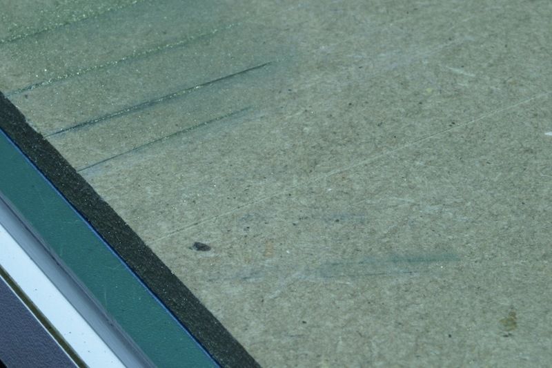

May I ask how did you manage to create conical masts? It is just dremel and sand paper?
Almost!

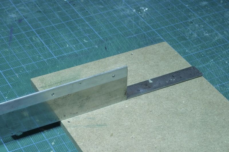

The problem with the Dremel is that anything longer than 1cm or so starts to twist and tremble, making it impossible to get nice and regular, or even any, results.
Jim Baumann told me this little trick in Telford last year: stabilize the wire in a small groove in the workbench.
My workbench is in the living room and I want to keep it in one piece, so I made the groove in a piece of MDF. I simply used a saw, guided by a metal ruler:
The groove is very simple and shallow, just enough for the brass wire to get caught in.
Behind the fresh groove, you see some used ones. The metal wire does erode the grooves when spinning, so I had to make several new ones. The upside to the MDF is that the brass wire doesn't heat up too much while spinning in it.

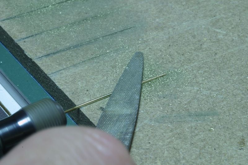

So then I spin the wire in the Dremel, lay it down gently in the groove, and press a file down on it (sandpaper glued to a thick piece of plastic sheet works well also):

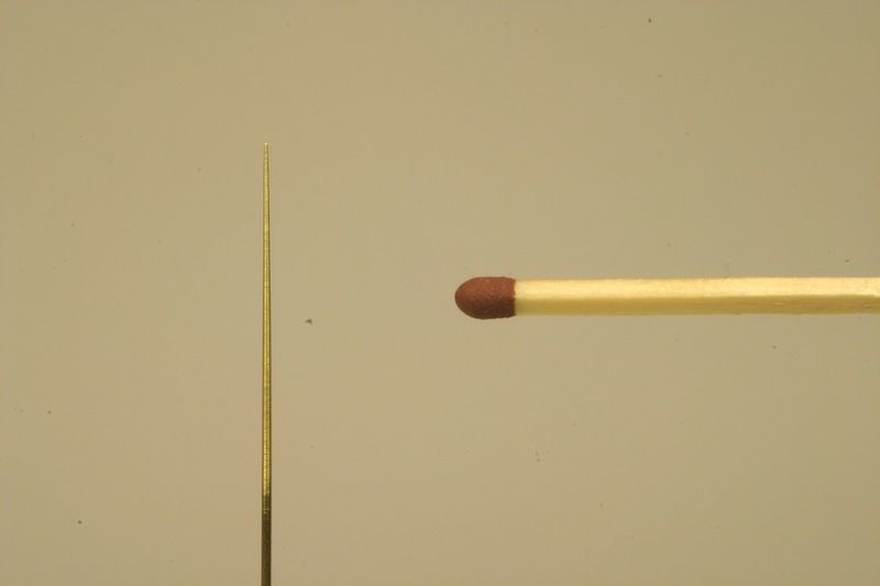

By moving the file up and down, and regularly checking the wire, this kind of results can be achieved:

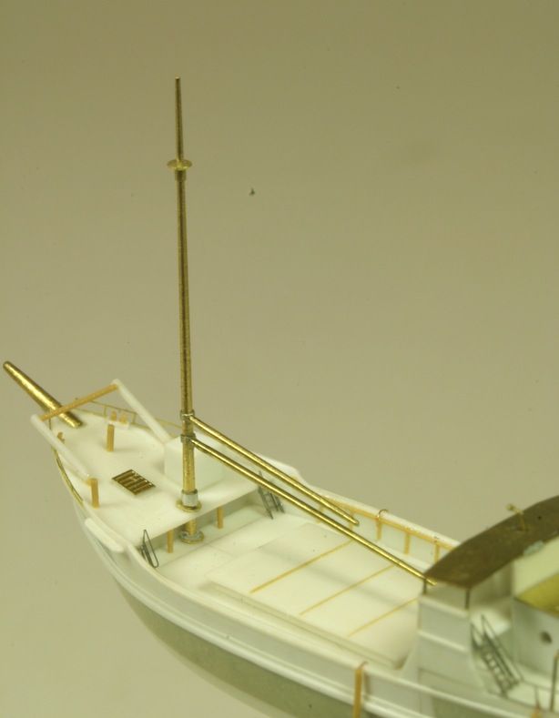

After adding some PE and tubing details:
The booms are also tapered this way, but to a lesser degree. I also added a small taper to them towards the mast by first turning the main taper, cutting the wire to length, turning it around in the Dremel and turning again.
I was surprised how well this technique worked, and how easy it was to get really nice results.
Just be careful with yours eyes; the wire can break at the fitting of the Dremel and get launched in the air at high speed.

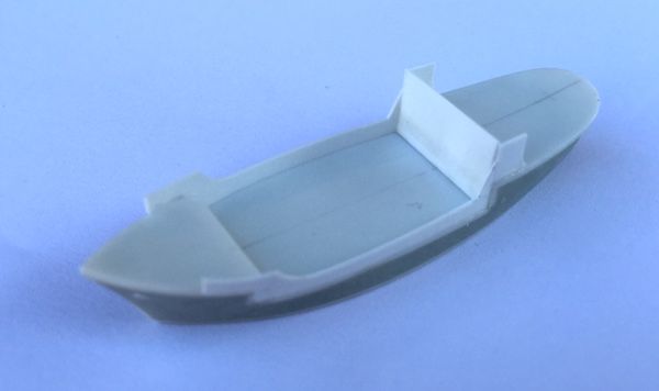

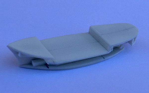

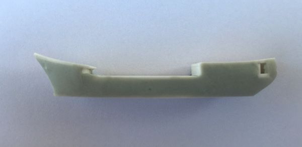

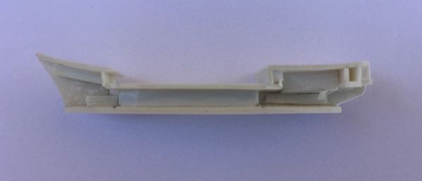

I first made a very basic frame for the ships from plastic sheet:
As you see, it is basically a waterline plate, the decks, and a longitudinal section in the centre to put the decks at the correct height. The rest is only framing for the openings at the stern, and re-inforcements.
For the two smaller ships, these frames were even simpler, as they only have one deck level.
The, I filled the gaps with Magic Sculp:
I prefer Magic Sculp, from my figure sculpting days, but any decent epoxy putty should work fine.
I sanded this smooth. Then I added the bulwarks, and sanded a bit more:
The rest is only a matter of adding details.
With the two smaller ships, the bulwarks go all around but the hull shapes are simpler. Therefore, I simply glued a skin of plastic sheet all around the hull after sanding the Magic Sculp. This was kept oversized, and cut and sanded down after the glue dried to the exact height of the bulwarks. Hence you don't see any Magic Sculp anymore on those two ships, but it is there under that skin.

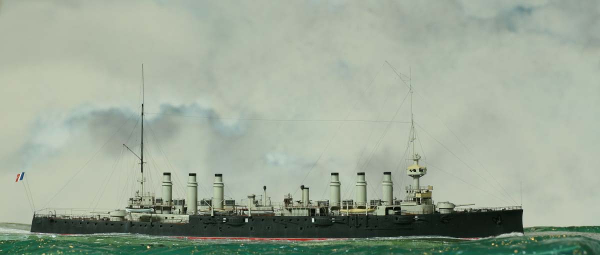

very very nice small craft!-- very fione weok
magic sculpt eh...--a favourite of mine too! )
I am glad that the mast making is working well for you using the grooves...)
for taller and/ or thinner tipped masts--
use stainless steel --
thin stainless welding rod is a good starting point
( I guess welding rod for mild steel would work also !?)
its sands even thinner finer and gives a much stronger springier mast
when lots of rigging is applied
even stretched sprue can distort if the masts are too soft ( and brass is twice as soft a stainless in this application)
these masts were made of stainless --and are very tall ( for 1/700 anyhow ! ) tall !
( 1/700 french cruiser Jeanne d'Arc )
