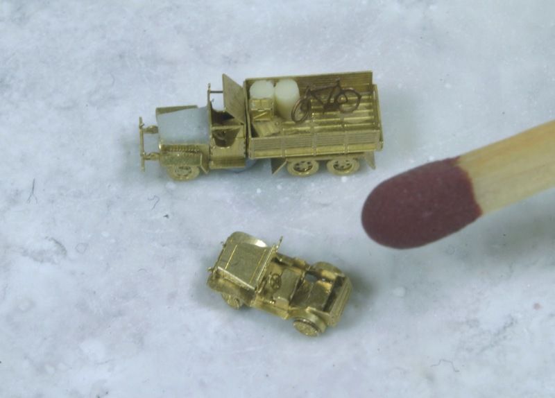

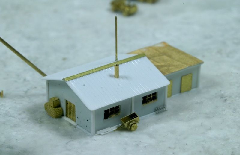

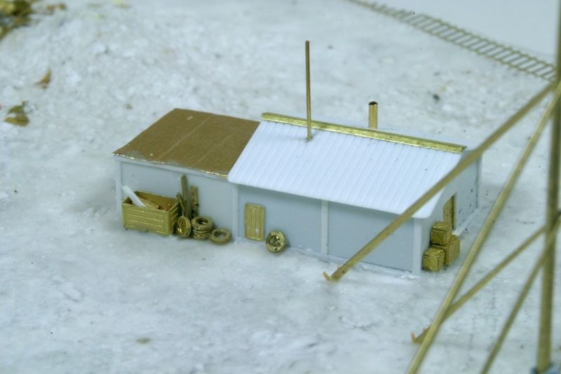

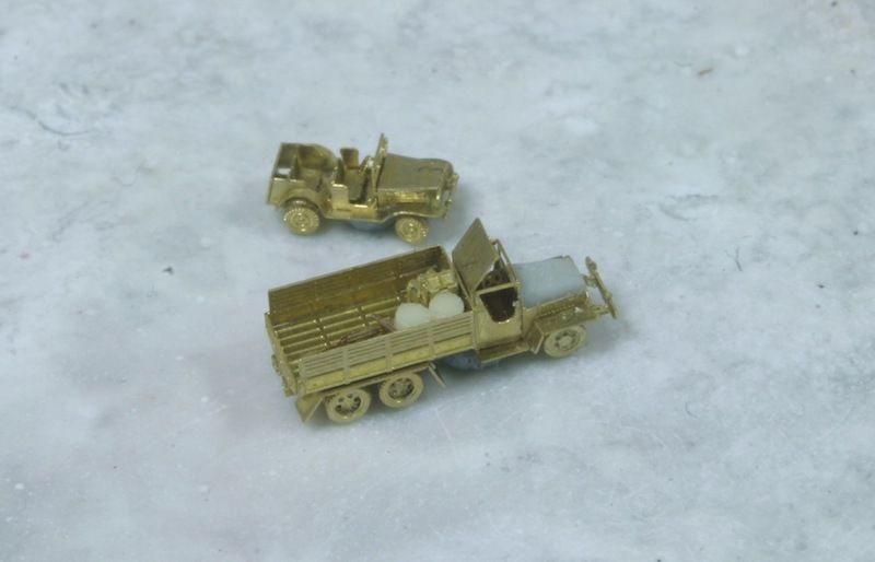

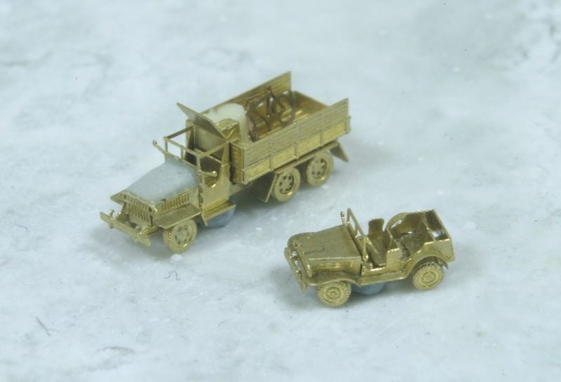

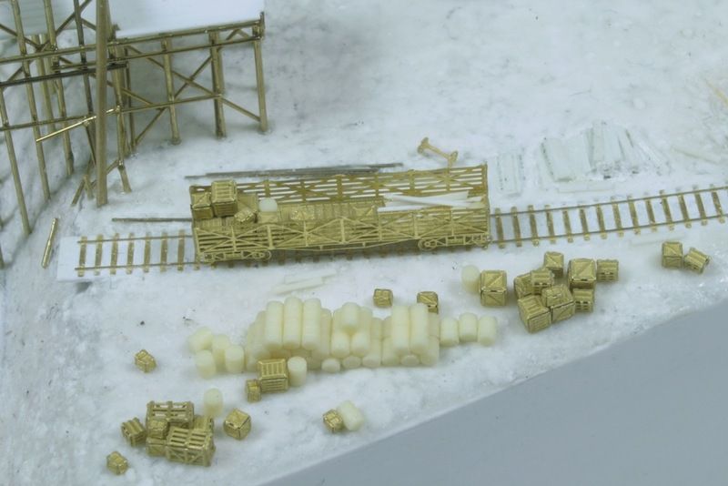

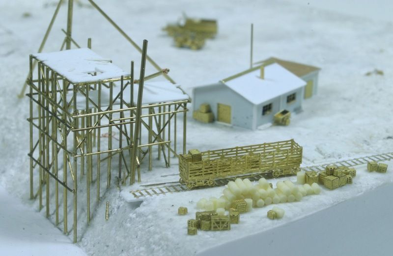

I haven't been very active over the last months, but at least I finished construction of the island and all associated details. I only have to add a small pier at the end of the railroad after the water has been done, and add some bumpers and hooks to the railcar.
The railroad and railcar, wooden crates, barrels, GMC truck, Dodge jeep and small trailer all come from 5star sets, which are all really great. The rest is scratchbuilt.

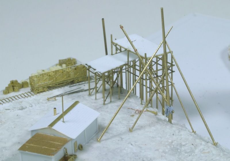

Please excuse the black smudges around the window frames. I painted the inside black before adding the roof:
The roof of the GMC's cab will be folded down after I paint the interior. Image
And the obligatory giant match! :) The bicycle comes from an older small Eduard figure set (thanks Joeri!)

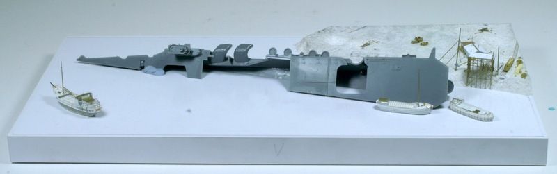

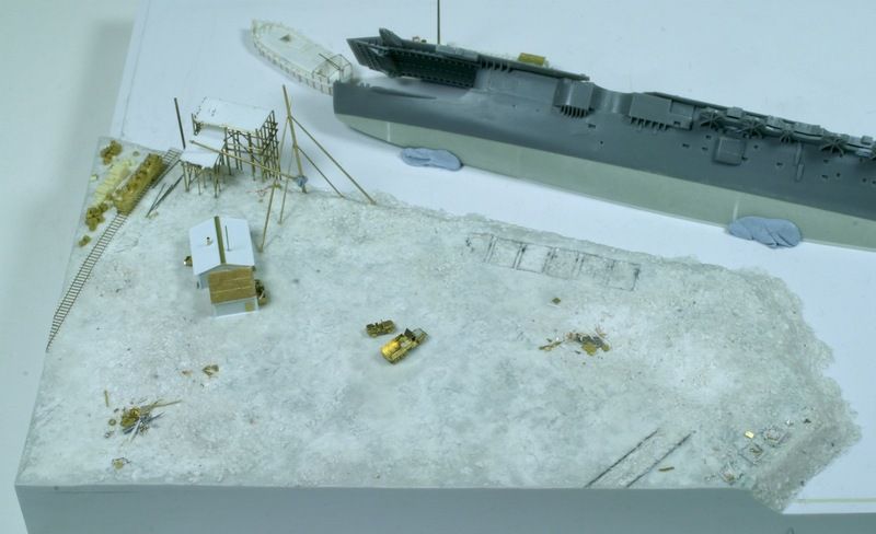

The entire composition:
Now I can finally get on with Amagi herself! :)

The scaffolding is scratchbuilt after the historic photo's, using brass wire and plastic sheet. It is actually simpler to do than the result makes one think. I first 'planted' all vertical beams in holes I drilled in the ground, then added all horizontal beams. After that the oblique beams followed, and finally the plank floors (engraved plastic sheet with the edges carved to make it look like individual planks).
The basic height of the island was built up with a couple of layers of plastic sheet. Then I added a layer of Magic Sculp putty to get close to the actual slightly undulating relief. The 'soil' is a thin layer of a mixture of wood glue and ceramic plaster (just the dry powder, no water), in which varying amounts of grit (dried and ground ceramic plaster) was mixed to get a lumpy and textured paste. Loose debris was strewn on top of this and fixed withwatered down wood glue.
