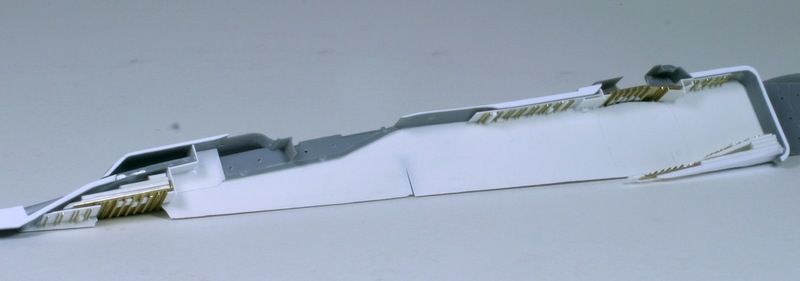

But first this one! After a couple of months of inactivity, I got myself started again on the Amagi.

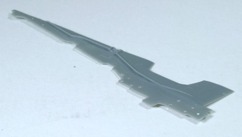

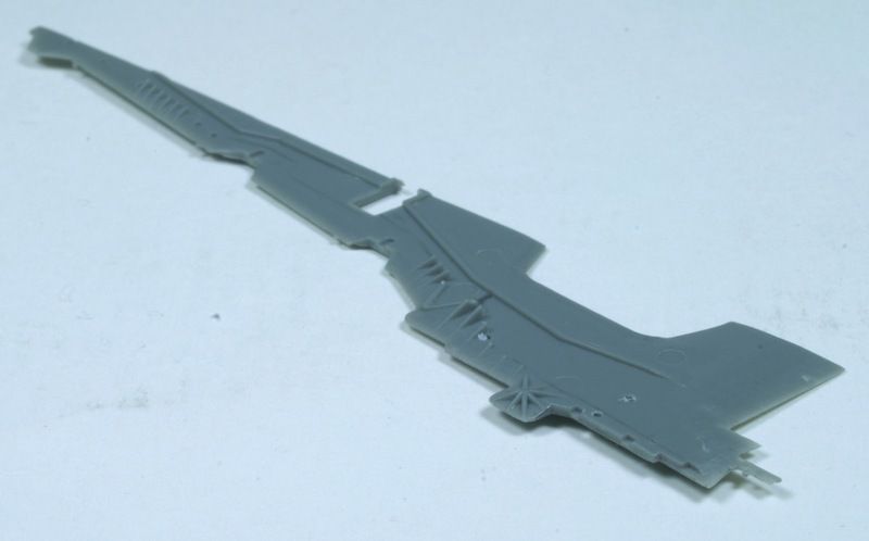

The underside of the flight deck has nice support beams and gussets molded on. The edge is nicely thin, but this necessitates a chamfer for the deck to molded:
But since I want to replace all beams and gussets by perforated ones, I cut them all away. The chamfer would hinder correct installment of those, and might be visible because the ships is tilted so much. I therefore thinned all visible flight deck underside surfaces, both on the side and the stern:
To compensate for the removed thickness of the deck, I added 0,5mm plastic strip to the top of the hull. I also thinned any hull plating that will be visible from the top because of the battle damage:
A lot of cutting, scraping and sanding, but not very sexy so far… :)

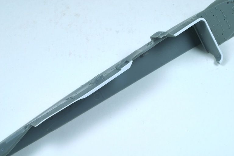

Then I added the top hangar deck, making sure it would be strongly supported:

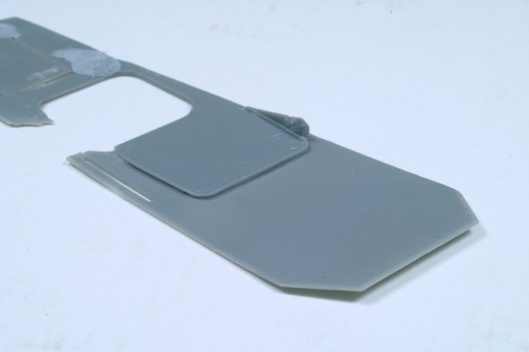

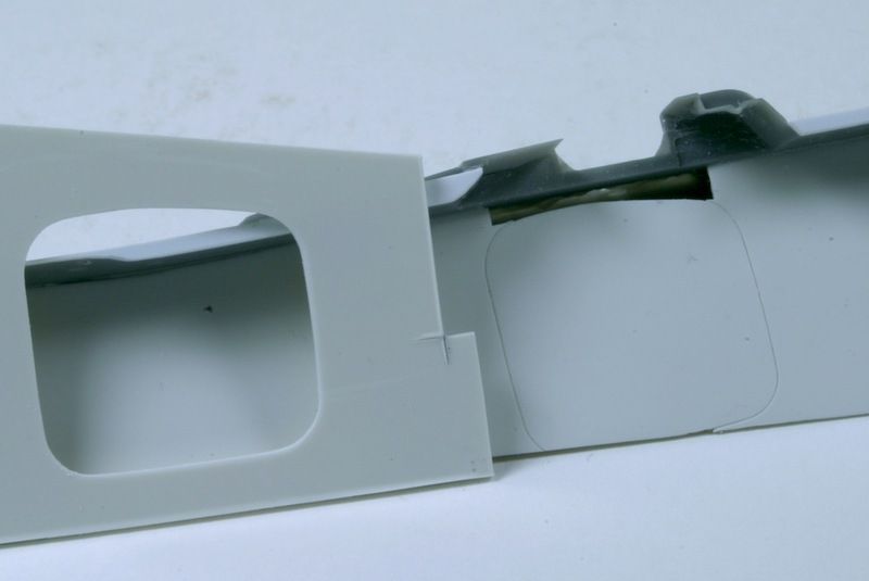

Before gluing the deck, the seam around the aft elevator was scribed with a needle. To get the curved edges right, I had to make a template from plastic sheet:

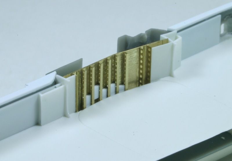

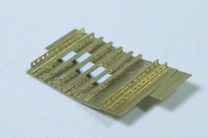

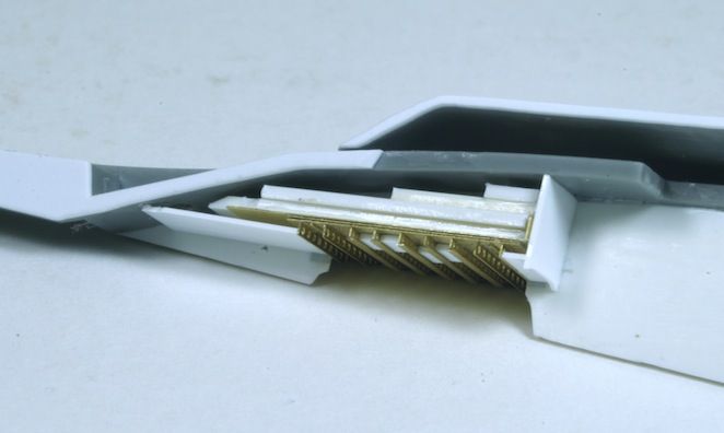

Bruno Gire designed a great additional PE set for Amagi in this setting, and graciously supplied me with copies. Many Thanks again Bruno!!!

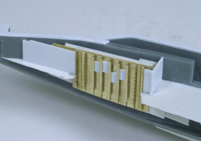

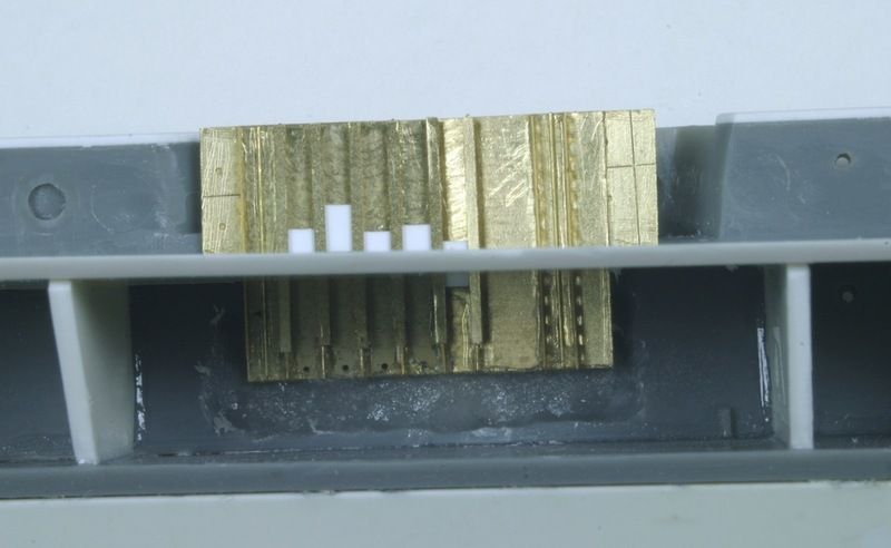

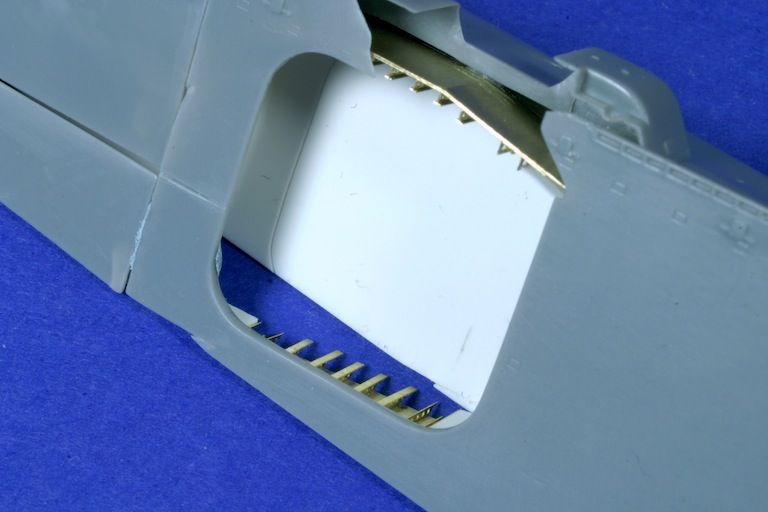

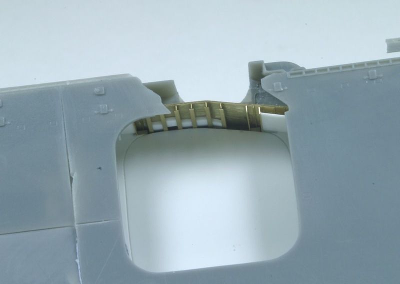

The starboard aft elevator mechanism is a bit different from standard because it has an angle in it, so I cobbled it together from pieces of Bruno's set and some generic pieces:

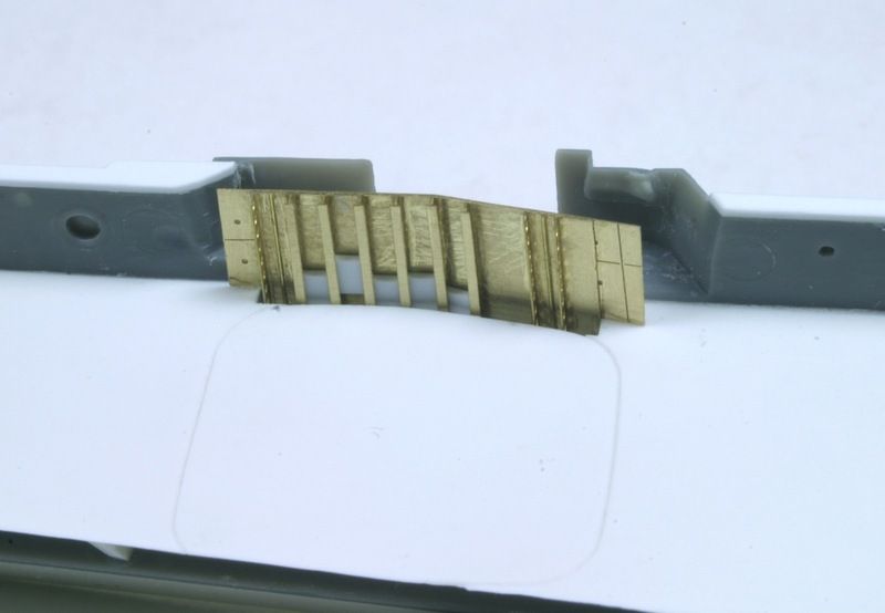

This was glued into a cutout I had made before in the deck:

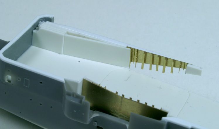

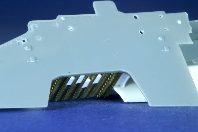

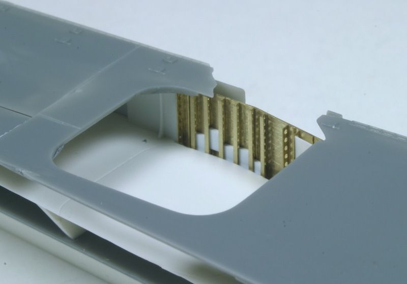

Lower down, the fit became quite tight, necessitating me to thin the hull side with my Dremel:
Next, some additional structures were added:
This is how it looks like when the deck is on:
The space behind the elevator side wall will later be filled with heavily damaged compartments, since a bomb demolished this area.
But first two more elevator sidewalls to go!

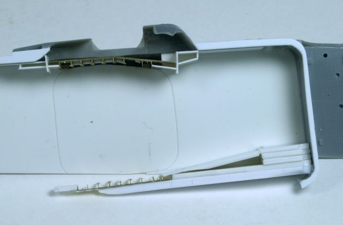

Meanwhile, I also did the other elevator well walls. This was a bit more of the same, but it only took a bit more time and care to get everything lined up properly to how the ship is waterlined.
The port side of the aft elevator well:
It should look a bit like this with the deck on and in the water:
The only visible side of the front elevator well. The front elevator went down to the lower hangar.
Some of the supporting plastic sheet is quite crude for speed of construction, but of course only where it is not visible with the deck on:
