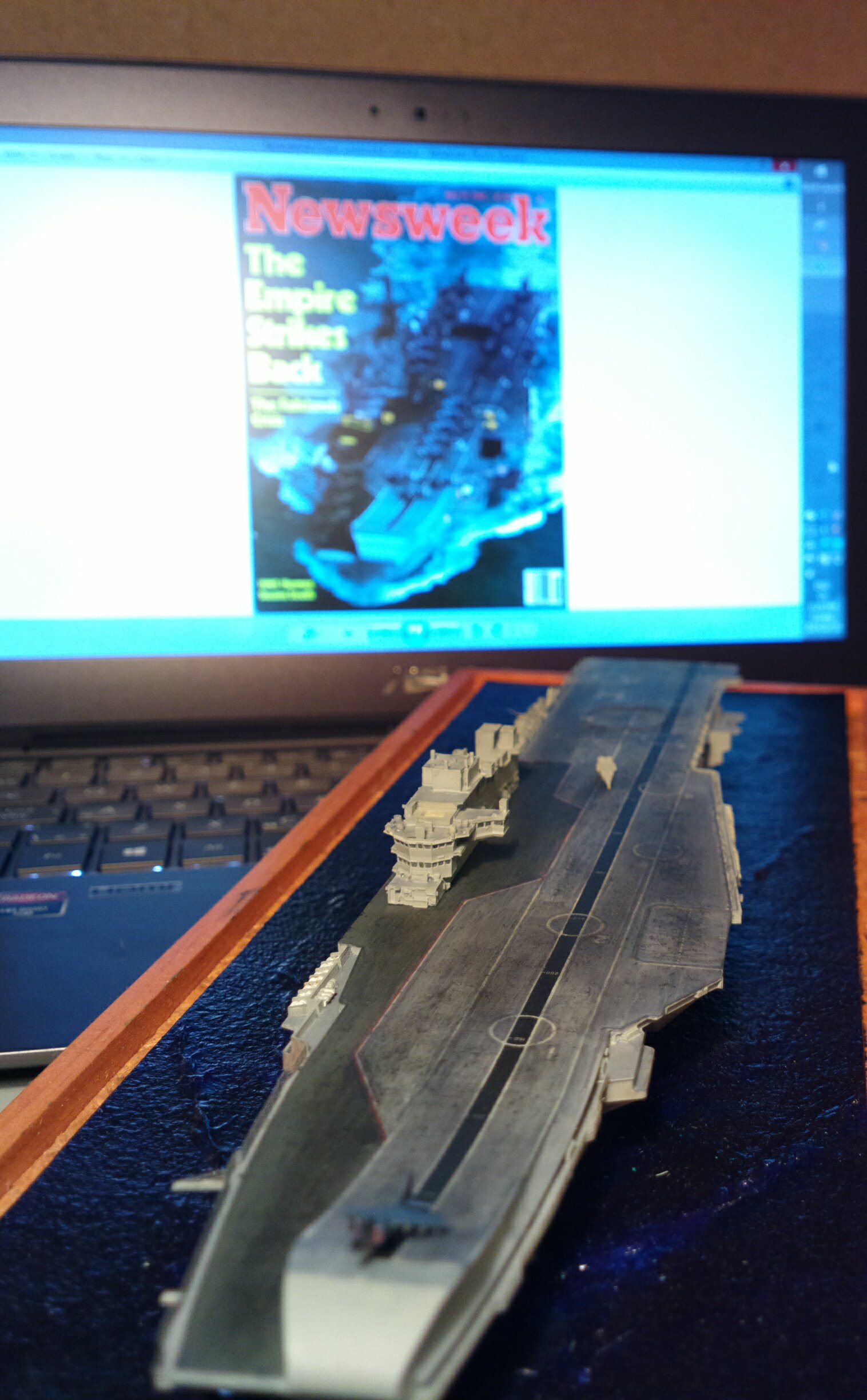

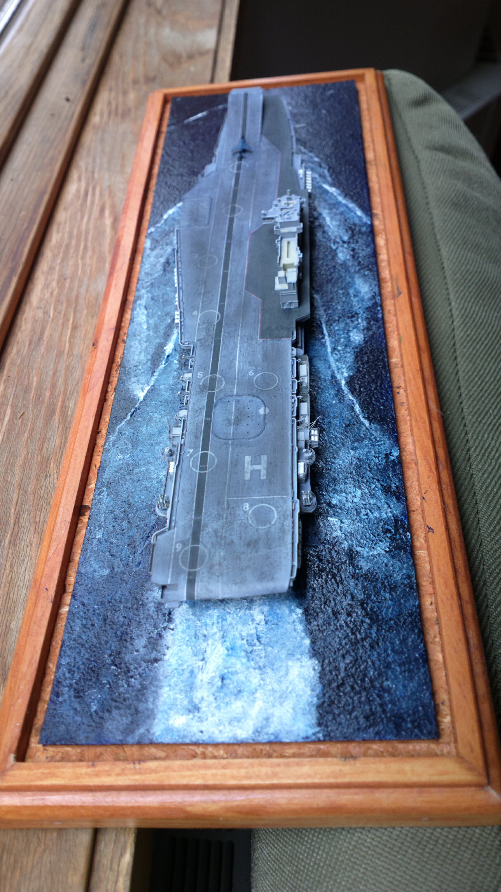

An update! Glued her down and finished the water:
It's no Chris Flodberg, but a big improvement over my previous efforts. Used a lot more thinned paints this time and experimented more with mixing colours.

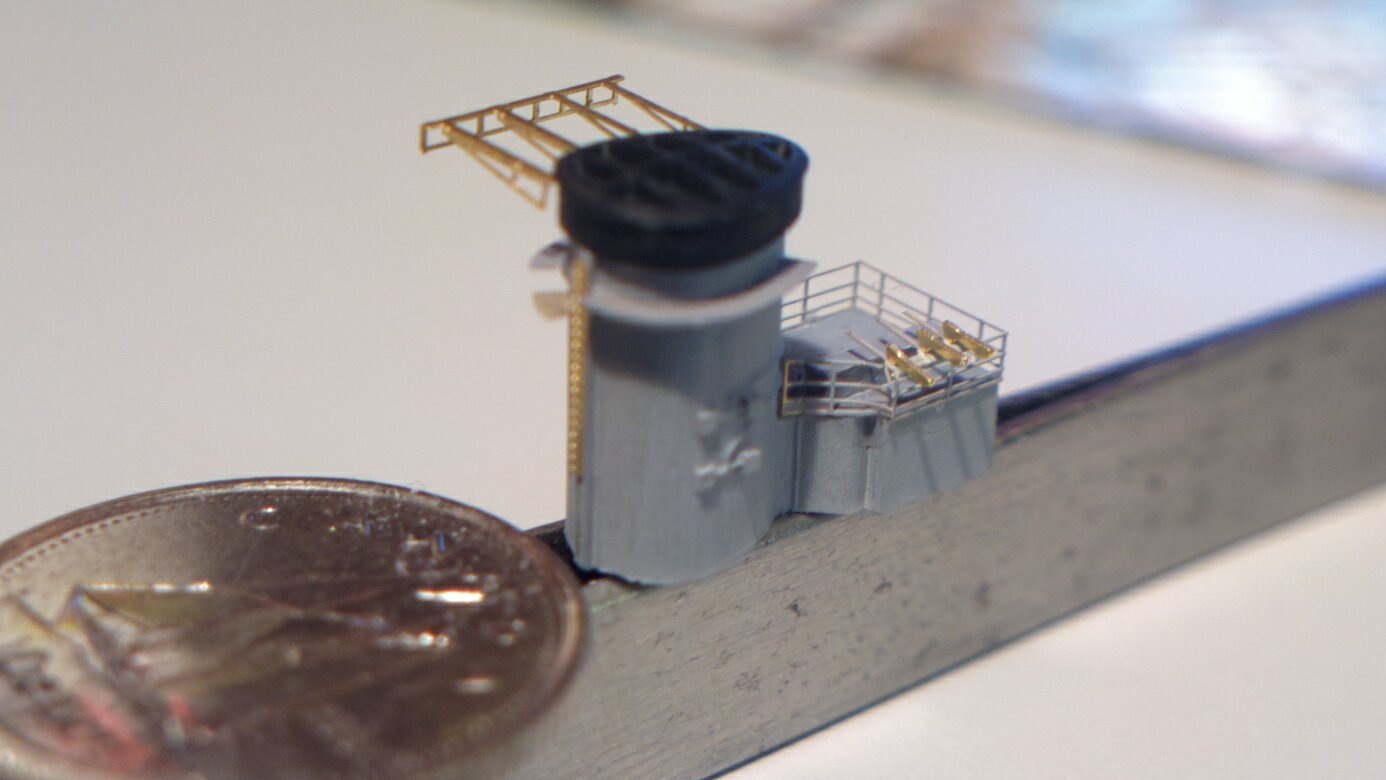

Latest progress from last night: started adding PE to the island, beginning with the funnel. I'll probably regret this later, but I plan on painting the PE after they've all been attached - the aesthetic of all the shiny brass is too tempting to ignore!

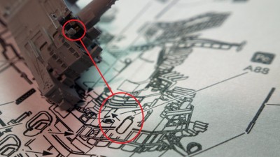

Incidentally, this is how you know they completely forgot about a piece until all the instruction were done.
PostPosted: Mon Jun 16, 2014 1:46 am
Posts: 12335

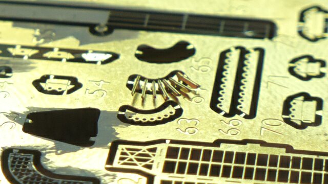

Wrapping up the evening:
File comment: The secret to getting the damned things on!
File comment: I don't know how I'm going to paint this.
PostPosted: Mon Jun 16, 2014 2:22 am
Joined: Thu Aug 05, 2010 5:40 pm
Posts: 234
Location: Dalgety Bay,Scotland
Wish l had done it that way ,l sprayed my first,took a long long time to do :scratch:
Yes that hatch was the only piece left,l found another hatch missing,used one from my spares box,will post a photo,also there should be railings around the walk ways on the funnel which they missed,but that's the only item l found .
