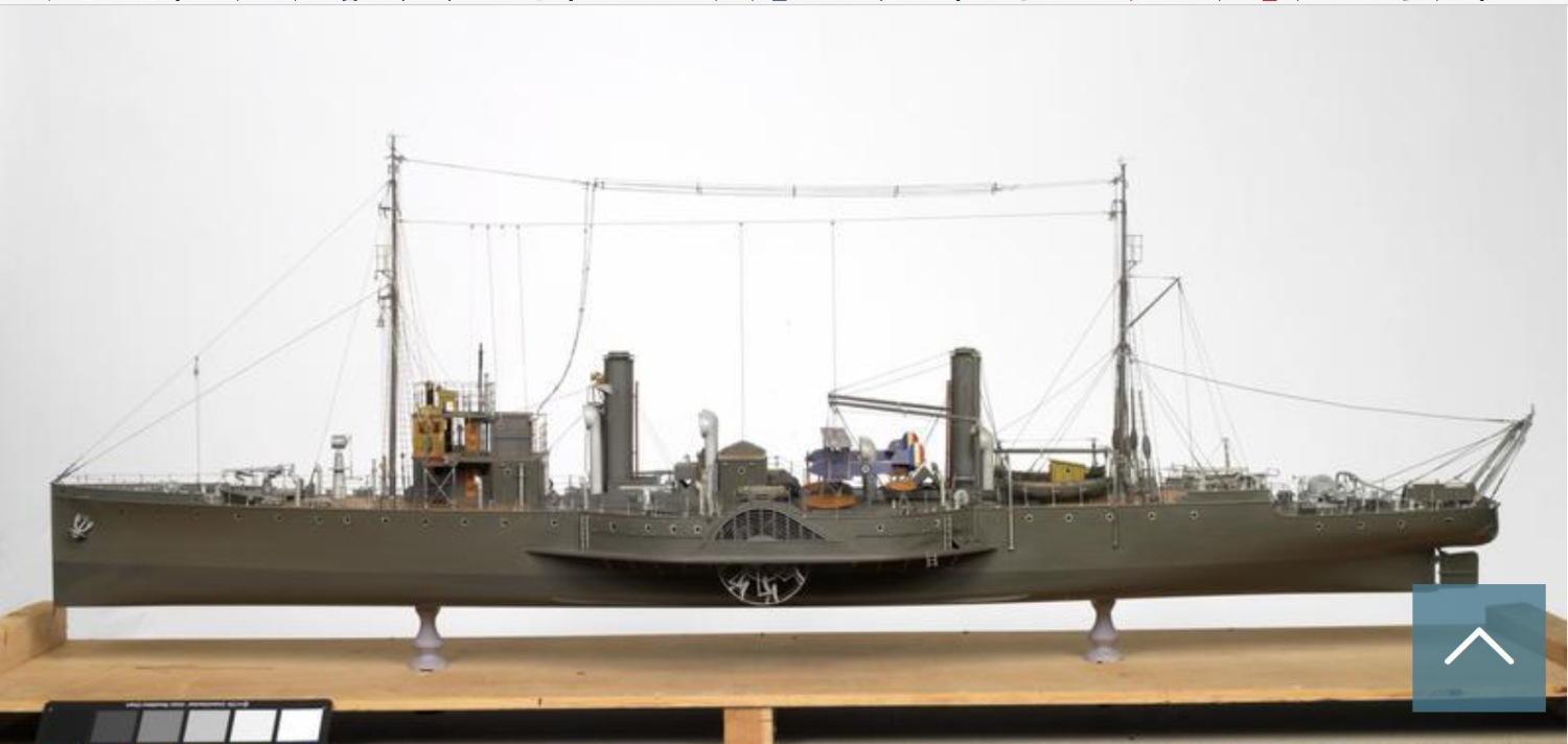

She is the only ship of the class for which I could find a photo which had the pilothouse left as a panelled unpainted wood structure
( as per the side elevation image of the IWM model of HMS Ascot ( alas in IWM storage...)
and the above image

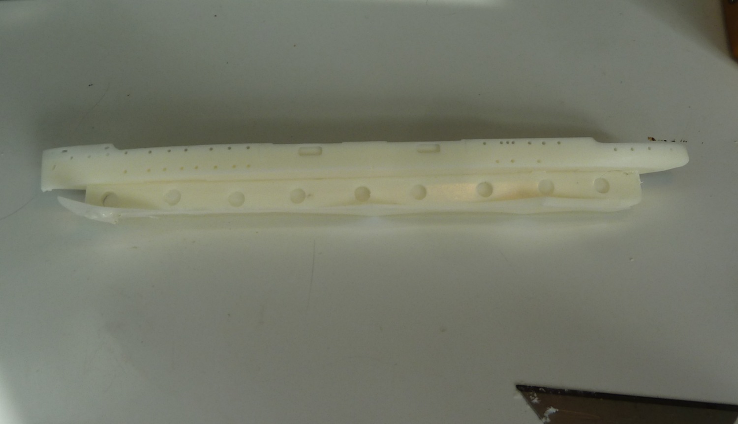

First job was to remove the huge casting flange block on the underside

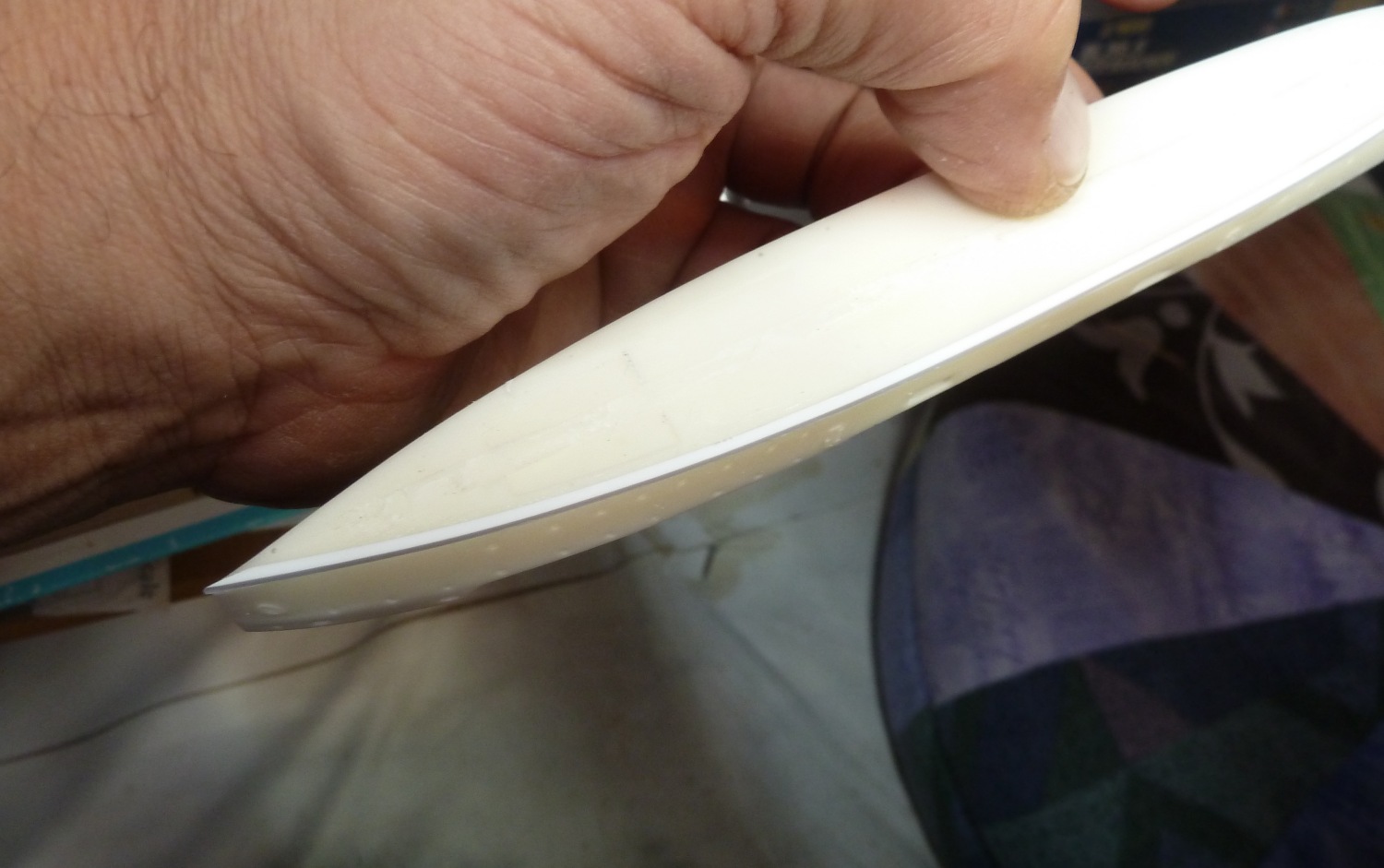

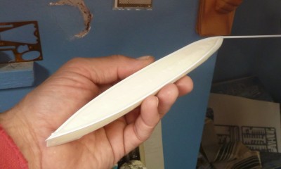

To be able to portray a ship at speed I always add a layer to the underside , so as to be able to have the underwater portion showing midships in the typical displacement wave pattern of bow wave, stern wave and a hole in the middle!
Lacking a huge plank of styrene--- I used some square section evergreen
It gives a stable base and a sharp guide line for the underwater portion of the ship
Some of the parts have been rapid prototyped -digitally printed I think-- some of the smaller structures showed the typical Layer ribbing on the flat surfaces, r
removed with a quick pare of a Stanley blade
The hull also had some marks of that ilk I think ( highlighted here with Graphite dust

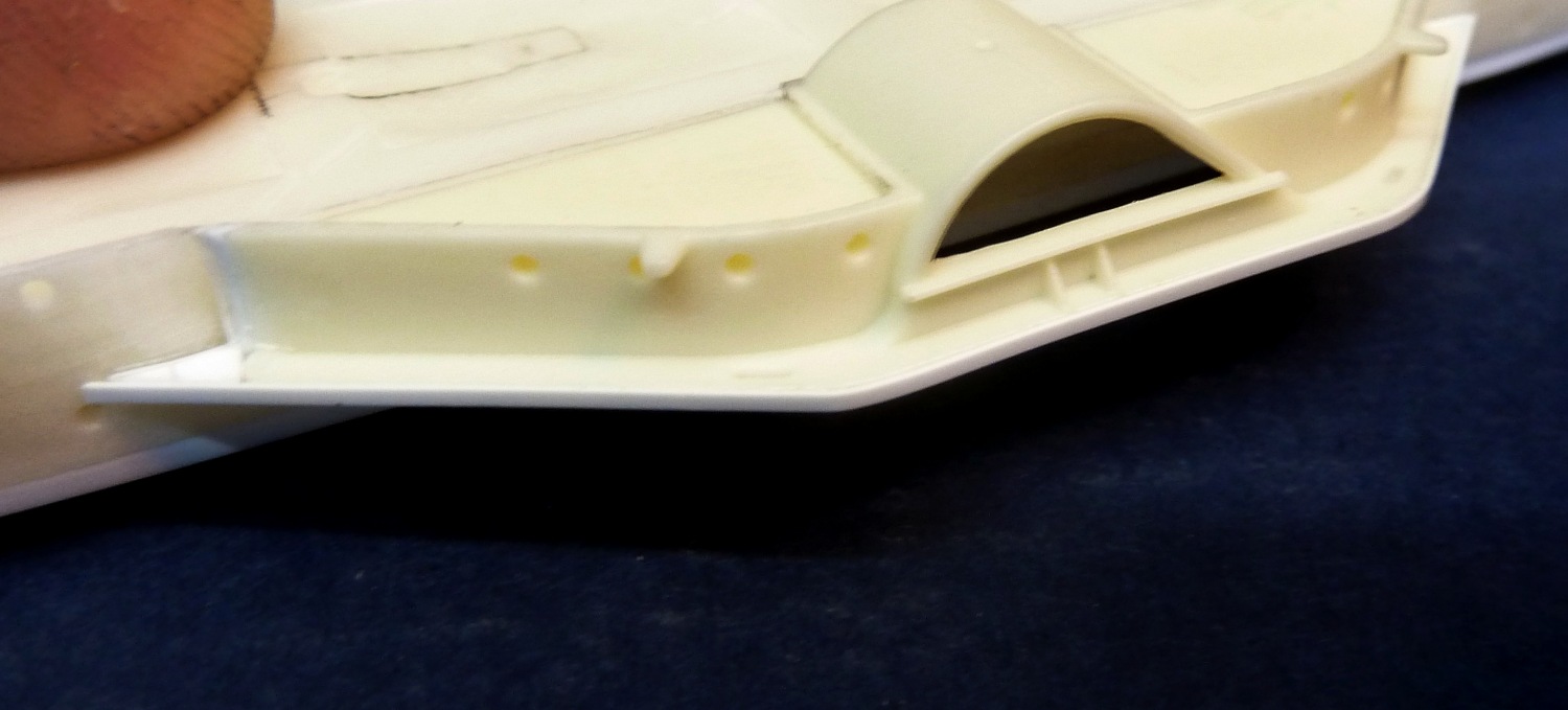

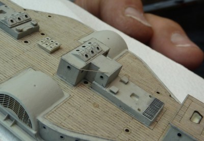

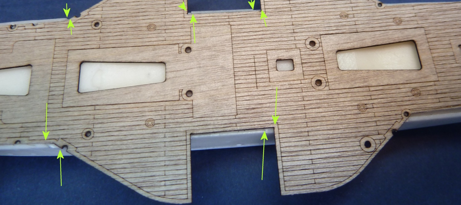

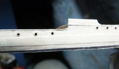

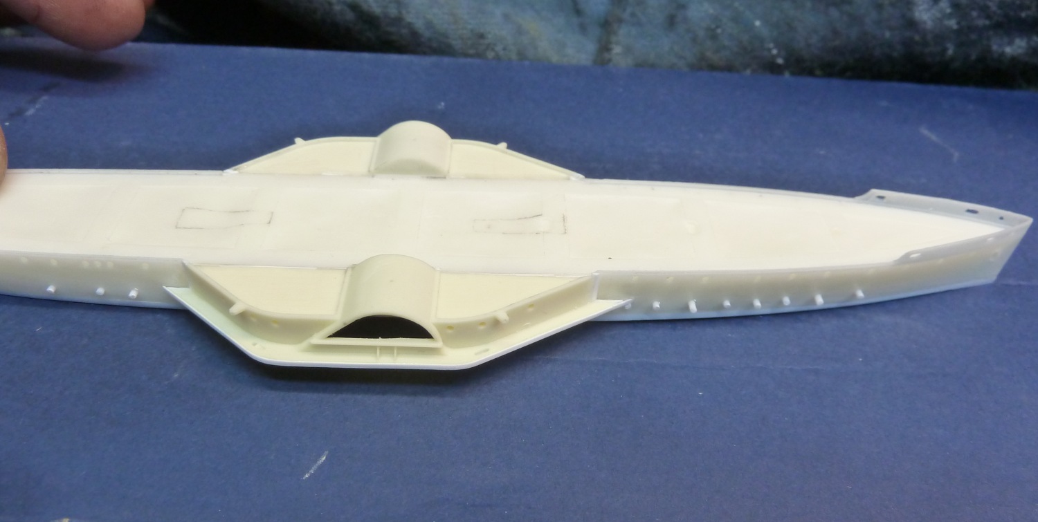

The first thing thereafter I did was to check the wood deck fit....
which alas was not entirely ideal, being a bit over-length on the weather deck and over-width on the paddle boxes.
The fore and aft location I optimised by removing a bit at both extremities, the lateral width problem was not as easliy re-solved-- as the margin planking even if partially removed would have looked odd.
I elected to shim outboard the paddleboxes, and build up the angled planes fwd and aft--
quite fiddly with much checking the deck against the unglued paddleboxes and for symmetry
( small tabs of double-sided tape on the paddleboxes and a sharp pencil were the key method!)
My paddleboxes had a casting offset on the inboard side- my shimming was not pretty
The enlargement of the fwd and aft facets were made piecemeal with strips of styrene

The challenges continued!
getting the paddle boxes to align athwartships correctly relative to the fore and aft position versus the enforced compromise of the deck...
The useful position blocks I reduced in size to gain fore and aft wiggle room ( in fractions of a mm albiet! )
--along with the cast on paddle box access doors--I shall replace them with PE items
It is possible that my hull's resin may shrunk slightly?
either way I had fit issues with the deck v. the hull
Nothing insurmountable
but more time

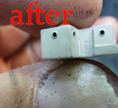

I was not completely happy about the edge of the rubbing strake around the paddle box,
as such I sanded it down in size to a squarer edge to allow me to make a crisp and tidy job
of the whole e thing once the boxes were installed with a strip of thin styrene strip

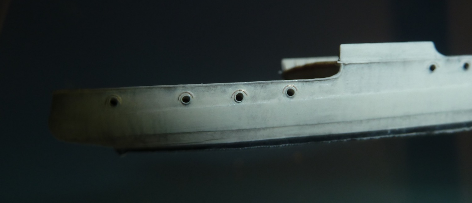

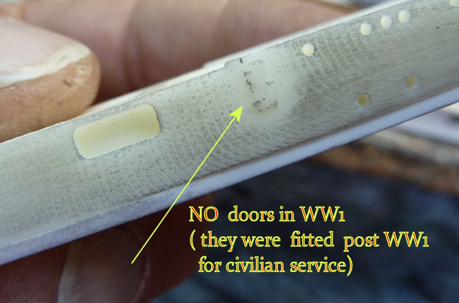

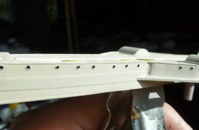

Infuriatingly --after staring at photos--I realised that there was a bit of an issue again with the portholes... (!!)
It seems the same hull casting was used for the WW2 Thanet version of the kit as the WW1 Ascot version...
Aarghhh!!
As a Navy built ship she had an upper row of portholes only
the lower portholes were added after WW1 in civilian service...
here is Athelston in her inter-war pleasure steamer guise as Queen of Kent- with lower portholes
and as its should be in WW1....
as can be seen on the Ascot builders model and every other image of the ship in W1 service... ( see image in my previous posting)
Hmnnn...
so this is the current status quo-- "HMS Porcupine..." :cool_2:

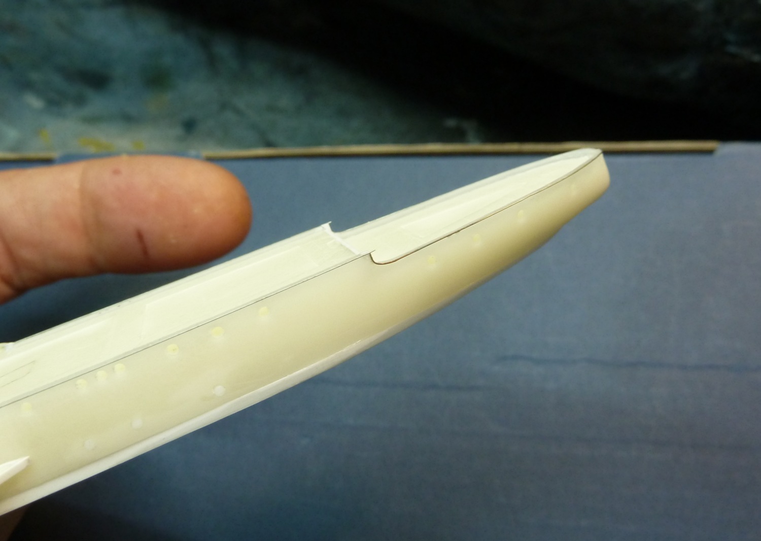

The kit rather disappointingly seems to have issues...

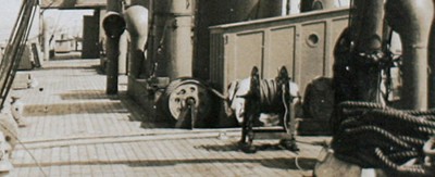

...a minor issue is that the forward hollow tumble-home is insufficiently deep
the real thing has rather more than the kit ( photo courtesy of screenshot of IWM image )
I shall at this stage live with it ...and use some subtle shading to accentuate the slight hollow tumblehome that is there

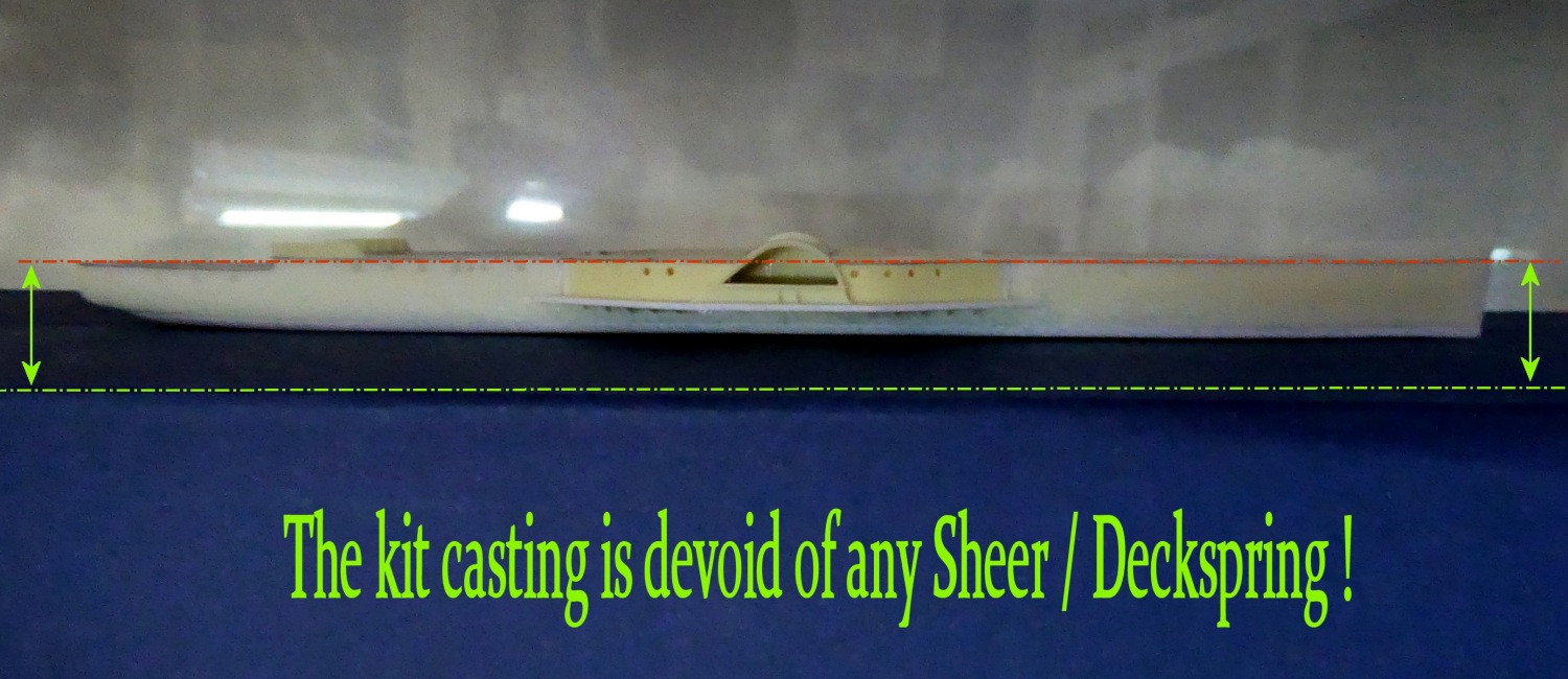

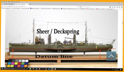

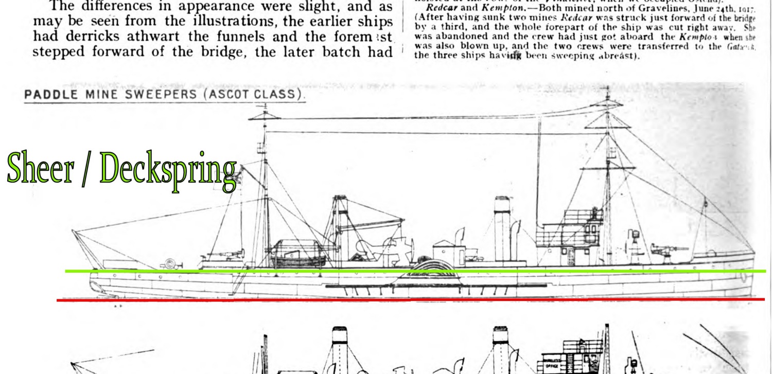

A rather bigger issue is the virtually entire absence of any sheerline ( deckspring )
The real ship and the builders model demonstrably have quite a bit
The model sadly quite evidently does not have any discernible spring
Fortunately I have devised a cure...
will report after the cure ( or destruction!)

The best of luck with that... a ship without sheer just looks wrong.

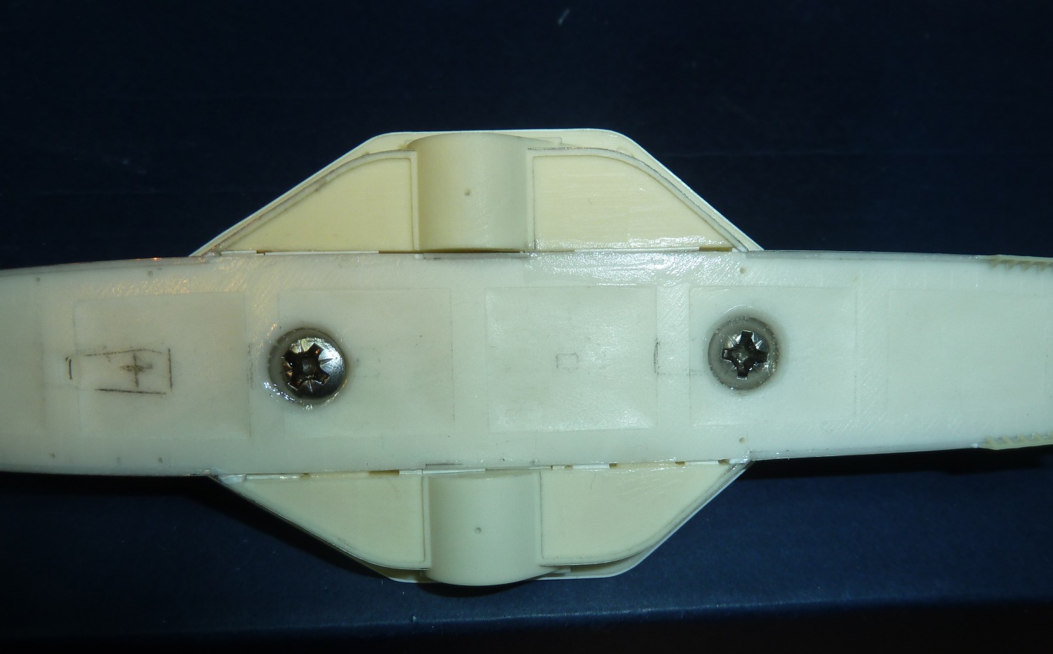

well here is how I did it.

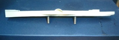

I drilled two 5.5 mm holes in the ship, countersunk the holes deeply enough so that
the bolt-heads were below the deck level and installed 2 x M5 stainless steel bolts.
I ensured I had clearance for 'wiggle' room as well not risking the resin hull casting splitting ...
These were glued in with epoxy from underneath and flooded with CA from above

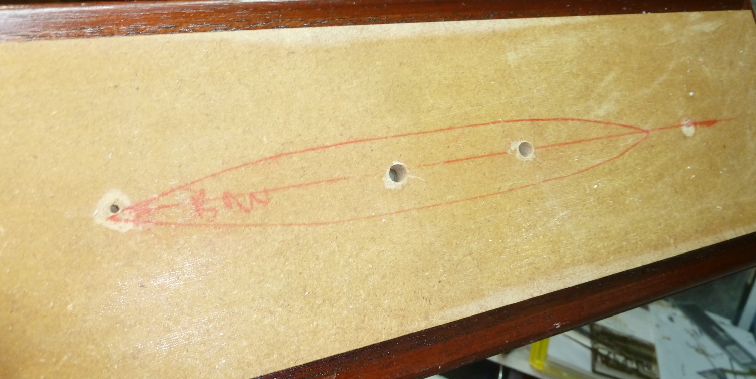

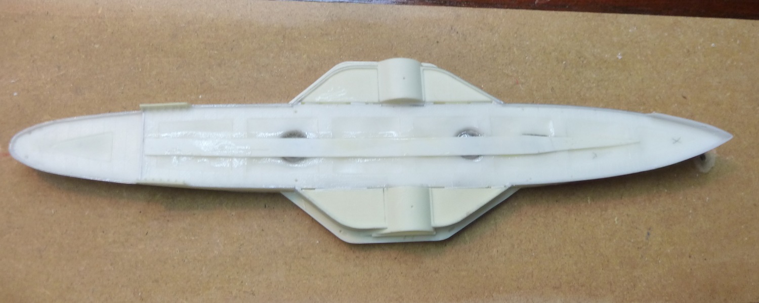

I took the base of the glass case--which is made of solid mahogany framing with an MDF insert.
I drilled matching 6 mm holes
The rise and fall of the displacement wave pattern and the bow and stern wave was laid out with cocktail sticks glued in place
This was covered with artists textured watercolour paper ( as per my usual method described in much greater detail here)
link: viewtopic.php?f=4&t=37223

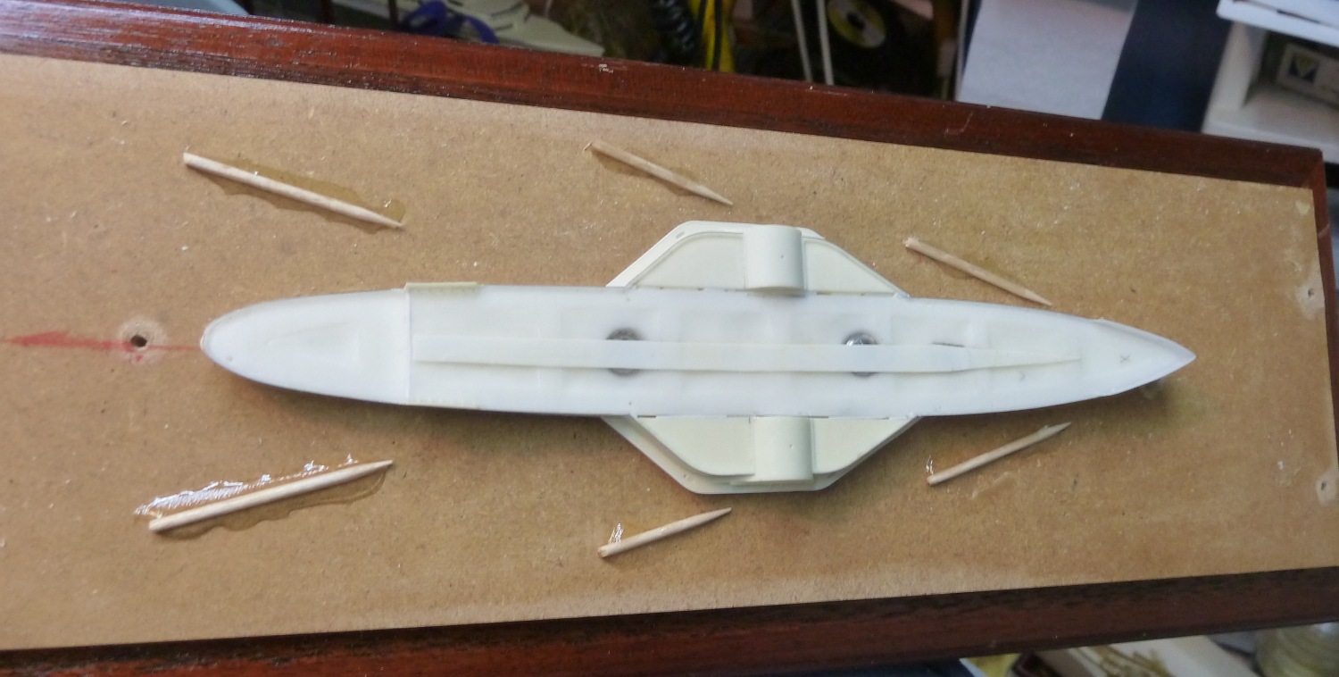

Fortunately I had previously added that thick square strip of styrene along the perimeter of the hull to give some waterline play
I sanded this out ( carefully!) so that at the centre of the hull the the styrene was sanded away almost completely,
then tapering out evenly fwd and aft-,with more material removed from the stern
than towards the bow ---
==> which needed to be higher with a more pronounced sweep

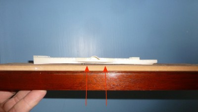

Placed on its base without the washers and nuts drawn up on the underside,
it looked like this, evidently showing the hollow that had been created
Once the nuts were drawn up
[b]( and every 1/4 of a turn allowed me to 'tune' the sheerline to my liking)[/b]
The hollow was sucked down with the nut tension and the result was that "we " now have a sheerline ,
that looks akin to the photos of the real ship as well as the builders model.

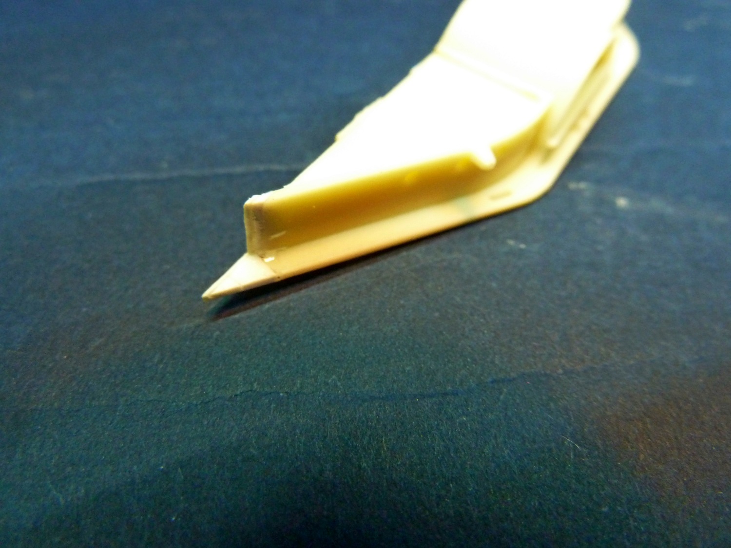

So as to create the deck-camber --which is noticeable on these ships
I added a thin strip of styrene down the centreline of the casting
The wooden deck will be glued down at both outer edges--
very gently curving over this centre spine,
==> thereby giving the desired deck camber :smallsmile:

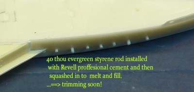

After that slight setback of changing the hull shape...(!)
I added the distinctive and visible deck-edge strake, made of thin copper wire,
this was surprisingly tricky to accomplish neatly

How did you go about attaching the deck-edge strake? Simply a lot of pre-bending to get the wire strait and conforming to the curves, then gluing section by section with superglue while adjusting the wire as you go? Or is there more to it?

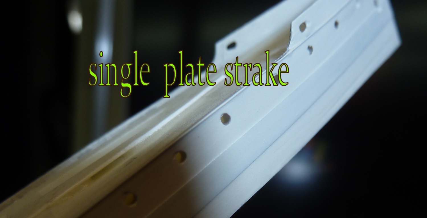

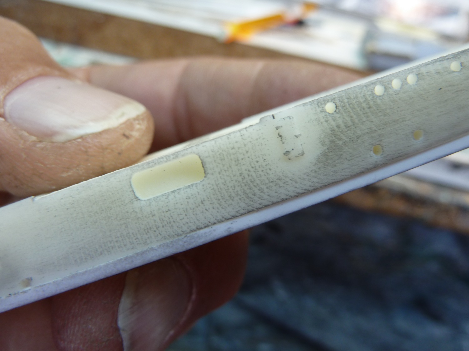

I was a little bit bothered about the " flatness" of the hull; certainly plating runs are visible in some images.
I concluded that sometimes less-is-more and rather than emulate complete plating - which easily could look too busy-
-I opted for a single run
I was next bothered by the lack of sharpness/ definition of my potholes
certainly these had a profile--which in model-form--would help define them

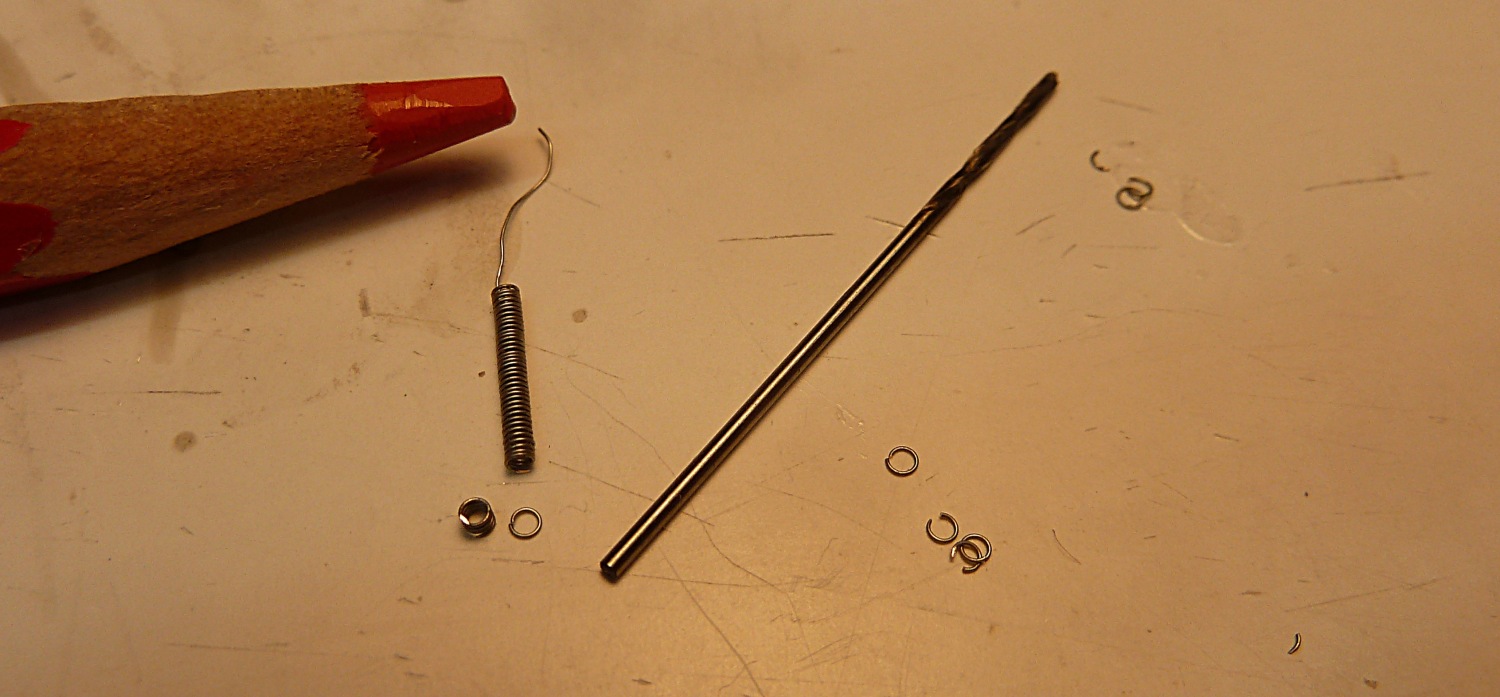

I started making porthole frames of thin wire --this was formed into a spiral ' spring' around a drill shank,
then cut off in sets of two,
then halved to make circles.
...........tedious --but strangely... satisfying!
once installed it looked a bit more pleasing
I know I know-... :thinking: -albeit it overscale--but in the overall perception of the model by the viewer...
( I hope ) it will blend...

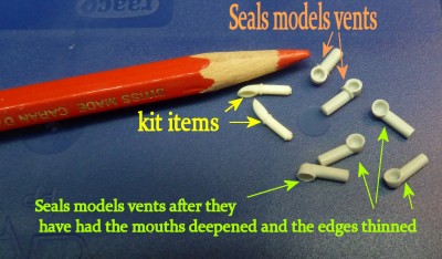

meanwhile cowl vents....
The kit supplied items to my eyes are incorrect in shape--being too oval in the mouth.
I have started preparing some spare plastic items of the correct ( ish) diameter
I shall mount the cowls on piece of brass / copper/ aluminium tubing for the various heights
My apologies for no response yet --
I did not pre-bend the wire per se-- I straightened and stretched the copper wire ( tinned 38swg) between pliers for each length.
I attached one enc with CA--and with the hull supported on its side ( tricky with the paddle boxes! ) I then laid the wire down and tacked it on with CA
I eyeballed it to straight--and the infilled with more CA from above--ie deck to strake--this filled the ' valley' twixt casting an wire.
afterwards with 1500 grit gave it a light sand from above to make flat
HTH

I had removed the cast on doors each side of the paddleboxes early on for my convenience ( to ease the adjustment of fit)
however closer inspection of photos shows the doors to have been fitted inter-war for civilian service ease of access
The paddlebox surround platform access being via ladder in initial WW 1 naval service
