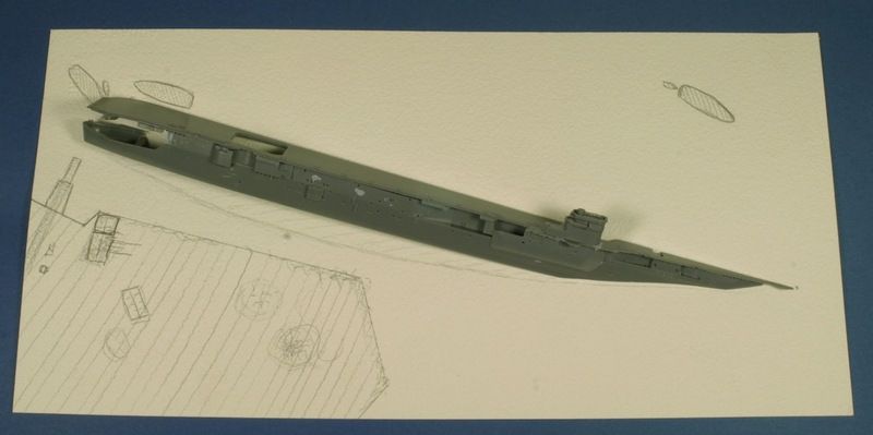

Humble beginnings:

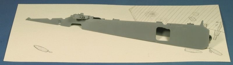

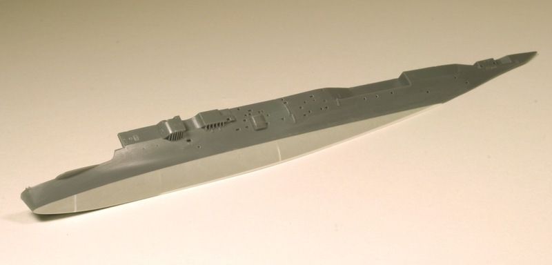

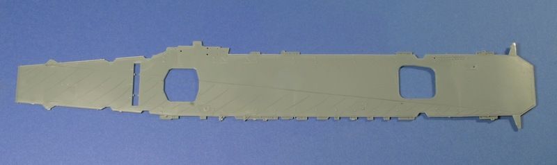

The waterline was marked on the flight deck part:
The flight deck was cut 2mm below this line. According to this, the hull sides and waterline plate were cut and joined. These were then temporarily fixed to the flight deck with a small amount of superglue and a lot of Blue Tack:

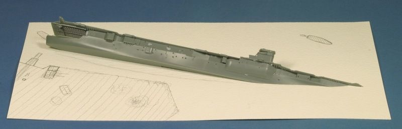

Now, this was sanded on a flat surface until I got the correct angle. I was I had a belt sander…
With the island tacked in place, this was enough to figure out the composition:
So, the creative part is finished, now I just have to build it! :)

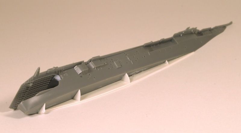

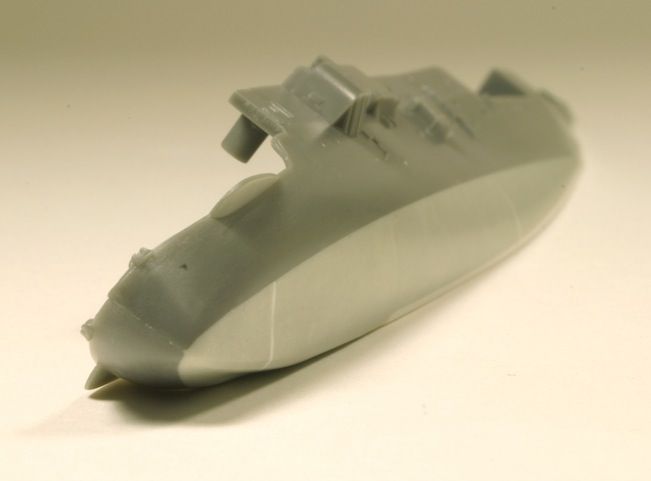

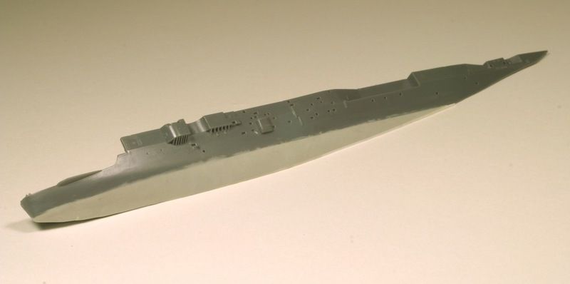

Well, the first job was to reduce it to a single waterline. But not the regular one of course…

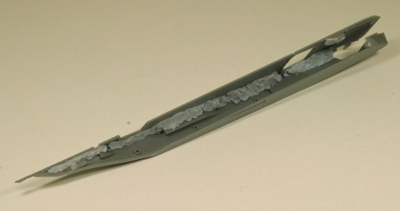

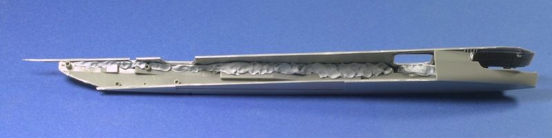

For building the missing piece of lower hull, I took the section drawings on page 99 of this book on the Soryu and Unryu classes in Russian (many thanks Peppe!):
I scaled them, and transferred them to plastic sheet. After cutting the excess for the position the ship is in, I could glue them on together with a new waterline plate.
Then I filled in the empty spaces with Magic Sculp epoxy putty, slightly oversized. I again detached the flight deck for this.
And sanded the lower hull down until the correct shape and smooth:
Cheers!
Marijn
