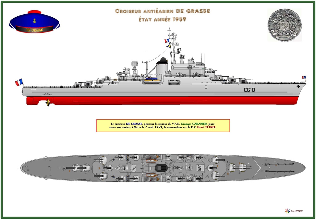

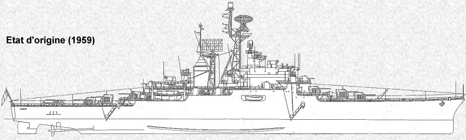

ok...new warf being opened...the French light cruiser "De Grasse"
she's a remarkable ship..starting construction in 1938 as a relatively classic looking light Cruiser with 9 heavy guns ...stopped because of war...re-defined as a Carrier by the Germans...stopped in 1942...after war in 1946 re-started...stopped again and finely finished in 1956 as a AA ship primary...
Not many war ships started in 1938...lived 18 years until sunk or broken up... for the De Grasse...it was her construction time only lol
I will build her as she was when she was finaly finished...say around '59
I'll be using these lay-out and...as usual...real pictures of her

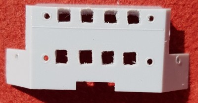

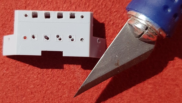

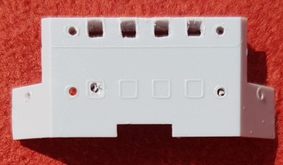

started doing bridge windows.....not easy to make nice square windows...and main problem...all same size.
as usual in heller kits...the bridge windows are roughly ...say designed on the plastik...
to show my way...I drill first holes...then cut it out in to shape with...a cutter
if somebody has a better way...feel free to say how you do it...I'll be very attentive

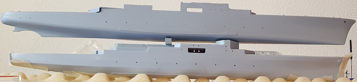

as I was looking at the 57 and 127 mm guns...Arsenal are in six pack....I went looking if yes I have Colbert....sort of eventual combined use
I have...so I went looking what's in there....darn...that's when you see (my Colbert is an older kit than my De Grasse) there is a BIG difference in details..
then I rapidly fixed the 2 half together and put middle deck part in to compare
you clearly see the difference in their concept...and size +8m for De Grasse
then put all I have roughly together

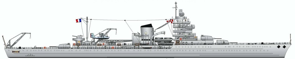

you gonna build it as planned at start in 1938 with the 3X3 152mm and 3X 2 100mm?
that surely would be an awesome thing to do....and see

cutting a square apertures in plastic is very hard indeed
cutting lots of them next to each other ius muuuuch harder.
I usually cut mine oversoze and then install a suitably sized PE square or oblong
that way they are all square and can then be retro-filled to size
I hope it may assit you

mmm..in a sort of a way...I did a similar thing in my previous one...
actualy I cut it..correcting..again and again untill my hole was too big....so I took a scotch...put it so that it was only open to the size I wanted my window
then filled with mastic behind the scotch untill I got to the limit of the scotch ...once dry I took scotch away and it was good.
but...keeping your way in mind now...txs Jim

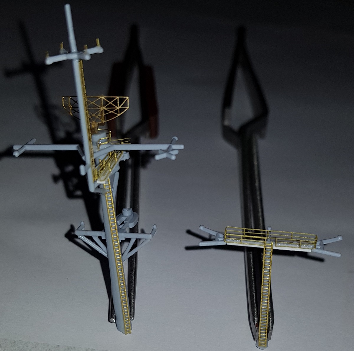

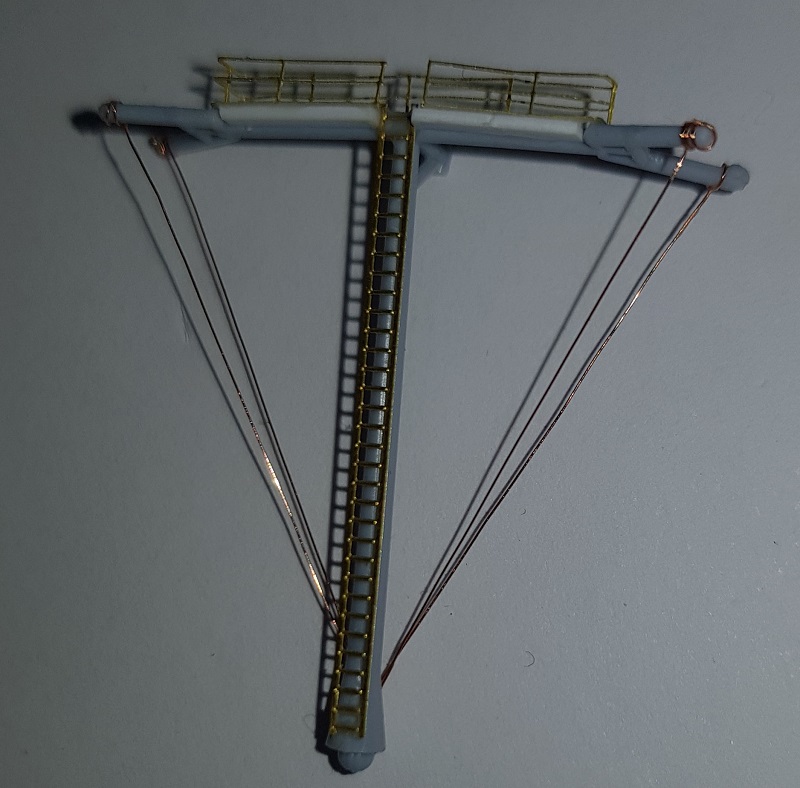

been doing some detail work...the mast
added walk way's for the marines ...on wich I can put small railings...like on the real one
the one in the middle is good...the other one...I'm not convinced...might try it differently...its 1 mm thick...means 40cm in reality...thats a lot for a walkway

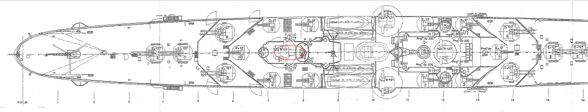

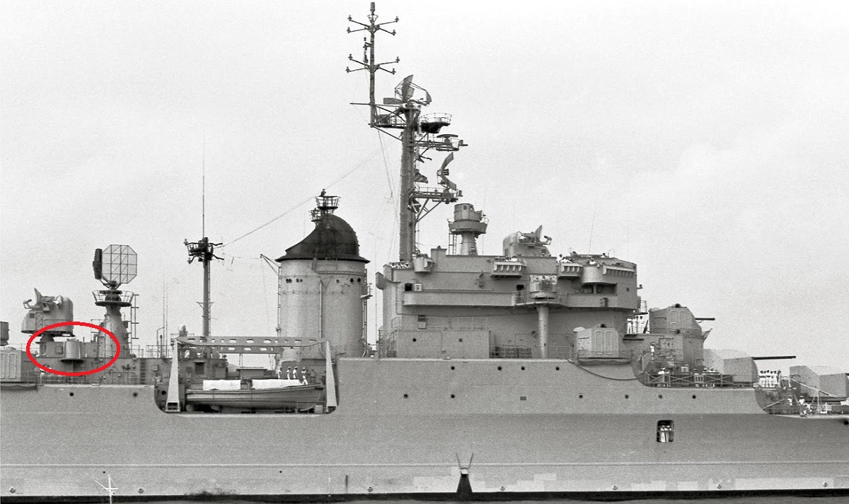

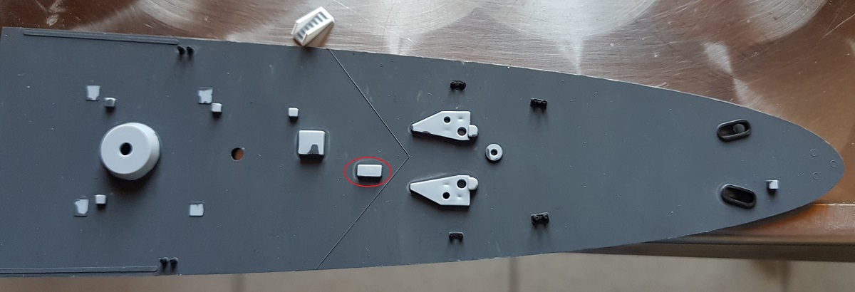

this picture made me think something not in kit....
So I went looking in the plans of "la marine National" send to me from David p
got confirmation there...so...modification

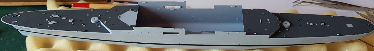

decided to do some more painting...as always...I start with the black line...and did a few decks..its hand painted...didn't bother taking air-paint for such small surface lol

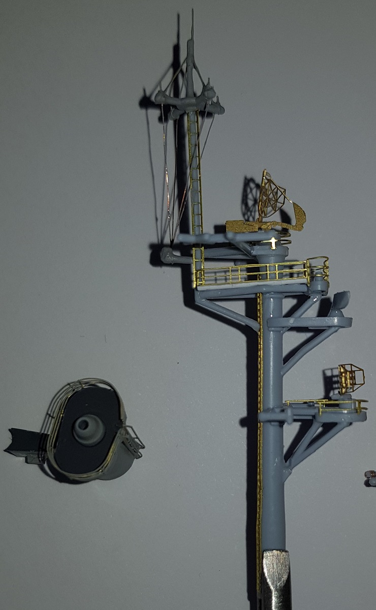

continued a bit also on my masts..

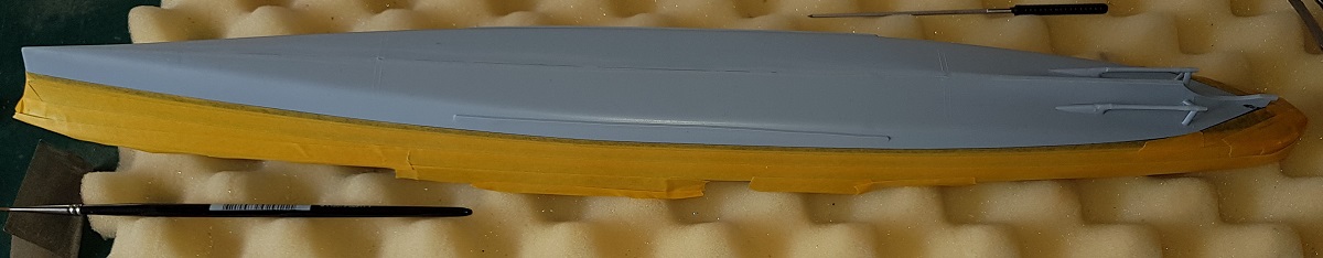

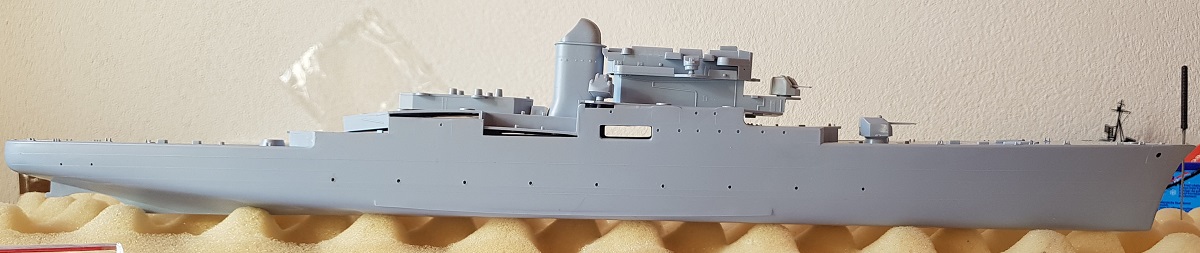

prepared for paint....airpaint has some propblem...now must wait with hull ..damm

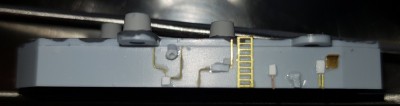

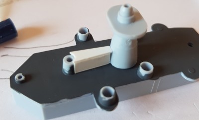

so doing other stuff...target is getting better with every ship I do...so added some details...
PostPosted: Tue Oct 02, 2018 1:07 pm
Posts: 1125
it was fun doing them....untill I suddenly realised...whatever I was doing....I had to do same ...on the other side...lmao
so I did..
fyi..I used real photo's of the "De Grasse" to ad the stuff...its not just do what pleases...although some free interpretation is done
mostly ...this ship is rather nude in external stuff and very pure in line so doing max on those places where some is.

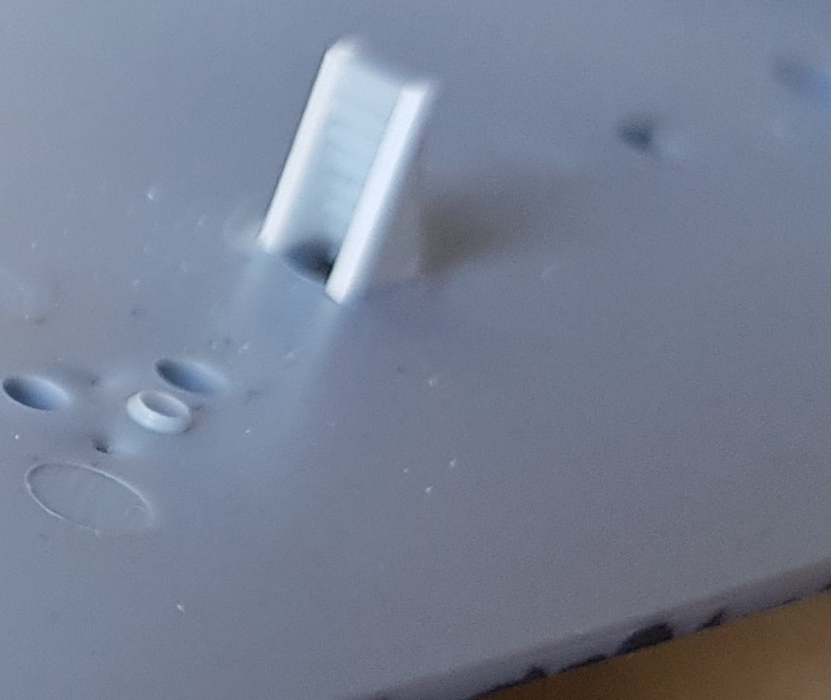

now....look at this....its supposed to be a stair going below deck....
PostPosted: Wed Oct 03, 2018 6:00 am
Posts: 1125
not very satisfying for me...so I decided to build a stair...(you can see him in previous photo)
cut the top off....make a hole in the deck...glue it on
