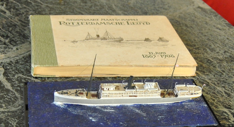

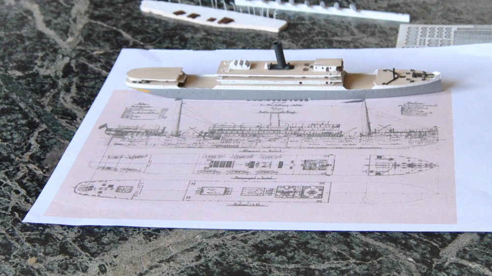

The build itself was quite straightforward but unlike Vondel I did not have access to good plans. The build only took off when I found a small book on the RL in a second hand shop. It was the company history of its first 25 years and it contained some reasonable GA plans.
These became the basis for a carved balsa hull. As luck would have it I found the official lines plan for Sindoro online last week....
This picture shows the GA plans from the book.

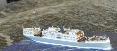

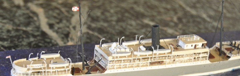

The build took quite some time as I was being distracted by other projects but once I had cleared the workbench for the ESM deadline she really started to grow on me. This local design (I grew up some 20km away from her place of birth and she was designed by the shipyard) had that really elegant and balanced look which is typical for many liners of the first decade of the 20th century. She had a good sized funnel and mast at a small angle to the vertical, a logical and proportionally 'right' superstructure and a subtle and elegant sheer. The RL seemed to agree as they ordered 8 ships of this design from the Koninklijke Maatschappij de Schelde between 1900 and 1910 though there were small differences in size, machinery and cargo handing equipment.

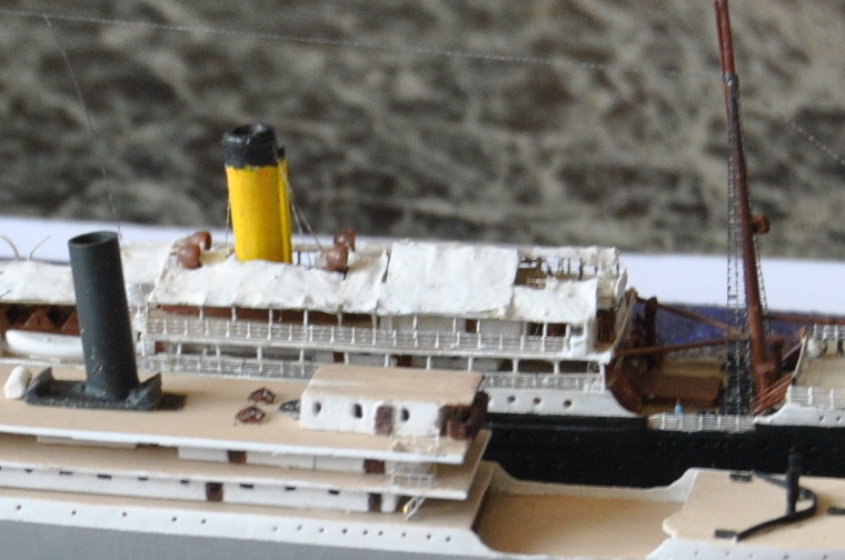

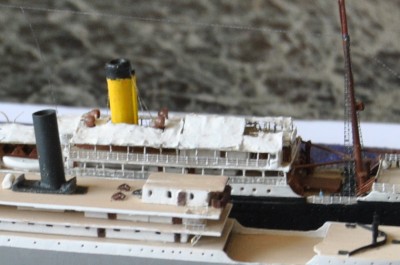

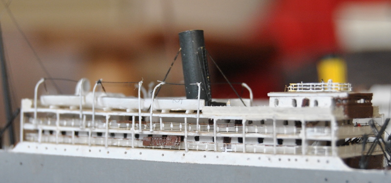

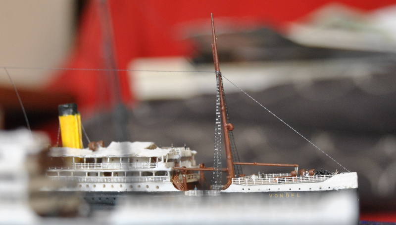

About the gallery supports. In the 1:1 scale world these are 10cm thick steel profiles with railing running between them. My first attempt on Vondel was to build them in 0,2mm brass and carefully glue photo etch railing in between. This became a mess of misaligned brass and glue spots so I decided to replace them by first placing 0,3mm styrene strips between the decks and after the glue on them had set glue photo etch railing strips to the outside. The result was passable but not as straight as I wanted it to be.

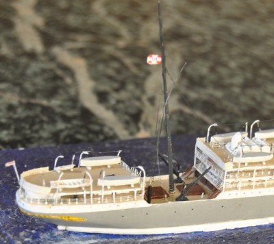

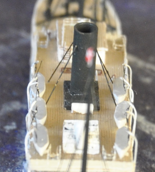

On Goentoer I would need to align between two decks and I also had lifeboat davits to contend with so I reversed the procedure.
The railings were superglued about .5mm inside the deck edges and carefully aligned vertically: each stanchion on the promenade deck would have a stanchion exactly below on the bridge deck. The 03mm styrene profiles were glued to their corresponding railing sections using drops of white glue and not to the decks overhead or below so I had some wriggle room. The resulting small gaps were filled using paint once the white glue had dried. This went very fast and gave good results I think. I did have some trouble aligning the davits to the outside of the finished galleries though as they only had two small points of contact on the real ship.
The over all result is nicer than the earlier buiid I think. They are still a good match though.

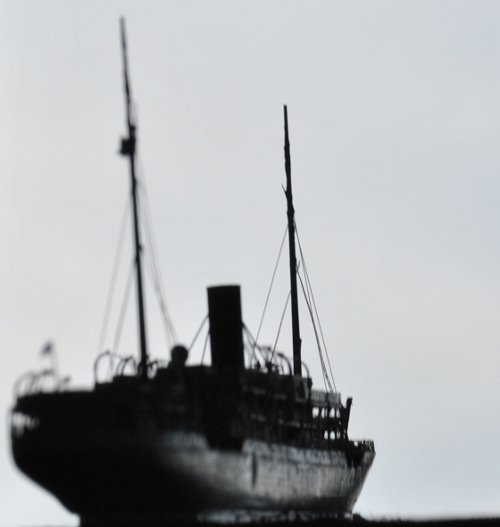

So here you have it. 20 davits, 80 stanchions and one funnel sailing on a trip to nowhere.
