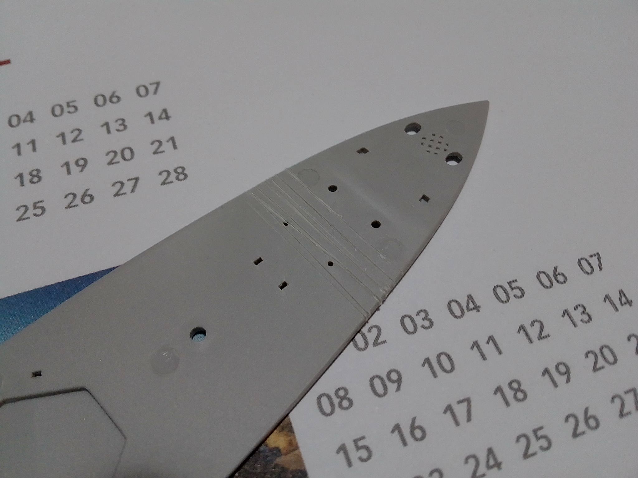

OK here we go !
as I am waiting for some aerial spreaders to finish my Dunkerque (1/350), I will begin my Tribal class DD (1/350).
so I will also use black cat early set, various generic PE and leftovers, and some included PE.
I think to paint it 507a/b, but did not chose the exact ship for the moment (an early fit, however).

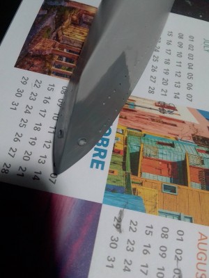

first thing, the bow :

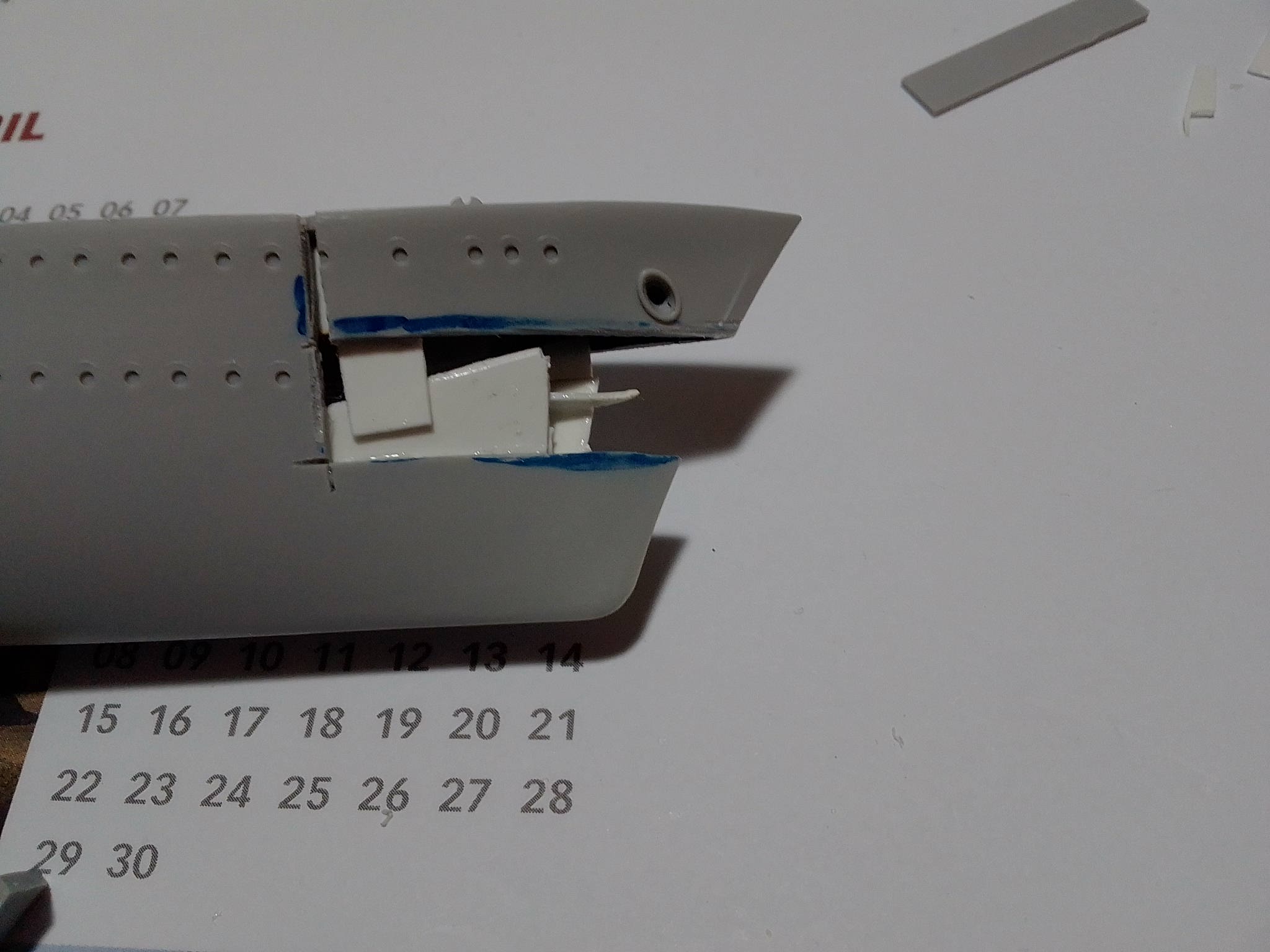

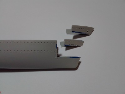

some cuts to help bend it upwards

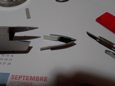

stiffenerd need some glue drying before final piece to replace
I will also have to slightly "square" the lower part of bow with some fine filing

PostPosted: Wed Jan 26, 2022 4:08 pm
Posts: 12330
This is great - thanks for showing us the step-by-step for fixing that sheer!
as I have to give back to caesar what owns to caesar, I found this technique in a british modelling forum !

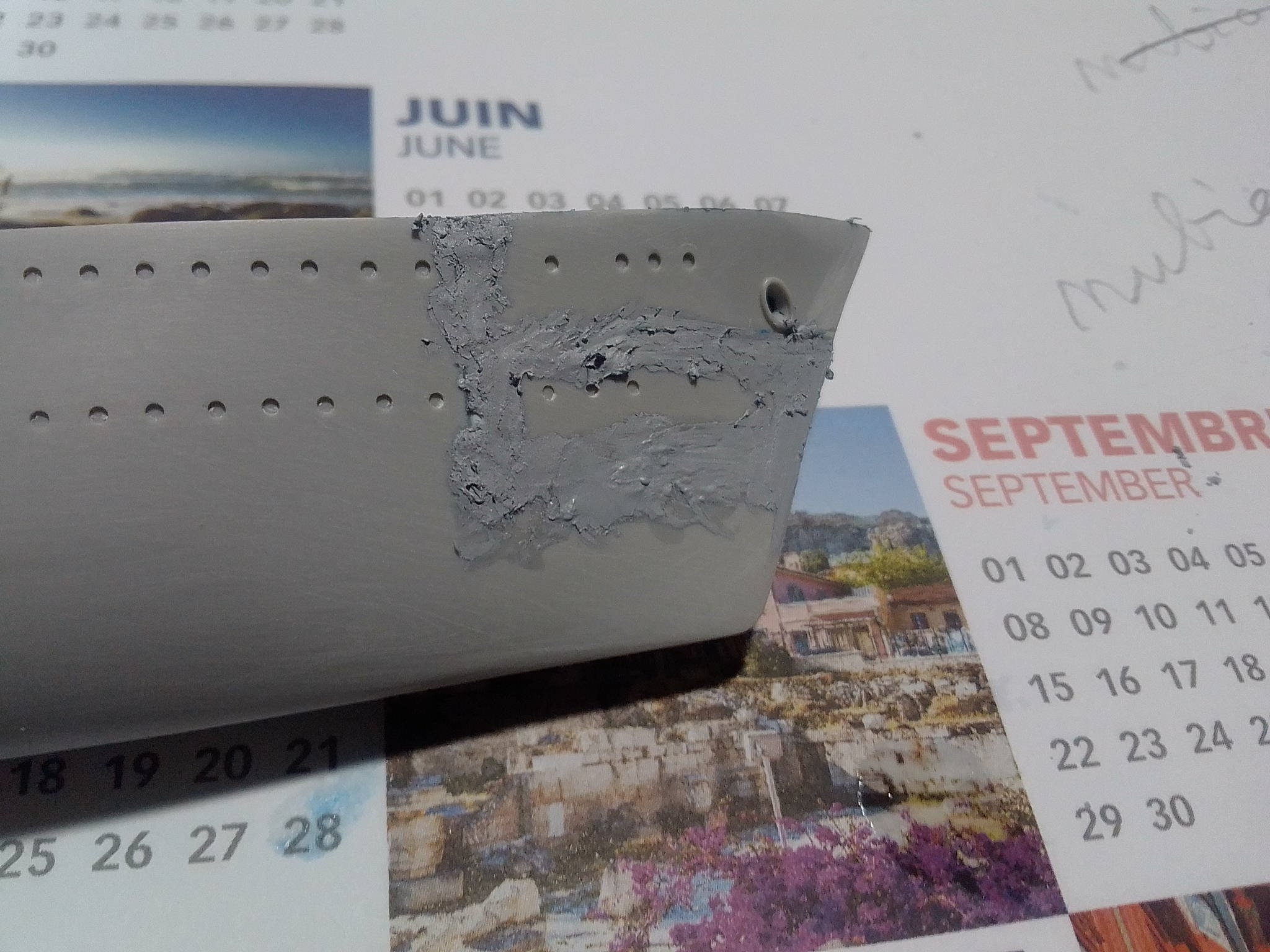

so, filled the slots with scrap plasticard :
filed/sanded :
and somewhat puttied :

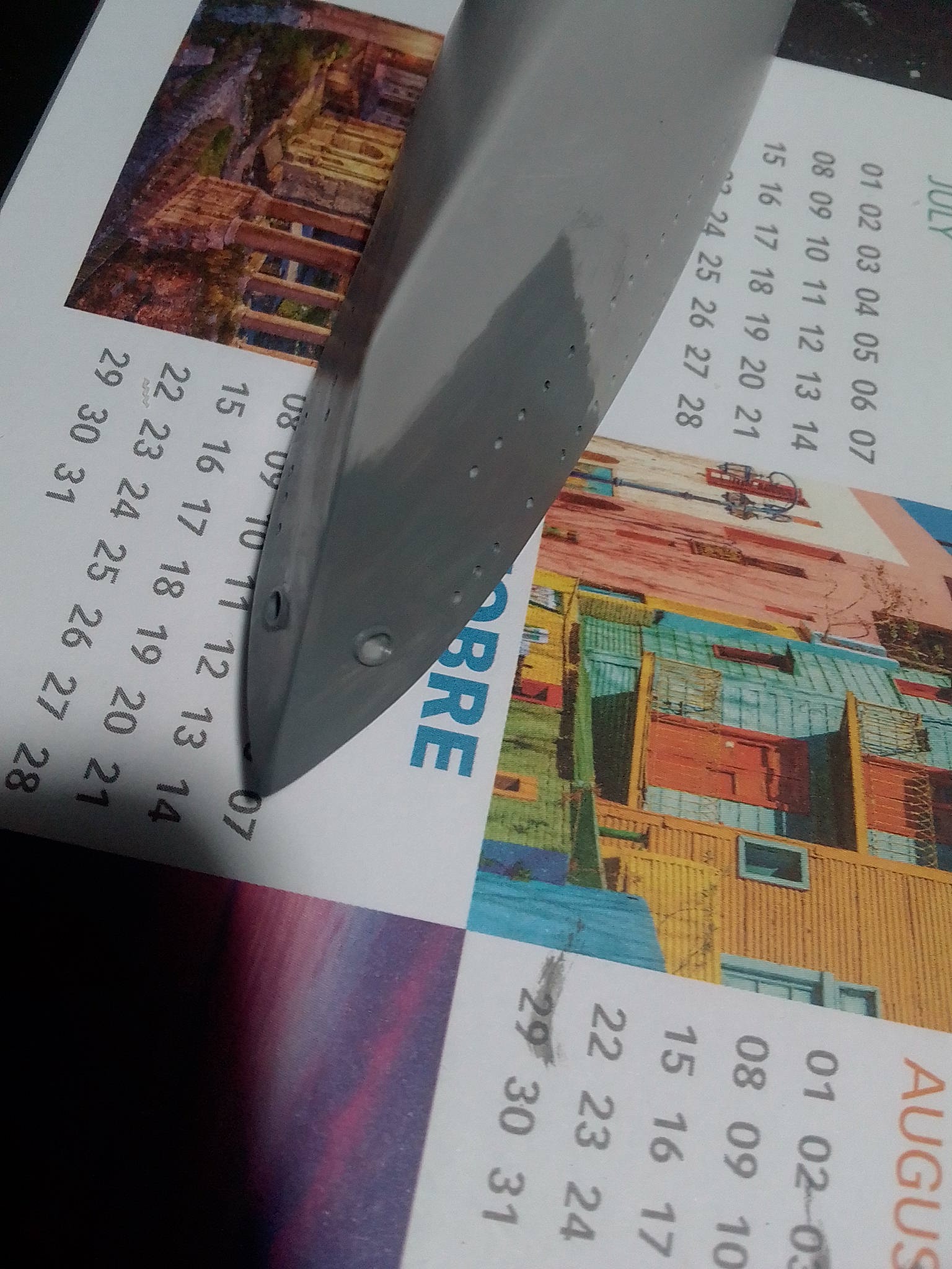

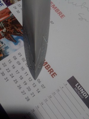

Nice ! I am pretty happy with results :
So I am waiting for J. Roberts book now.

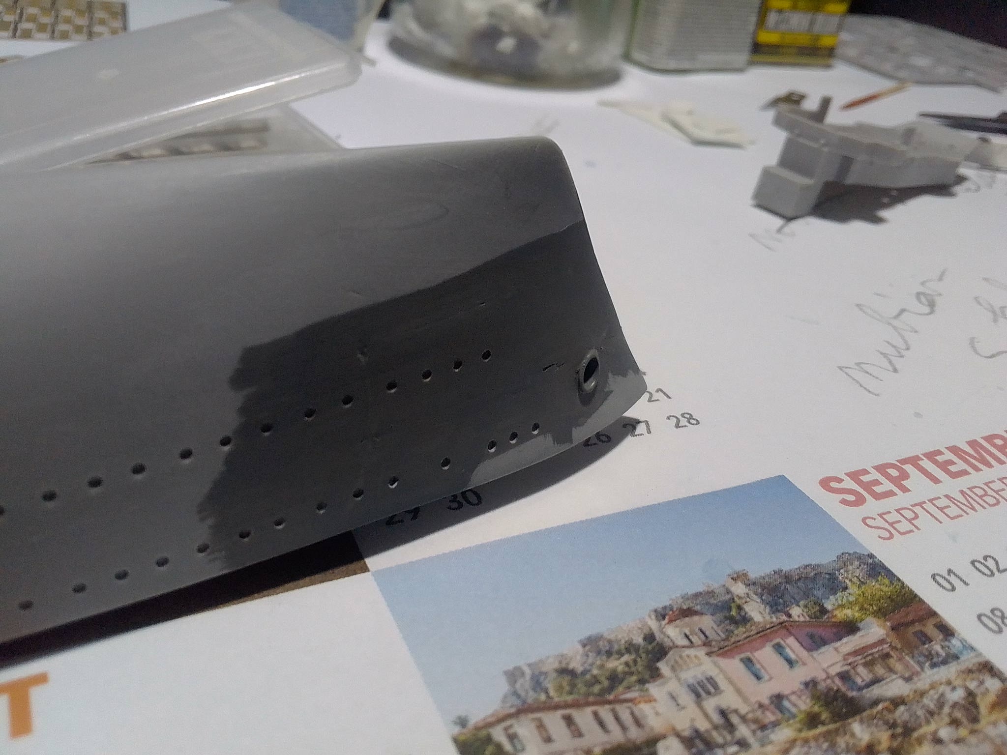

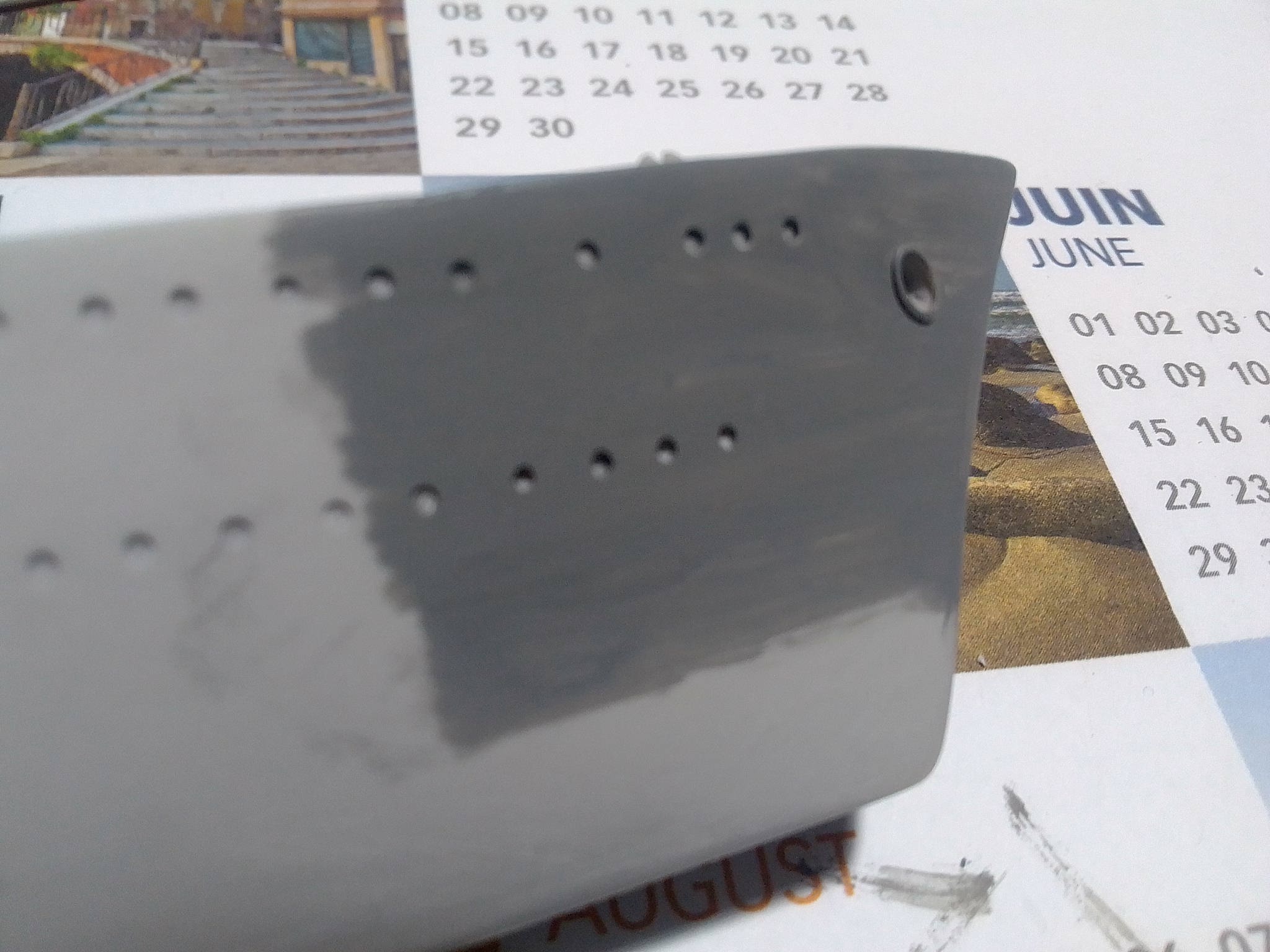

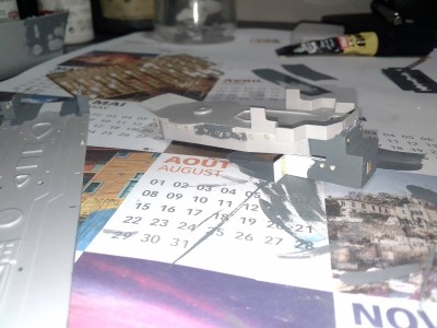

So,
as putty recessed during weekend, I will wait a little more to achieve a better bow with putty a bit later.

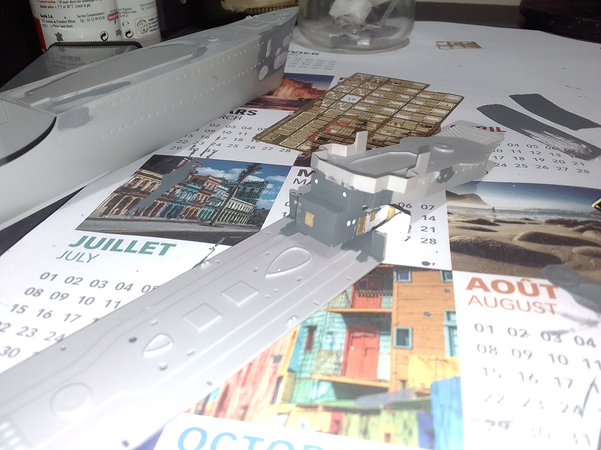

as i just received my book, I will now check portholes as it seems to be some minor differences between kit and plans of 1938.
Damn the torpedoes, full speed ahead! - David Glasgow Farragut

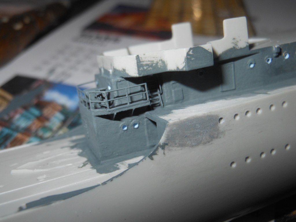

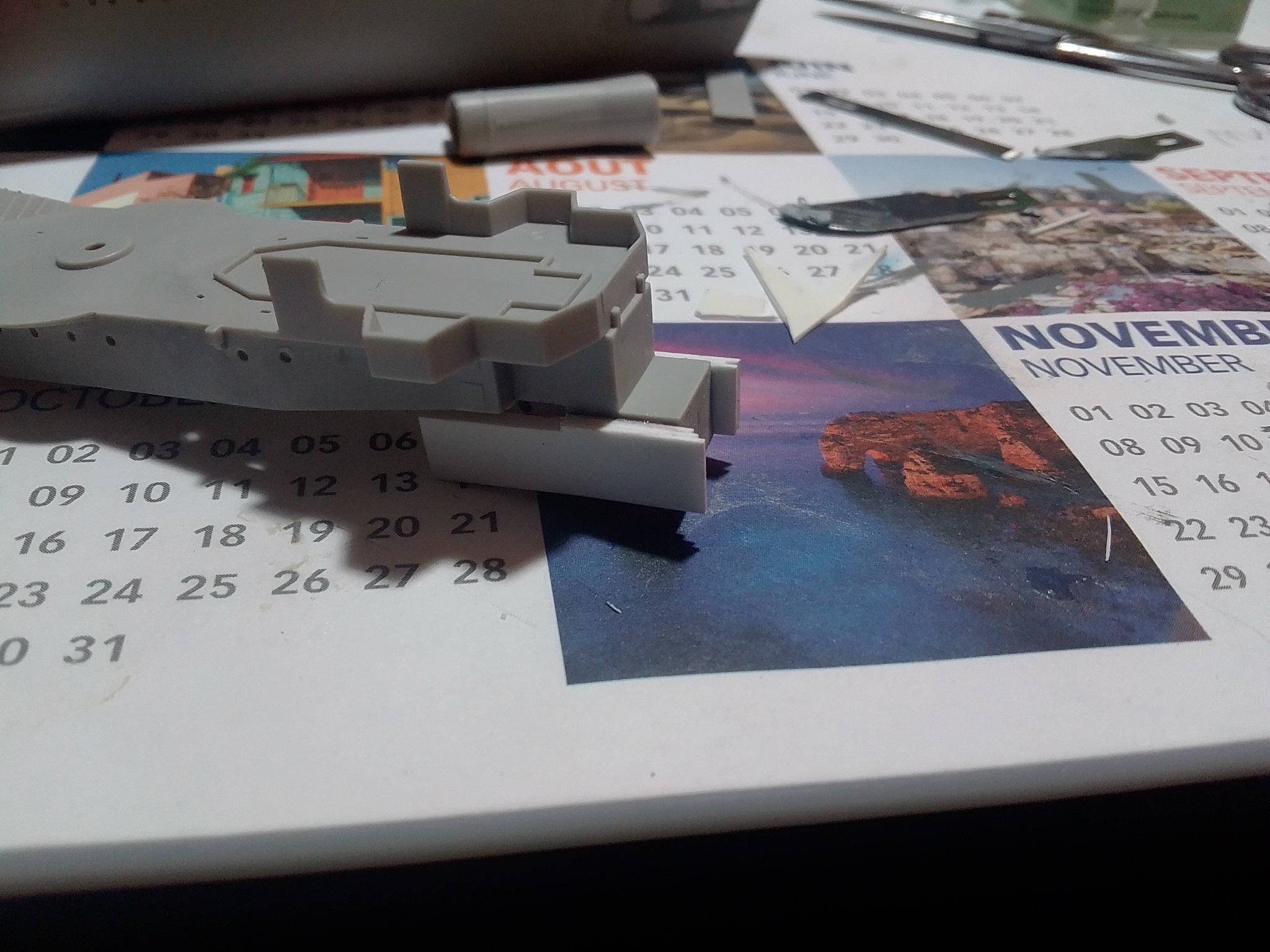

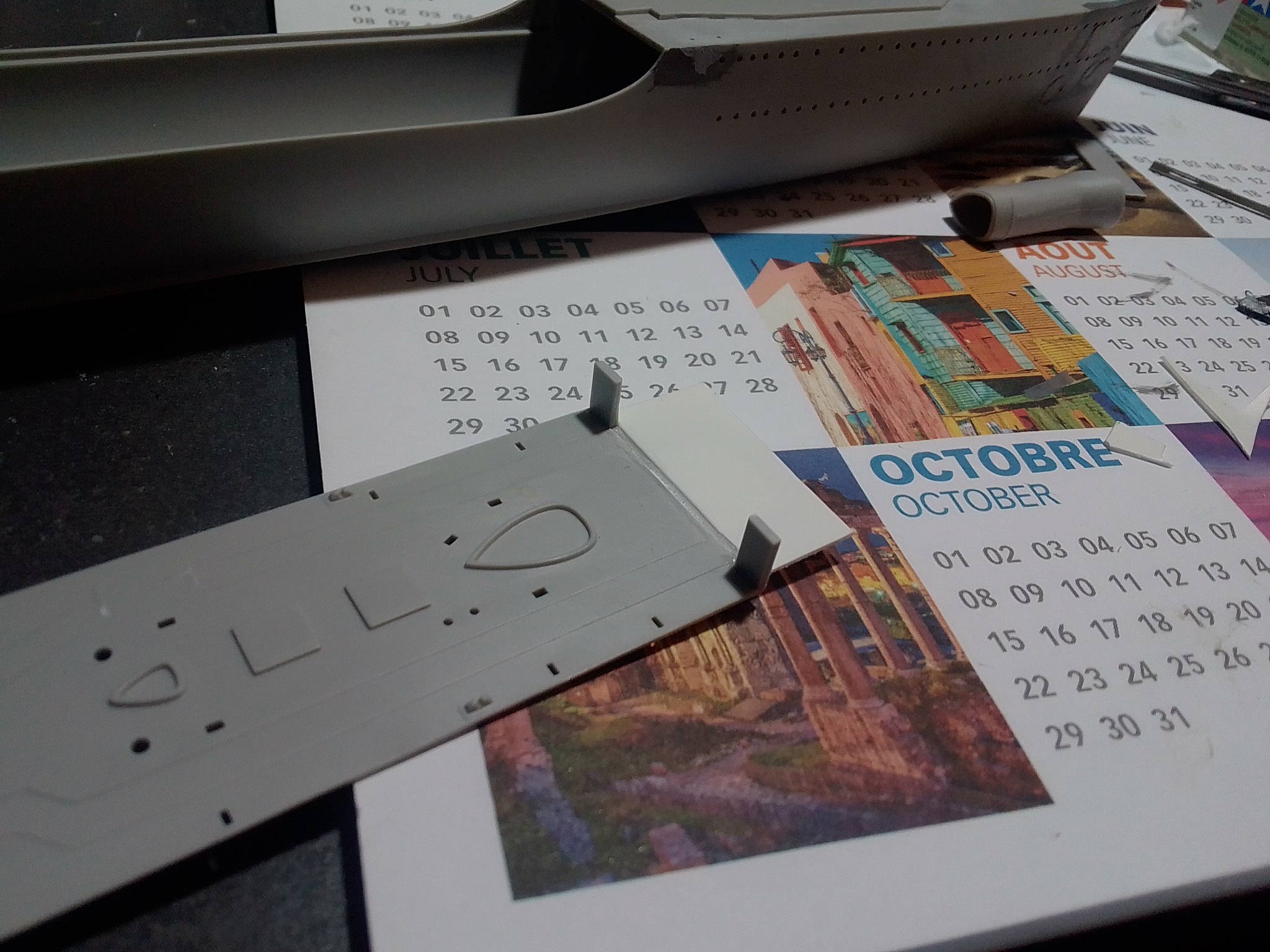

I see that crews galley need to be wider, so I add some plastic on the sides, and will drill portholes later.
crews galley needs to be wider because two stairs on the left and right side go down from the roof to the main deck, and those stairs normally are arriving on the side of funnel.
If I dont widen it, stairs will arrive just in front of funnel...

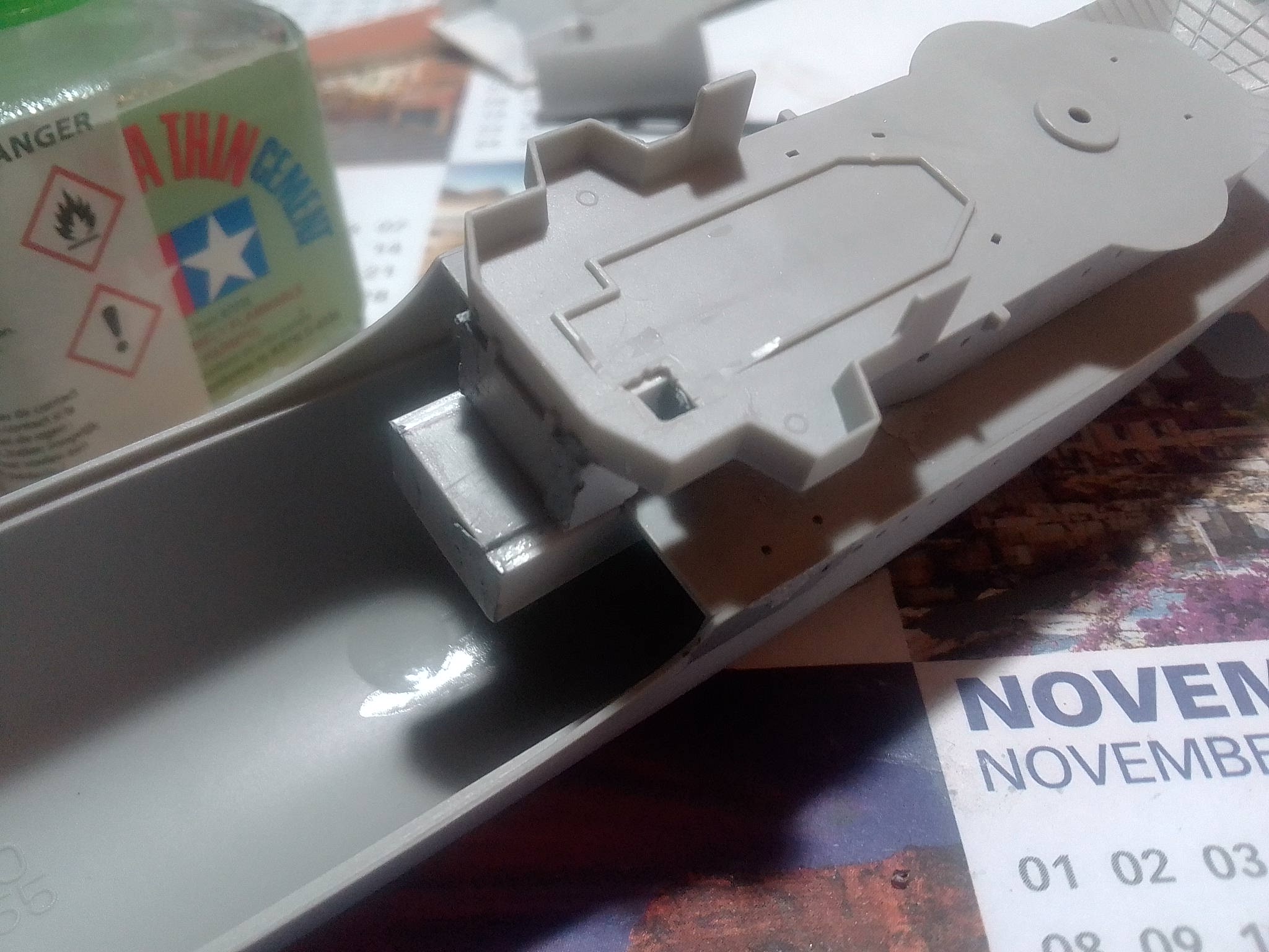

Trumpeter did also bad for rear of forecastle, as gangway goes inside, and doesnt abruply stop against a bulkhead (piece c6)
So I am preparing an "inside" construction.

the rear of the forecastle structure also needs some widening... and some porthole corrections.

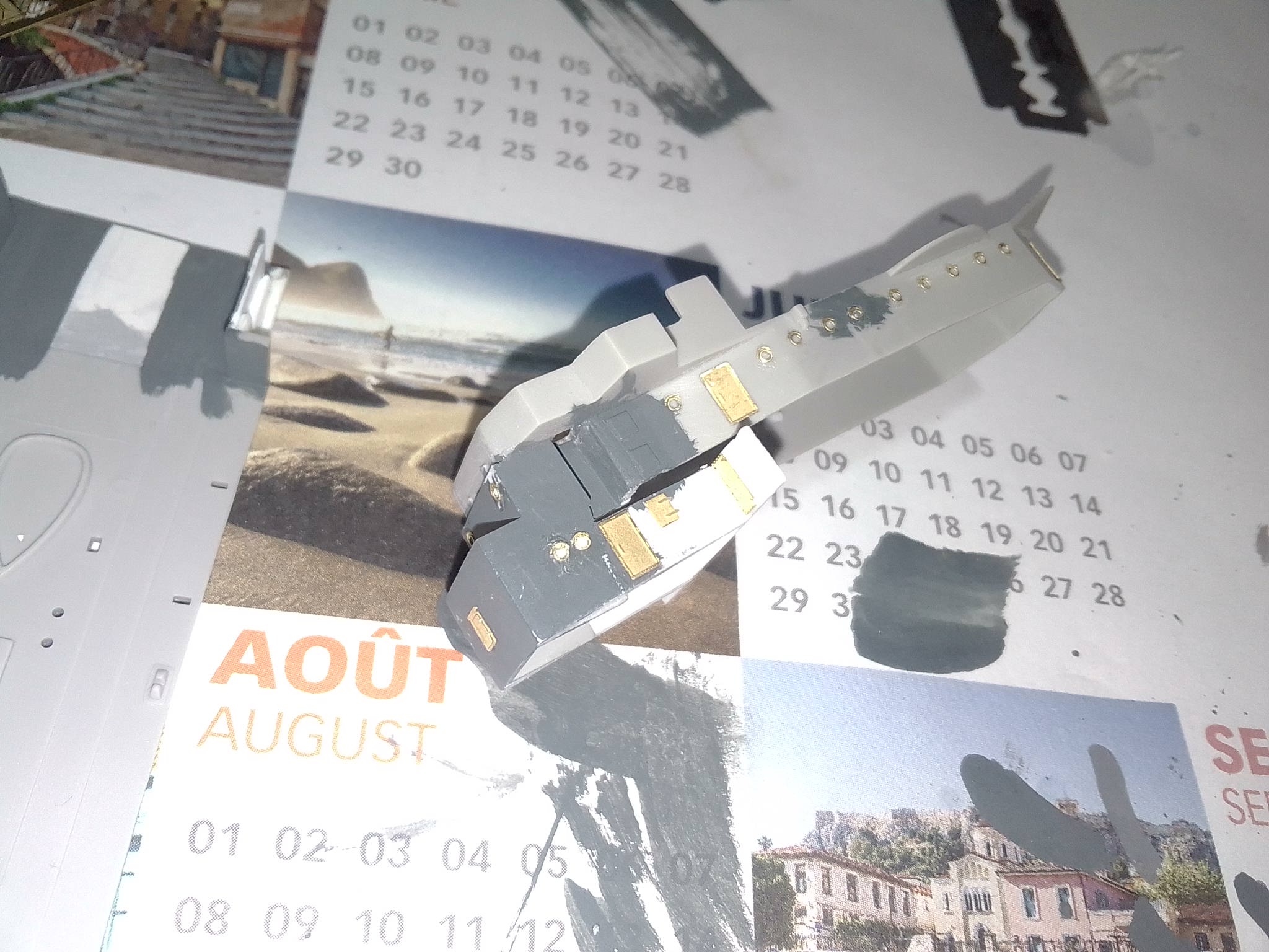

yes there is a lot of small additions, corrections, and so on.
I will use various generic/leftover PE, IJN mushroom vents leftovers of previous models, because model doesn't include any of these? and so on...
forecastle base in place now. and crews galey roof nearly ready to receive some more hatches, sounding machine and oil bunker.
will also be in need of some old photoetch railing leftovers tailored at a matching size.

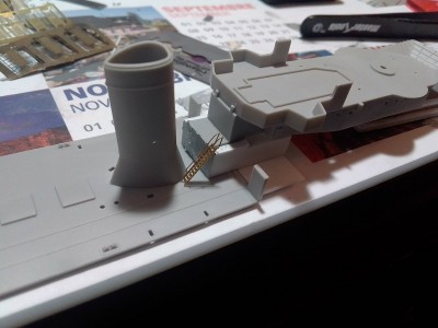

crews galey roof ready, and inclined ladder in place
