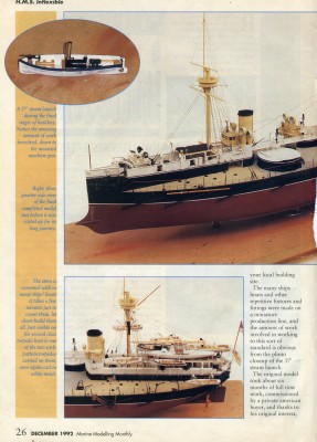

Ahoy Stefano
did I send you these...? ( or did you not ask for them...?

Jim, you posted them when i asked in the main forum what that hellish arched contraption on the bow was :D and these pictures were very useful for general detailing of the model :thumbs_up_1: :thumbs_up_1: :thumbs_up_1:
so thank you again for posting them, hope they'll be useful for other modelers!
