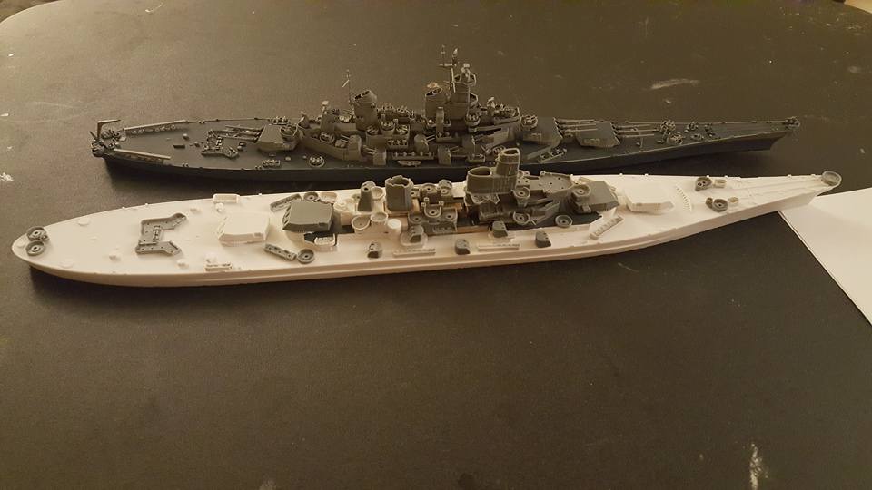

Ended up getting the resin IHP 1/700 USS Montana craftsman kit (2 weeks later very fire came out with their kit), but this is a mock layout, only scratch built sections are permanent. Just my idea of what the Montana might have resembled if she were completed at the end of WWII if she was built and commissioned. Took many concepts and ideas from the successful Iowa class fast battleships. kitbashed the superstructure off of an extra tamiya USS Missouri kit I had lying around. Though I do not have access on making the 5"/54, so using the 5"/38 as a place holder for the time being, or might just settle on them but make the barrels a little longer. USS Wisconsin as size and shape comparison as well as reference. any criticism and suggestions are welcome.
@Betelguese90: Did you also "take" some concepts and ideas from other people's Montana builds? I noticed some of your placement of parts kinda mirrors what I did for my Montana build which is here:
Look carefully and you'll see some similarities. ;)

Take is a strong word lol, borrowed ideas from other people's builds sounds better, but yes I did. Yours was closer to what I had for an idea so I used your build as my main reference along with the late war Iowa's as well.

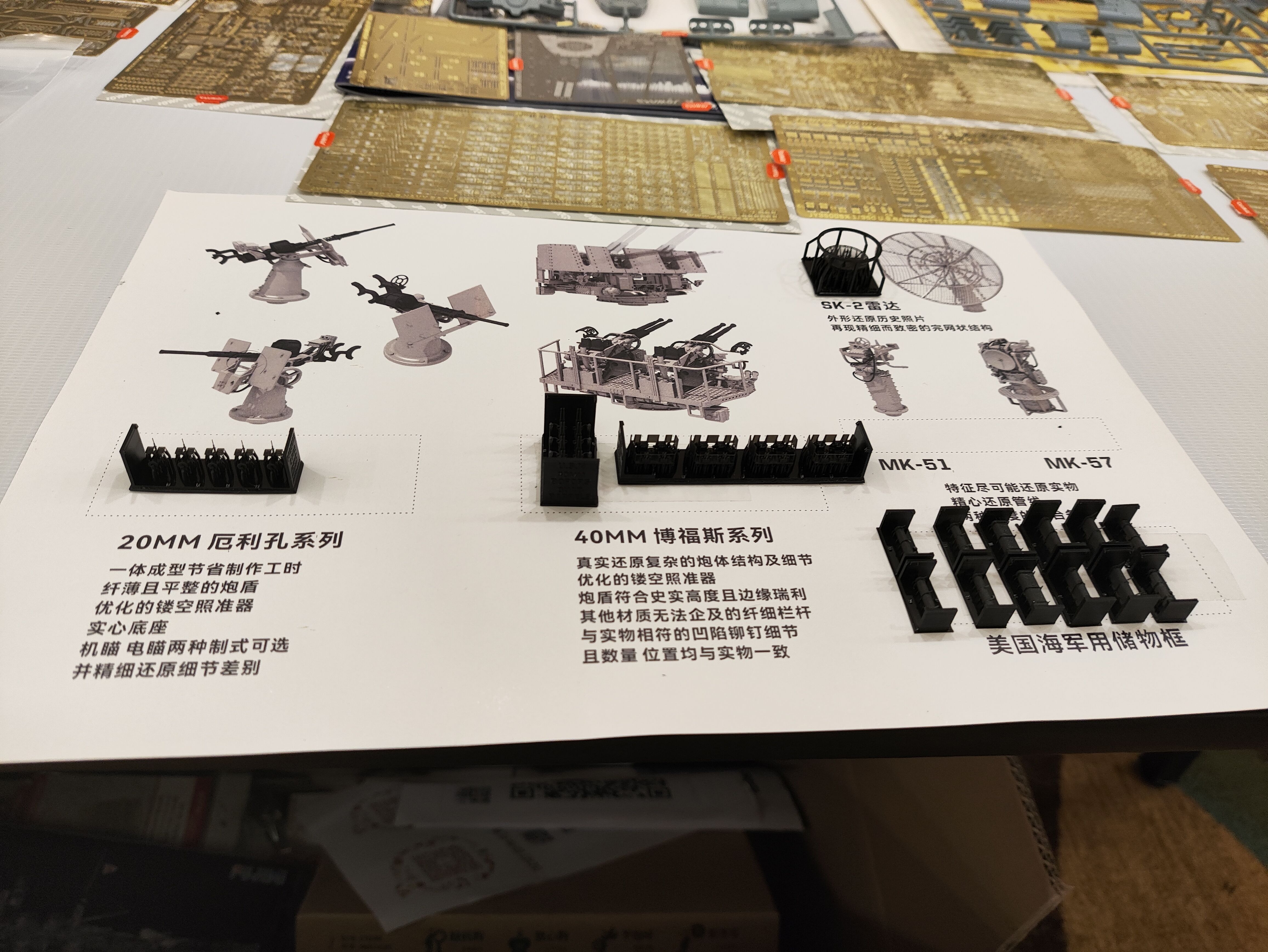

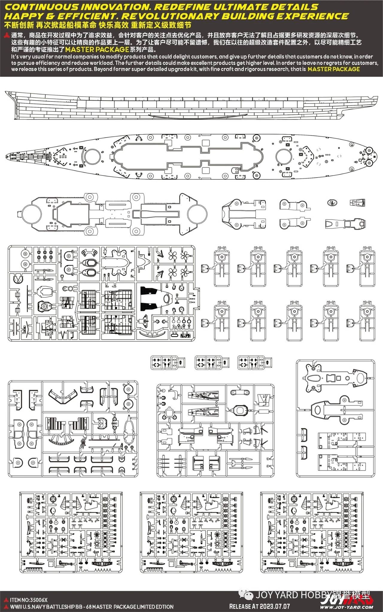

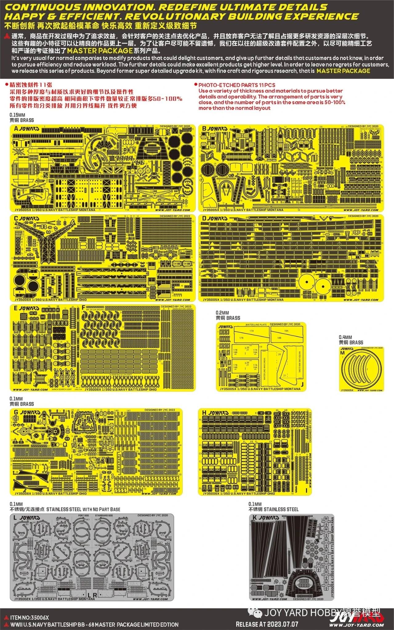

JoyYard’s new products,BB68 OHIO

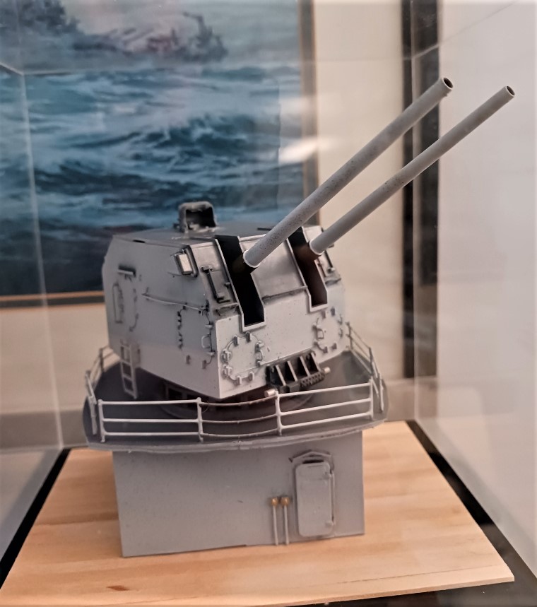

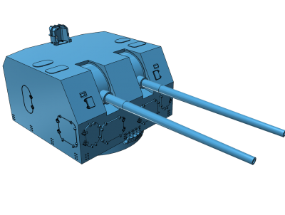

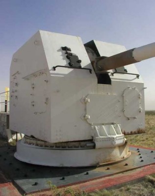

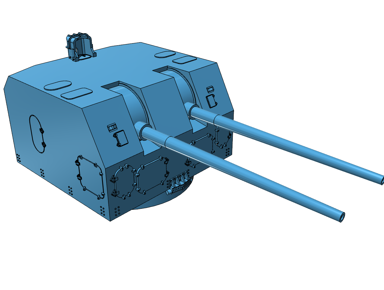

Some have argued that the 5"/54 cal. Mk.16 gun would have been installed within the same gunhouses enclosing the shorter 5"/38 cal. guns fit to the Iowa class, South Dakota class and North Carolina class battleships. But a 3D design study shows that the 5"/54 cal. Mk.16 gun does not fit in that gunhouse. The gun is simply too big. The 5"/54 cal. Mk.16 gun's breech extends so far to the rear of the trunnion that there is insufficient space behind the breech in the small 5"/38 cal. gunhouse to load the gun or provide sufficient space for recoil. Additionally, when fully elevated, the breech of the 5"/54 cal. gun pierces the 5"/38 cal. gunhouse floor. Since the 5"/54 gun can't operate in the 5"/38 cal. gunhouse, a new, larger gunhouse that can accommodate the 5"/54 cal. Mk. 16 gun is required, hence the need for the Mk.41 mount.
No official plans, drawings or photos of mock-ups of the proposed 5"/54 cal. Mk.41 twin-gun mount's gunhouse are known to exist. So some educated guesswork is needed. We can make a reasonable design based on a theoretical enlargement of the very real Mk.16 single-gun 5"/54 cal. mount fit to very real Midway-class aircraft carriers and later installed in the very real Japanese Akizuki-class and Murasame-class destroyers from 1958 to 1959 (photo below). Credible sources indicate that the Mk.41 twin-gun mount would have carried the same gun as the Mk.16 single-gun mount. Since the real 5"/54 cal. gun is known to fit and work in a real Mk.16 gunhouse, the real Mk.16 gunhouse can be used as a logical basis from which a theoretical Mk.41 gunhouse can be designed (rendering below).
While the Montana builder's model does indeed have 5"/38 gunhouses, these were probably just placeholders for the new gunhouses which had not yet been designed.
Since a Mk.41 gunhouse would probably be larger than the gunhouse enclosing 5"/38 weapons, the location of the barbette, or nearby bulkheads, would need to be adjusted to provide sufficient space for the Mk.41 gunhouse to operate.
Just my 2 cents.
Model Monkey 1-200 5in-54 Mk.41 Mount for Montana a.png [ 219.19 KiB | Viewed 3047 times ]

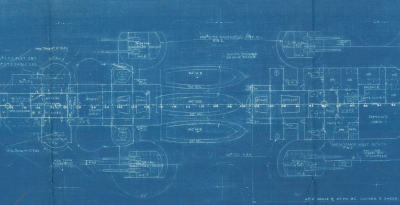

This is the closest I have ever found to plans for the Montana's twin 5/54's, clearly longer than 5/38 gunhouses.

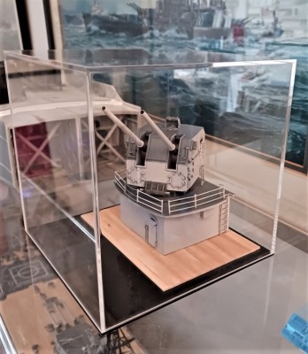

For what it's worth, earlier this year I came up with a dual 5"-54 gun mount that could have been a MONTANA class mount as a small mini-project. It's roughly based on the 1945 Mk. 39, Mod. 0 single gun mount which WAS incorporated into the MIDWAY class CVAs. My build is over on the Scratch Built Forum, but here are a couple photos of the completed 3D designed/printed gun mount:
Before coming up with the final version, I solicited input from other modelers and the final version is based on that input. It is depicted on one of the raised (01 Level) amidships gun platforms. Was an interesting interlude. MONTANA class BB's simply won't go away, will they??

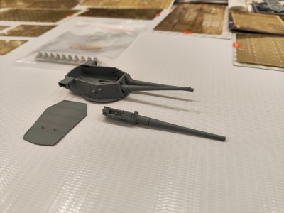

joy`s ohio now update
