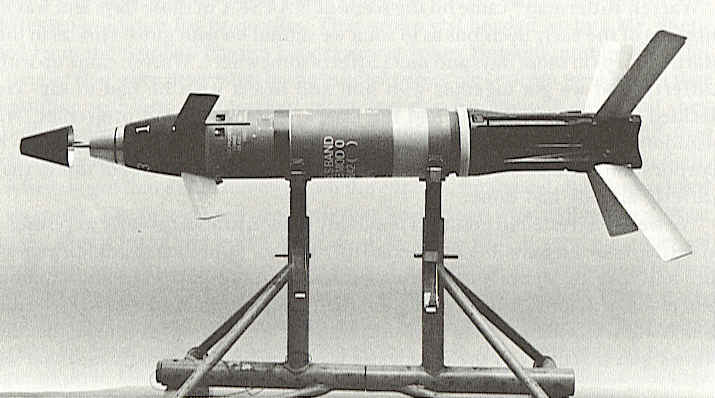

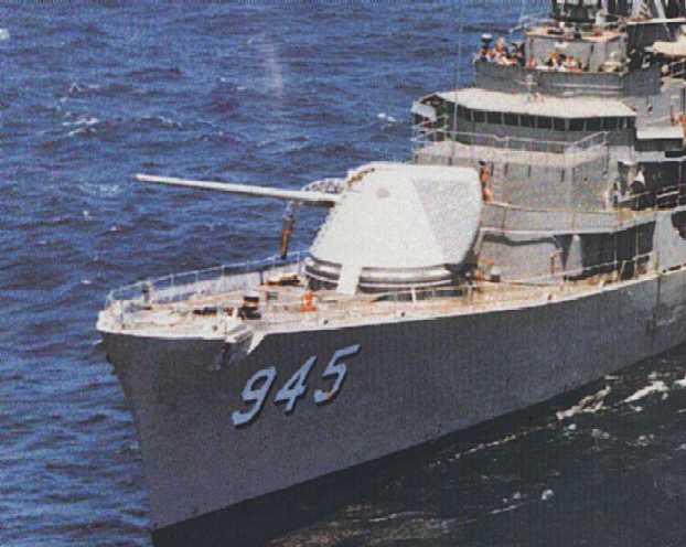

PostPosted: Thu Sep 03, 2009 12:11 am
Posts: 3127
The only effective future of NSFS. Man, isn't that sexy?
Does anyone else have suggestions about a modernization of the Boston and Canberra that would follow an economic and Iowa-class like modernization in the 1980s?
I would very much like to hear any and all suggestions.
