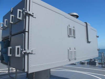

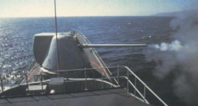

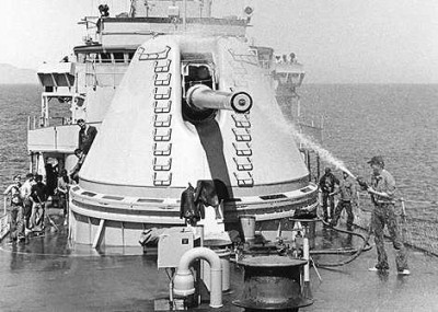

Unfortunately, the Mk71 8" gun is too large to fit where the 5" guns are. It has a 20' base ring, and it requires a LOT of below-deck magazine space.
I mean, look at this big b!tch! It barely fit on the bow of the Hull. The Spruance-class's bows were specifically designed for them, and even that was going to be a tight but comfortable fit.
HUUUUUGE!
The Burkes are the only modern ships that really have enough bow area to comfortably have the mount. Of all the Burke-type ships out there, the South Korean KHD-IIIs are the only ones with a long enough and deep enough bow to have the full 500 round Spruance magazine. :big_grin:
