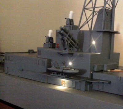

For a change from working on my other project CGN-36 I have begun fitting USS Long Beach's deck lighting starting with the hanger section. I am using 1.8mm LED's CA'd behind a small 1.9mm hole in the wall of the SS eventually once all lights are in and final painting is completed I will fit a small piece (1.5mm(ish) long)of clear styrene rod in front of the LED 2 diffuse (hopefully) the light. Got six done so far and need to add a couple more each side of hanger and upper area plus cabling for aft flood and flight deck lights.
Cheers Bruce
File comment: test on 6volts

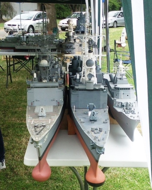

I had been doing some building of racks for aft life raft canisters during the past week as well as some drive line alterations after our club run on 27th Feb, until I had a 'minor' fall on friday and broke my wrist !! All work has been shelved until I can use two paws!! Here R some pic's from work done so far....
Bruce :mad_2: :mad_2:

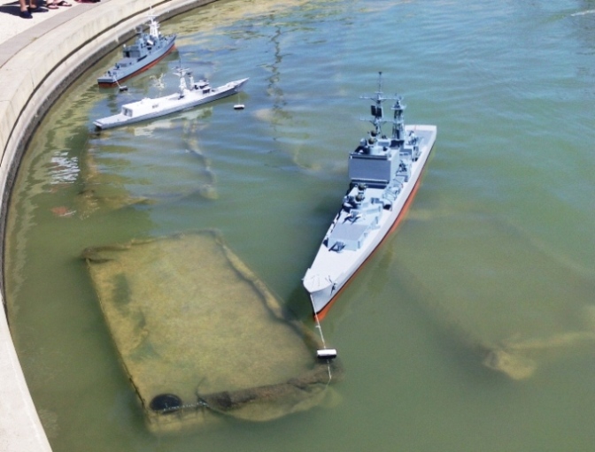

File comment: HMAS Sydney trails USS Scott and USS Long Beach

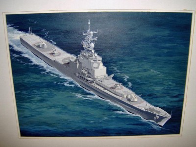

I have something for the community. There are few paintings and reference material out there about the strike cruiser conversion planned for the USS Long Beach. This is a painting recently discovered at Lockheed Martin's Aegis warfare center and was done my Lockheed's conceptual artist Vince Peicyk. It has been stored at Lockheed's facility at Moorestown, New Jersey for decades. This is a copy of the original and is being posted with permission on the internet for the first time.
As you can see it's fitted as:
Aegis
4x SPG-62 from the looks of the directors
2x Mk71 MCLWGs
2x Mk26 twin rail launchers
16x Harpoon
8x some larger missile, perhaps another launcher variant for the tomahawk
SPS-49 on the aft part of the mast
SPQ-9 perhaps inside the dome
This ship would have been a beast. I have a larger version of the file if anyone would like a copy.

Awesome painting mate! Hints of the CGN-42 AEGIS cruiser in the design of the super structure.
Sending you a PM mate for the larger file!

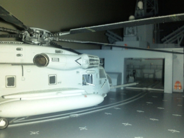

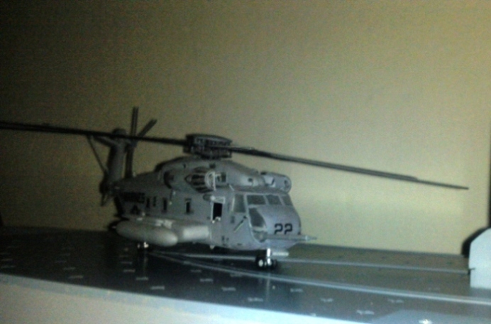

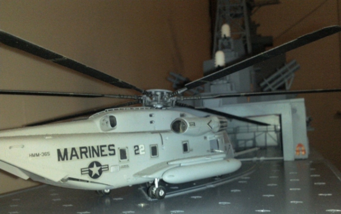

Still a couple more weeks before I can do any more work on USS Long Beach, my wrist is out of the cast but very stiff and sore :Mad_5: :Mad_5:

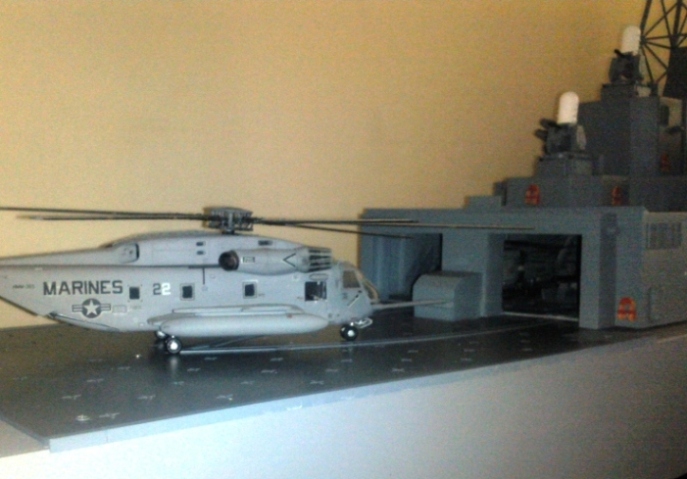

Played around with my camera the other day and got some pix of my CH-53e Super Stallion on the heli deck and a shot of the monster in its usual place in my living room....
Bruce :cool_1:
File comment: the big -53e takes up a lot of space even on a big ship like LB
File comment: SH-60B hidin in hanger
File comment: note 7.62mm minigun sticking out door! was salvaged from my destroyed MH-53J pavelowIII model

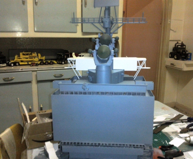

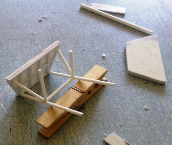

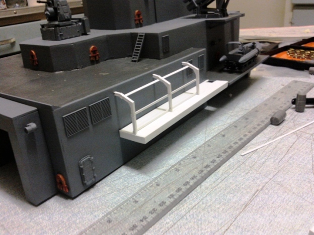

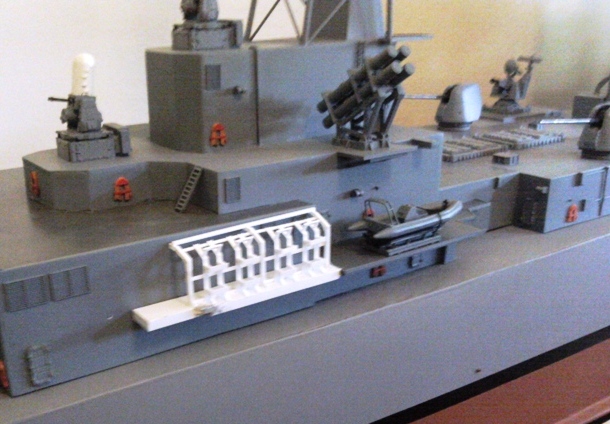

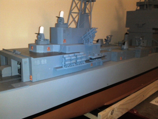

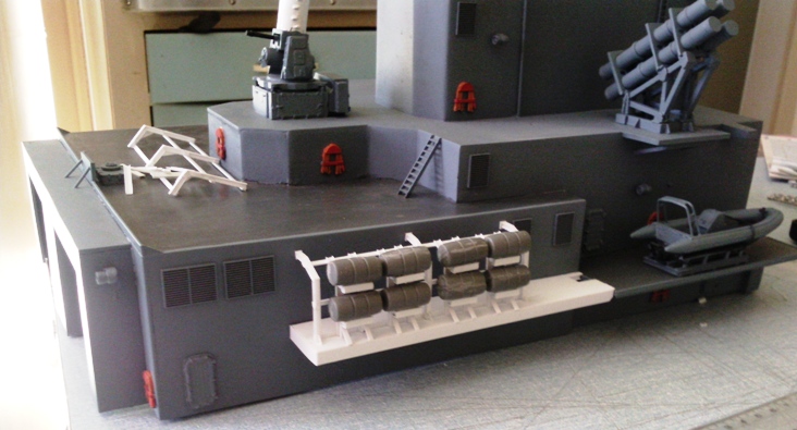

Well I have restarted work on detailing the beast, beginning with finishing construction of the life raft racks either side of the hanger. They are nearly done just some LED lighting to fit then I can paint and fit them.
Began building the platform's for the SLQ-32 ECM system which stick out from either side of the upper bridge area very fiddly, but made a start!! Good to be doing some building again. :cool_1: :cool_1:
Cheers Bruce :cool_1: :cool_1:
PS Any one have decent pic's of the older Square type Satcom antenna??

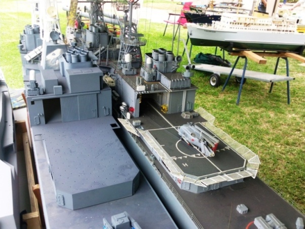

Thx Mate,
I will be redoing the flight deck a darker gray when I get 2 it !! Its not quite the right color, I have compared it to a club mates USS Fife DDG-991 flight deck and now I want 2 change the deck colors before 2 much more detail goes on her. Should be redoing it soon just need 2 get the paint.... :heh: :heh:
Cheers Bruce
File comment: USS Scott DDG-995 and USS Fife DDG-991
File comment: USS Fife is fully finished and USS Scott is still getting detailed.
Note the different deck colors

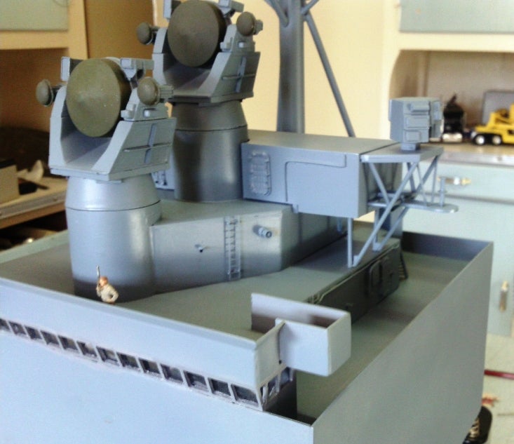

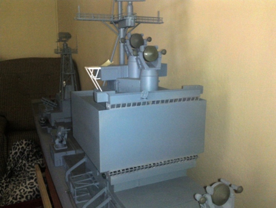

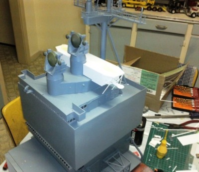

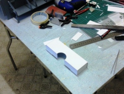

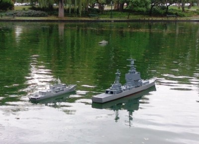

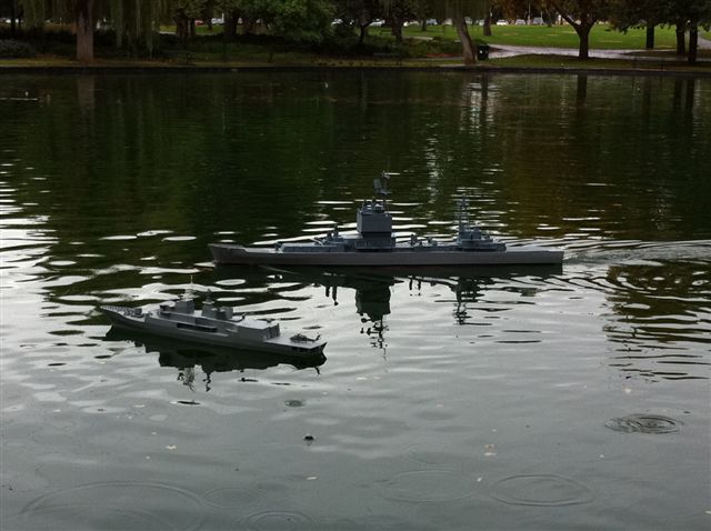

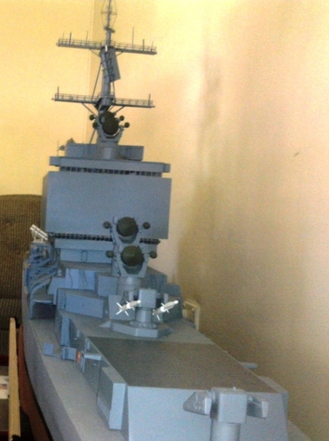

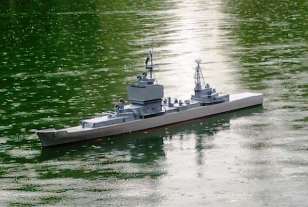

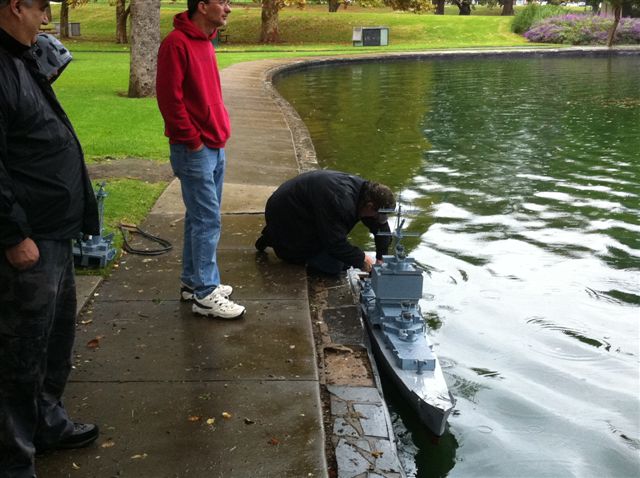

This week have been getting the platforms for the ECM gear finished off and decided 2 rebuild the box that the SLQ-32 ECM platforms attach too, as it turned out 2 be a POS!! :mad_2: It was not square 2 the deck, So it got attacked with the little drill, a screw driver and pliers!! The replacement piece is a much improved bit of kit..
Had a bit of a test run [in the rain] with my club mates last weekend and new motor position is much quieter now.
Here R some pic's of the test run and the rebuilt upper bits...
File comment: USS Long Beach CGN-9 with HMAS Parramatta FFH-154
File comment: Me kneeling down adjusting aft ballast
File comment: Note the rain drops!!

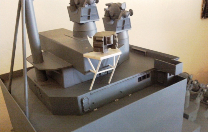

And some more...painted new upper bit and attached the SLQ-32 ECM gear [resin fittings from APSmodels] now just need 2 glue new bit to upper superstructure. Also made up the 2 flag lockers that go at the back of the bridge, and working on the dual whip antenna mounted on the back face of the cube (just can't get the hinge right!)

She's looking better with every new post! I love this one.
As a detail nut, I have to ask about the SLQ-32. You've installed the SLQ-32(v)3. Your time frame is mid to late 90's. From the mid 90's on, SLQ-32 was often paired with a separate enhancement called Sidekick; the pair of devices was collectively referred to as SLQ-32(v)5. Just thought I'd throw that out there in case you wanted to consider adding Sidekick.
Here's a photo of Sidekick as mounted on a Perry FFG.
Regardless, this is great work. I can't wait to see more. :thumbs_up_1:
