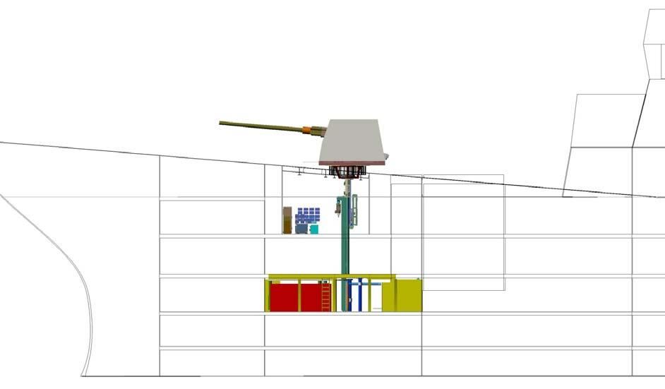

As fitted for the DDG-51 class:
The mechanical inner workings of the mount.
When it comes down to brass-tacks, the Mk71 8-inch is proven. The AGS Light is not. The Mk71 8-inch can fire 8-inch heavy and laser guided rounds up to 22nm and with a sabot, it can fire the 155mm LRLAP. The AGS can only fire the LRLAP.
...one way or ther other, the Mk71 8-inch is still the best way to go...

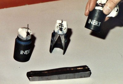

Field artilery ammunition comes in four parts : the fuze, projectile, propellant charges(s) (could be one to eight charges), and the primer. The propellant is "built up" by combining different charges of to get the desired amount of propellant, the more you add, the greater the velocity of the projectile. You can change range by changinging gun elevation or propelling charge, or both. Bags of granular propellant (M3A1, M4A2, M119, M203A1, etc.) are still in the system, but the new modular charge technology is to stack pressed charges (they stack like tuna cans). Here is a 28lb M203 charge and its carrying container (yes that is 28lbs in a single charge):
Here is how the new modular charges equal the older bag system.
The rapid fire 6"/47 and 8"/55 guns used fixed charges loaded into a brase case that in turn was crimped to the projectile almost like a rifle cartridge. Again, I am not certain that current 155mm ammunition can be be mated to a fixed case without modification (maybe they can use some super adhesive?), but it should be trivial to make future projectiles compatable with cases and bagged charges.
Although bagged/modular charges seem to be cumbersome, they do give the firing battery a tremendous amount of flexibility in controlling the trajectory of fired rounds and help make tactics like MSRI possible. Fixed charge ammunition is very inflexible by comparison.

SumGui wrote:
Basically, am I insane in thinking two 8" tubes with a 12 to 15 rnd RoF could deliver the same or similar effect to three 155mm tubes with a RoF of 6 to 10?
Land artillery batteries are pretty much standardized on 4 or 6 tubes per battery (the high ROF automatic systems are generally self propelled); are you trying to compare shipboard weapon options, or trying to compare ship board guns versus field artillery batteries?
BL: “Effect” is not linear with caliber, or shell weight, and "it depends".
1. If the scenario is suppression/interdiction using conventional HE rounds, a four-gun automated 155mm battery beats the 2-gun 8” ship battery.
2. If the scenario allows DPICM, or calls for laying minefields by artillery, the 8” gun absolutely dominates the 155mm battery.
3. I give the nod to the PGM 8” round for destroying point targets, but note that 8” is probably overkill for most targets. The PGM 155mm projectile is a damn effective weapon.
Consider that artillery has more uses than just throwing HE, DPIC, and PGMs, Ground commanders very much appreciate things like smoke and other munitions. There are also many cases where more tubes is desirable. Also note that newer projectiles (thermobaric!) change the rules.
8” guns can throw projectiles weighing up to 335 lbs, 155mm projectiles weigh ~103 lbs: the 8” gun carries a much larger payload, but HE blast effectiveness drops rapidly (inverse cube) so a shell needs to be ~ nine times bigger just to double blast effectiveness". But the situation changes with DPICM (cluster bomblets), bigger projectiles are much more efficient carriers of sub-munitions; from memory the 8” round can carry 195 DPICM bomblets versus 80 for a 155mm projectile. DPICM rounds are a contentious weapon and may go the way of napalm. DPICM is also not appropriate for certain fire missions (shooting close to friendly troops, creeping barrages followed closely by infantry, etc.).
As I noted before: 2x MK71 guns get you eight-rounds in twelve seconds. A four-tube modern 155mm field artillery battery (automatic loading) can put 16-rounds on target in twelve seconds and depending on range, has the option of employing MRSI (potentially up to 24-rounds landing on target all at the same time).
