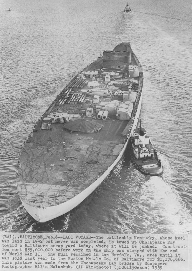

Carr has thrown his input in! Is there anyone else? Just looking at this picture:
you really see the potential of this platform. This project was just so, so perfect.
Any more mission statements or a list of missions and justifications by the contributers?
