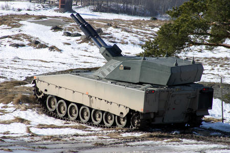

    1. Off the shelf, the Hamina is tough to beat, but if you want to recover 11m RHIBs, the hull will have to be stretched.
    2. Weapons: I would add an AMOS 120mm automatic gun-mortar turret (it has been tested on the CB90/RHBS).
      - Fires all NATO 120mm mortar rounds including PGM; a M933 HE Round: ~31 lbs; (roughly comprable to a 155mm howitzer round)
      - 10 km range (farther than the MK 110)
      - ROF: 16/12 (Max/sustained), but it can shoot 4-rounds in < 8-seconds, and has an MRSI of up to 8-rounds simulteous impact (!)
      :woo_hoo:
      - 48 round magazine
      - Fully automatic
    - Pricey, but what else are you going to spend that MFP 11 money on? :heh:
    :woo_hoo:
    - 48 round magazine
    - Fully automatic
[/list]
I was not a fan of the AMOS for the larger platform due to lack of range, but using the Mk VI as a platform to get AMOS in close and up waterways would be a great fit.
AMOS was found to be too large for the CB90 (52'x12'6"), so the Sweeds are developing a larger vessel to carry it, measuring 79'1"x17'2" - slightly smaller than the Mk VI platform.
The other option is the Patria NEMO - a lighter single barrel version of AMOS. That might allow the Mk VI to pack a Mk 38 and a NEMO without losing too much space. Nice for close in work
The PC's can act as 'big brother' to the Mk VI when forcing a beach.
