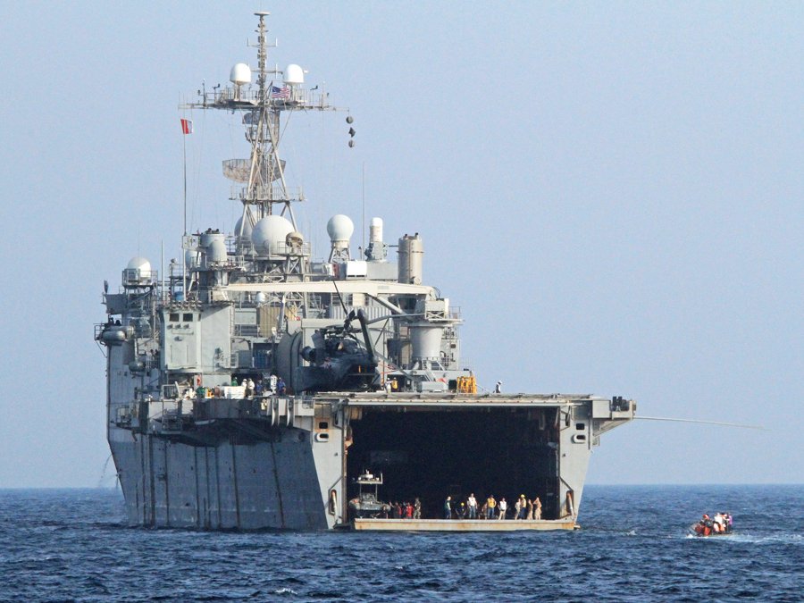

The Navy has brought back the USS PONCE from the scrap heap and re-named her as the USS PONCE AFSB (1)-15 as a mine warfare and support "mother" ship.
Her role is mostly mine counter measures, support and command and control.. They upgraded her electronic's along with making it better for the crew.
So here is my design questions for a future project in 1/350.
Base ship would be LPD-17 HUll which is a design that the navy has in current operations which would allow standardization of parts and training of crew.
What changes would you do.
1. Keep the twin Mast arrangements or reduce to one ?
2. Keep the same weapons and electronics, or add additional systems such as small VLS for ESSM Quad packs?
3. Millenium or phalanx?
Thanks
Major-B :thumbs_up_1:

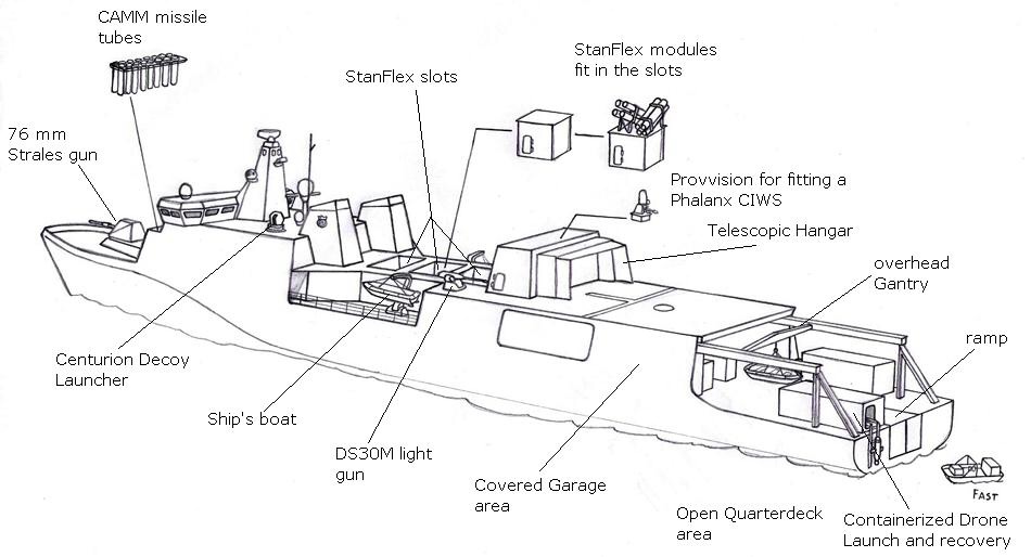

This project will be part of my What-if navy which will include several DDH's and several other replacements designs for the perry class FFG and DD that is designed to fill the role that spruance class DD used to have. So here is rough thought via google image search.. I think this design would fill the role of support ship that would handle either Mine Warefare support or be used for SPEC-OPS.. again this a work in progress not a final design... your thoughts?????
Thanks
Major B :thumbs_up_1:

PostPosted: Tue Jan 14, 2014 9:24 pm
Joined: Sun Jul 31, 2011 6:18 pm
Posts: 372
MAJOR-B wrote:
Understood and thanks for the suggestions/ideas...
Still working ideas, mostly on paper and talking to individuals who do a lot of scratch building or skills that greater than mine at current.
Thanks
1) that is a very nice sketch: she should build into a nice model.
2) If you have a boat ramp, do you need boat davits too?
3) Can you extend the aft overhead crane so you can lift things directly from the water?
4) Permanent vice telescoping hangers?

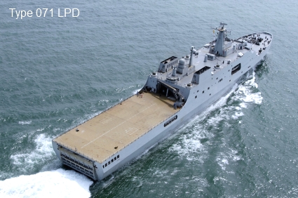

Update...
I have two kits narrow down as the starting point for this project.
1. 1/350 USS New York
2. 1/350 Trumpeter Type 071 PLA LPD
Since this is a What-if build right now I am leaning towards the using the type 071 kit
1. The design as it would allow for the flight deck to handle either an osprey or ch-53E as well as lamps III along with UAV Launch and recovery with some minor modification to the hangar area.
2. The container Area/ overhead crane: This would be plastic beams design would allow items to be picked up/lowered to bottom of the well deck. as I said still a work in progress.. input is welcome... Thanks :thumbs_up_1:
