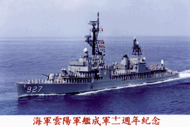

love the idea found these photos of the real ship and a Vetran's 1/700 model...
It seems the Taiwanese navy has replaced the 5 inch with oto-76mm and added a ton of blot on weapons...
I know it's what dave had in mind but it is a good visual for sensor's and weapons they did add..
enjoy
-Major B :thumbs_up_1:
