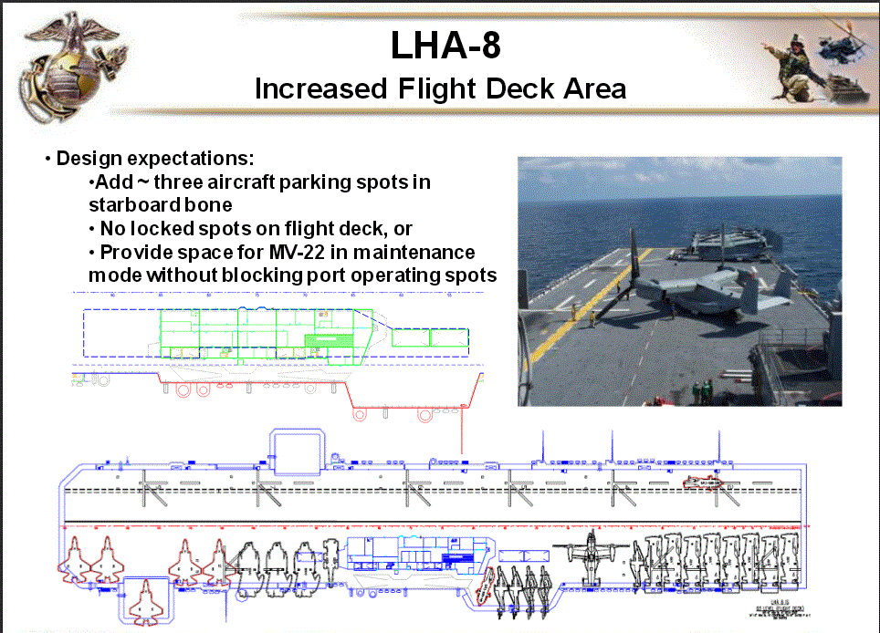

We have data on the proposed LHA-8, or next baseline of the LHA-6 class:
File comment: Shows a clear increase in aviation capability, even while retaining the well deck, troop berthing, and vehicle storage

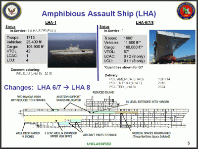

File comment: Shows proposed layout from above - illustrating the bump out forward of the reduced footprint bridge

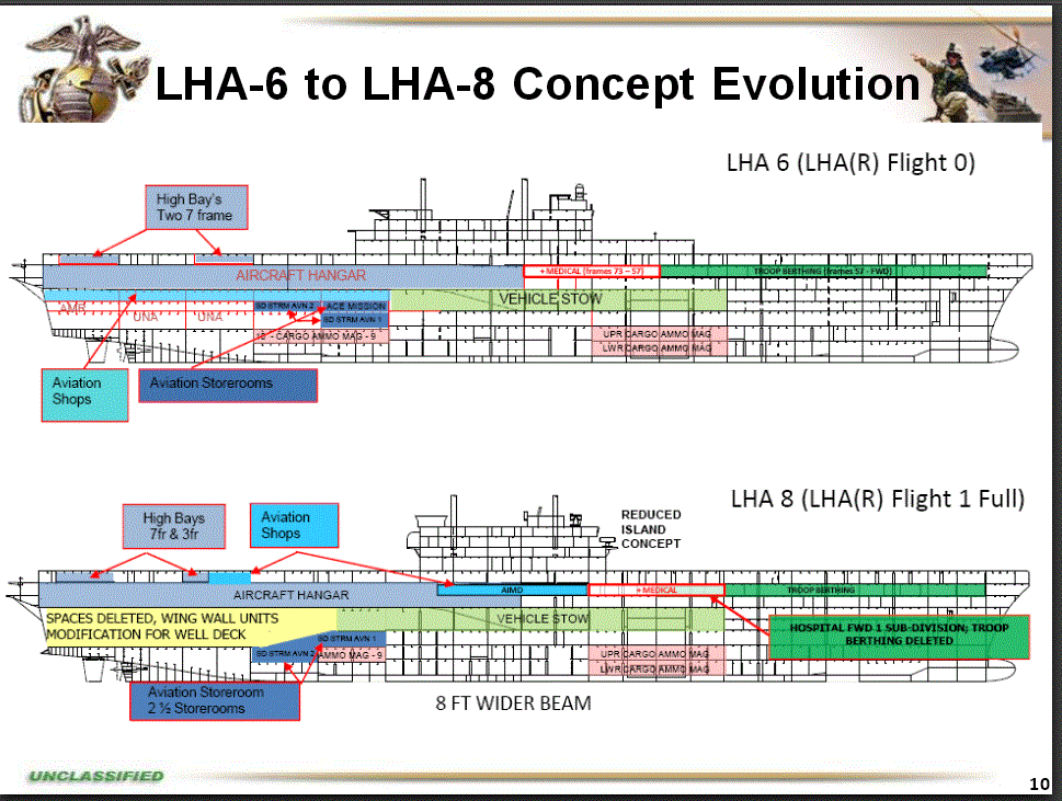

File comment: Shows the internal availability of space
File comment: More detail on the reduced Island footprint

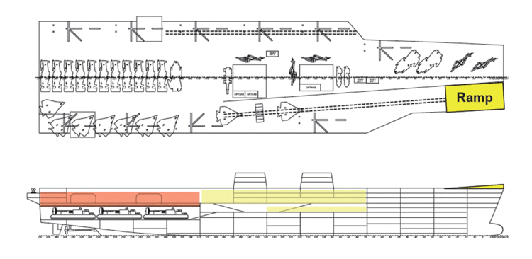

File comment: And the possibility still exists to extend the basic design

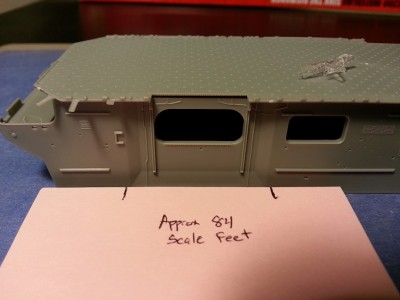

So I have received one of the two kits I will need to feebly attempt this.
I am using the Hobby Boss LHDs. Excellent kits. Happy with what I have seen so far.
To capture what I intend to do:

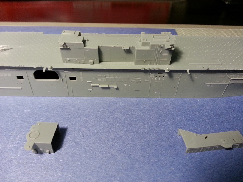

This shows the standard island as the LHDs are and as the kit intends:
The way the kit is constructed, the "Front Porch" and the after section of the island are already separate, facilitating the 'Reduced Island' proposed for LHA-8:
The larger effort will be extracting an elevator side and adding it forward, thus representing both the increased length of the "Plug Plus" and adding the proposed elevator forward, all at once.
The section to be removed:
You will notice that that is marked out as approximately 84 scale feet. the Plug Plus was to be 56'+21' for a total of 77'. I need to extract slightly more than that to get the proper hull shape for the elevator support, so I will be 7' longer than proposed. Oh well, not going to sweat that in 1:700.
Where it will be added:
The aftermost reference point is where the added section will begin, and carry forward.
Flight deck will also be extracted, in excess of the elevator section, to cover the area forward as well as replace the area which came pre-formed to accept the 'Front Porch'.
It should not be difficult to join to sections of the hangar deck to have the extended hangar visible when completed.

That section is flat - the hull curve actually starts where you see a light pencil mark on the model - so as complex as this will be to get right, I don't have to deal with hull curve or knuckle.
It isn't where the lengthening was supposed to go under 'Plug Plus', but probably the place where I can add the length and get the best modeling result.
Side note: "Plug Plus" included adding 10' to beam in at least one of its iterations - I don't intend to add any beam to the hull. Just way too much work along the entire length of the vessel, so I guess it is just "Plug" not "Plug Plus". I may add flight deck width, that remains to be seen.

PostPosted: Wed May 25, 2016 11:52 am
Posts: 484
Really grotesque capture of what the general intent is for the CHM/SCS, a slap-together job in about 10 mins with paint.
 Post subject: Re: CVM?
PostPosted: Wed May 25, 2016 12:02 pm
Joined: Sat Sep 15, 2012 12:12 pm
Posts: 398
Thanks for the PM.
I have several Iwo Jima's from squadron arriving today. They had a great sale last week on the LHD-7.
The general layout looks good.
Major B :thumbs_up_1:

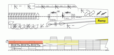

I found this design on the Net. Would something like this work, but take out the landing craft well deck, and make a few other changes?
http://img.ph.126.net/c7qs1x1i_SkfgFOo0 ... 839501.gif
