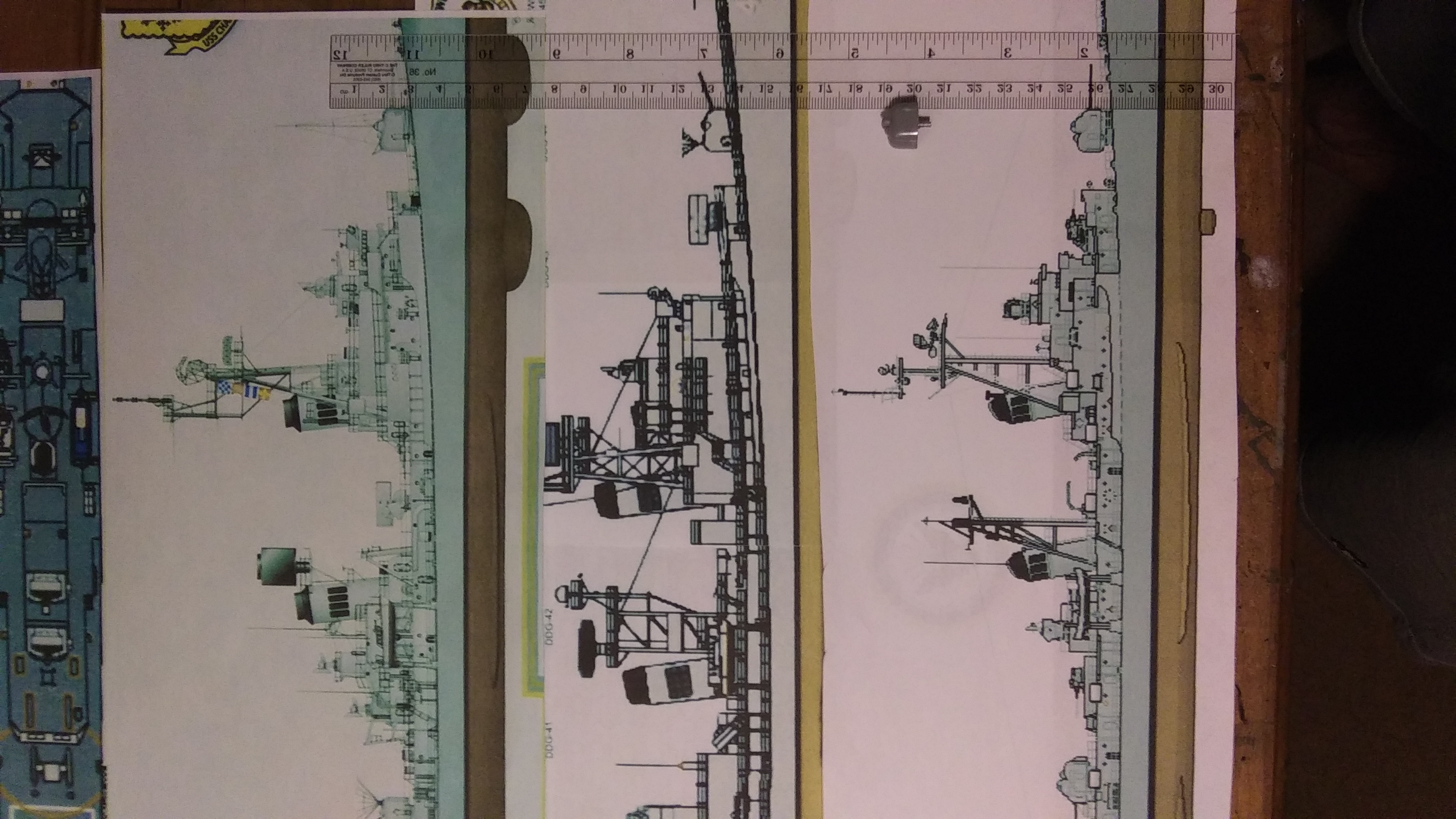

printed up some images to work with, plan on drawing up some sort of ship build plan, to do the measurements, and figure out space needed for the ship systems/weapons/sensor fit, the scratch build component size:
using a(atlantis 1/320 F.Sherman kit): F.Sherman enlarged, adding 33' to the lenght at the waterline, and 18" to the beam
listed below is new build conv. what if data / compared to orignal F.Sherman data
build conv.DLG 1957-59 / F.Sherman DD original build 1952
LWL 440' / 407'
beam 47' / 44'-11.5"
Draft(full) 15'-6" / 15'-0.37"
SHP 70,000 / 70,000
speed 31.8 kts / 33 kts
Lt ship* 3,370 / 2,734
Full load* 4,670 / 4,916
Endurance** 4,300 / 4,500
1xtwin mk10 Terrier lchr / -----------
1x octuple ASROC / -----------
1xsingle mk42 5"/54 / 3xsingle mk42 5"/54
2xtwin mk33 3"/50 / 2xtwin mk33 3"/50
2x triple mk32TT / 4xsingle mk25 TT, & 2xsingle mk4 dropside ASW Torp lchr.
-------------------- / 2xMk10/11 Hedgehog
-------------------- /1xDepth charge track w 12xDCs
*long tons
** at 20kts, nautical miles

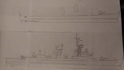

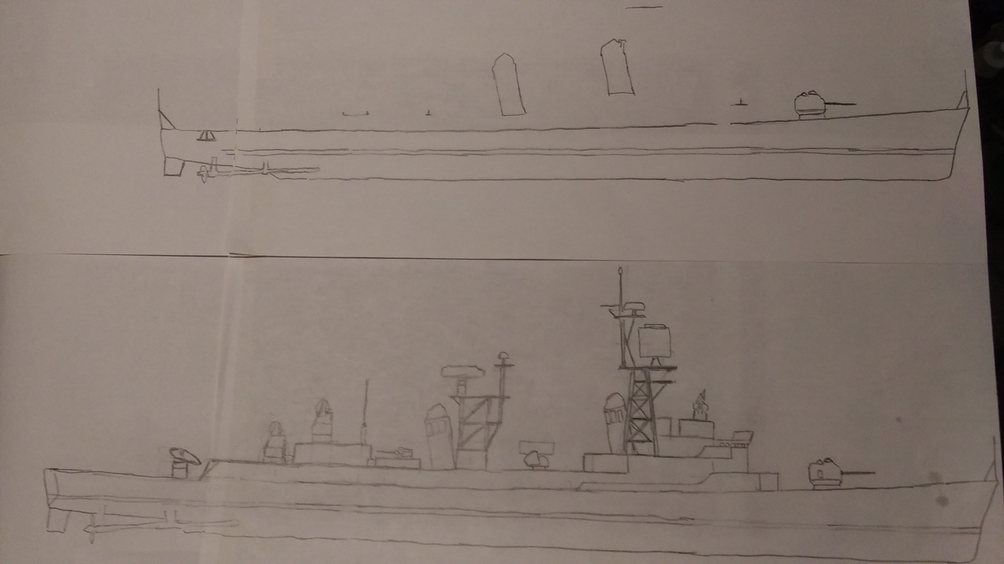

did a rough draft drawing, still in the drafting phase until the model kits arrive in the mail.
top outline is a F.Sherman, the below outline is a F.Sherman with hull extended, with possible wpn systems, and the location of ship systems such as smoke stacks, etc. still playing around with this, thought I share what iam thinking at the moment.

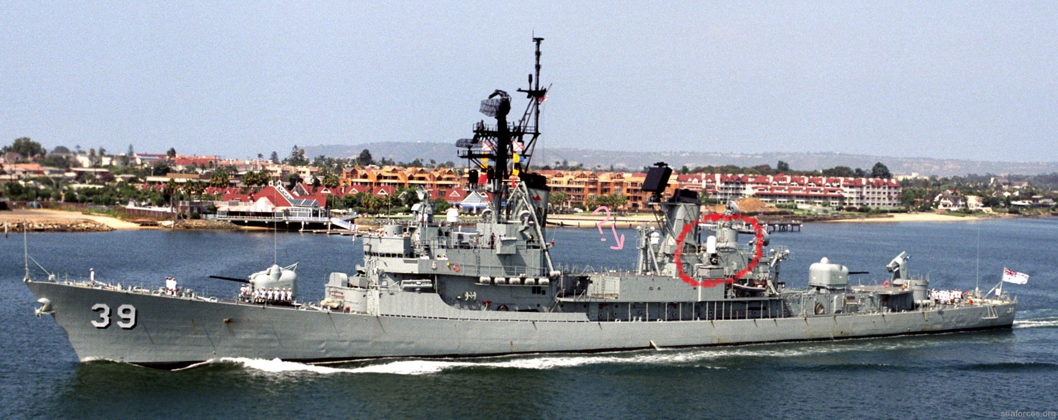

online photo of Australian C.F.Adams: shows Phalanx CIWS adjacent to aft stack, *possible location for where to add a phalanx in the new builds or upgrade mods. Note there no Ikara ASW system ? in the original ASROC area, photo also shows superstructure expanded in this area at the level 2.

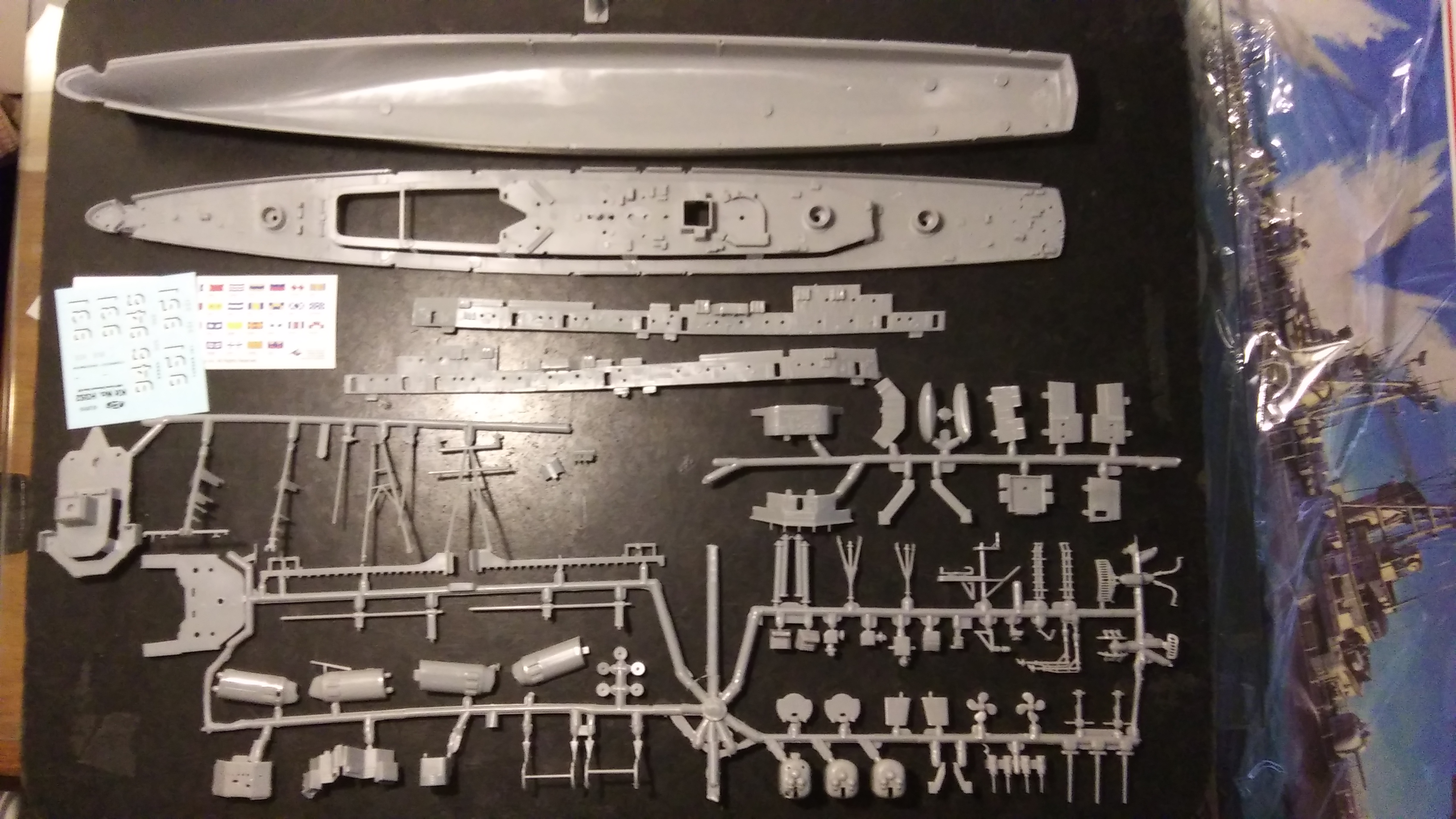

Just recieved a third Atlantis 1/320 scale F.Sherman class model kit, posting a photo as out of the box not started. the first two kits already built, first one as DD-931 around 1960 before any major upgrades, second one as DD-932/DDG-32 with Tartar conversion around mid 1970s.
Plan on starting the third kit this weekend, cut the hull add an plug/extension to the hull, this build will be something between a DDG2 C.F.Adams class and a DLG Farragut/Coontz class in size.
