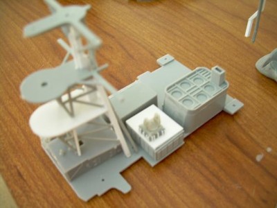

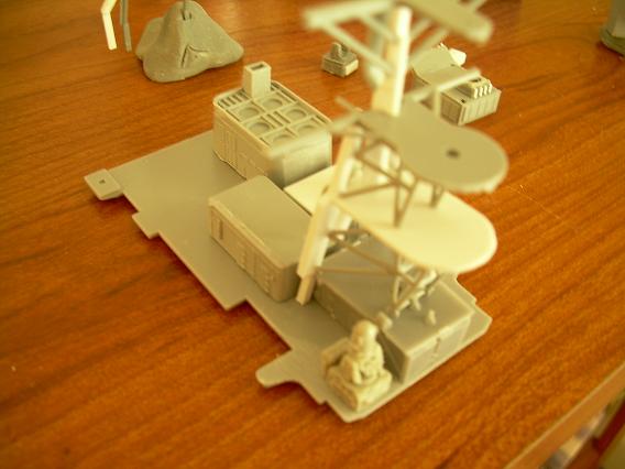

My idea is pretty much a VLS version of the Kidds. They would be equipped with a modern version of the New Threat Upgrade. I don't know how much upgrade would actually be involved becaues the system, epsecially in the late '90s was awefully advanced, but CEC would certainly be part of the package.
I would involve the Mk71 MCLWG for the forward mount and upgrade the aft five-inch mount to the Mk45 Mod4.
The Sea Sparrow mount would be removed and the massive void under it would be filled with another 64 cells of VLS.
SPG-51D/E illuminators would be installed
SPQ-9B in place of the 9A on the main mast
SPS-48 and 49
2 RAM mounts
Phalanx Block 1B in place of the current Phalanx
Permanent UAV antennas
Mk23 TAS
Mk38 Mod2 (would unfortunately be installed. They really suck.)
Here are the pictures I have so far.

The NTU on the Kidd’s was fantastic. I was onboard USS Scott during the early 90’s. We operated with two Aegis cruisers most of the time. During several operations the Scott out performed the Aegis systems. We could detect, out track, and out shoot Aegis. We did a simulated shoot down at over 100 nautical miles. Aegis at that time could not due to limitations.
During one set of operations with the British two Aegis cruisers could not protect the British ships as good as Scott. They ended up calling us the Terminator.
The VLS system reduces the effective range of a missile as compared to that of a missile coming off a MK26 launcher.
The big drawback to the Kidd class was the inability to launch Tomahawks. Also they were restricted to only carrying the SH-2F helo. We could land anything, but were only allowed to carry the Seasprite.
The engineering plant was identical to that of the Tico, which was improved over that of the Spruance.
I like what I am seeing from you so far.

Rockin' posts! The exchange of ideas you guys are having is very informative. So, let me ask you, I saw you said the displacement of existing DD-963 hulls could only support 9,200 to 9,300 tones but could not support 10,000 tones. With that in mind, could a DD-963 in your opinion support the addition of another 64 cell VLS pad back aft in the place of the Sea Sparrow launcher?
PostPosted: Tue Jul 21, 2009 8:34 pm
Posts: 1111
Some very interesting thoughts put forward here.
I would imagine, a Mk71 modernized, had it been retained, would have a newer Low RCS layout to it. And it might have, of course, been made into a slightly more compact version.
I always thought a VLS Kidd would look neat, so I look forward to seeing the design in action, Dave. She should be quite something to see.
