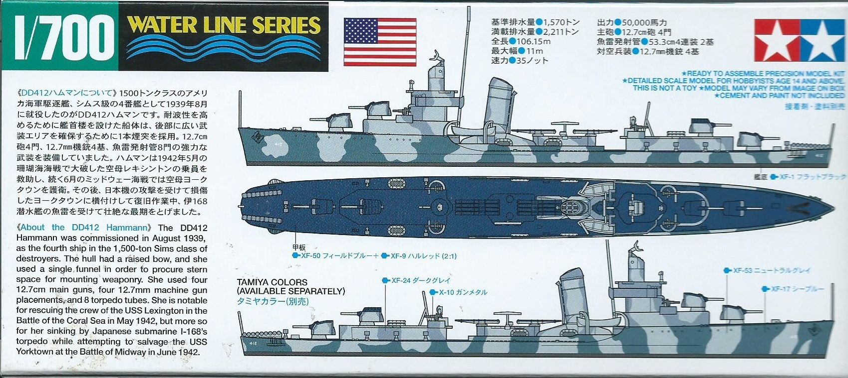

Hey Aekold,
Have you tried the Deck Blue analogue that Tamiya recommended on the instructions for the 1/700 Hamman kit?
The instructions, as you can see below, recommended XF50 Field Blue + XF9 Hull Red for the deck colour with a 2:1 ratio of the XF50 to XF9 in the mix.
While the scheme shown in the instructions below is MS12 instead of MS21, both use deck blue for their horizontal surfaces.

Obviously no, as it is not available as a spray. I'm sticking to Testor dark sea blue for USN decks
