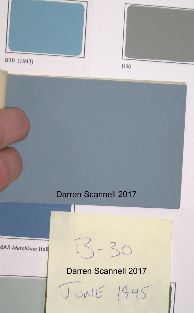

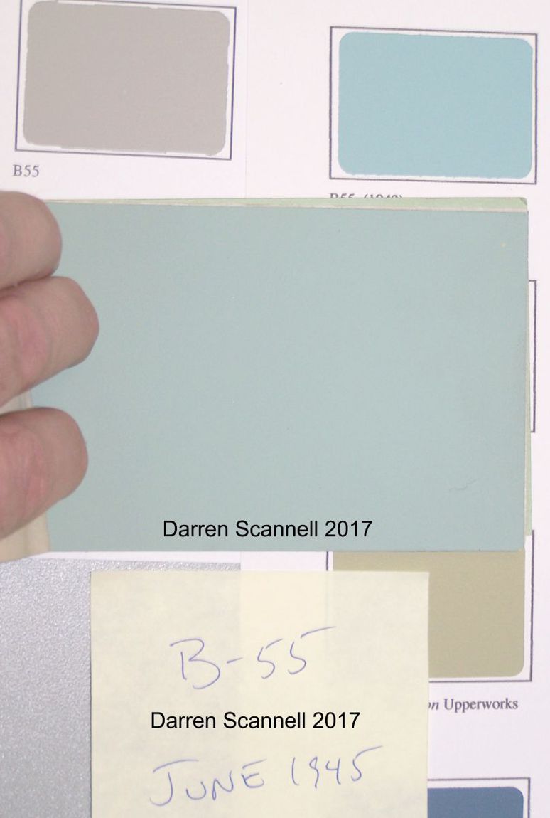

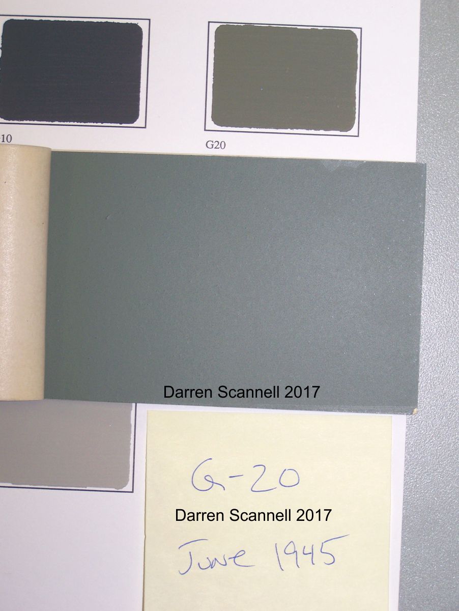

PostPosted: Wed Dec 27, 2017 5:10 pm
Posts: 934

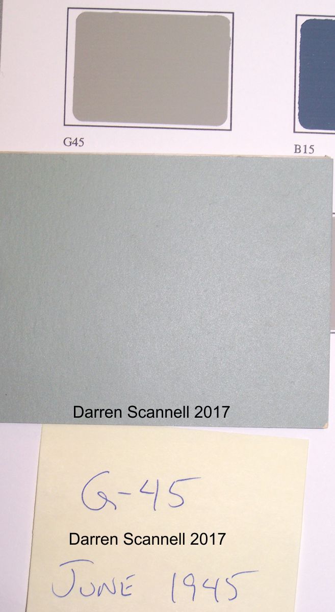

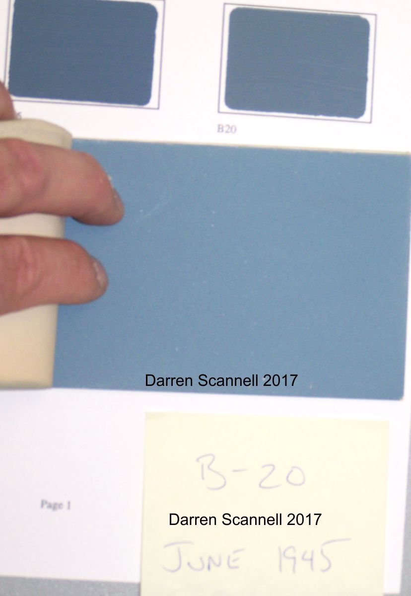

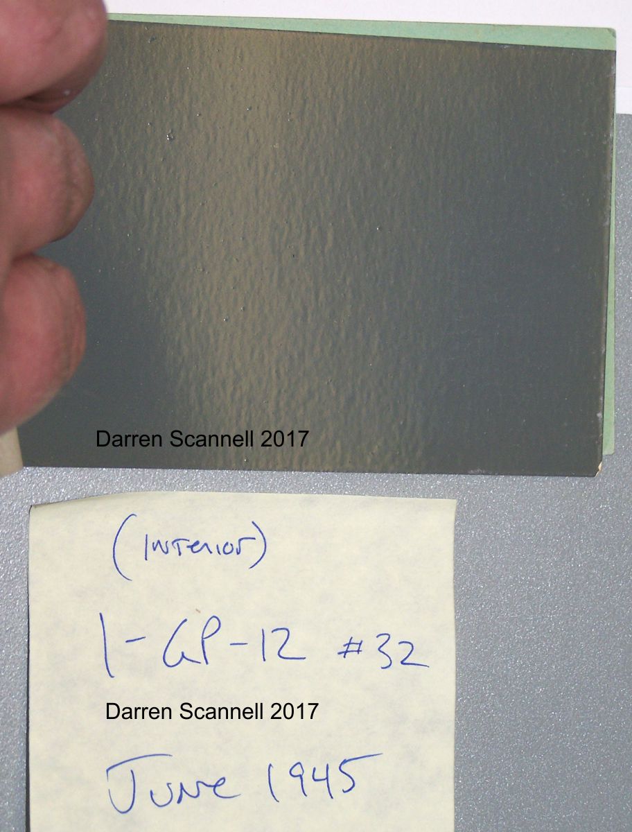

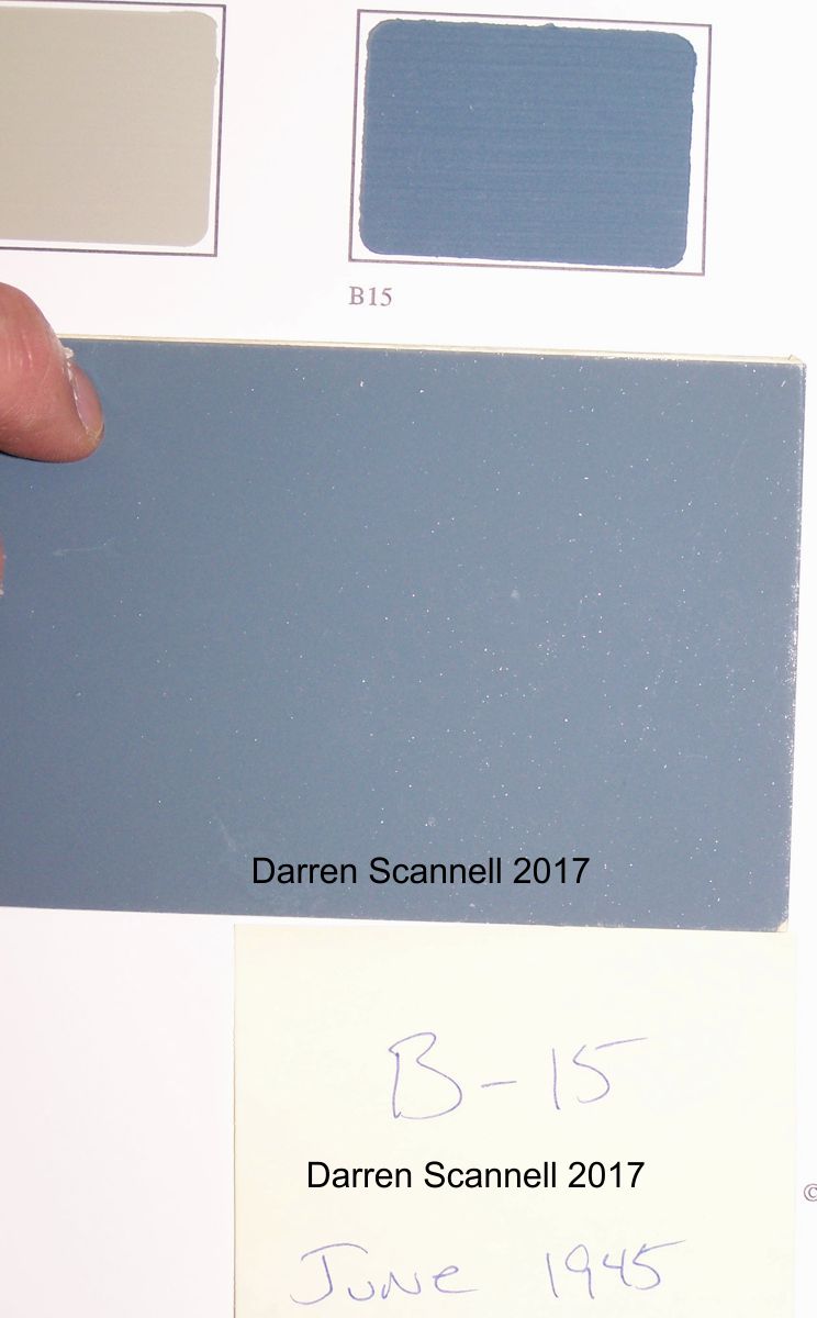

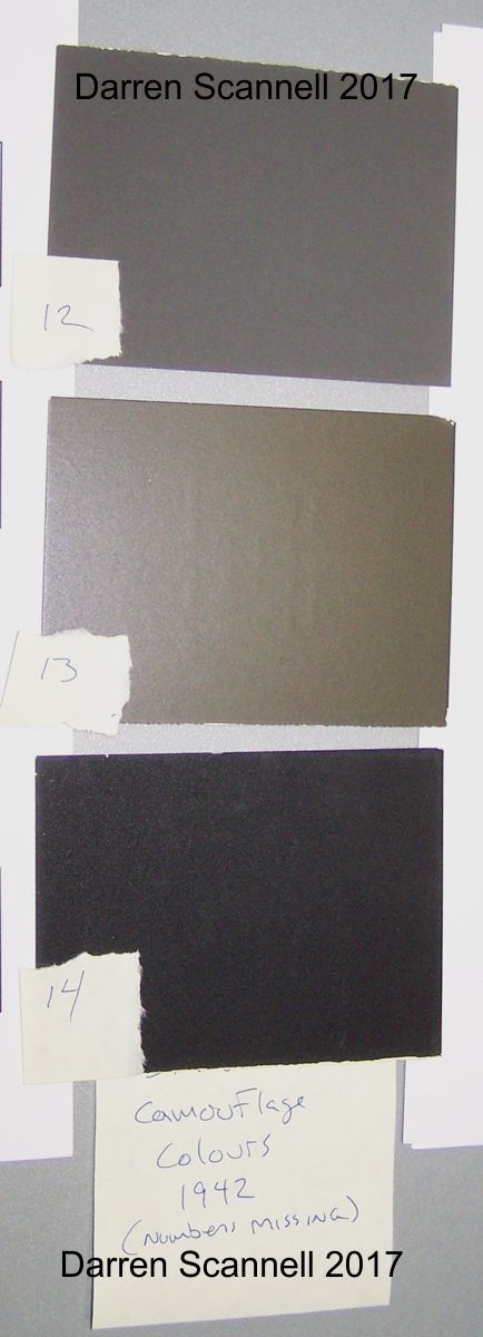

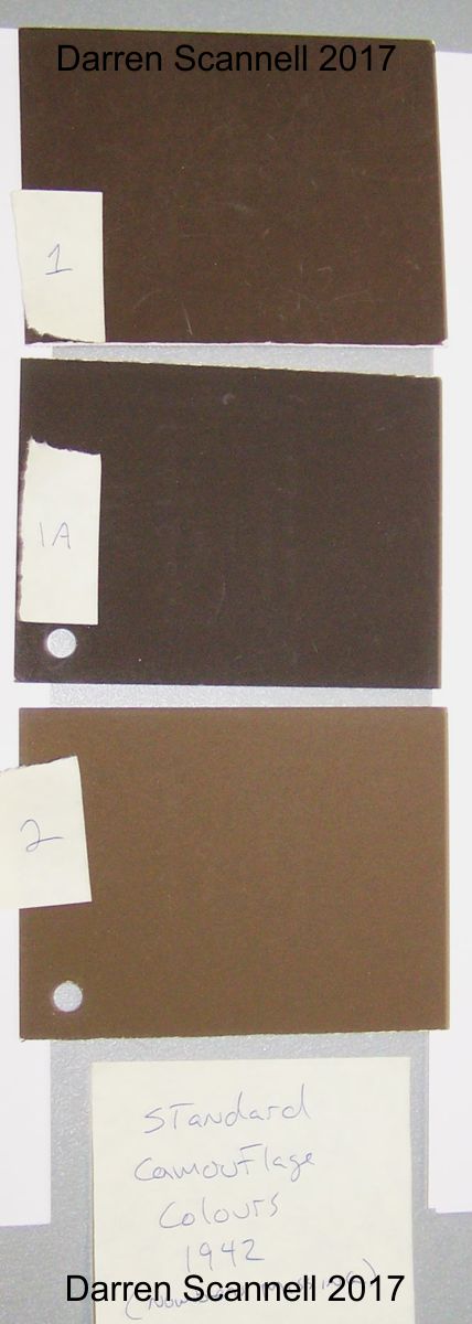

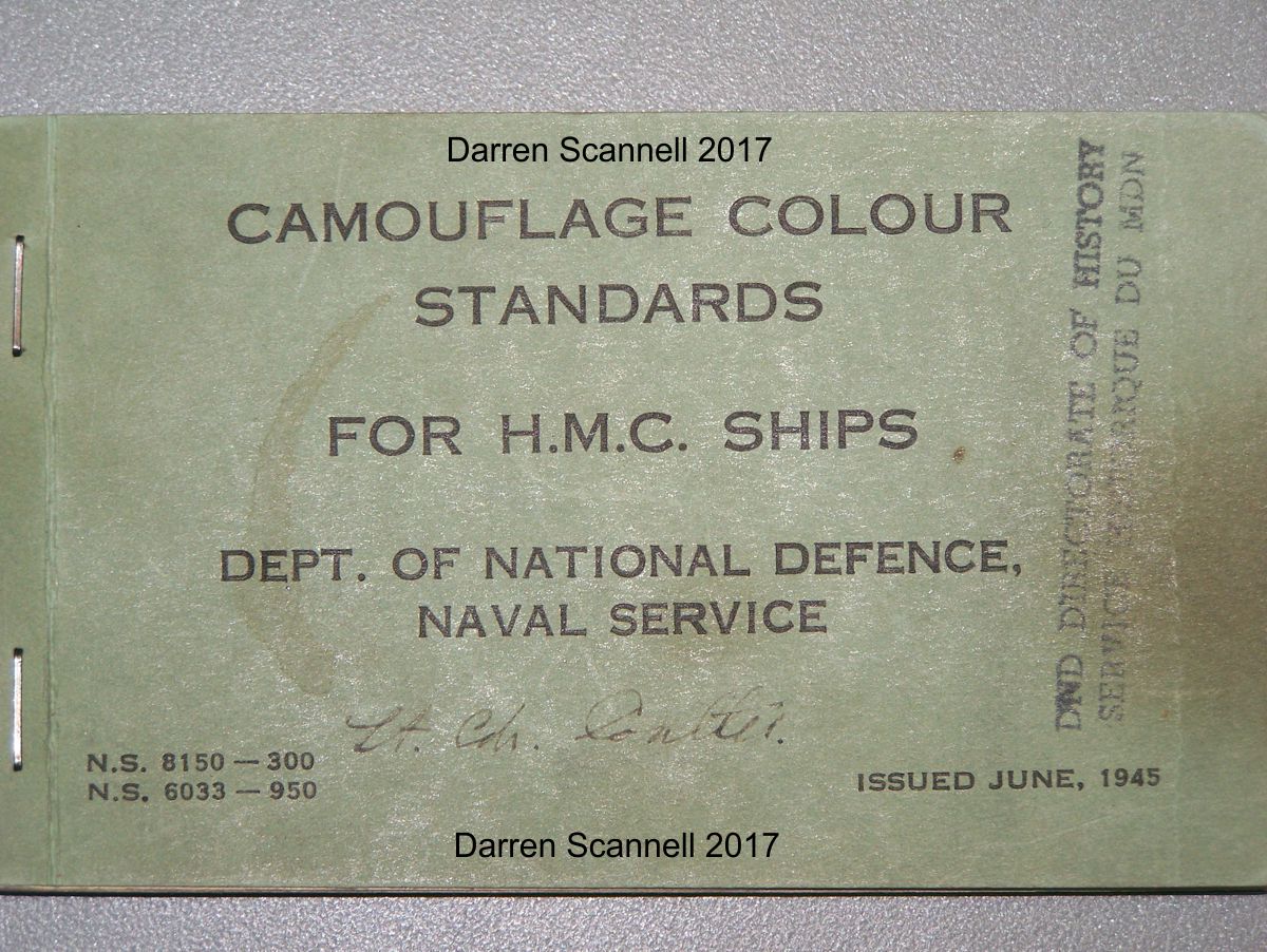

Okay, okay, my bad. That'll teach me for being lazy and copying colour descriptions from other websites.
Here are photos of the HMC Colour reference from 1945.
Darren (Admiral Hawk)

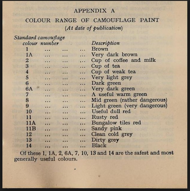

And for good measure, official Army descriptions. (With Opinions!)

Wow, Thanks guys for the responses! And Happy Holidays to you!
James - Surprised to hear G45 is a lt. grey like 507c, and not 'warm grey'... that changes a lot of RN ship profiles!

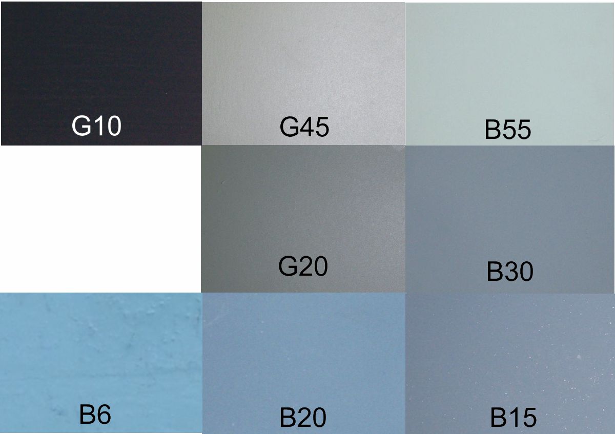

Maybe this will help bring it all together,
G10 shows a bit too dark, bad photo.
Hi Darren, that's a very useful post and I have just put 2 and 2 together and realised that Dick had previously spoken of you to me in private regarding these.
May I PM you about it?

So after reviewing the videos and photos of the ships two things jump out at me.
1 - In the scheme Huron is wearing, the fwd and upper panels do NOT look like G45. It Looks more like B30.
and,
2. The scheme Athabaskan is wearing looks like B30 as well, however, sources say it is B55.
So, the question I have is, does colour movie film of the period affect the tone of colours as much as black and white film of the period can? Or are these colours completely different than currently believed?
