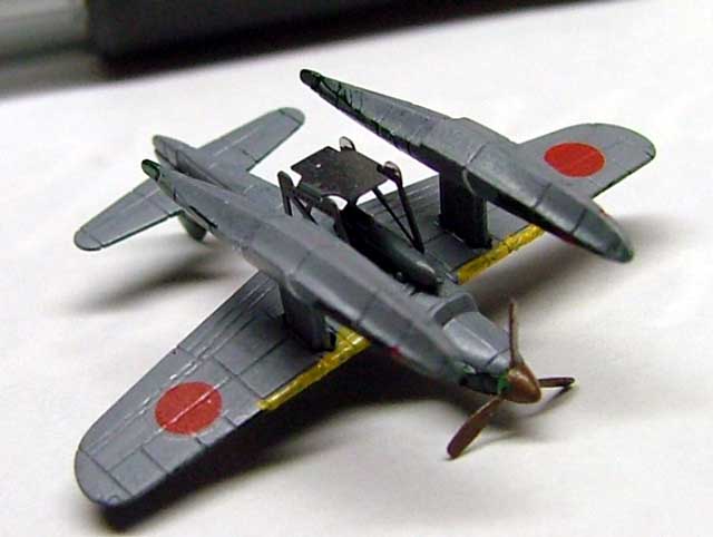

Once you've clicked "Add the file" for your picture, and the picture has been uploaded, there is new option under the reply box called "Attachments". Next to that is a drop-down box with the names of each of your pictures. Select the one you wish to put at your cursor in the reply box, then click place inline
So it'll look like that, as opposed to being put all at the end of the post.
Note that if you don't fiddle around with the "Place inline" option, all uploaded pictures will be placed at the end of your message.
