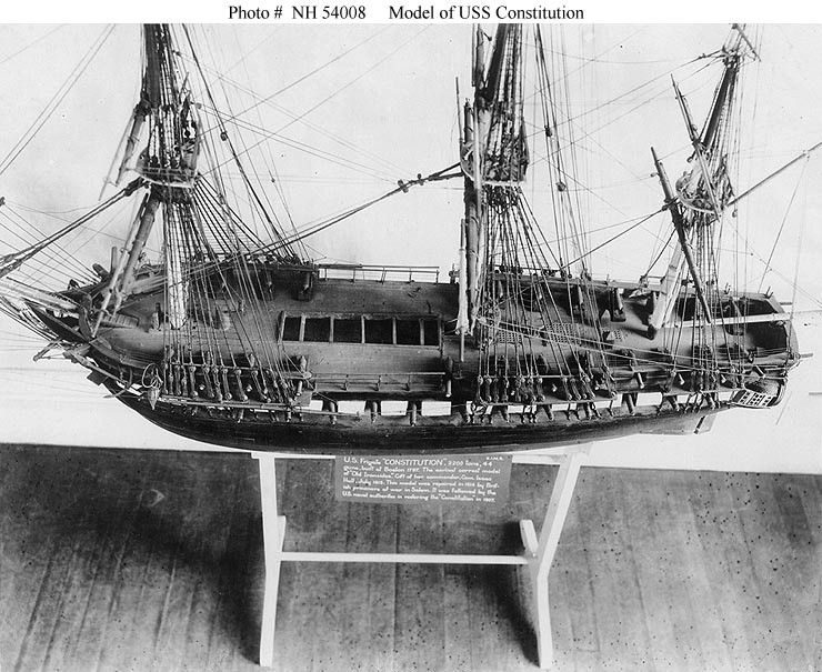

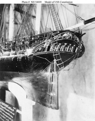

Here are photos of the famous "Hull Model" and photos of the Smithsonian Museum's 1/48 scale model of USF Constitution.
The three photos below are National Archives photos of the famous "Hull Model" named for the model's first owner and ship's captain at the time, Isaac Hull. The Hull Model of USF Constitution was made by the real ship's crew and presented to their captain, Isaac Hull, as a gift just after their War of 1812 victories. The model now rests in the Peabody Museum in Massachusetts. Since the model was made by actual crew members it is considered to definitively show Constitution's true War of 1812 appearance. Certainly the ship's own crew knew what their ship looked like and built an accurate representation for their captain.
Of the many injection-molded plastic kits now commercially available the Revell 1/96 scale kit most closely resembles the Hull Model.
Note that Hull Model shows that Old Ironsides only carries gun port lids at the extreme bow. Period documents confirm that Old Ironsides carried no hinged lids at this time. Those lids that were present were removable and stored below decks prior to going into action.
Also note the coloring of the masts and fighting tops (white) and yards (black) and that this model of Constitution does not carry her name on the transom.

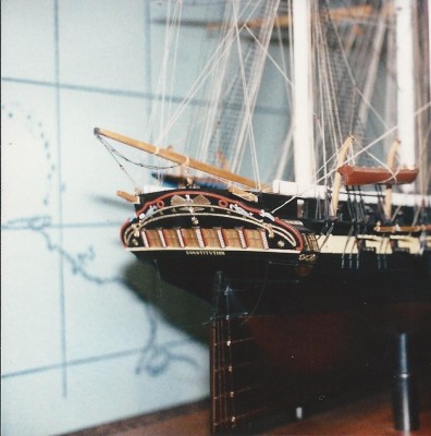

Compare the Hull Model photos to those of the Smithsonian Museum's 1/48 scale USF Constitution model which was built from early plans and using the Hull Model as a significant reference. The Smithsonian's modeler(s) chose to paint the gun deck stripe an off-white, very similar in tone and hue to what we today might call "radome tan". The rigging of this model is nearly identical to the Hull Model in arrangement.

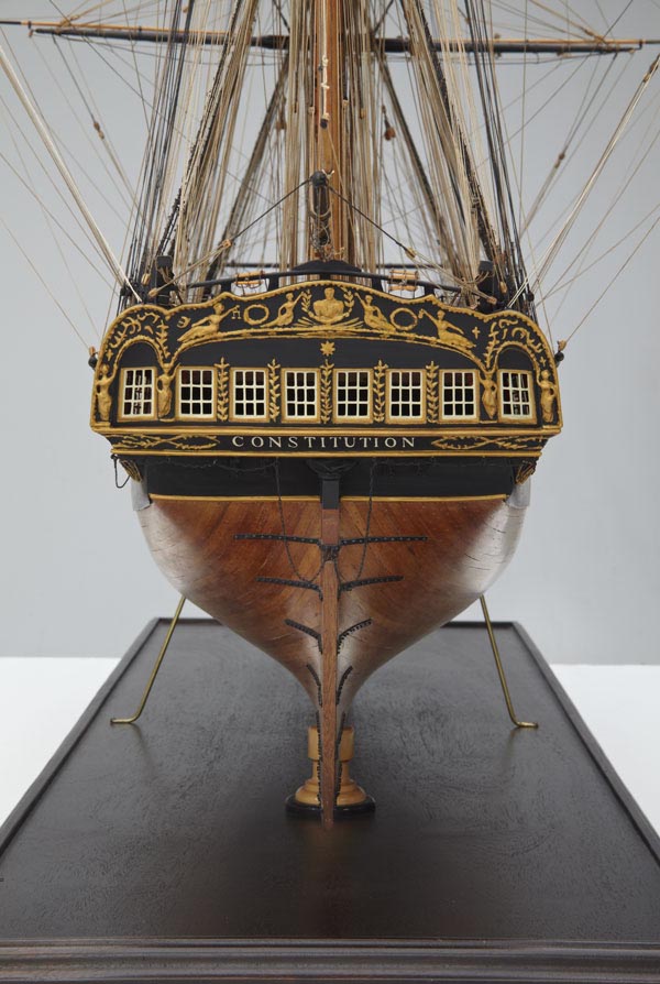

Compare the 1804 Corné painting to this superb model in the possession of the US Naval Academy Museum.

Also note that, like the Hull Model, the name "CONSTITUTION" does not appear on the transom.

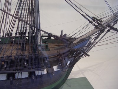

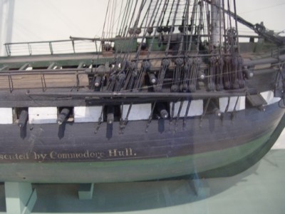

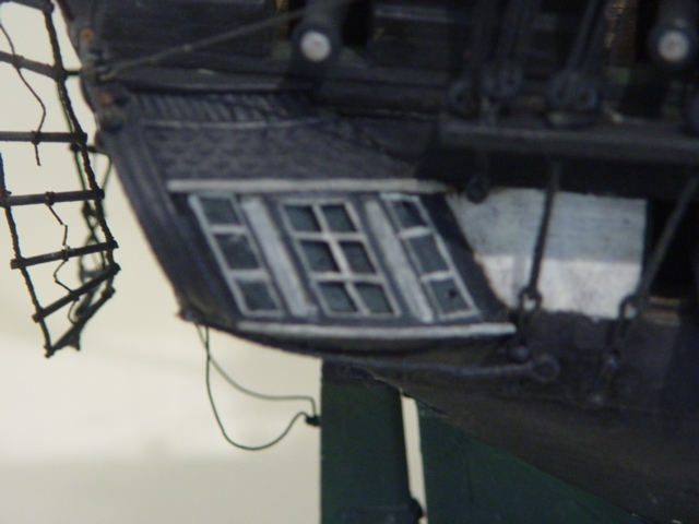

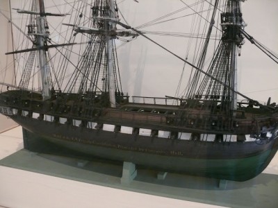

More Hull Model photos taken by Steve Hawley and used here with his permission.
