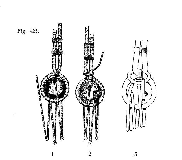

I am attempting to repair a tall ship that my Grandfather handmade of the, I believe, Mayflower 1. My question at this time is how to tie the shrouds to the dead eyes. Terms of all this is new to me, so if I use them wrong help me out. Tying meaning, which hole of the 3 to start with, sequence to tie (which hole next and threading front or back or visa versa) and how to tie each end together. Not sure if the pictures attached to this post will show. If you know where I can get a picture to see how the rest of the rigging is tied would be very helpful.

There's this:
http://www.youtube.com/watch?v=oU-h8i4LtPM

Thanks. That was good just wish he had zoomed in a little to show the threading.
I think that will help.

Does this make it any clearer? Views 1 and 2 are from out board.
Steve
SCOTLAND
File comment: Deadeye arrangments.

Perhaps you should first verify what ship you have. The period will be very important for the way the deadeys are turned in. this changeg quite a bit over time and was different between countries.
