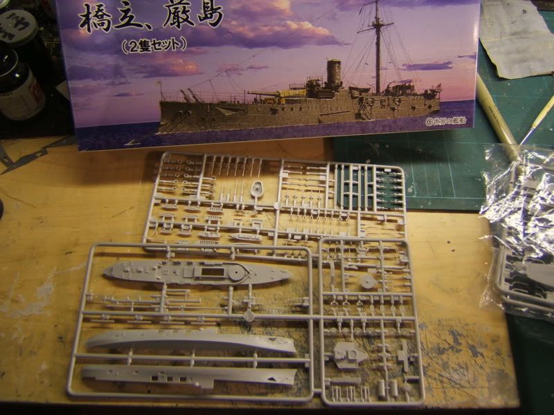

Here's my entry for the group build: The Sealsmodels 1/700 Itsukushima as she appeared in the Russo-Japanese War.

Nice project, which has some common history with my project. What references will you be using?

Pieter: I'm basically using the box top as my reference as I was not able to find many photos online, or any English language history documenting the changes made to the ship or the differences between Isukushima ans Hashidate. I'm actually finished the build, but haven't posted the photos yet. :cool_2:

When I did my Hashidate (backdating her from the Seals kit) I found some references. I have the warship article by Lengerer and Itani as well as some other pictures. PM me when you're doing Itsukushima.

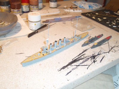

My entry is HP Models 1/700 HMAS Sydney, 1914. I hope to complete her (and the IJN torpedo boat destroyers) by the end of the year.

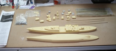

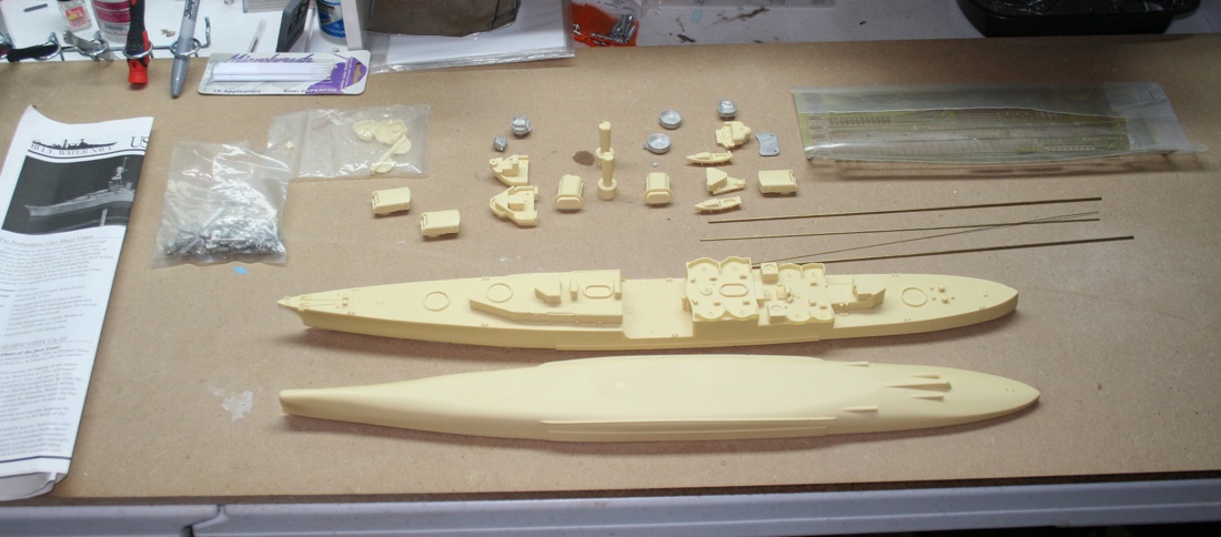

Ok, now that this thing is officially going, here is what I will be working on.
Bluewater Navy's 1/350 USS Houston

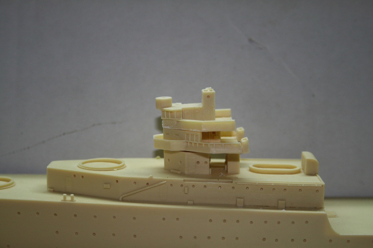

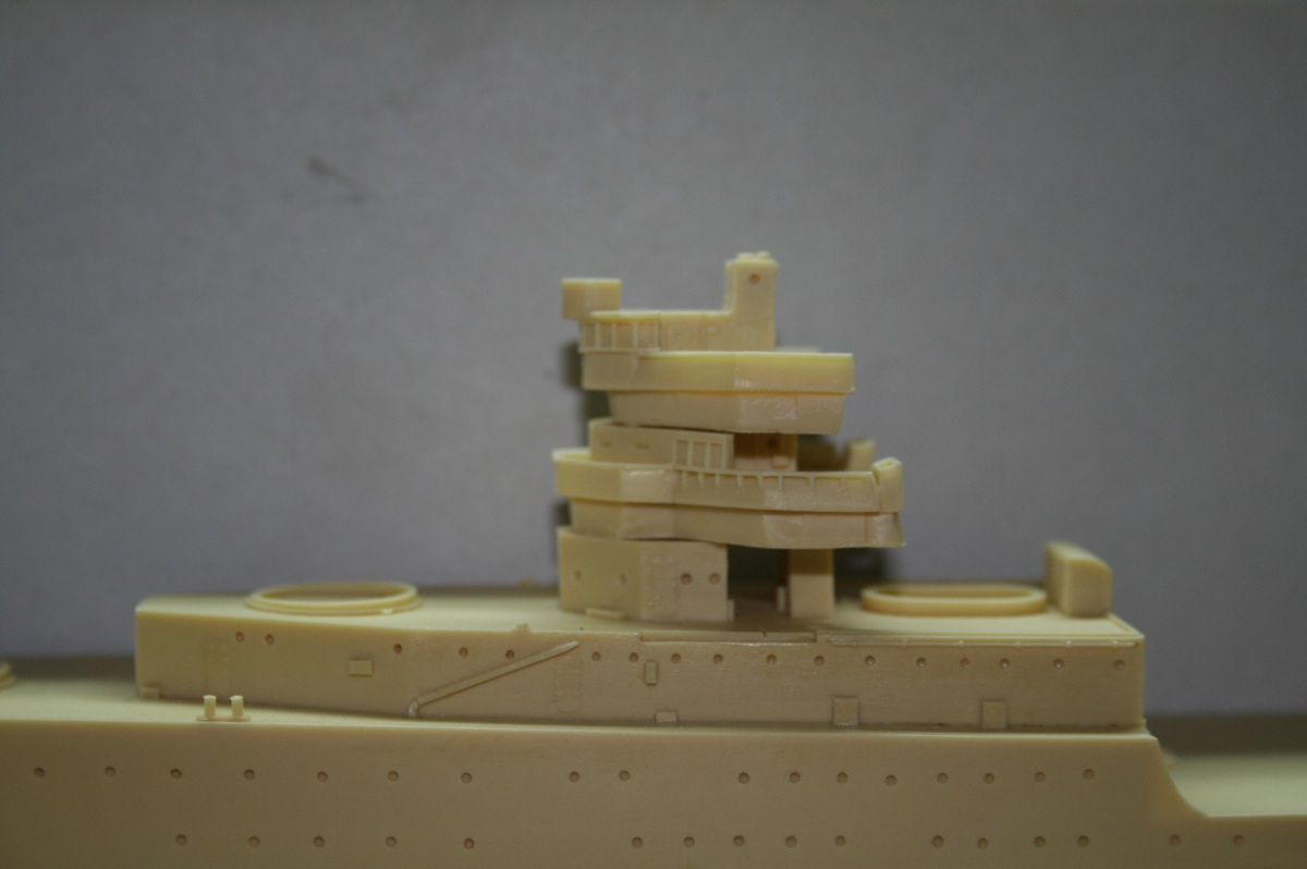

I will be building her as the USS Chicago as she was when she was torpedoed in the first battle of Savo island. I haven't done much other than take the parts out of the box and give the kit a good going over, I did however notice the overpour on the bridge levels was much thinker than usual.

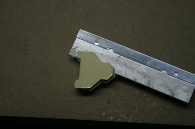

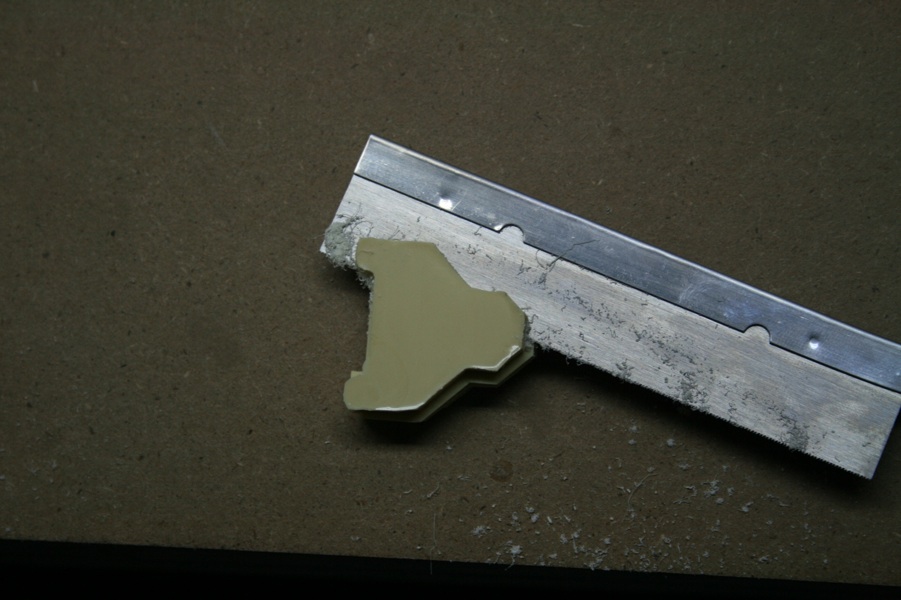

Of course, I just had to see if this was going to be a real challenge or nothing at all. So I contemplated how I was going to tackle this as I feared that the old power sander would produce too much heat with this much sanding and warp the part. I noticed how the overpour was recessed from the edges of the part so I thought about a razor saw, it would lay flat against the bottom of the piece I wanted and remove what I didn't.
What do you know, it worked pretty well only taking about 5 minutes a part. It would have been faster but I kept stopping to check my progress and making sure that it didn't start to go off course. No with a little sanding, these pieces will sit real nicely.
