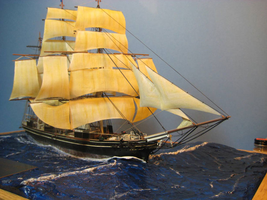

thank you..I look forward to the pics....I should be able to kit bash...I dont know if you have seen my gallery here...I do more sailing ships than gray ladies...this will be a nice change of pace from my last build Cutty Sark.
She's a beaut Bill!! :thumbs_up_1: One day I'm gonna build her again :big_grin: First real ship I built as a kid was the 1/96 scale and the instructions weren't in the box. I was a very determined 11 yr old kid & built her from pics from the library books.
