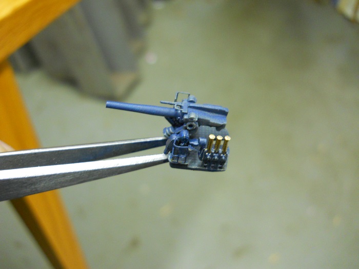

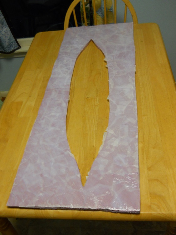

All righty now! .....I'm back at the bench finally and taking any spare time I have to begin wrapping up my Arizona. Lately I've been focusing on the little details, touch-ups I wanted to get while I can without knocking something off my model before going further. That completed and not really worth photographing, I've started on the sea base. As a reminder I plan to mount my model waterline underway depicted about December 2nd just prior to the attack. The other items to date are the .50 cals which had to be stripped down, barrels changed out, as well as the 5"25's. I'm trying to get the main superstructure/tripod command top completed and rigged with the halyards and slowly work my way backwards and outwards. At a certain point I'll have to mount it in the base, so from there on I'll have to work over the sea diorama, which will be even a more challenge. My next subassembly will be the ship's boats(next post), wrapping up the funnel and mounting it, then finishing out the main top/tripod mast. I will keep everyone posted on the progress.
File comment: I'm using the technique that sergeantx has used and explains quite well in his tutorial. This a before shot with the wave troughs worked in.

File comment: This is after I've applied the paper/gel medium over the pink foam board.

File comment: Here's a picture of a completed .50 cal water-cooled MG. It was difficult getting it in focus!

File comment: One of the 5"/25's about 90% completed..

Water cooled Ma Duce, very interesting! I'll have to read up on the water fashioning, something I have been assiduously procrastinating about for Alaska.
Look'n good!

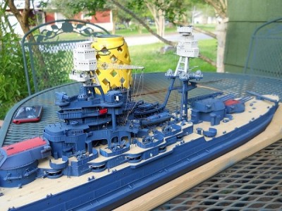

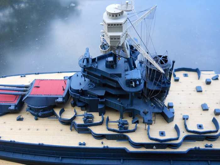

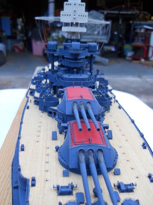

Ok, time for an update. Here's some picture I snapped before it got dark.. I've been wrapping up the main superstructure on the Arizona, taking care of ladders and other small details. The signal halyards were painted to show some grime as I didn't want to show them a monochrome color at this scale. Rarely are they bleached white and get a grey brown color. I finished my funnel and installed it. Now I move to the ship's boats and mainmast area, working aft.

Man, that's looking excellent!!! Good detail & paint work, I'm in awe!

Paint, the light drybrushing, the uniformity of work. Absolutely outstanding work.

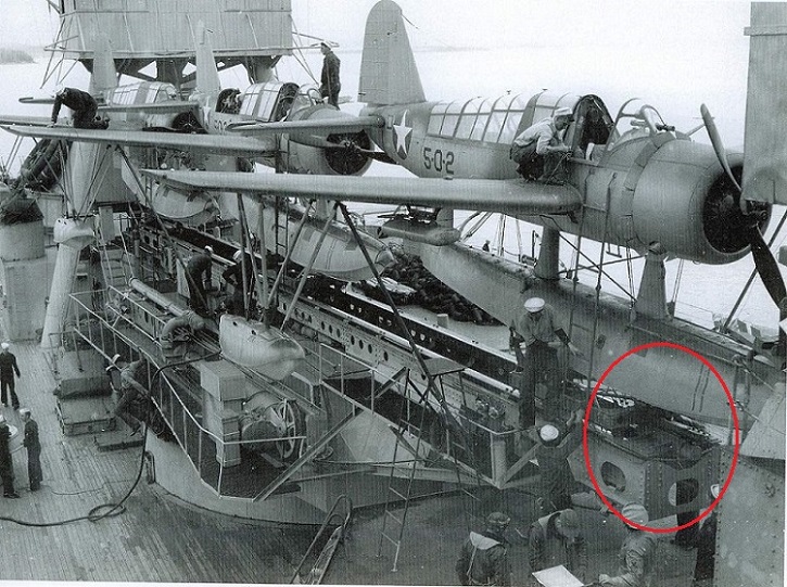

While building the ship's boats, I broke away and modified the turret 3 catapult. It was a P4 mod1 which have a single shock absorber on the end as opposed to the doubles on the P6's..

File comment: This is on the USS New York.

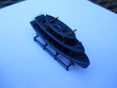

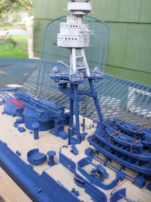

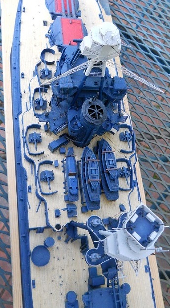

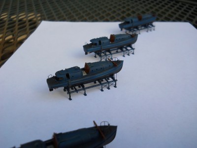

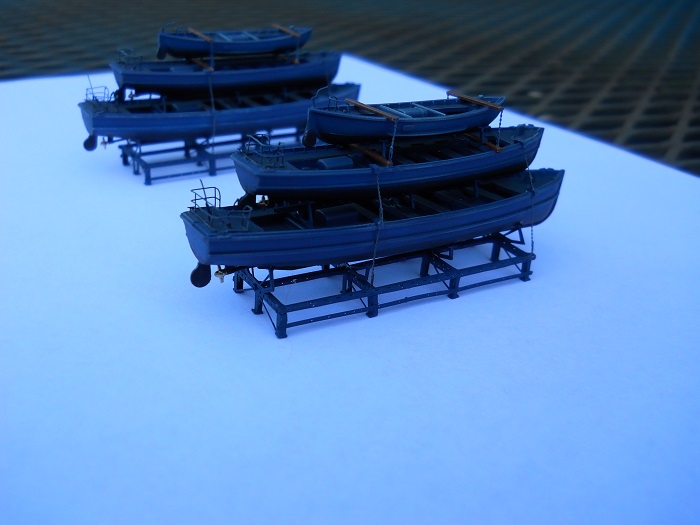

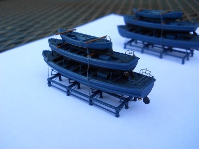

Alrighty now! I've had time to work on the ship's boats finally and have them completed. I spent some time researching the correct way these were secured to the deck and have got it pretty close. For all I used spare PE chain with some turnbuckles from North Star. Cradles are Eduard, which I added a small plastic square at the bottom of each leg as the mounting plate.
Future Project: TBD

Before I added the boat "stacks", I installed the aft stays on the funnel. There were more forward but it was too late to figure out where they went and mounting them.
File comment: Boats mounted, stays painted

Hey Randy: Looks like you are the sole contributor to this "Group Build." Boats look great, the time and effort to add the proper securing gear is paying dividends. They really look the business, the stays are a nice touch as well, a lot of modelers leave these off but they are an important detail.
Looking forward to the next update.

Yes! Incredible models within models!

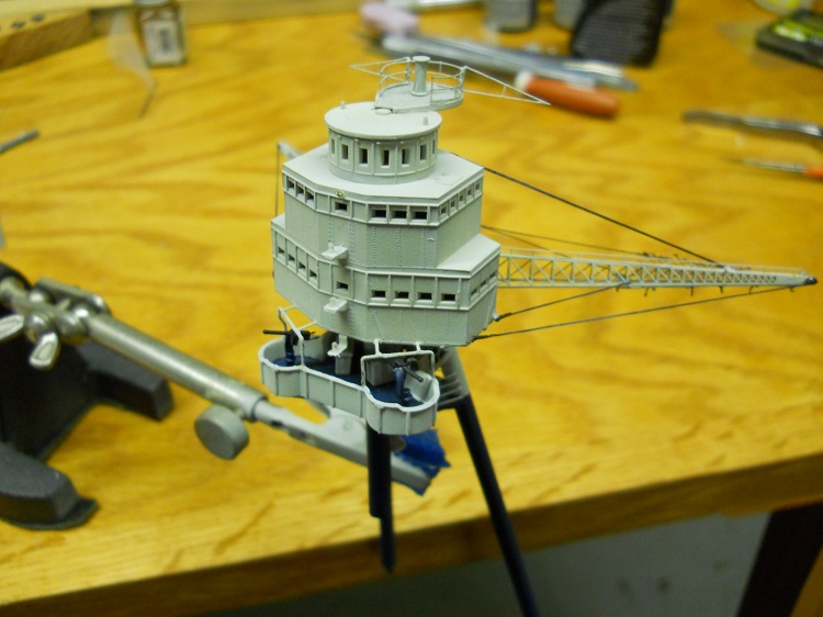

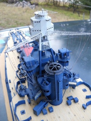

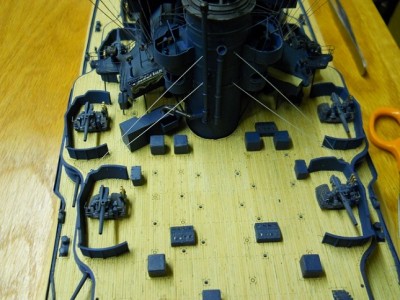

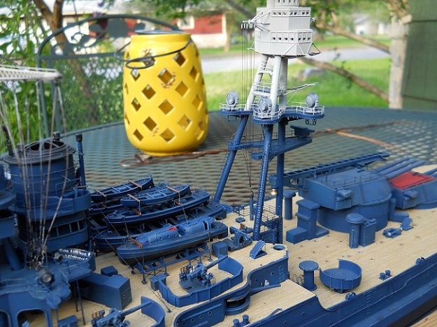

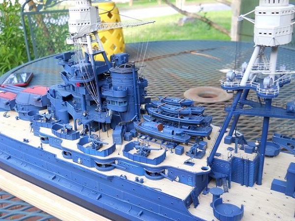

Ok all, time for an update. I've mounted the boats between the fore and main masts and mounted the mainmast. The mainmast involves rigging the six antenna wires prior to attaching to the deck as well as deciding on the method of attachment to the trunk. Pictures are in and around the stages so far. I need to touch up some places I missed. Now I'm trying to decide on whether to attach some of the railing prior to mounting the model on the sea base.
Randy

File comment: I added a tie-down rack for the secondary halyards. In photos there seem to be two halyards both sides, running from the small yard arm on the mainmast as well as an antenna wires strung from it as well..
