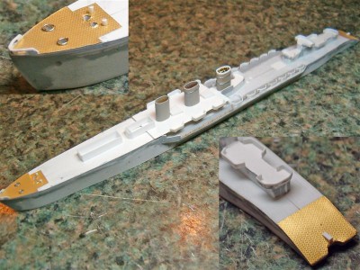

I've done a little more work on my 1/700 Kamikawa Maru to Kagu Maru conversion:
    Main deck glued in place adding a little more sheer to the stern area (will reinsert the 'tween deck from below after painting),
    Bottom of the ship cut out to facilitate a cargo hold extending beneath the waterline,
    Focsle added with a couple PE doors,
    Bulwarks removed to be replaced later,
    Remaining hatch covers built,
    Superstructure decks cut from Evergreen 2020 (just stacked in place here),
    Bridge face cut to size,
    Started work on reshaping the bow.
Any feedback or constructive criticism is appreciated.

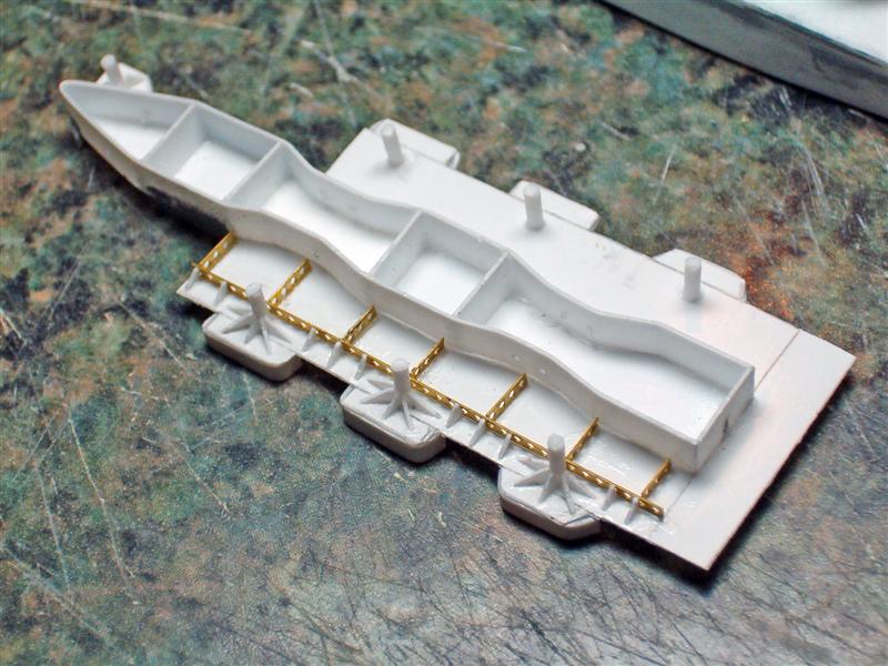

Here is the Kitamami I'm working on. This progras is as of today. None of the super structure is glued yet. I've been putting off doing the triangular bridge but cannot do it too much longer. Gonna finish the hull soon and start painting.

Scott: Your progress is coming along great on Kagu Maru. :thumbs_up_1: :thumbs_up_1:
AJ: Your Kitakami looks like a kit and not scratchbuilt . :thumbs_up_1: :thumbs_up_1: I wish I could scratchbuild like you do. :wave_1:

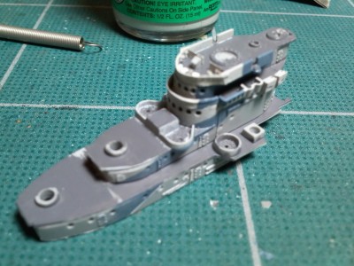

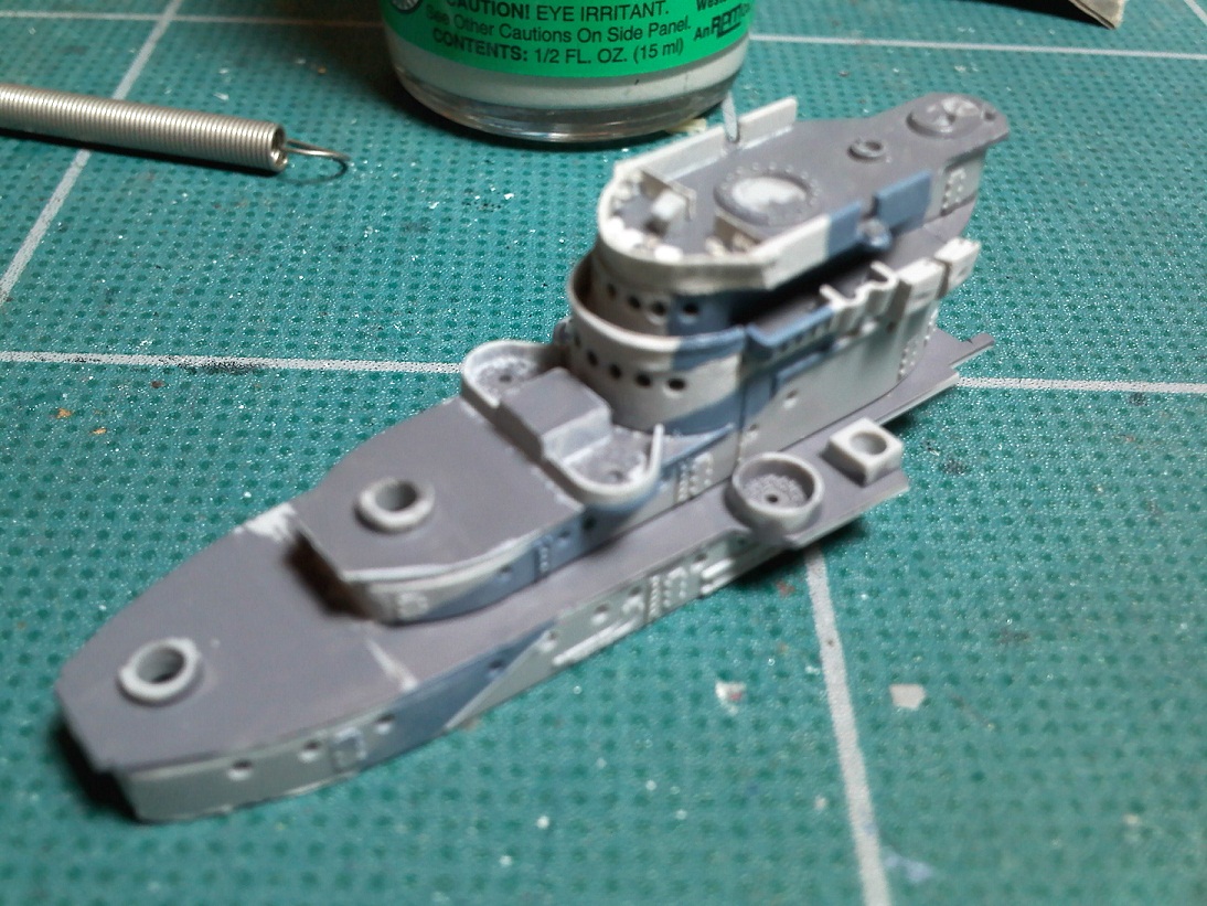

Detail and paint added to mid section, depth charge racks, crane and catapult finished, main guns assembled.

While I'm awaiting my 1-700 IJN Yahagi from Hong Kong, I've made a second start on Yubari with the forward bridge almost finished.
http://farm3.static.flickr.com/2597/418 ... b738_b.jpg
At times, I wish my camera wasn't as good as it is, with the naked eye, this looks the dogs dodars, blown up, and straight away it requires a good clean. But then again, there's not many people that's gona carry a 10 million megpix camera around with them.

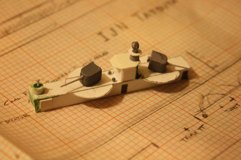

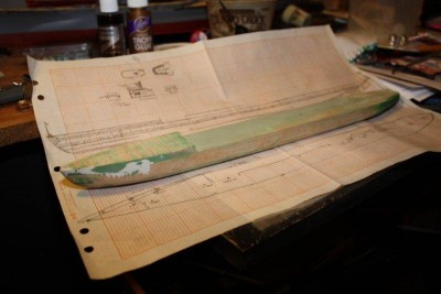

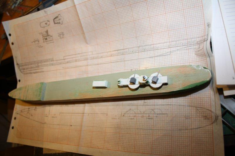

My Tatsuta scratchbuild is moving...along...slowly. The hull is almost shaped, just needs some filling and profiling before the prime/final sanding. The aft deckhouse is ready for some more detailing, painting & P/E. After the first wood was cut, I found more information (isn't the internet great?!!) that clears up questions about the hull profile and deck arrangement. A build like this can make you truly appreciate the work that goes into producing resin or plastic kits.
Next up...prep hull for plating, portholes, paint; paint aft deck house, add hatches, rails; finalize bridge plans.

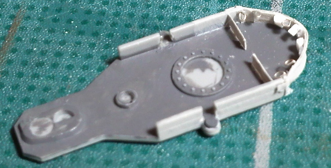

Here's some work on my 1/700 San Diego, trying to accurize and detail it as much as feasible. Note that this section is nowhere near finished, so ignore the messy painting :P
Pictures were taken with my cellphone, which has a less-than-desirable macro function, hence the blurriness.
As the kit fails to accurately instruct the builder on the correct parts for San Diego and lacks the accurate parts needed for San Diego, some research was required. Splinter shielding in front of the open bridge was added (poorly), as was the one in front of the second row of portholes. Random pieces of junk were used to detail the open bridge, with hoops from metal wires used for the sky lookout positions which are filled in with glue and will be painted later to give it a solid look.

PostPosted: Thu Dec 17, 2009 4:15 am
Posts: 591
Good to see ya got a horse in this race Timmy and your off to a good start by the looks of things.
