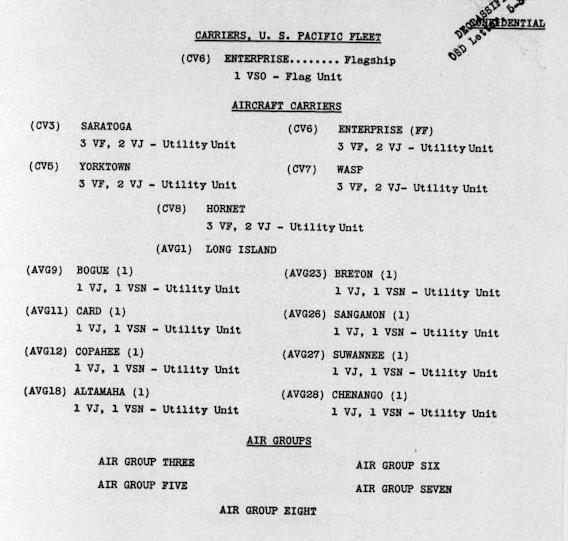

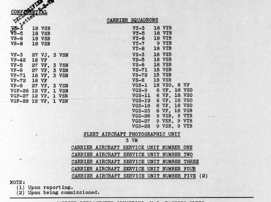

From Atlantic and Pacific Fleet Organization dated 8 Aug 42:
[img]
[/img]
[img]
[/img]
Also have a snapshot of CinCLant War Diary from Jun after Wasp's return from duty with the Home Fleet, but it's too big to attach. Working on it.

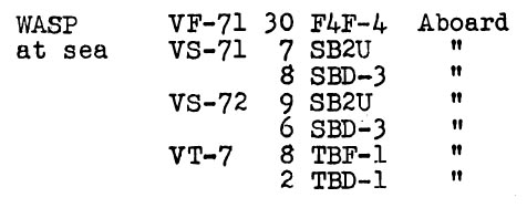

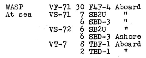

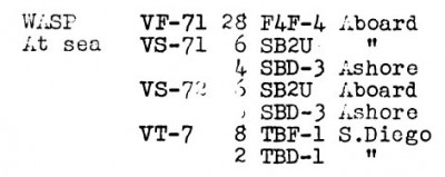

For what it is worth, from the more-or-less weekly "Location of U.S. Naval Aircraft" reports:
File comment: July 9, 1942 Report
File comment: July 21, 1942 Report
File comment: July 30, 1942 Report
