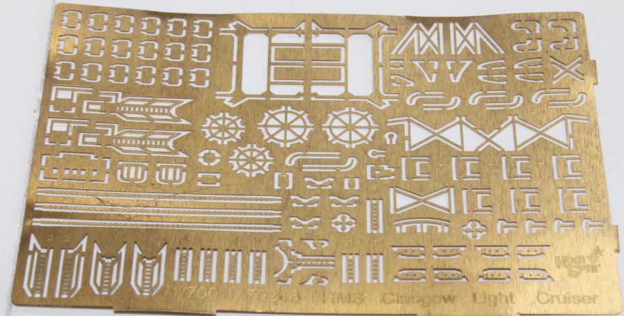

When you open the box of kit number 70246 it is typical of Combrig. The hull and parts are cast in light grey resin; there is a simple set of Photo Etch (PE) and a set of instructions. You are expected to provide your own masts & yardarms and drawings and specifications are provided on the instructions

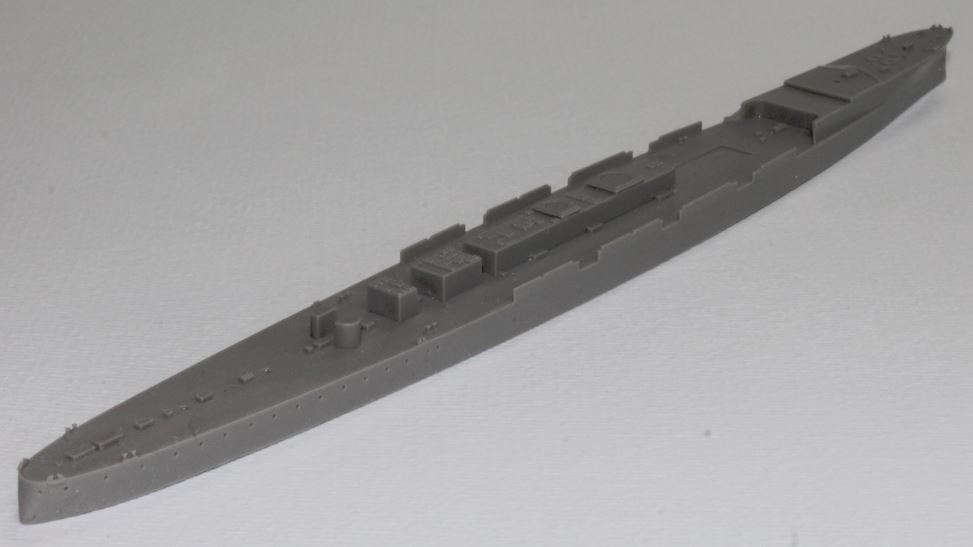

Hull is model very crisply, is highly detailed and well engineered.

The fore deck main deck break is engineered to show the correct overhang. The bridge is also engineered to provide the maximum detail using a combination of resin parts and PE.

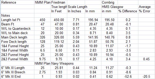

Looking at the accuracy when measured with a digital caliper and contrasted with the National Maritime Museum (NMM) plan of HMS Bristol, the Combrig HMS Glasgow has less than ½ % error in the hull parts I measured.
I am of the thought that the error is likely more due to my measurement technique and that the kit is dead on accurate. This may be due to the 3D modelling techniques used in making this kit. When looking at the fittings, accuracy is reduced due to the constraints of the resin model material utilized.

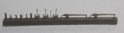

Here are some typical parts:

The parts are all cleanly executed and should clean up with the minimum of work.

The PE is typical Combrig, so in my thoughts a little on the heavy side and only what is truly needed or is unique to the vessel is provided. Aftermarket PE is required for railings and extra details.

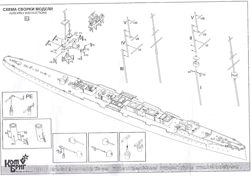

Instructions are typical Combrig, due to the number of very small parts you may wish to take the time to mark which part goes where. Even the QF 3LB guns and the Machine Guns are not only included but are made up of barrel and base. Talk about tiny!
An interesting feature of the instructions is that the next page shows mounted, what was positioned on the prior page. You will get very accustomed to flipping forwards and back again during this build.

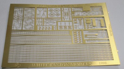

Should you get WEM PE 724 then there is a boat rack that can be modified easily as per the red cut lines below.

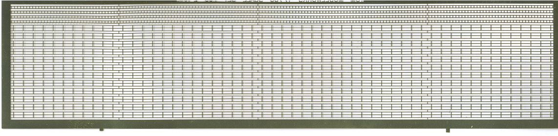

Aftermarket Considerations:
Tom’s Modelworks 705 Two Bar Rail, or equivalent is required for the railings.

White Ensign Models PE 724 1/700 Royal Navy WW1 Cruiser/Destroyer PE is handy for the small part details and the boat rack. Do not use the railing as per the NMM plans HMS Bristol class used simple 2 bar rails.
