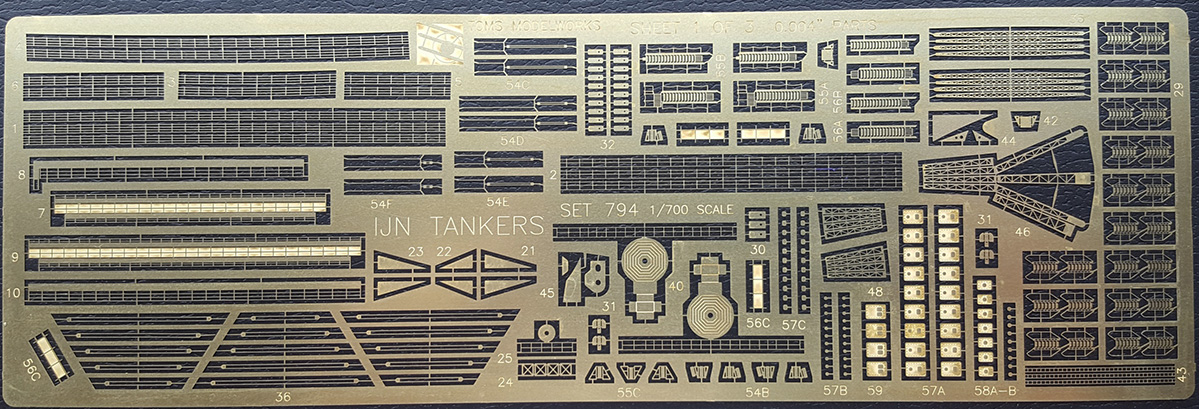

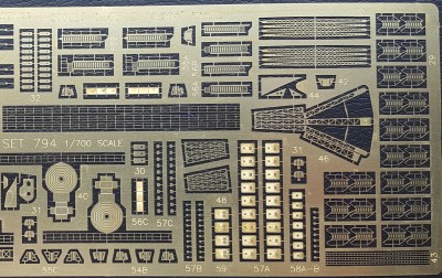

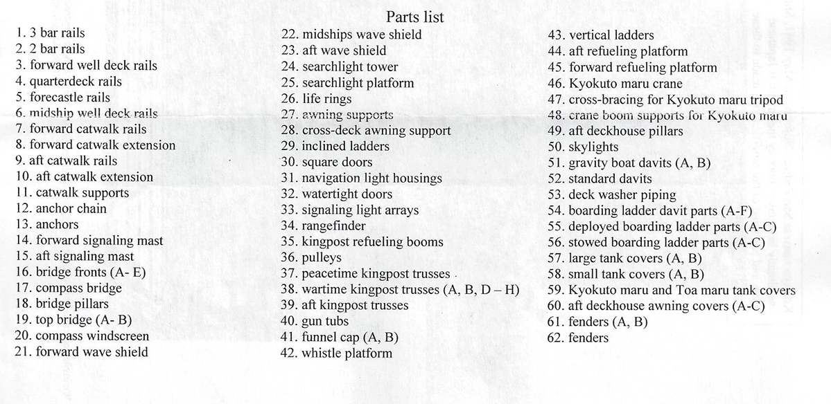

First, I’ll repost images of the individual frets and the parts list. There are 10 pages of instructions, but I’m not going to post those. I’ll probably next comment on the bridge, but I need to take some additional photos before I do so. All comments welcome.

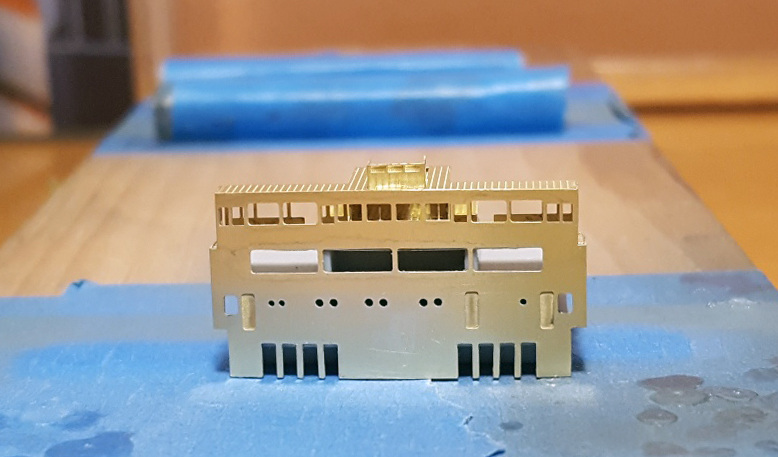

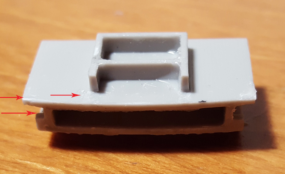

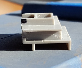

The instructions are straightforward regarding the bridge, and the parts easy to use. However, to maximize the use of the bridge PE and get an even more accurate bridge, a few more steps can be taken that involve removing a little more kit plastic and replacing and repositioning one bulkhead with strip styrene.
D54 is the plastic kit part that serves as the base of the bridge. A small rectangle needs to be removed on either side as indicated. Doing so allows windows on either side of the bridge face on the 01 level to seen.
D53 is the next level up on the bridge. As the Tom’s instructions show, a set of plastic tabs has to be removed as they will interfere with the PE compass bridge deck part 17.
On the actual ships, this level sports a large compartment whose forward bulwark is recessed slightly back from the bridge face. The kit part needs to be cutaway approximately 2mm on each side and a new bulwark installed. Otherwise, the resulting aperture abuts the inner side of the bridge face and it comes across as slightly incomplete.
So, D53 has the marked portions also removed. A new strip of .015” x .1” styrene was installed. You could also use .01” x .1” but I wanted extra thickness to stiffen the wall as I drilled out some portholes.

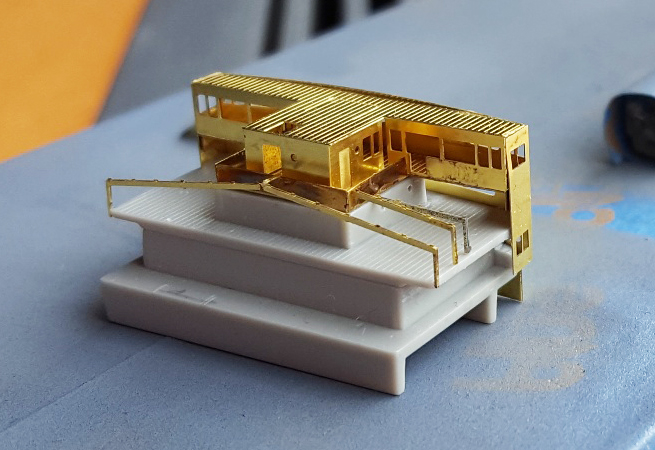

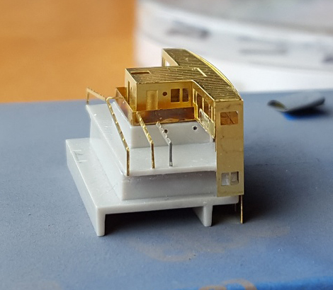

At this point, the PE bridge face can be glued to the kit parts. Here, I‘ve used a face with a full width compass bridge deck with openings at the bottom, good for Toei or Toho Maru. (Since I had only one set of kit spare bridge parts, I had to re-purpose the original PE example by removing and damaging that facing to get at the plastic parts.) You can see how the recessed compartment compares with an example of the real thing, Nippon Maru.

The compass bridge deck and compartment are relatively straight forward to glue in place.

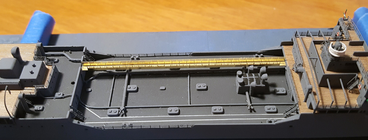

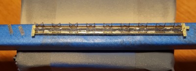

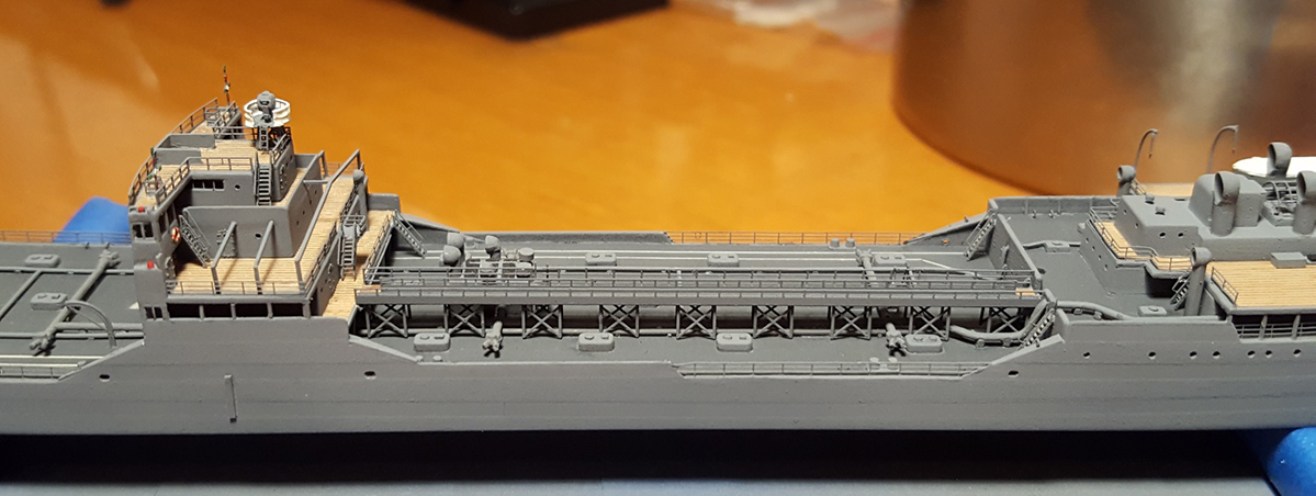

Rear Catwalk
This has been another detail that, like the bridge structures, really helps make this set worth the price of admission. It’s a pretty straightforward addition, though, again, there are a couple of small tweaks that are required. (The forward catwalk will be covered separately as it has a particular set of challenges.) The kit supplied catwalk is somewhat wanting. It’s made of stainless steel and consists of only a featureless walkway and support trestles, without any railings or siding. The Tom’s set adds the necessary walkways with railings and detailing while utilizing the kit supplied part as the base of the catwalk.
The first thing is to decide if the tanker will be a pre-war or wartime UNREP version. Prewar versions had only a single walkway atop the trestle. Wartime UNREP versions utilized that original walkway as storage for the UNREP hoses, so an additional walkway was added to the starboard side of the original catwalk. The Tom’s set allows for either version.
The kit supplied trestle is designed to have its aft end fit into an opening in the ship’s aft bulwark, while the front end lies on top of the decking of the 01 bridge level. One could certainly retain that application with the Tom’s set laid on top of the kit trestle, but I believe it makes for a better appearance if the ends of the catwalk are matched or faired into the corresponding kit locations at each end of the catwalk. In fact, the Tom’s pieces are 61mm long and can’t be cut down at either end without compromising the appearance of the unit. So, it made sense to fair the ends in and match them to the level of the decks around it.
I took a small .015”x .02” piece of styrene strip and glue it onto the bottom of the aft bulwark aperture that the catwalk fits into. (This was done to raise this lip to the level of the surrounding deck – don’t want a ditch to show.) I then took another short strip of .02” x .02” styrene and glued it just a hair below the one just installed. This was done to provide a ledge upon which the aft end of the Tom’s pieces could rest and be anchored to with glue. A similar ledge was attached to the aft end of the 01 bridge level. But, because the Tom’s piece is still a bit longer than the space between those two points, I had to chisel out a shallow ledge from the kit plastic of the bridge. Ultimately, the Tom’s piece nestled into the space. Sadly, I don’t have a photo of the cutout, but in the photo labeled “Prewar catwalk portion test fit”, you can see the forward end of the catwalk nestled on its support strip with its back end resting on the aft ledge.
To put a wartime catwalk in place, it is necessary to glue both the original and the supplemental piece onto the top of the kit trestle. However, the kit trestle is too long to fit properly as a support for the Tom’s pieces within the two bulkheads. I trimmed the stainless steel part by 1.5-2mm and dry-fit it for position on the deck with the catwalks on top. The trestle legs need to splayed apart just a bit in order to allow the walkway surface to reach the proper height.
Once satisfied with the positions and alignments, I glued the catwalks on top of the trestle. I favored the original catwalk with about 60% of the width of the trestle and the supplemental walk occupying the remaining 40%. . Once dry, I attached some piping of my own, then painted the assembly. The final step was to glue the entire assembly in place.
Things that were missing from the PE:
1) The additional catwalk was floored with wood. Unfortunately, the seam lines for the planks on the Tom’s piece were omitted in error. I still sprayed that portion with wood tan paint and washed it with burnt umber, so I feel it still came out looking like wood decking
2) The actual catwalk had two access ladders leading up to it from the main deck. The Tom’s part does not have openings in its railings for access to these ladders. However, it can certainly be cut away by the modeler to provide such access, as shown in the photos.
Ledge support in place, prior to chiseling out ledge above it.jpg [ 343.02 KiB | Viewed 1602 times ]

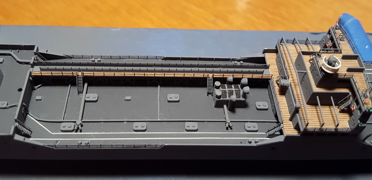

PostPosted: Thu Oct 25, 2018 3:48 pm
Posts: 8849
One more view of an aft catwalk access ladder aperture, then on to the......
Forward Catwalk
Everything that I wrote about the aft catwalk holds true for the forward catwalk. There is, however, one more complication. The forward main deck (now that I think about it, this is more properly called the forward well deck) rises up to the bow. This sheer is slightly curved in a concave manner. The kit supplied trestle is designed to follow this curve. Regrettably, the Tom’s catwalks cannot bend and conform to the curve due to the solid walls of catwalk that forms the bottom of the trough. So, the pieces have to be modified.
What I chose to do is make one set of cuts in the sold brass sides of the main catwalk, and a corresponding cut of the vertical portion of the railings on the supplemental catwalk part. I chose a location that seemed the point where the well deck transitioned from horizontal to sheer. This was almost half way back from the forward end of the catwalk, though this is a “guesstimate” on my part. (In line with the small deckhouse, and definitely in front of where the mast is mounted.) The cuts were meant to take a very shallow “vee” out of each side of the metal trough that forms the base of the main catwalk. It does leave a seam of sorts, but it’s not that easy to detect amidst all the detail.
