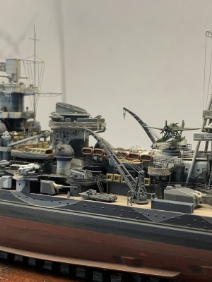

Time for another update, still iphone pics but at least Ill make it a long one!

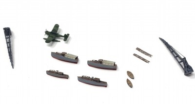

First I started to sort out all the small bits, like cranes and boats. For the boats, I have gone initially with a red bottom - as seen on the pic. However - when installing I did change it back to black as my other KMS builts were all with black boat bottoms and didnt want to change tradition.
Dont laugh but I also folded the access ladders in a rather crude way to place it along side aft superstructure. It looks better once placed, believe me. :D

Next, Ive installed the cranes and the Arado plane (how many Ive built those by now...), to what an already fierce looking ship. I pointed the plane out to port, and played a bit with crane elevation. They look a bit livelier. I actually wanted to suspend the plane from a crane over the open hangar, but there were two issues with that. One, is the hangar door was closed, and two - the plane with folded wings somehow was missing the tail fin section, and I had no idea where it went. So - we have to make do with a plane on a catapult and cranes kinda eclectically pointing up.

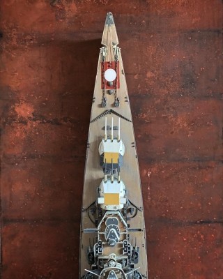

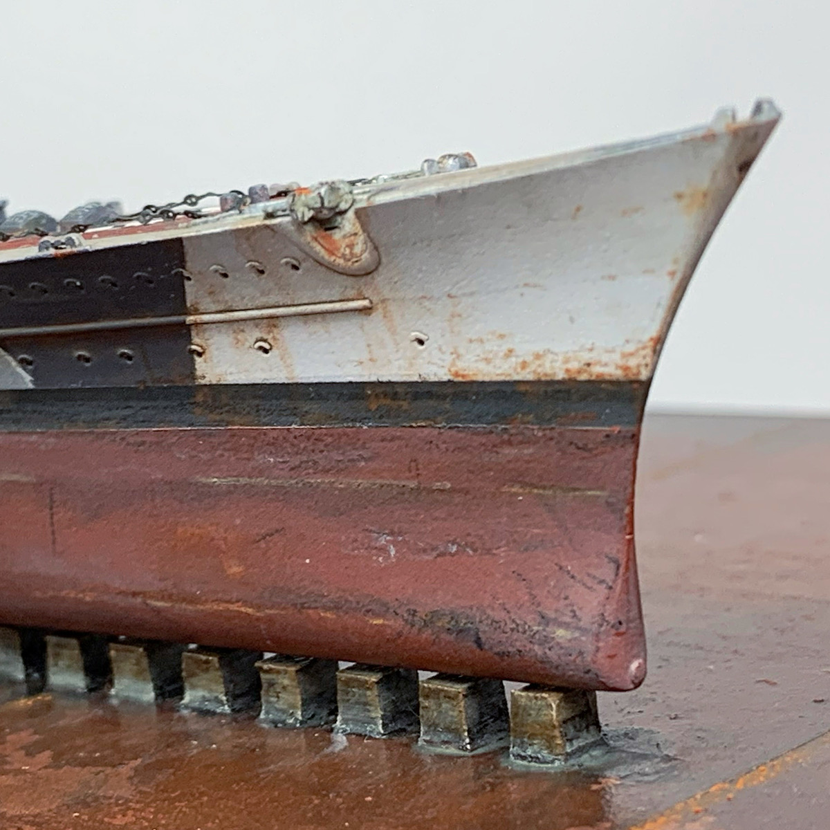

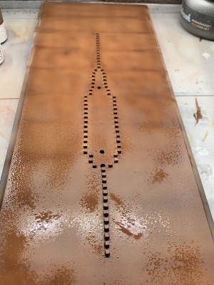

I also had a bright idea to build the base for the ship stylised as a floor of a floating dock. Basically a chunk of rust. I may have over done it as it somehow dominates everything, but my sneaky plan is to tone it down with more browns, but not sure if it should be dark browns or brighter orange browns. Either way, it will bury underneath the rather well textured and beautiful floor. I quite like the effect that I got by painting and chipping and weathering it with pigments in very random fashion. I really really like how pigments weather everything, the trouble is every time you try to fix them with means I have (lacquer for instance) - I end up right away with losing like 80% of the effect. I then repeat it, and may be it gives layers but still I am yet to find the final form..
Here are some shots of the floating dry dock base progress from plastic to paint with chipping fluid to semi-final:
Keel blocks are just square rods (someone who 3D prints, make yourself some money and 3D print proper to scale dry dock keel blocks please? like few hundred Id buy from you). Wont ask this again, Ill do it myself. :) Also - anchor chains installed from PE. Not sure, from upclose they look very 2D, but afar - very good impression. I think will keep them.

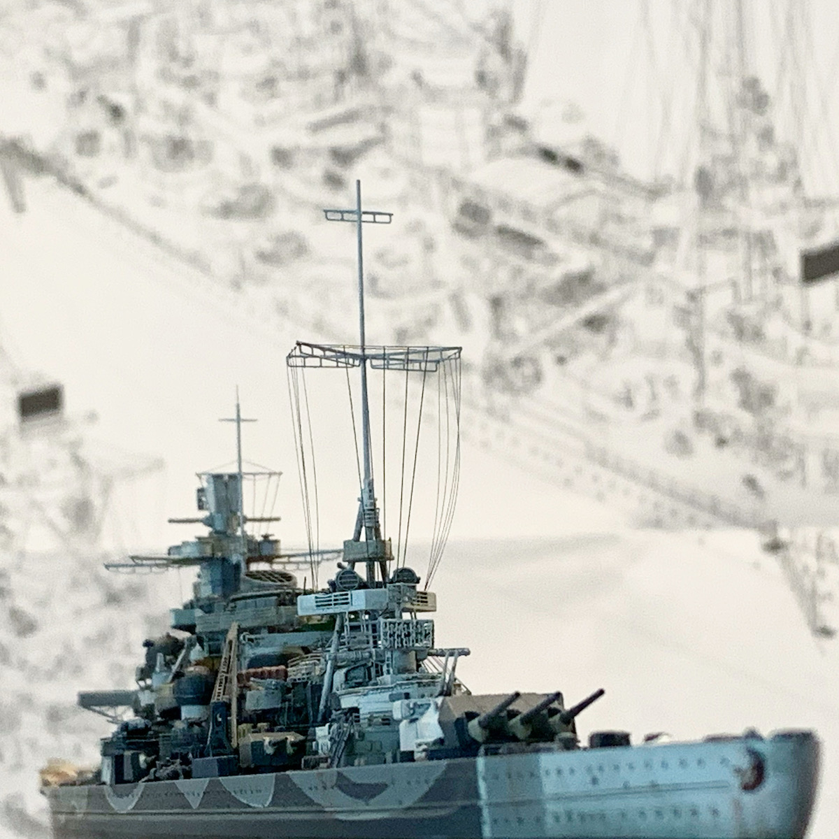

After this I turn to rigging (which is my current stage). Again, using A. Bonomi's book Anatomy of Ship, I proceed thread by thread. The result is pretty nice, but it sure is taking time. I have avoided doing double lines for flag lines, and instead go with thicker single line which may be seen. I am afraid to overwhelm the masts and the model. I do like how the whole thing looks of course, and I also simulated the sagging of the lines on port and starboard side of the main mast depicted in the book. Perhaps too much, but this is best I could get with tungsten wire, it was a little tricky. If you think it is terrible and I need to fully redo it, please let me know. Yet not too late.

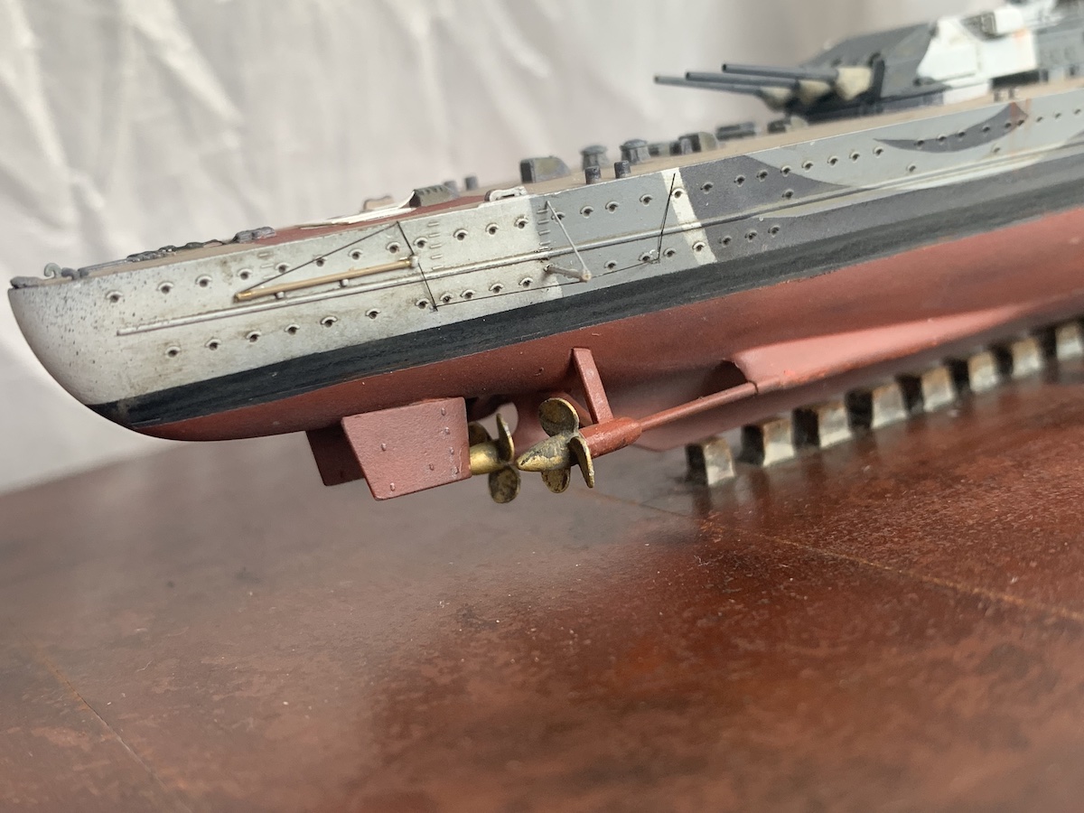

a follow on from previous post - rigged propeller guards. For some reason I wanted to see them extended as the sticking out propellers seem fragile. So now I have created an even more fragile propeller guard... Why I do this to myself. :heh:

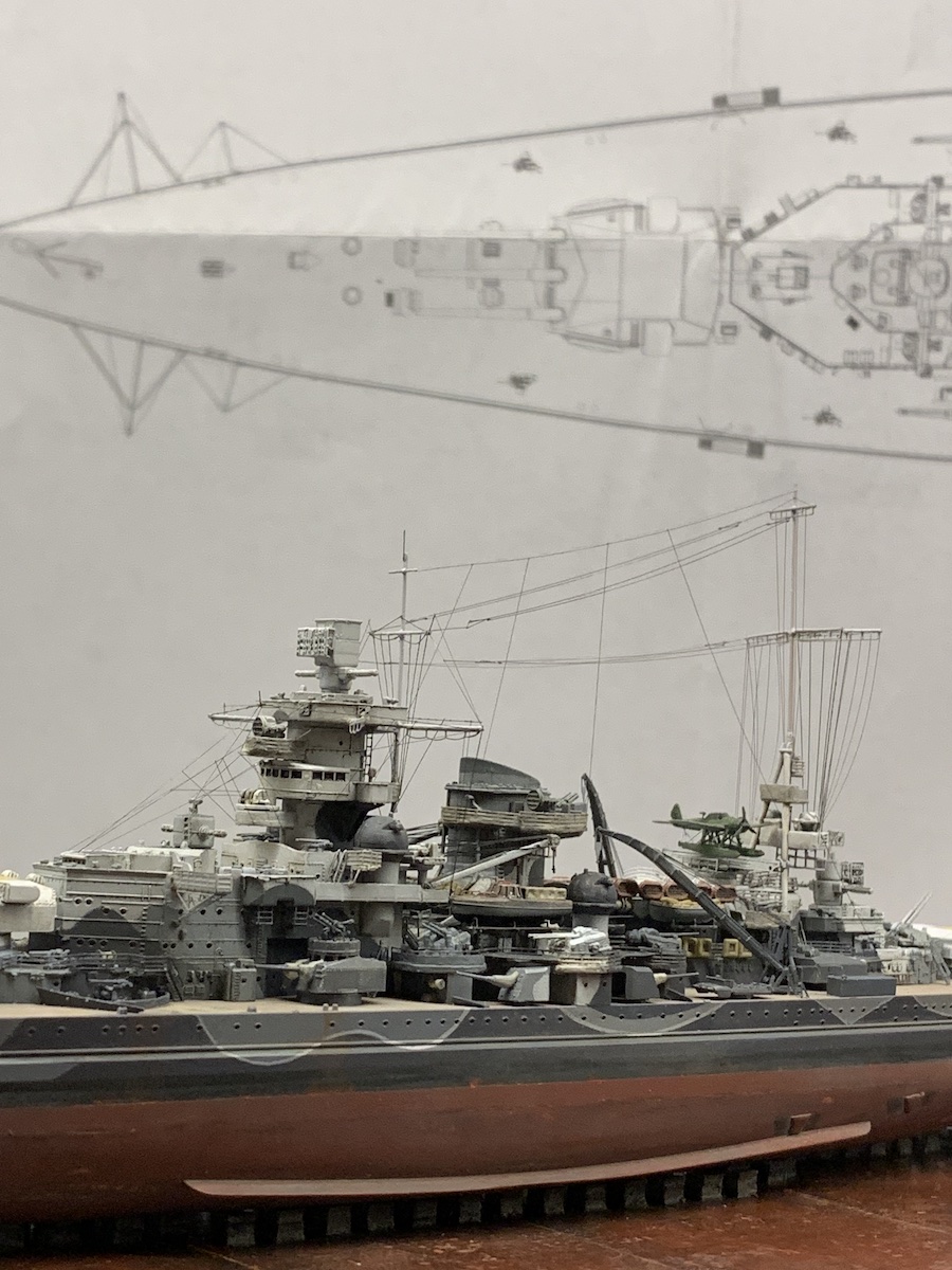

Next phase - shortwave antennas and get the rigging up.
For the shortwave antennas I just bend a piece of wire at approximately the right angle, and build them piece by piece, having pre cut everything in advance. It works pretty well, they do a have a little bit sag so may be stretched sprue would have been better here. Still result overall is good.

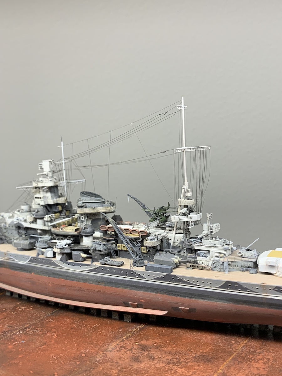

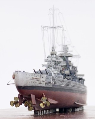

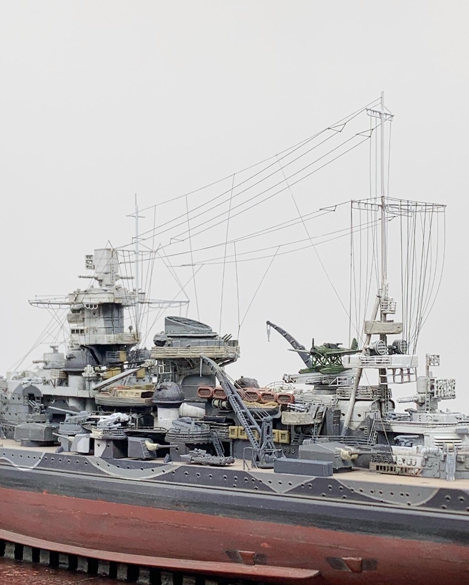

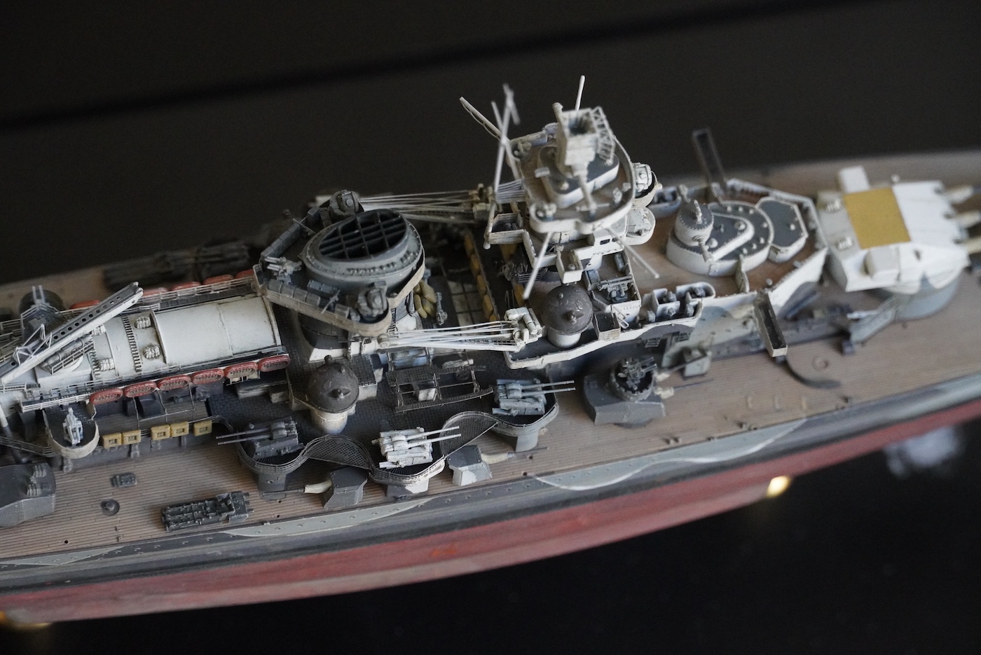

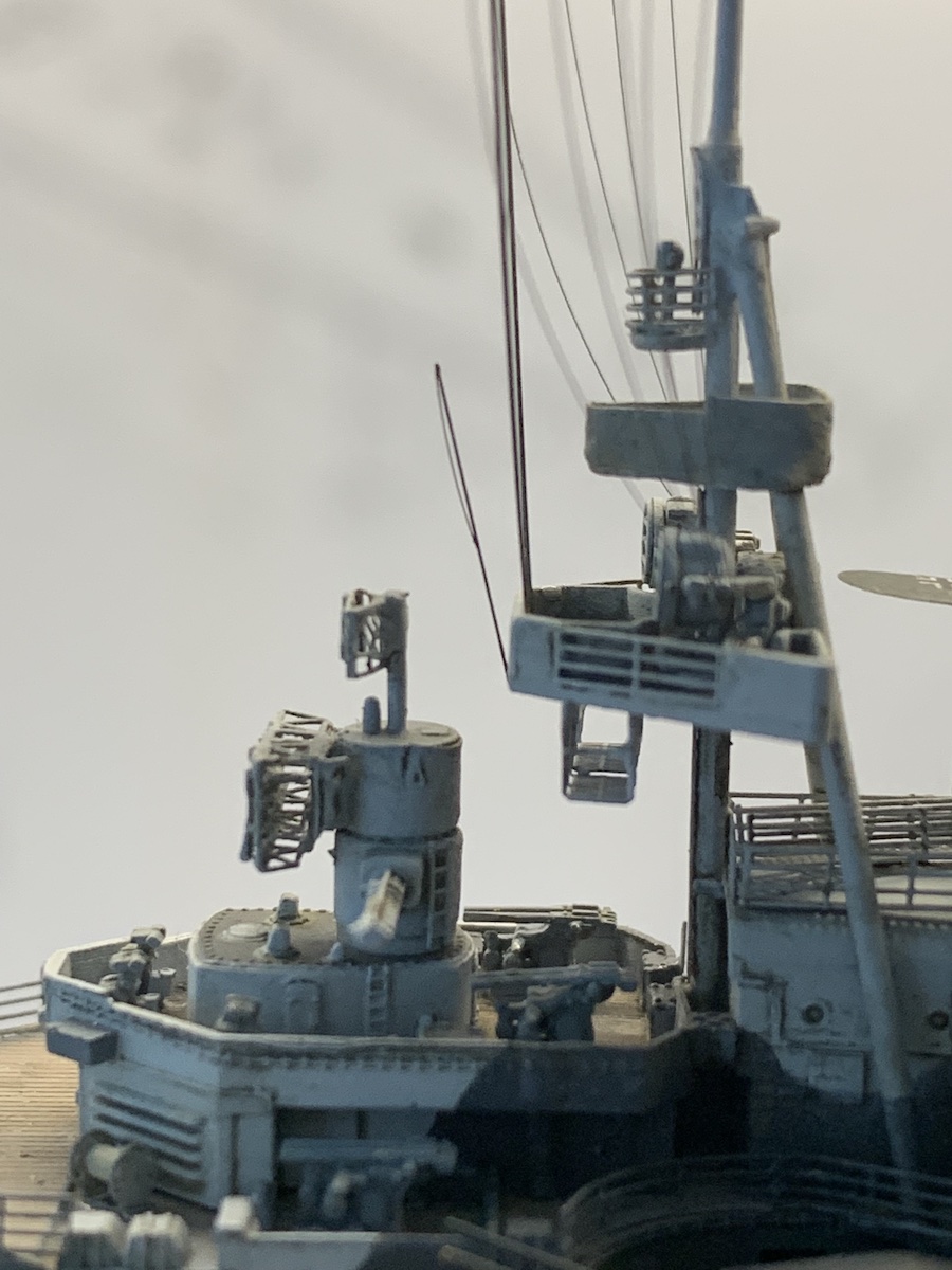

Been quite a journey for almost two years or so, but glad to have it done and focus on the next builds (and tidying up old ones, always fun).
The model is finished.
Below are first teaser shots. Intending to take few more later with good camera and in better light conditions, yet here she is in her 1/700 glory, in Battle of North Cape camouflage. I got to say thanks to the forum, and to the authors producing references for these ships. Really has helped me a lot in painting (Antonio Bonomi book was used very extensively here). As well as Jim Bauman's tips on painting railings on the superstructure rather than using PE (I tried Jim!) and thinning out various platforms (where it wasn't too late).
