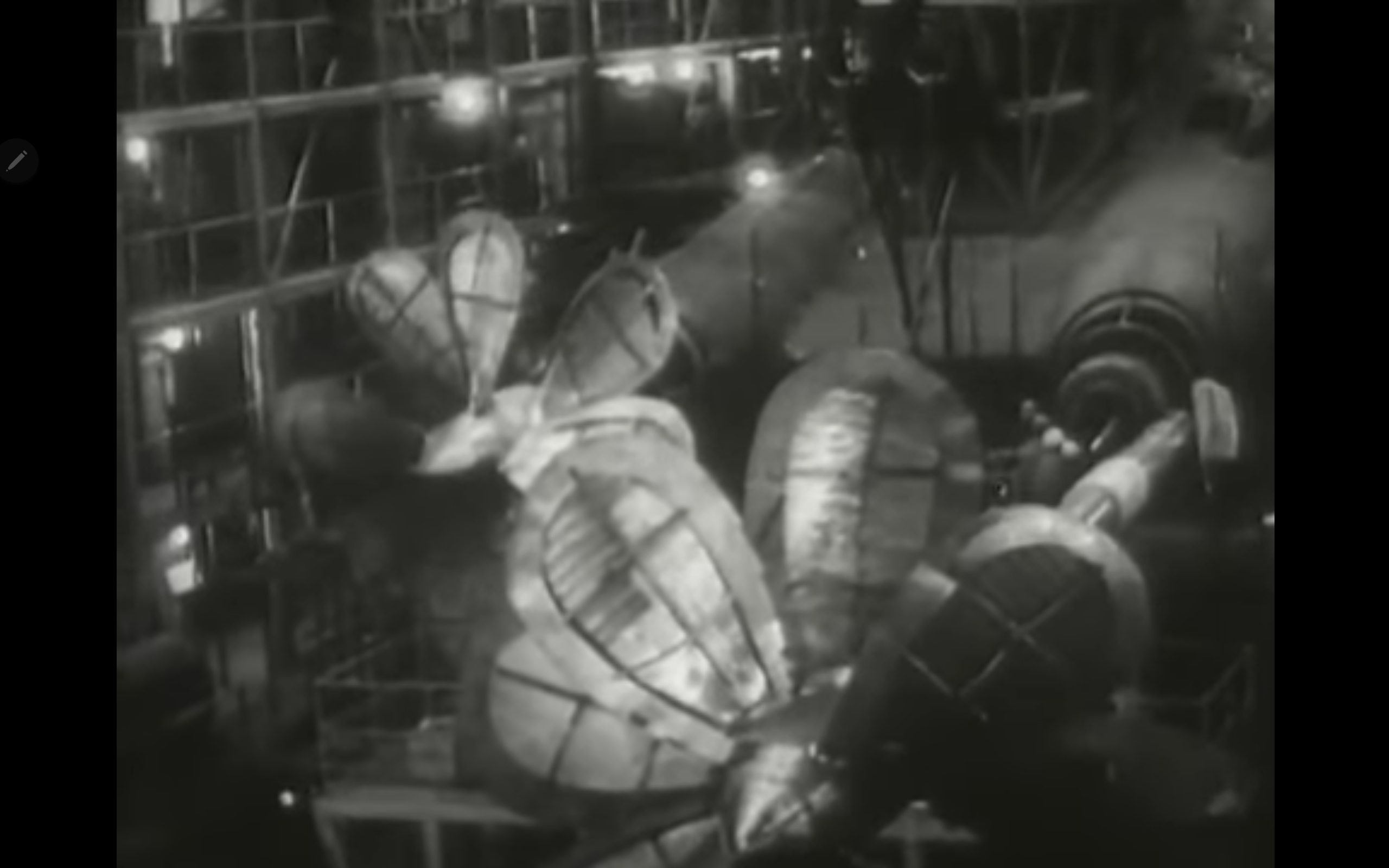

Anyone happen to have a picture of OSCAR I with the early tandem screws.
Dave
PostPosted: Thu Aug 03, 2023 1:55 pm
Posts: 268
Location: United States
Dave
Dave,
See this 1983 Soviet film about Project 949:
https://www.youtube.com/watch?v=Fk29x3u928o
The propellers are at 5:10.
Jacob

PostPosted: Thu Aug 03, 2023 6:38 pm
Joined: Mon Aug 03, 2015 10:20 am
Posts: 56
Nice. Thanks Jacob. I love these old movies.
Dave
PostPosted: Fri Aug 18, 2023 8:08 pm
Posts: 56
Another screenshot...
