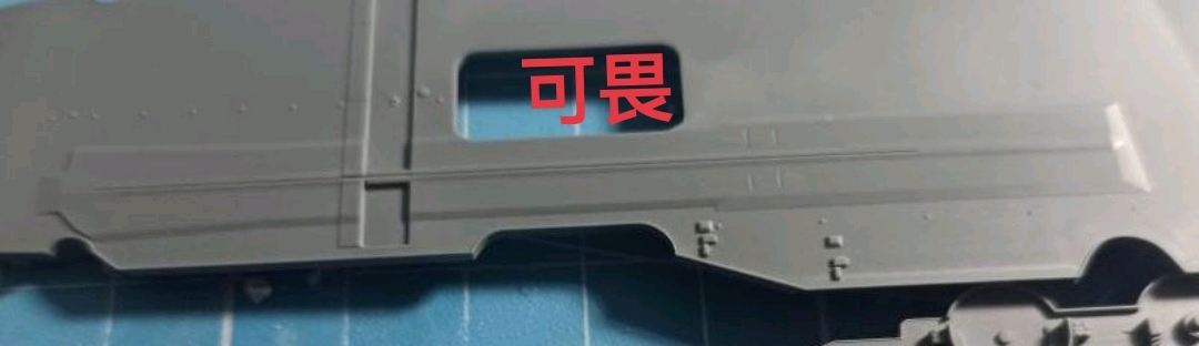

A week ago, a modeler in China also posted in Tieba about the mystery of the flight deck of the Flyhawk Formidable (link attached).
https://tieba.baidu.com/p/8005432138?pid=145377912999&cid=#145377912999
He noted that the catapult part of his kit on hand is different from his friend's kit. One with full width with flares out slightly at the forward end, one with reduced width in the forward side. After doing some research as demonstrated in the post, he suspects that the wrong deck was in fact correct for Victorious.
So, an odd packaging problem?
And a Victorious kit is upcoming?

On Teiba.Baidu there is a guy who compared many pictures of Illustrious class carrier and concluded :
我突然意识到,我手上这个“可畏”的甲板其实是胜利的甲板,然后回去翻照片考证。果不其然,FH悄咪咪地搞了个大新闻,早就把胜利的甲板开好了,
that is :
I suddenly realized that the "fearful" deck I had was actually the Victorious deck, and went back to the photos to verify. As expected, FH had quietly made a big news and had already opened the Victorious deck.
https://tieba.baidu.com/p/8005432138?pi ... 5377912999
An error in selectioning the part to be manufactured?
A Victorious comming soon?
