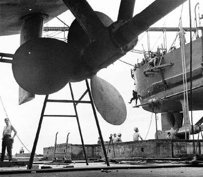

Speaking of Sonars, I need to research the sonar for these DE's, though at 1:514 it's terminally dinky. But if I do construct a larger model, likely something that can be accurately replicated. I did find a dry dock photo showing the three blade prop and one of the rudders.
Note especially the way the rudder pivots and the direction of rotation of the props, which seems typical Destroyer practice.

Posts: 1813
Fliger747 wrote:
Note especially (...) the direction of rotation of the props, which seems typical Destroyer practice.
Well, the props seem to turn outward -- which is very standard IMHO. The opposite would have been really uncommon.
Roger Whittaker +9/13/2023
PostPosted: Tue Sep 13, 2022 11:24 am
Posts: 5060
Indeed the destroyer in the background shows the same directional convention. Fortunately in printing props one can mirror them in the slicer. At this scale the blades are extremely thin and I destroyed several installing them.
