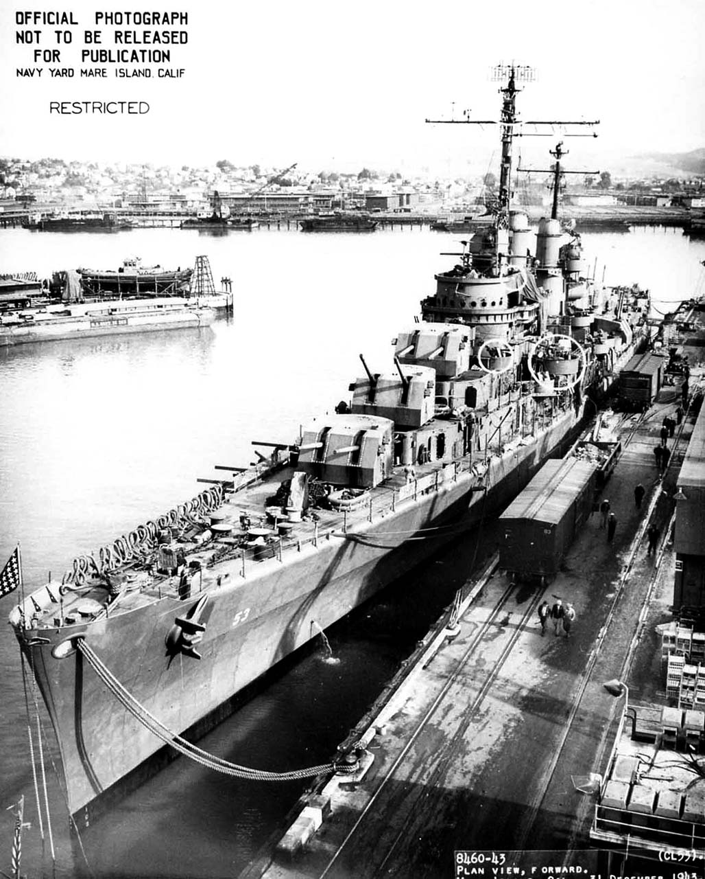

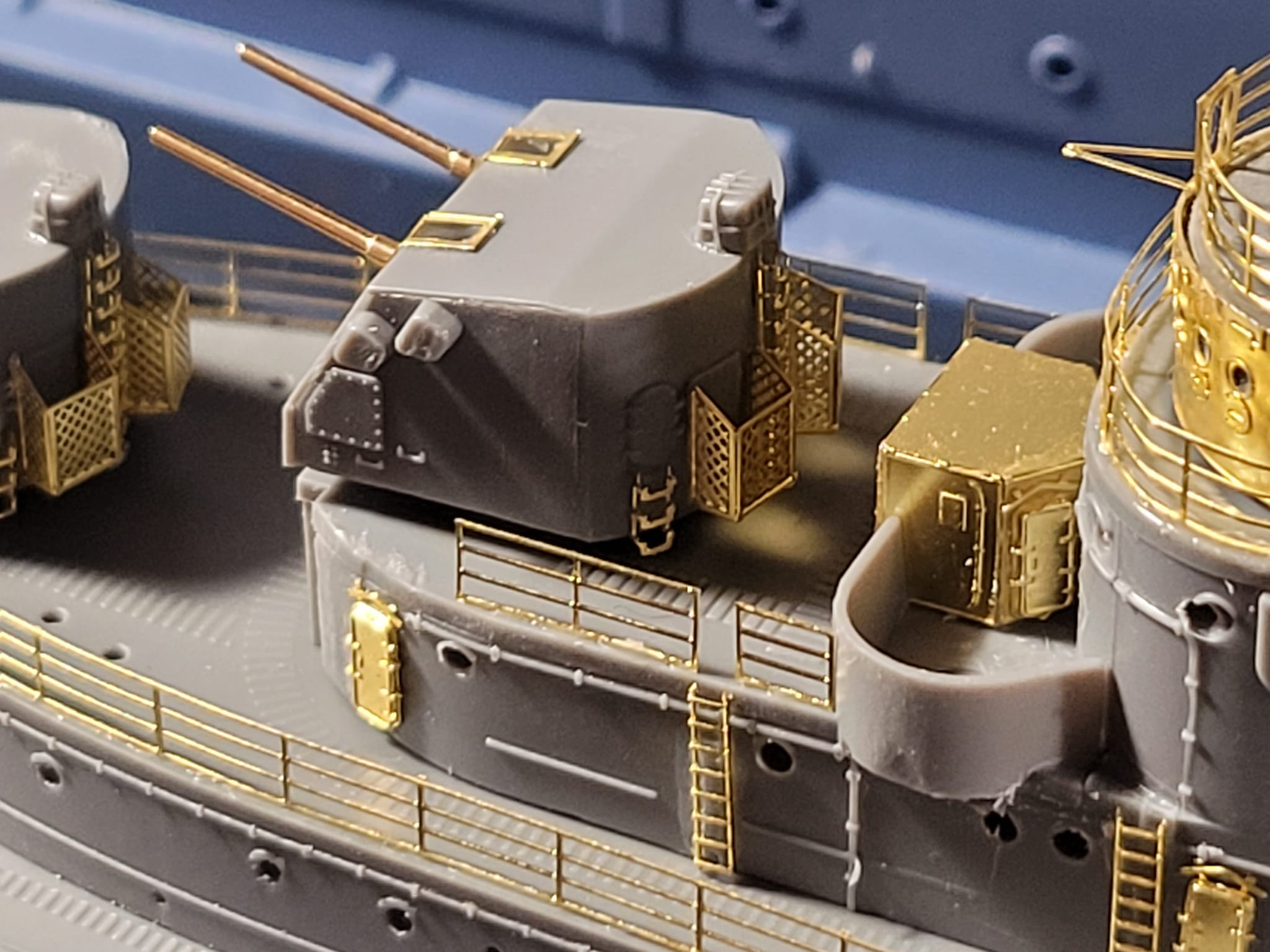

It looks like Very Fire included the wrong 5"/38 mounts for their new Atlanta kit in 1/350 scale, a very easy mistake to make. The kit looks like Mk.32s were included. But photos of the real ship indicate that Atlanta and other early ships of the class were fit with mounts that had a gunhouse with the same shape as the Mk.28s fit to fast battleships.
Can anyone confirm or deny?

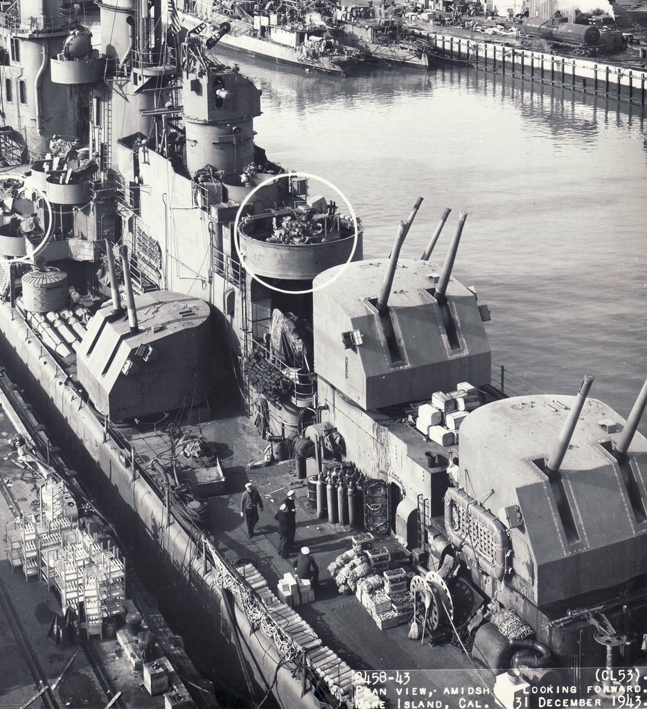

Yes, which is why the mounts on early Atlanta class ships may be Mk.28 Mod.1 mounts which had a shield thickness of 1.25 inches and were intended specifically for light cruisers according to the gun catalog. This is the mount David suggested and he may be right. Link: http://archive.hnsa.org/doc/guncat/cat-0250.htm
The shape of the mounts on the early Atlanta class cruisers does not match the shape of Mk.32 mount gunhouses. So with respect to the Very Fire kit, the shape of the mounts included with the Very Fire Atlanta kit does not match photos of the mounts on the actual ships.
Compare the photos below of the 5" mounts on Atlanta and San Diego with the mounts fit to Cleveland-class ship USS Biloxi. Pay particular attention to the height of the vertical glacis plate (frontal armor plate). The Atlanta-class gunhouses are noticeably differently shaped than those of the Cleveland-class ship. The Atlanta-class 5" mounts' vertical glacis is much taller than the vertical glacis of the Mk.32 mounts fit to the Clevelands. The tall Atlanta vertical glacis looks to be the same height we see on Mk.28 mounts fit to fast battleships. I am not suggesting that the Atlantas were fit with the same mount as fast battleships. I am saying that the shape is the same or nearly the same.
Very Fire included Cleveland-class Mk.32s with their Atlanta kit, probably the very same models included in their very nicely done Cleveland class kit. But photos indicate that the early Atlantas did not have Mk.32s installed. The early Atlanta class had something else. What that something else is, I do not know. The shape of the mounts fit to the early Atlantas most closely matches the shape of a Mk.28 mount. My guess is that the Atlanta-class 5 inch mount may be a Mk.28 Mod.1 mount, which had thinner shields and was therefore lighter than the fast battleship Mod 0 mounts. Whatever was actually fit to early Atlanta class ships, it is certainly not a Mk.32 like the Clevelands had.
As you pointed out, fast battleships were fit with Mk.28 Mod 0, which had a 2" thick shield. We are in complete agreement that the Mk.28 Mod 0 mount was likely far too heavy for an Atlanta class ship. But perhaps the lighter-weight, thinner-shield, Mk.28 Mod 1 mount is correct for early Atlanta-class ships. The Mod 1 shape matches photos of early Atlanta-class mounts, the gun catalog states that the Mod 1 mount was explicitly intended for light cruisers, and the Mod 1 mount is significantly lighter than the Mod 0 mount fit to fast battleships.
Having said all that, later Atlantas, more properly known as Oakland class ships, are different. The Oaklands do indeed have what looks like Mk.32s, same as Clevelands. Reports indicate that the early Atlantas were dangerously top heavy which would account for lighter weight Mk.32 mounts being installed on the follow-on Oaklands, which also had two fewer 5" mounts than early Atlantas.
If true, the Very Fire kit has an Atlanta-class hull and superstructure with Oakland/Cleveland-class 5" mounts. This is an error, and an easy error to make, because these different mounts are so similar. If the real ships were fit with Mk.28 mounts, this is an easy error to correct with aftermarket Mk.28 mounts.
Trumpeter made a similar error with their 1/200 scale Iowa class ships. Their Iowa class kits have Mk.32 mounts. The real Iowa class ships had Mk.28s. And the difference is noticeable.

I agree with Steve. The mounts on the Atlanta look like the Mk 28, and certainly would have had the lighter shell.
