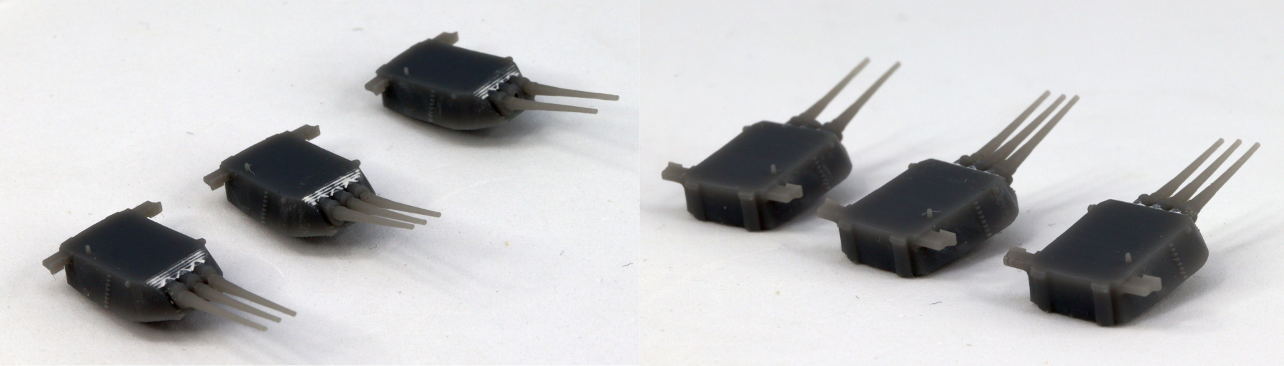

Main turrets
This is another feature where the New Orleans class members varied. Well-known is the difference between Mark 9 guns in �round face� turrets and the slimmer Mark 12 guns in �flat face� turrets. The other difference is less obvious � were flat vents added to the turrets in the thirties. These appear on all class members except of San Francisco, but most units had them on sides below the local fire directors. Quincy had them slightly (1/2 of width) more forward compared to the others, but Astoria was another exception as she had them located on the back side of the turret. I noticed this difference already two years ago when we worked with Justin / Red Devil Design on his 3D model. For some reason I forgot to include this feature in the New Orleans class comparison table (as of 1942) previously, it�s been updated now.

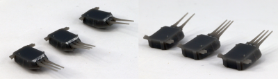

Matt / Kraken Hobbies kindly printed these turrets for me in 1/700. There were some visible printing layer lines on turret faces that I tried to make less obvious by liquid putty. The one missing barrel was lost to the carpet monster, waiting for Matt kindly providing a replacement. Foremast and mainmast

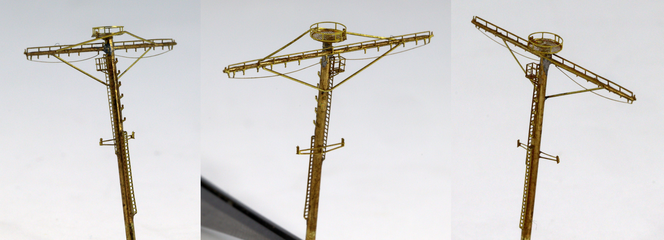

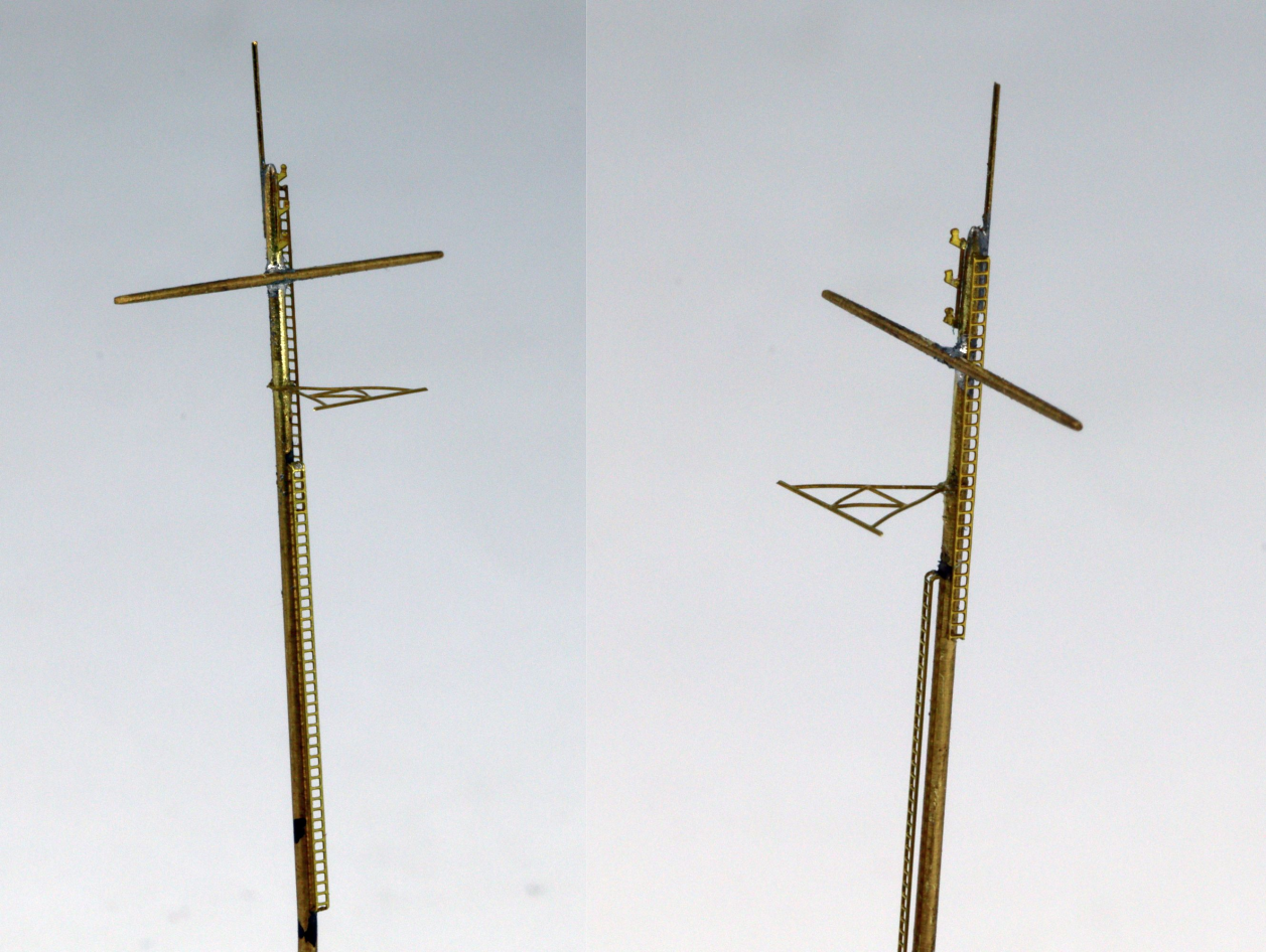

Both masts were completed using my PE details. The SC radar, a weathervane and TBS antenna are missing, will be added later.

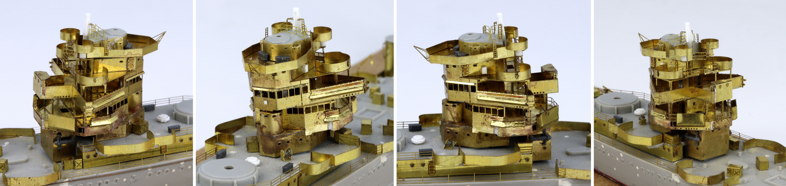

Main bridge
I reported about the main bridge already before, only some corrections were left to be done like non-ideal fit on the back of the bridge etc. Wind baffles came out too large in the previous attempt so have been amended on both navigating and signal bridges.
Flag bags were added to the signal bridge. I used the FiveStar overlay for the fire control top and added some ladders, railings, door and a scratchbuilt support for the Mk28 director.
Bulwarks are still missing from the battle lookout platform (fwd of 1.1 splinter shields) as the platform itself can still be removed to provide access to the navigating bridge below to allow for painting and installation of the crew and other details.
All levels are dry-fit only.

Vladi excellent progress so far.
Did you solder the main bridge components as you did for the mast? if so the soldered joints are flawless, and considering how small is the bridge that's a remarkable feat.
Are you using the usb soldering unit coupled with ordinary solder wire or the (Koki) paste ?
on standby for the next updates

Hi SG1, thank you. Yes, I use an USB soldering unit and solder wire and sometimes solder paste, but only really for the main joints like attaching floor to the bridge sides to give it structural strength. I will solder the foremast to the bridge when I�m done, too, for the same reason, but it will be a bit tricky as I need to paint the bridge before that.
For everything else I use the CA glue and CA gel because these are easier to repair/reposition if something went wrong. I use cheap brands and preferably in 1g packaging because I�ve never been able to prevent the nozzle from getting clogged after having been using it for some (not so long) time. I tried some of the more expensive with a teflon nozzle but the result was about the same, just with more waste as the packaging was larger
BTW: saw the pin vise and drills you posted on your blog - these can be bought very cheap on Aliexpress

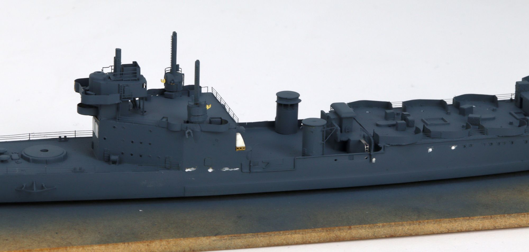

I declined attempting to imitate oil-canning as it was unnoticeable on wartime Astoria photos because of her 5-N paint (unlike on e.g. fantail of USS Quincy).
Some corrections and additions done after airbrushing. Status as of today. Deck painted 20-B, attached funnels and vent under the searchlight platform. Started painting details and railings. Adding details to the bridge.

Lovely. I agree about skipping the oil canning.
