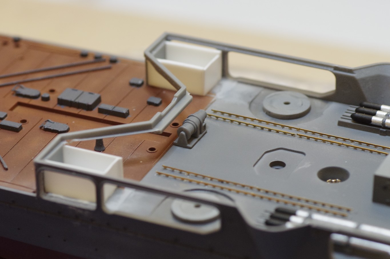

An update in progress:
Based on the info in these pages, I decided to fix the Tamiya error with the aft part of the catapult deck (part C40). Made the so called "safe boxes" (assumed to be used for plane fuel etc.) from styrene sheets following the sketch of Mutsuo Uchiyama. Added also some additional port holes, doors and left over torpedo rails on the torpedo deck. These are hardly visible, but adds some detail.

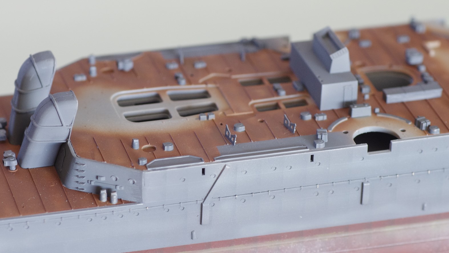

Also continued the painting of the hull with some weathering both below & over the waterline. I tried to follow the technique presented by koppalakki and reach a result with a worn out look, but did not succeed very well. Used mainly AMMO Mig products like 1208 "Rainmark Effects" & 2010 "Scratches Effects" and washes from AK Interactive like AK027 "Slime Grime Light", AK305 "Streaking Grime for Light Grey Ships" & AK306 "Salt Streaks for Ships". Need to add some more rust marks...
