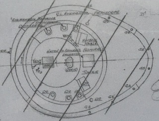

I also noticed that there is a step in the turret roof edge that is not present on the actual ship, and the entire bolt line is situated more towards the outside of the roof plating. (see attachment) More correction work needed?
(Unfortunately this kit is rapidly descending towards toy-status, the Micromaster turrets suffer from none---though it has a slightly exaggerated panel line between the turret roof plate and side plating---of the shortcomings in the Takom kit?)
