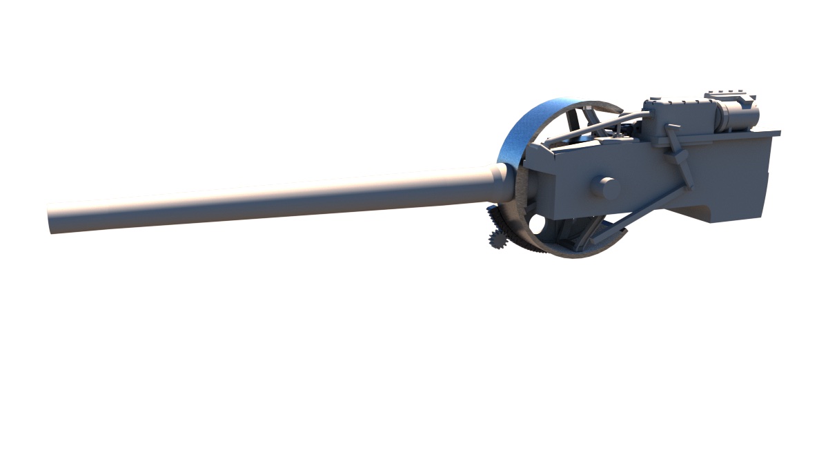

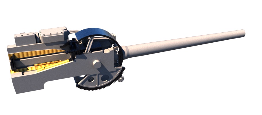

With the success of building a complete cutaway of an Iowa class 16" turret complex, now on permanent display at the Battleship New Jersey Museum and Memorial at the Camden, NJ waterfront in the Delaware River, I decided to build a companion model of the 5" secondary battery also cutaway down to the magazine. This too is destined for display in the Big J.
Like the 16" gun, finding dimensioned drawings is a challenge, although a bit easier with the smaller turret. What is more complex is the relationship between the ammo handling spaces and the gun. Unlike the 16" turret where all of this is self-contained in the rotating portion (the magazines themsselves are surrounding the turret and I didn't model them, in the five inch system the magazines are located three decks below and offset by various amounts. To complicate further there 10 turrets (WW2 configuration) are served by 6 magazines. The fore and aft magazines serve two turrets each with the midship magazine serving a single turret. With the 1986 refit, some of the magazines were decommissioned. The intervening decks contain non-weapons-ralated cabins and the blank space between the splinter deck and the one below. The deck space below the splinter deck is only a few feet. Since modeling all of this is complicated and doesn't add much value, I've discussed this with Ryan Syzmanski, the muesum curator and I'm choosing to duplicate this somewhat fanciful version that's widely seen illustration.
This rendering shows the design work I've finished so far.

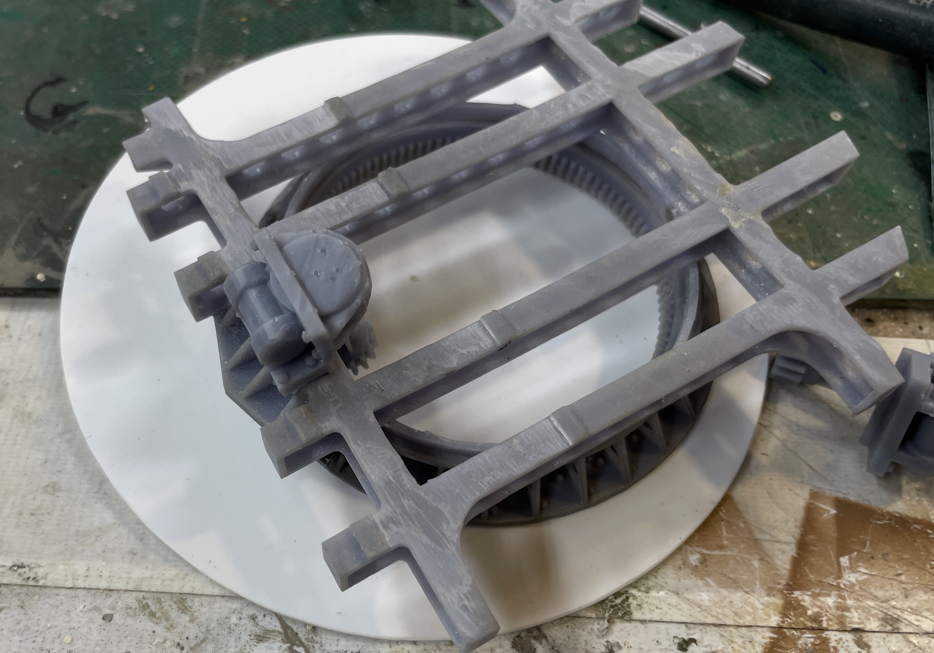

With the Fulament spring built plate I'm using, I rarely have adhesion failures, but I do get support failures. It is crucial to put a lot of heavy supports at the lowest (first) edges that form. Not only do you want to have a good, solid start to the print, but the lower supports have to support the ever-increasing weight of the part as it's forming. It's all proportional. A small part may look like this rule doesn't apply. Afteral, how much can it weigh? But it's not just gravity you're fighting. There is also suction created due to the perfectly flat surface created betweenl the FEP when the resin layer is curing. The build plate, through the supports, has to break that seal to lift the part so fresh resin can infill beneath the part. I've printed hundreds of parts in the four years I've been at this, and still have support failures. There are guidelines, but there are no hard-fast rules.
As the part forms you can lighten the supports on the upper reaches since the amount of mass is greatly reduced. I also add light supports to all details where removing the heavier supports would destroy the detail you're trying to print when you remove them.

Good printing tips about supports and of course orientation can be critical. The secondary battery units are called mounts and not turrets.
