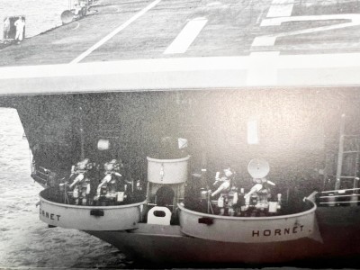

Good Memorial Day Weekend all. I'm trying to verify exactly what was located in Hornet's Stern 3"/50 cal twin mounts director tub on her stern gun sponson. The schematics are for a later time frame after this sponson was removed. Was it a Mk 56 director but with the radar dish located on top of the left side 3"/50 cal? Was it a different type of director? Was it a searchlight and if so any idea what size? As usual any help would be greatly appreciated.

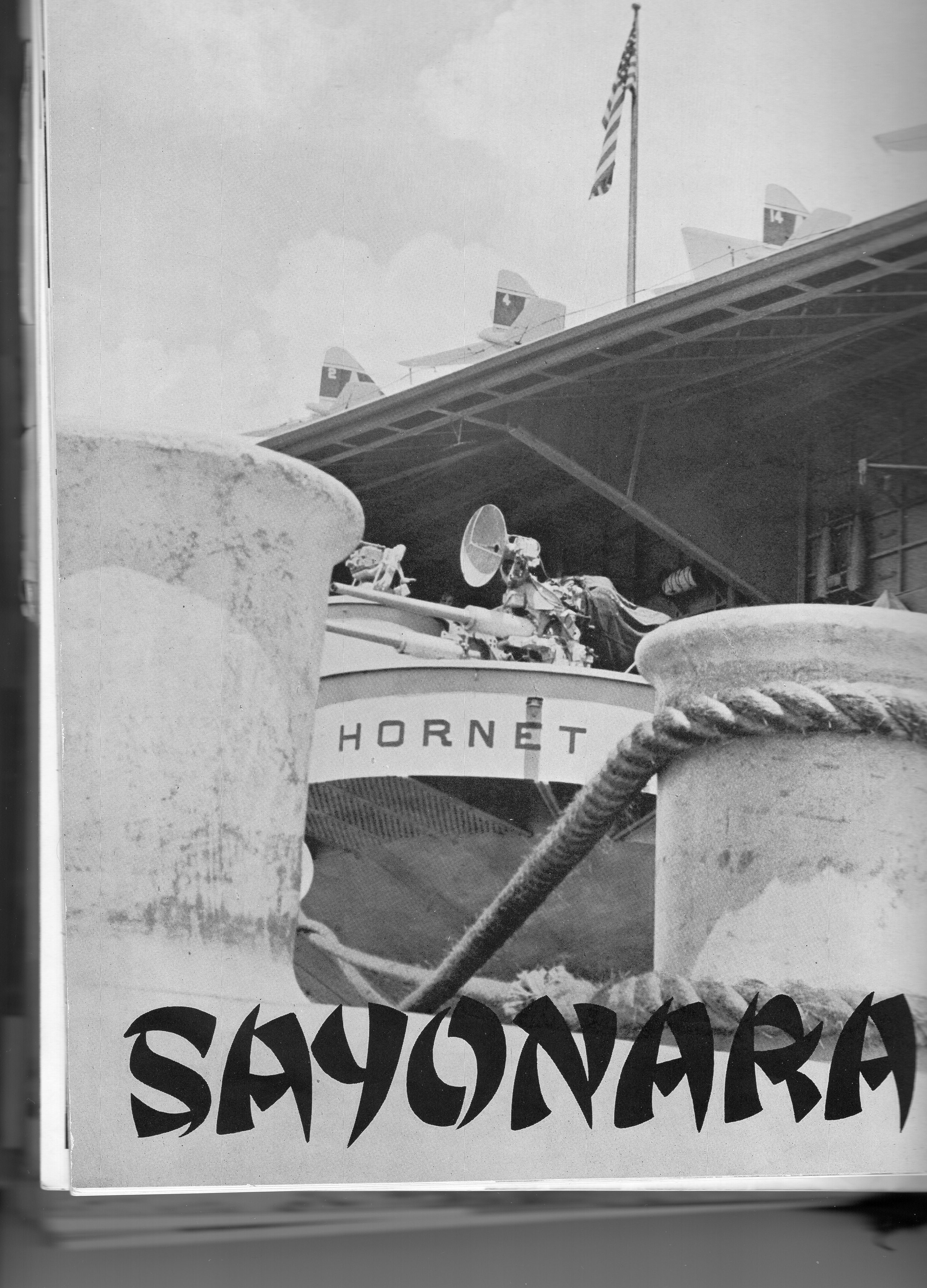

Here's a scan from the cruise book............
File comment: From the cruise book
PostPosted: Fri May 26, 2023 12:38 pm
Posts: 12331
Looks like the Mark 63 Fire Control System, where the director/gunsight is the Mark 29 and the radar antenna is located on the 3"/50 mounting. Details here: https://eugeneleeslover.com/USNAVY/CHAPTER-26-D.html
Simply amazing the knowledge found here. You guys are wonderful!! Thank you.
