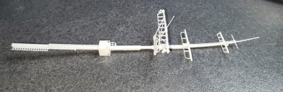

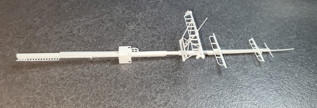

So I printed this banana:
File comment: Bent Mast
Soaked it in hot water (not boiling) for about 10 seconds and applied slight pressure, Le voila!
Not perfect and I might still re-work that a bit, but certainly displaying less bananaristic tendancies.

Those anchor chains are delicious, especially if you have the supports just right and they zip off and then collapse in a pile just like real ones! I've tried the warm water trick but without the success that you had, they seem to resume their banana after drying. Maybe your resin is better than mine. As to the masts I have found them to be quite durable with the wire and also not being bent by the rigging. I did however have to run a wire up and down to keep the hollow open while washing and curing as bubbles tend to form and want to block off the passage.

For my ARL and DE masts I printed them in halves as you describe. It also worked better to make the yards hollow and each end printed separately and also joined with a wire. For the DE the mast protruded through several decks and it worked well to print each section secretly and run a wire to locate all the sections. I'm sure whatever solutions you work out will be satisfactory. An advantage of 3D is if doesn't work one can make modifications.

Had very good luck printing hollow masts, in a vertical orientation, hollow. In some cases printing in several sections. The wire makes it very easy to locate the sections and retain strength. The biggest issue is keeping the central hole open during washing and curing. I would run a wire up and down while washing to prevent bubbles forming and blocking the passage. A way to do the yards is to have the cross piece stubbed with a hole to run the wire through both yards which are printed separately. Solid yards will bend and droop, especially under tension of rigging.
