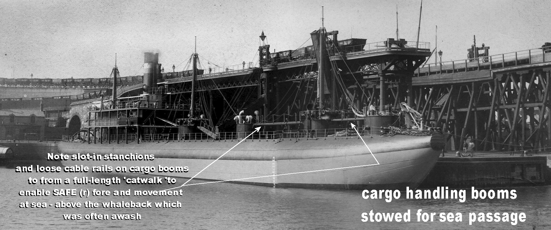

still steadily working forwards....
when the Sagamore was alongside -- discharging Cargo--the cargo-booms
were located to the ' upper' hinged gooseneck fittings

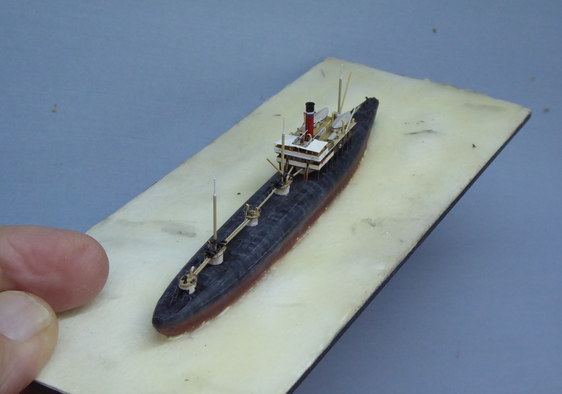

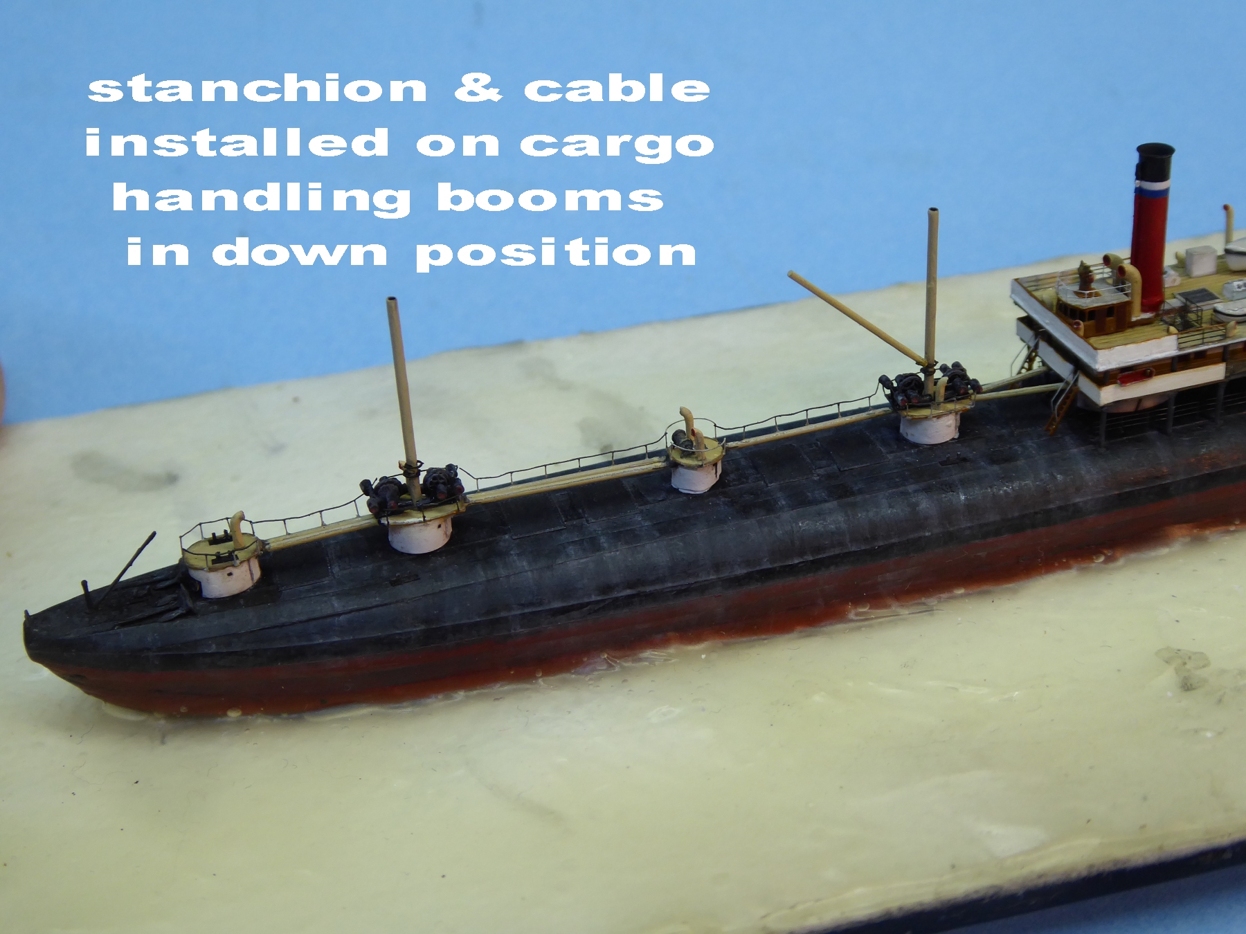

When the ship was at sea .the whaleback rounded main deck was often awash--especially when fully loaded,
hence the cargo booms were stowed in the 'lower ' position so as to form a Catwalk,( as per Windjammer Sailing ships)
in order for the crew to be able to move between the ' turret' structures without being washed overboard
the cargo booms were set up as twin booms had stanchions-and-cable railings to facilitate
a degree of safe transit
I cut the bottom off some GMM Gold Plus twin bar rails, and depressed the centres to give the impression of loose cable
in the photo below they are painted dark grey--
==>.....but have since been given the suggestion of being thinner by being highlighted on the top and mid grey on the sides-
( it works quite well ! )

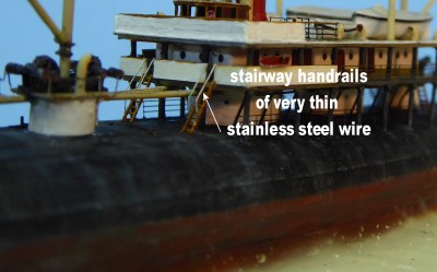

The stair railings were made individually of very thin stainless wire-- much thinner that usual stair PE handrails

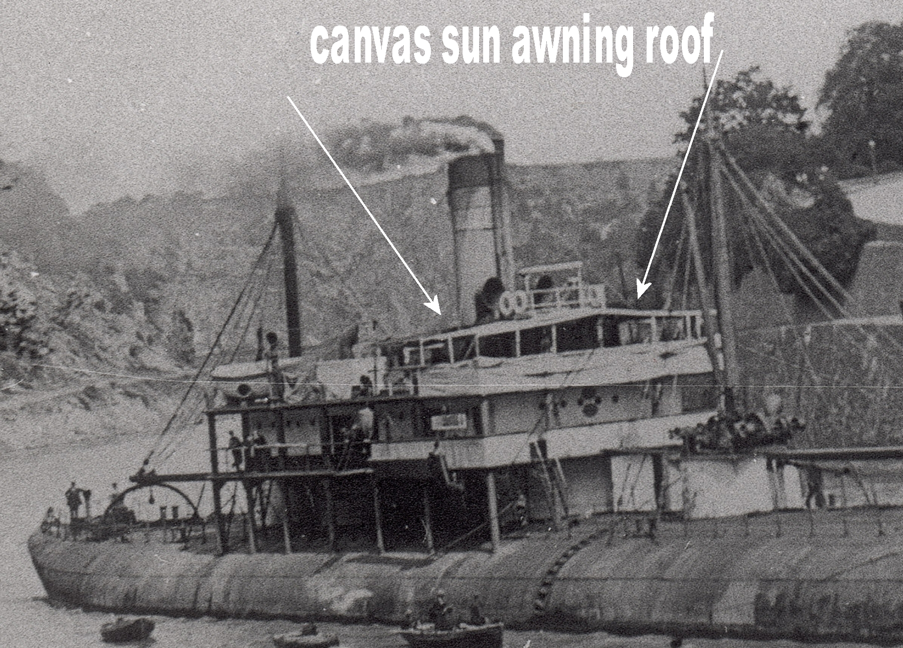

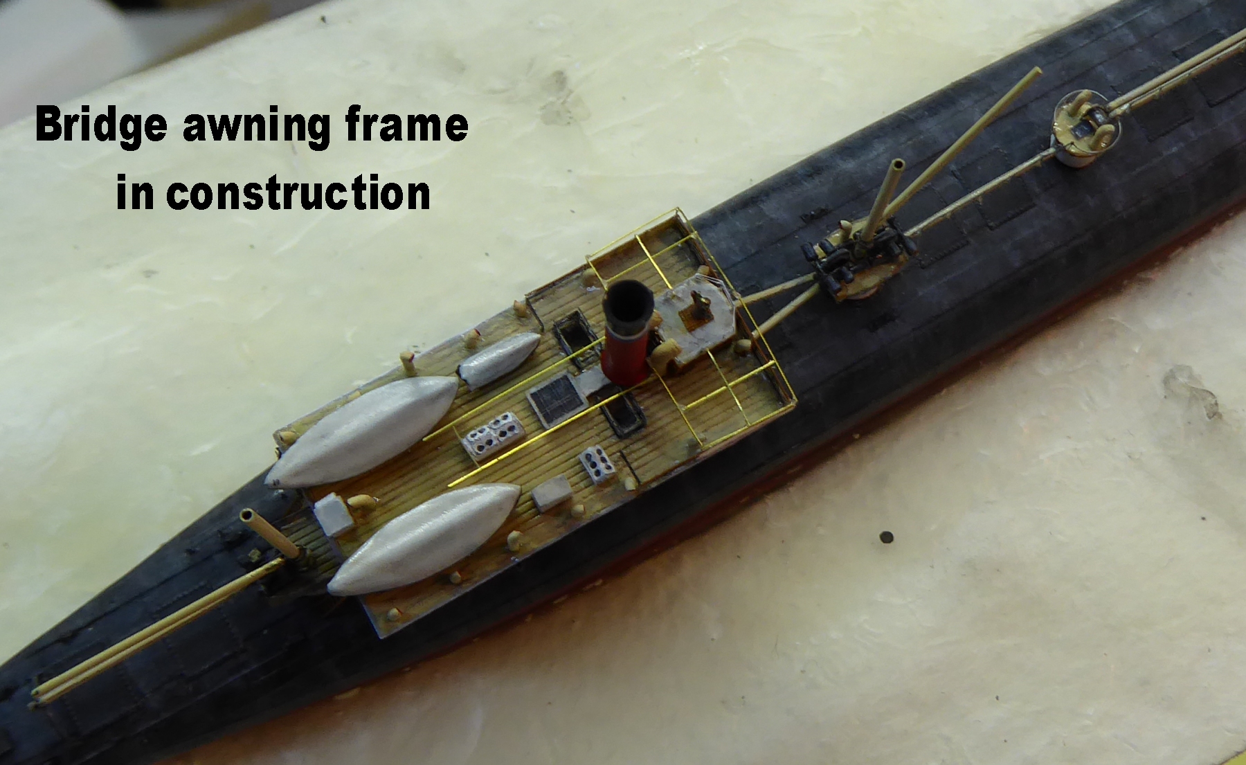

a very distinctive feature on this ship was the large canvas sun-awning covering the bridge the full width
This Sun awning is not erected in every photograph-- but some / most of the framework is ....

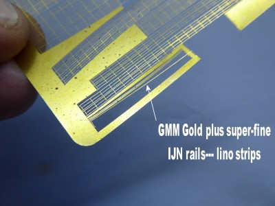

The framework was of rectangular timber beams, so as to emulate the larger depth that width of the beams
I could use wire
I used etched brass strips that were thinner than they were deep
( intended for IJN lino strips )
These were cut carefully and joined with matt varnish first( tacky)
and the had runny CA glue dribbled in to the joints
It was a fiddly fragile and small assembly...!

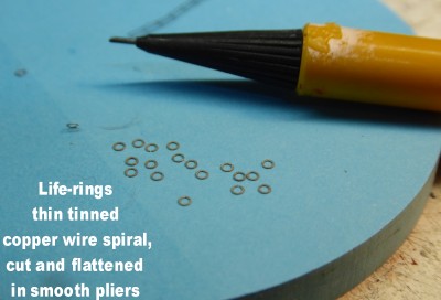

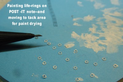

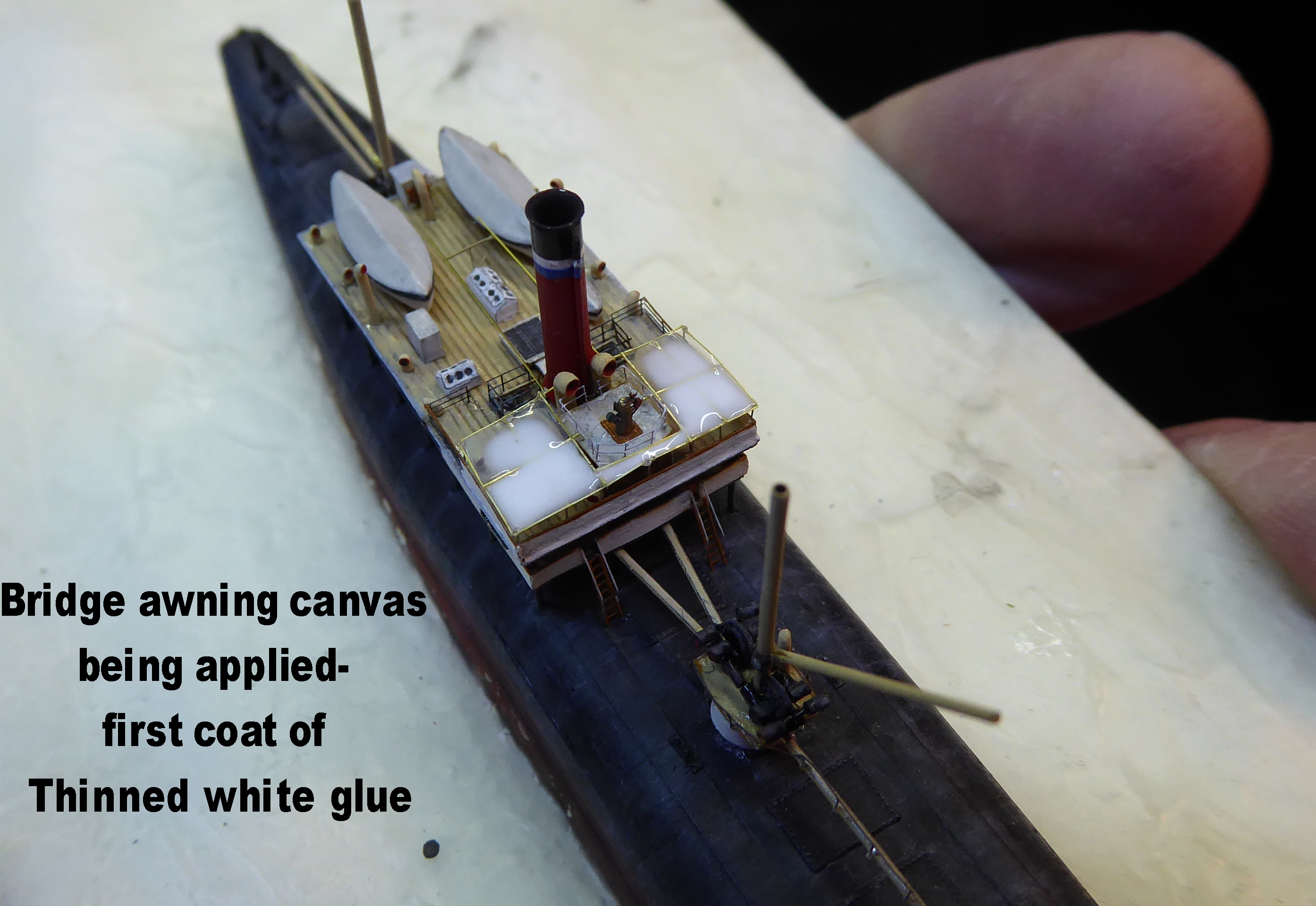

whilst the white glue ' canvas roof' was drying...
I set to making the numerous life rings that were dotted about on
the bridge superstructure railings -
--....in the usual manner
of a soft wire spiral round a small drill shank the spiral then cut and flattened
the failure/ discard rate was 50/ 50...(!)

Very nice awnings Jim. How do you keep those PE beams from moving under the pressure of the white glue drying? On Batoe I used .3mm brass rather than PE sheet for that reason.

@ Pieter--- I thin the white glue about 65-70% water to glue-- that weakens its shrinkage
and inhibits the deflection of the frame (..... I have found anyway!)

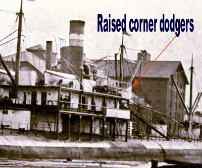

I must say that on the real ship the ' set' of railing dodgers
seems somewhat lackadaisical ...!!
I think the ' tattiness' it is because the corners had triangular panels that could be raised--and are often dropped
in addition....the entire panel could be raised it seems ( alas not a great deal of visibility or elegant! )

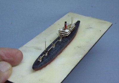

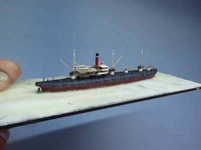

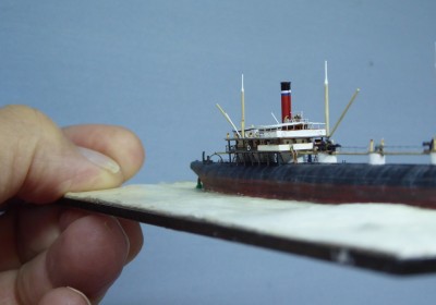

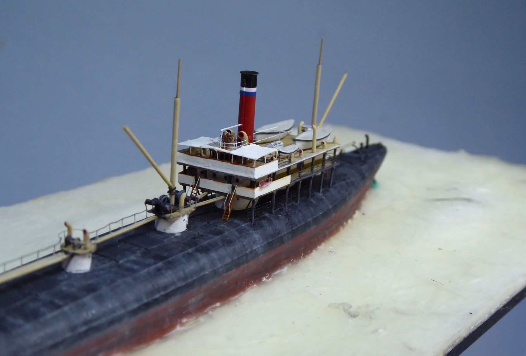

But... apropos awning ==> herewith a few overall views of the awning on the model...;

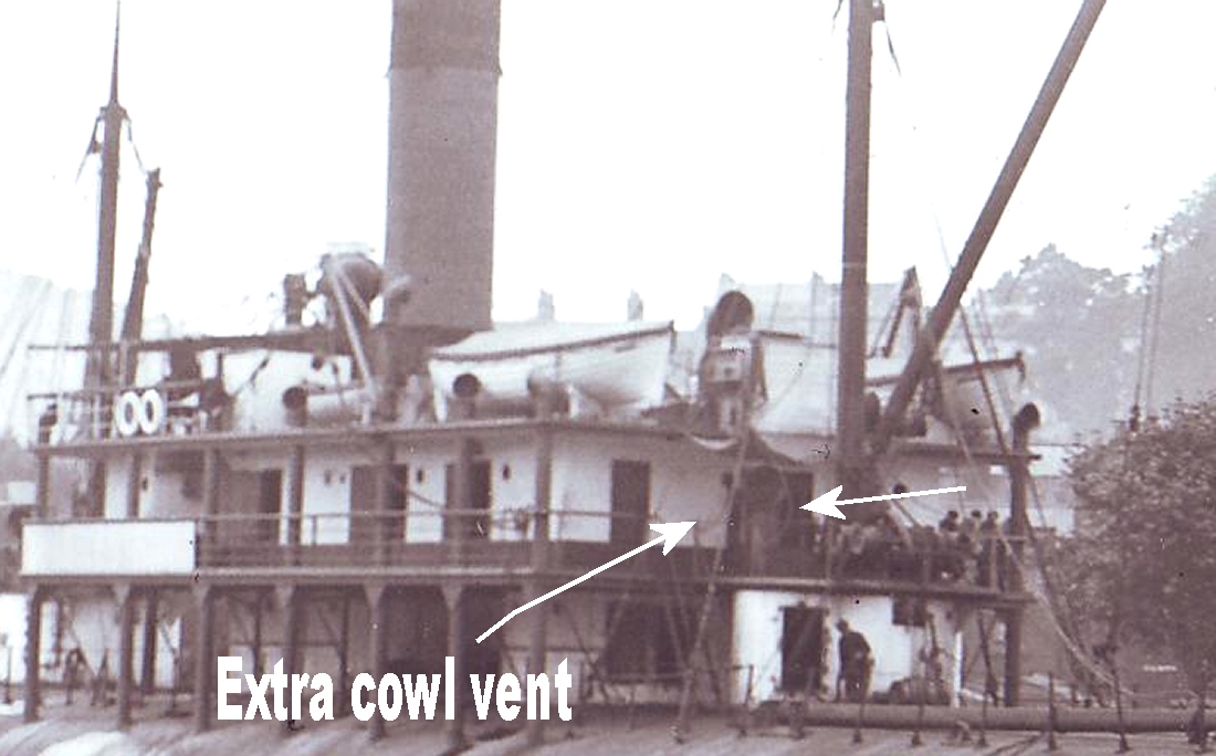

whilst studious of the aft end...
I discovered and extra cowl vent !!

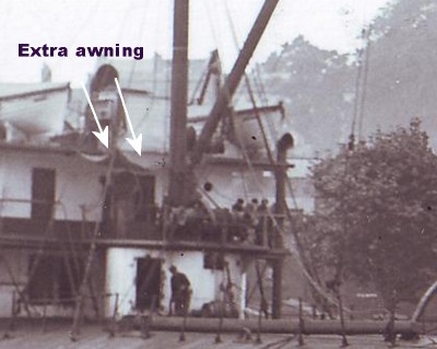

whilst at the aft end I noticed this little awning
which I think I shall add as it will brighten up the aft end a little

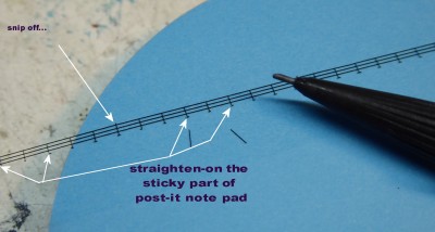

the railings on the rest of the vessel were stainless steel and very very fine...
but for the deck railings I chose to use GMM Gold plus ultrafine-- as they were brass and almost as fine
but a little more yielding to the double curvature of the hull... !! ..
Because if the lack of a water-rail/ spurn-water... they needed the bottom cutting off
I used scalpel for the first cut on a piece of thick glass
and ' Fiskar 'curved scissors for the second cut
the couple stanchion bottoms that got deflected were straightened by
placing the railing on the sticky-pad end of the post-it note pad
( which held it firmly without point loadings)
and peeled off the ' sticky' by placing a scalpel blade and gently lifting
attaching them was quite and adventure... the glue contact area is minimal
I used thinned white glue 80 water/ 20a glue
this is very tacky and dries really very fast .
...and is --once all the stanchion bases have had a bit of glue brushed on
with a point fine paintbrush--the bond is quite strong--
the excess glue was washed away with a wet paintbrush wetted with water )

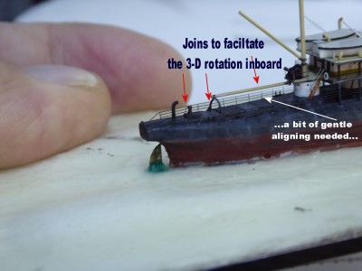

the stern needed quite a bit of ' cut-n-shut ' of very small bits of railing
and many a deep breath...

I could not avoid the problem any longer--and started the process of raising the water-level in 4 layers.
I used for the first coat a lower density faster drying structural gel
in the image it looks like the ship has stranded on a white beach... ! .? :big_grin:
Once the water-levels had dried ( 2 weeks !) the first coats of paint went on.....
aiming at a shade and hue suitable for the grey -green of the coastal waters of England,
adding coats wet-on-wet of differing and lightening shades
